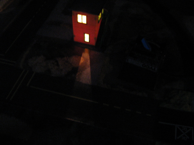

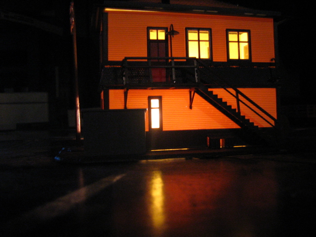

I set up a light from a TycoKit building and it
seems way to bright. Buildings Light up in colors
which looks pretty but needs toned down a bit.
What about a dimmer switch?
What's needed for LED's
I plan on having over 50 Lights with all the buildings,
street lights and traffic lights. I have many Tyco pak 1's
I plan to use for power.
I hooked the light up to the AC side, is that correct?
If I hooked it up to the DC would it still light and could I
use the throttle as a dimmer?
What can be done?

 Posted - October 21 2008 :  09:46:56 AM Link directly to this reply  Show Profile  Send catfordken a Yahoo! Message  Add catfordken to Buddylist
hi with out some sort of converter to use ac (alternating current) in a dc socket is very DANGEROUS,ac is what most houses have and dc is usually battery power.ken
 Posted - October 21 2008 :  09:51:16 AM Link directly to this reply  Show Profile  Send catfordken a Yahoo! Message  Add catfordken to Buddylist

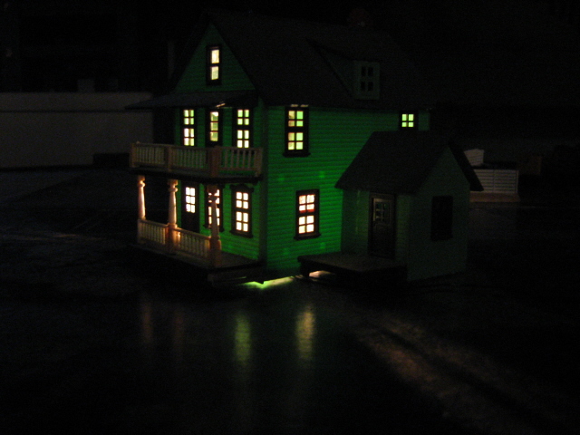

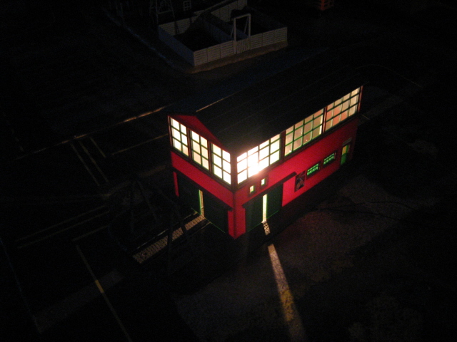

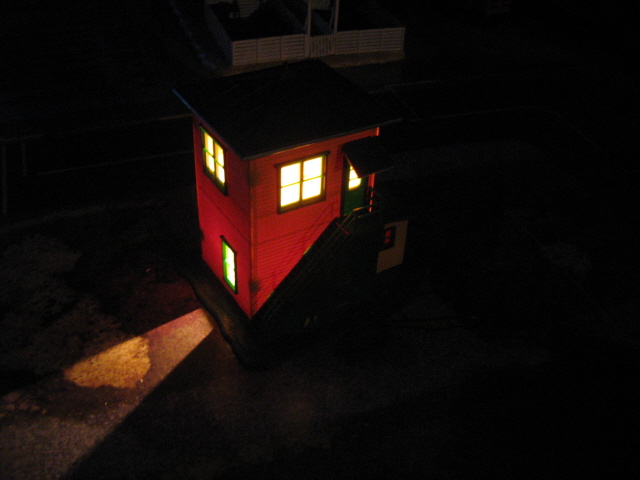

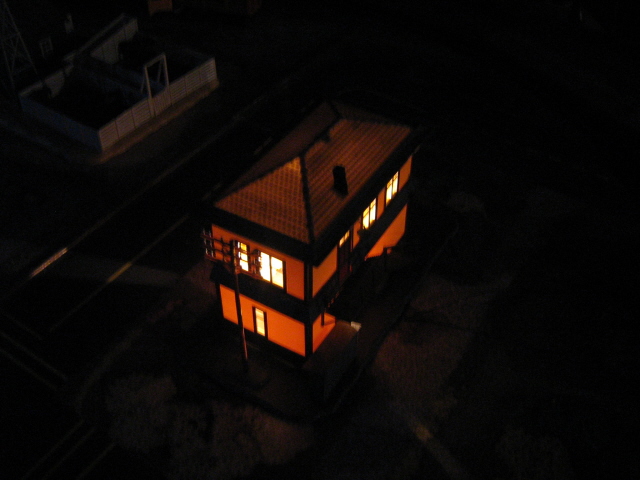

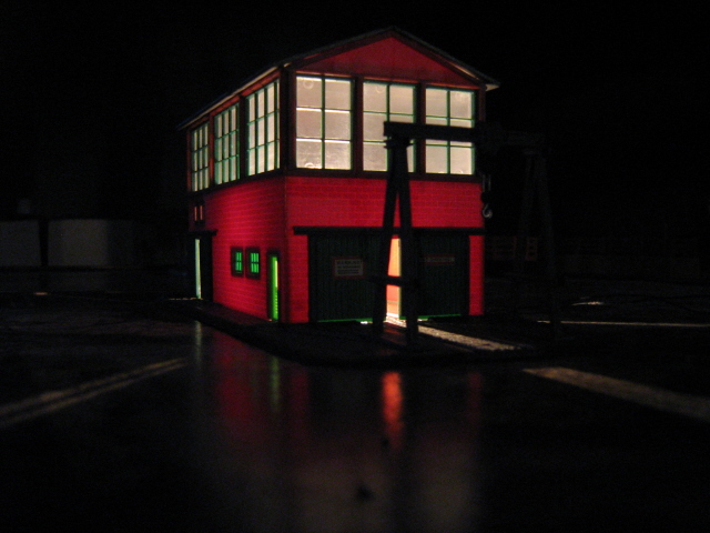

to me it looks good,what is spoiling it is the light at bottom edge of buildings,to tone lighting down glue curtains to insides of windows and paint inside of roofs if you have light leakage,it looks as if you have lighting outside building as people do in my opinion ken
ps the hardest one to illuminate is the signal box,replace with a very dark coloured light bulb as it is it looks empty,best answer there would be detailing interior and dark bulb

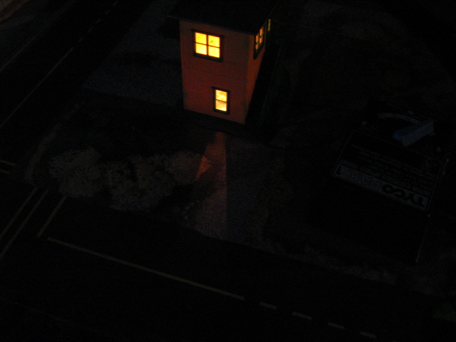

Thanks for the link. I thought about painting the inside also.
The models I have done are all from opened boxes and I still have the same one's sealed,so I can start over again. I'm just trying some things out before anything is goes on the main layout.

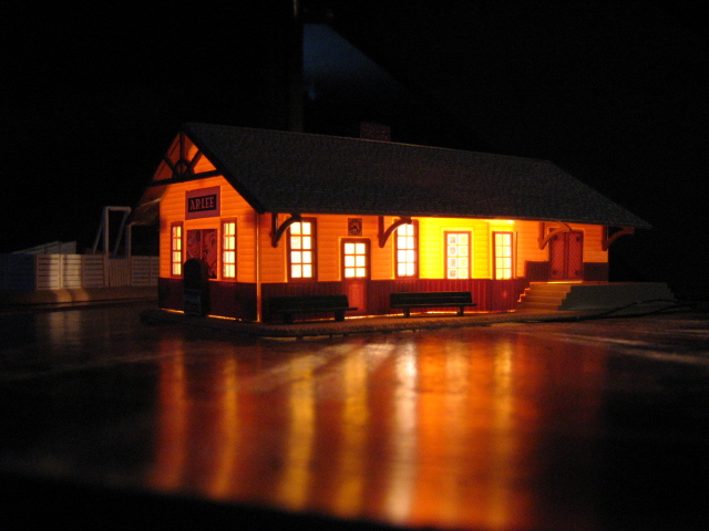

Well I hooked the light up to DC and got results I like so far.
First of all the light stays off when throttle is off.
Next the tyco pak 1 works well as a dimmer.
With power on and on low
now on high
Am I dealing with such a low voltage that a bulb works AC and DC?

I had the same problem so now I paint the inside of my buildings with black or a dark grey, then I but a flashlight inside to see what it looks like, just in case I missed an area...garret
 Posted - October 21 2008 :  4:35:48 PM Link directly to this reply  Show Profile  Click to see DaCheez's MSN Messenger address  Add DaCheez to Buddylist
Painting the inside black is probably the best and easiest idea. On some of my engines and cars I put pieces of tinfoil inside. This acts as a heat shield as well as keeping light from bleeding through the plastic. If you're doing a lot of buildings though, the paint would probably be best, as cutting tinfoil to fit in can be a pain.
