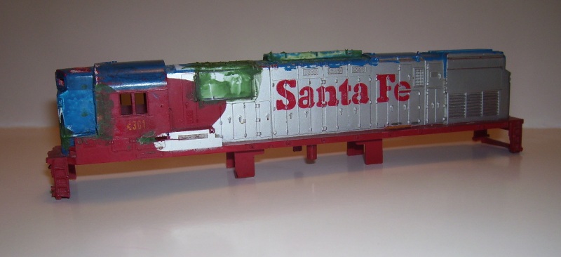

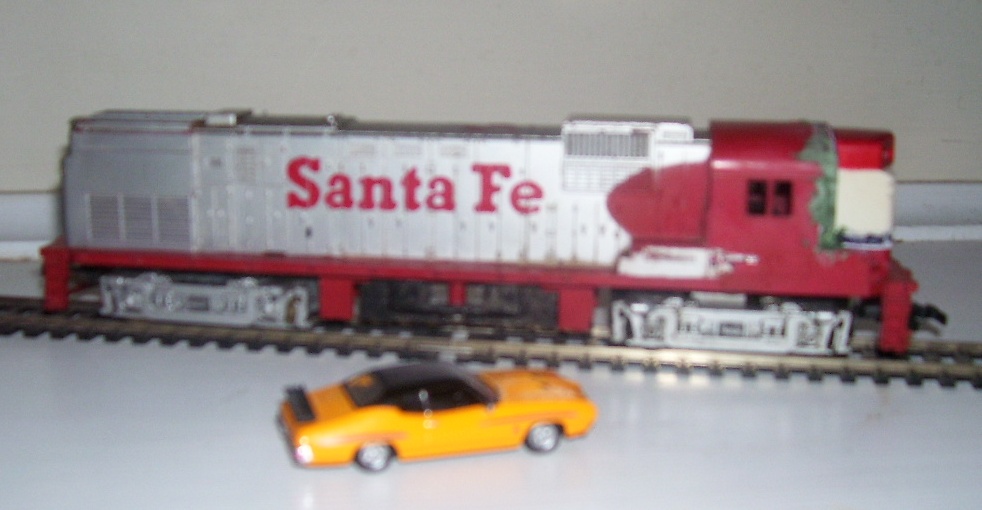

Thought I'd show a project that I'm having fun with. I have swapped the high nose and moved the trucks closer together to look more like the 425 and 430s. I'm going to make a more proto tank, etc. I cut the "flaps"
next to the tank to give truck clearance like the protos. Using MU2 power. Had to grind material off the front truck bogey to move truck backward and lengthen the mounting slot. Drilled the back plate to move truck foward. It runs!
A bad bad pic but you get the idea.

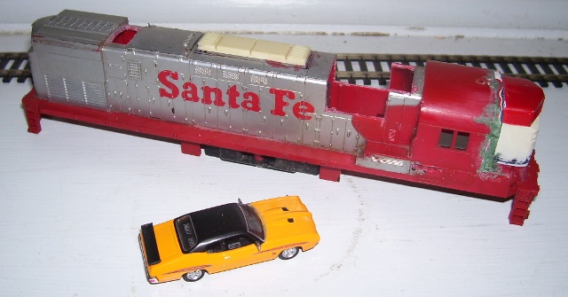

Here's an updated pic of the 430 shell with some parts removed to help it look more like a 425.
The 430 shell was from Brianstyco and the DB casting is from Hypoponera and the high hood is from Outofstorage.

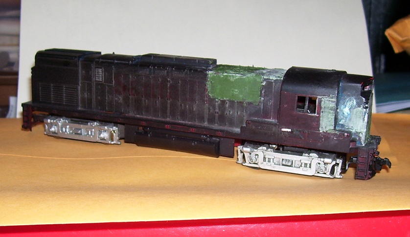

I have been working again on my C425 conversion. There are many things I should do to make it more accurate but I think once I sand down the putty I'm going to paint this thing. I had earlier moved the trucks inward to look more like the position of the truck on the prototype. I may fill the pilots and body mount the couplers.
The cab on the 425 is much shorter and I'm not sure if I can use the MU2 trucks if I shorten it.
The drawing I was using didn't have a vent where the filter box used to be behind the cab so I filled it in. Then I looked at the link above which I hadn't looked at in over a year and see that example does have a vent. I May leave it as it is, smoothing out the rough spots.

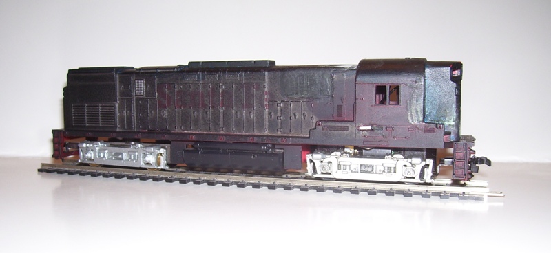

Update .It's running and I'm working on it again. It is supposed to be a high nosed C425 from a Tyco 430 shell. I know its not exact and is too long but I'm operating on the "close-enough" principle that a noted railroad modeler subscribed to. It won't be long hopefully untill it goes to paint.
I'm sure you can see some of the changes. I altered the wheel base to look more like the 425 reference photos. Added a C630 nose and removed the air filters behind the cab. Also added a DB and removed another box on the roof and shortened the "tank flaps" next to the fuel tank.
