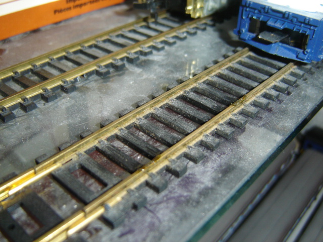

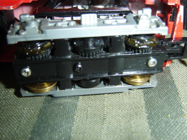

I'm sure we already have enough topics about traction tires on this forum, but has anyone ever seen anything like this?
I took one of my C430's off the shelf today and found that the traction tires had melted!! I picked it up and they were literally OOOOOZING all over the track the engine was sitting on. I took the wheels out and gave them a good scrubbing, but it didn't do much. I ended up replacing the wheels...not sure what to do about the track yet O_o
yummy...
See those dark spots?...ya...thats melted elastic...
Anyone ever seen this before? FYI, I think the "tires" on this engine were dental elastics, and it had been sitting for a few months.
-cheez

I've tried to warn people away from dental rubber bands. They soak up oil and turn to that goo you've got there, Cheez. Try soaking those wheels in 90% alcohol, and using it on the rails as well.

What a Goopy Mess!! Try some Goo-Gone on those tyco wheel sets. Let them soak in it. Goo-Gone is a great gunk remover. It will remove about anything and clean it too. I bought some at Wal-Mart a long while back.
