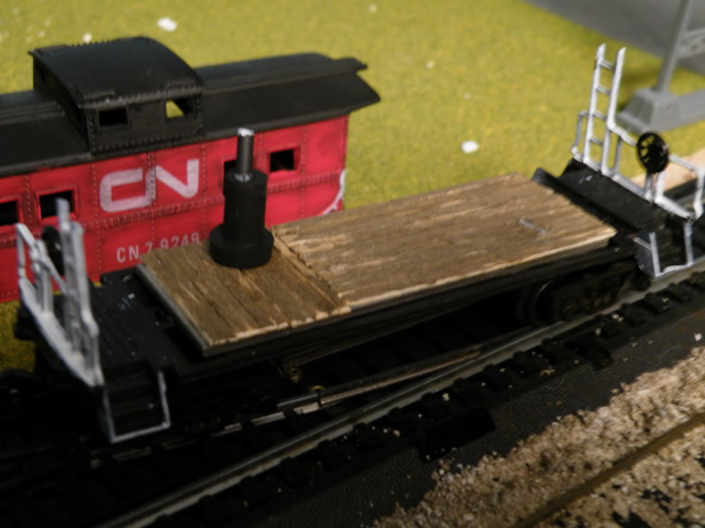

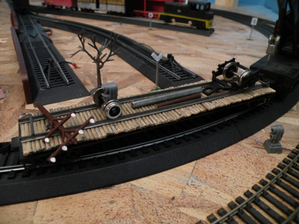

This is actually a little something I did up only because I had bought an Athearn rail crane kit, but I didn't have a work caboose or something like that to go with it.
It actually started life as a Roundhouse 50' boxcar. I glued down all the toothpicks and then snipped the bits hanging off with a pair of scissors. It left quite a mess. Then I glued down some scrap steel track and coated everything with a flat black wash. Not pretty, but it's rarely out on the main line.

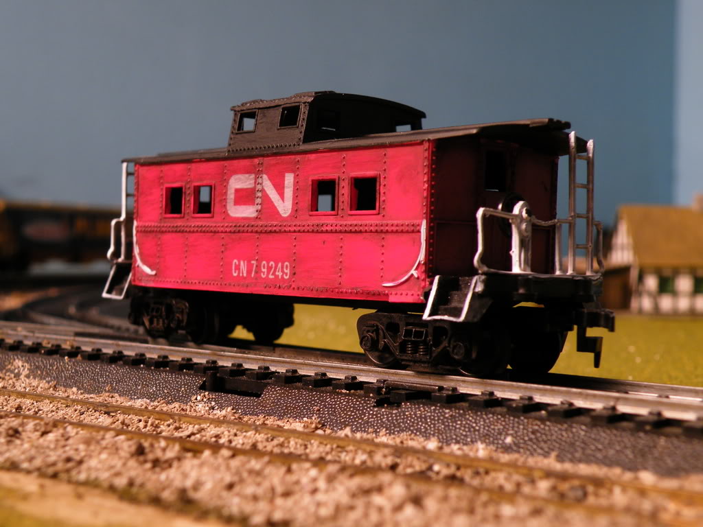

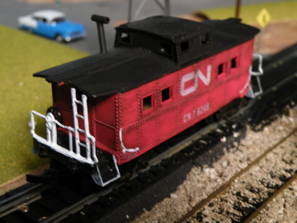

And this is a fairly new, cheap little Life-Like caboose. I started by building a replacement chimney out of all things, Q-Tips! Then I painted over the glossy black roof with a coat of flat paint.
Then I painted all the handrails white. I don't think that's prototypical, but I like the look. Then I tried a new idea for weathering. I took one end of a Q-Tip and dipped it into a flat black wash. Then I covered the whole area until it was sopping wet. Then I quickly rubbed it dry with the other end of the Q-Tip, which left some residue near rivets and edges.
Lastly, I built a floor out of toothpicks and applied some old wood stain. I also built a makeshift stove out of sprue parts. You can't see in the windows much, so it's not a big deal.

Neat idea on the caboose interior, I do not do any interiors on cabooses usually, what I do is make windows, sometimes partial open and fog them a little with mat clear paint, just to the point that they look older, sometimes I make them look broken or cracked, paint the inside a dark color also helps give a illusion that something is there. you can also use small pieces of wood in different shapes to represent items like bunks, upper areas and stoves, sinks, desks...all they have to do is be similsr in shape, no details needed, also if you place a person inside or hanging out of the door or window it helps with the illusion...Garret ...the "fanged one"
