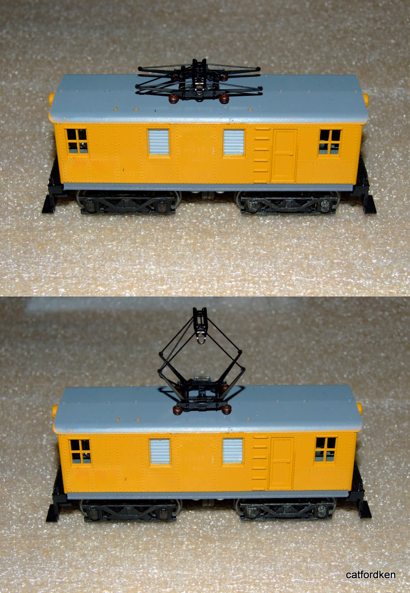

 Posted - July 17 2011 :  5:37:12 PM Link directly to this topic  Show Profile  Send catfordken a Yahoo! Message  Add catfordken to Buddylist

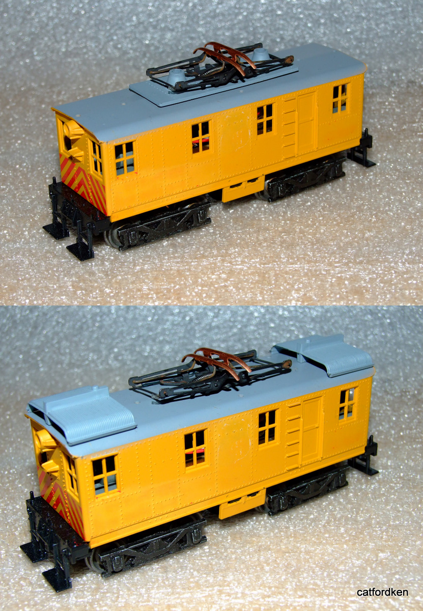

this is my start of a dual powered boxcab,track and overhead,nothing on roof is permanently fixed as yet,ken
as a starting point which would you use
Edited by - catfordken on July 17 2011 5:44:52 PM
 Posted - July 17 2011 :  6:11:47 PM Link directly to this reply  Show Profile  Add shaygetz to Buddylist
The bottom...the other detail, stacks and cooling coils, would be unnecessary on a juicer...
Sweet lokie...

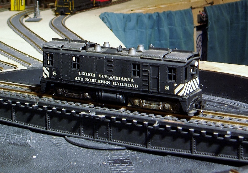

 Posted - July 17 2011 :  7:37:39 PM Link directly to this reply  Show Profile  Add shaygetz to Buddylist
You'll want to add air horns, an air bell, cooling coils but of a different type (see pic), the two center windows on either side you'll want to make into air vents, roof walks of some sort and a junction box on the roof...
Every road is different, mine follows basic details found on a variety of roads that struck my fancy.

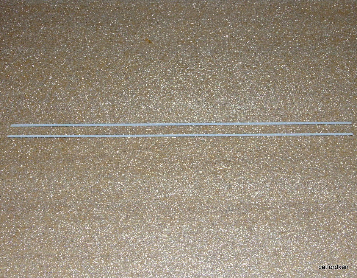

 Posted - July 17 2011 :  8:19:22 PM Link directly to this reply  Show Profile  Send catfordken a Yahoo! Message  Add catfordken to Buddylist
got plenty of plastic strips,just need some horns and bells,what you use for the cooling coils ken
 Posted - July 17 2011 :  8:54:02 PM Link directly to this reply  Show Profile  Add shaygetz to Buddylist
I had some stiff steel wire that came in a bundle, I bent it just like you see in the pic. Took a couple tries to get the right length but, once I got it, it was easy to copy for the other side. Then I added the styrene standoffs with ACC gel to keep them separated. It copies some of the earlier boxcab juicers on the New Haven...I really only added it because it made the roof look busier and I liked the look...
My pantograph came off of an AHM/Rivarossi GG1...

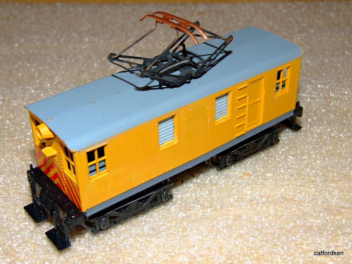

 Posted - July 18 2011 :  4:36:26 PM Link directly to this reply  Show Profile  Send catfordken a Yahoo! Message  Add catfordken to Buddylist
shay hows this looking,remembered i had some walthers module bits and pieces ken
Edited by - catfordken on July 19 2011 07:58:13 AM

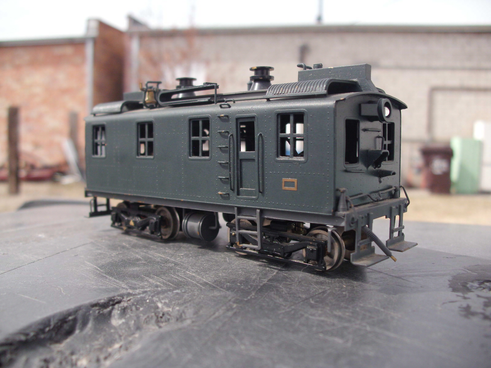

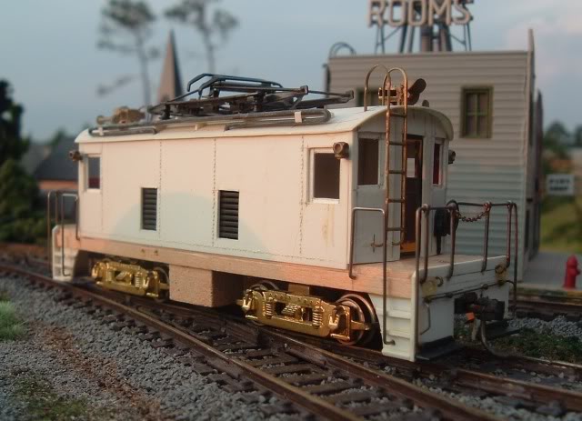

 Posted - July 18 2011 :  5:02:43 PM Link directly to this reply  Show Profile  Add Redwoods to Buddylist
Ken, here is one I did many moons ago. She's due for a paint job, I really like your traction yellow. - Thomas

 Posted - July 18 2011 :  5:08:33 PM Link directly to this reply  Show Profile  Send catfordken a Yahoo! Message  Add catfordken to Buddylist
nice one thomas,i wanted to know what the louvres looked like,it was a union pacific liveried one but took the tampo printing off ken

 Posted - July 18 2011 :  6:50:17 PM Link directly to this reply  Show Profile  Add Redwoods to Buddylist
Thanks Shay, yours looks great too, I especially like the details like the coils and the horns.
Question: How do you curve the roof? Is the plastic just thin, or do you do anything special to get the curvature?
Thomas
 Country: USA  ~  Posts: 1093  ~  Member Since: July 07 2011  ~  Last Visit: October 25 2026 Alert Moderator  Go To Top Of Page
 Posted - July 18 2011 :  8:00:09 PM Link directly to this reply  Show Profile  Add shaygetz to Buddylist
Thanks...I rolled the roof around a half inch dowel, then glued it to a curved framework---then cornered the market on rubber bands....

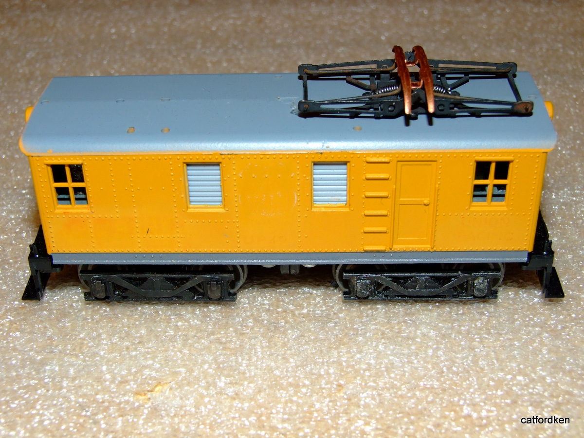

 Posted - July 19 2011 :  08:35:53 AM Link directly to this reply  Show Profile  Send catfordken a Yahoo! Message  Add catfordken to Buddylist
final question,where should pantograph be,ken
on end
cetral to windows,or central to roof
Edited by - catfordken on July 19 2011 08:36:47 AM
 Posted - July 19 2011 :  09:13:56 AM Link directly to this reply  Show Profile  Add NickelPlate759 to Buddylist
Ken, from the pictures I've seen, it seems like the pantograph should be centered unless you're adding a trolley pickup on one end like Thomas' model.
http://www.jefflubchanskycpa.com/PRR5690STRAS-AP20-2DG568.jpg
http://www.lafterhall.com/osw06_012.jpg
Nelson
 Posted - July 19 2011 :  09:28:45 AM Link directly to this reply  Show Profile  Send catfordken a Yahoo! Message  Add catfordken to Buddylist
hi nelson i prefer centre, the size of the panto is to big to make like Thomas did,ken

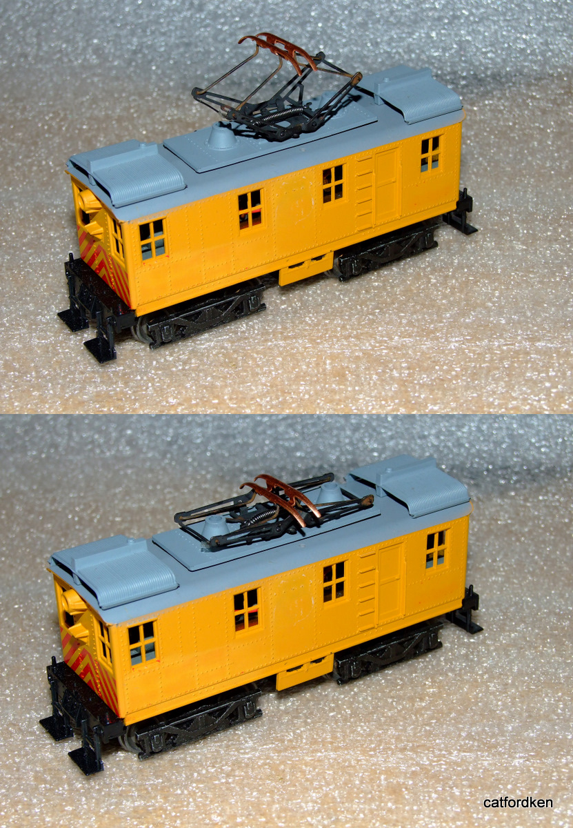

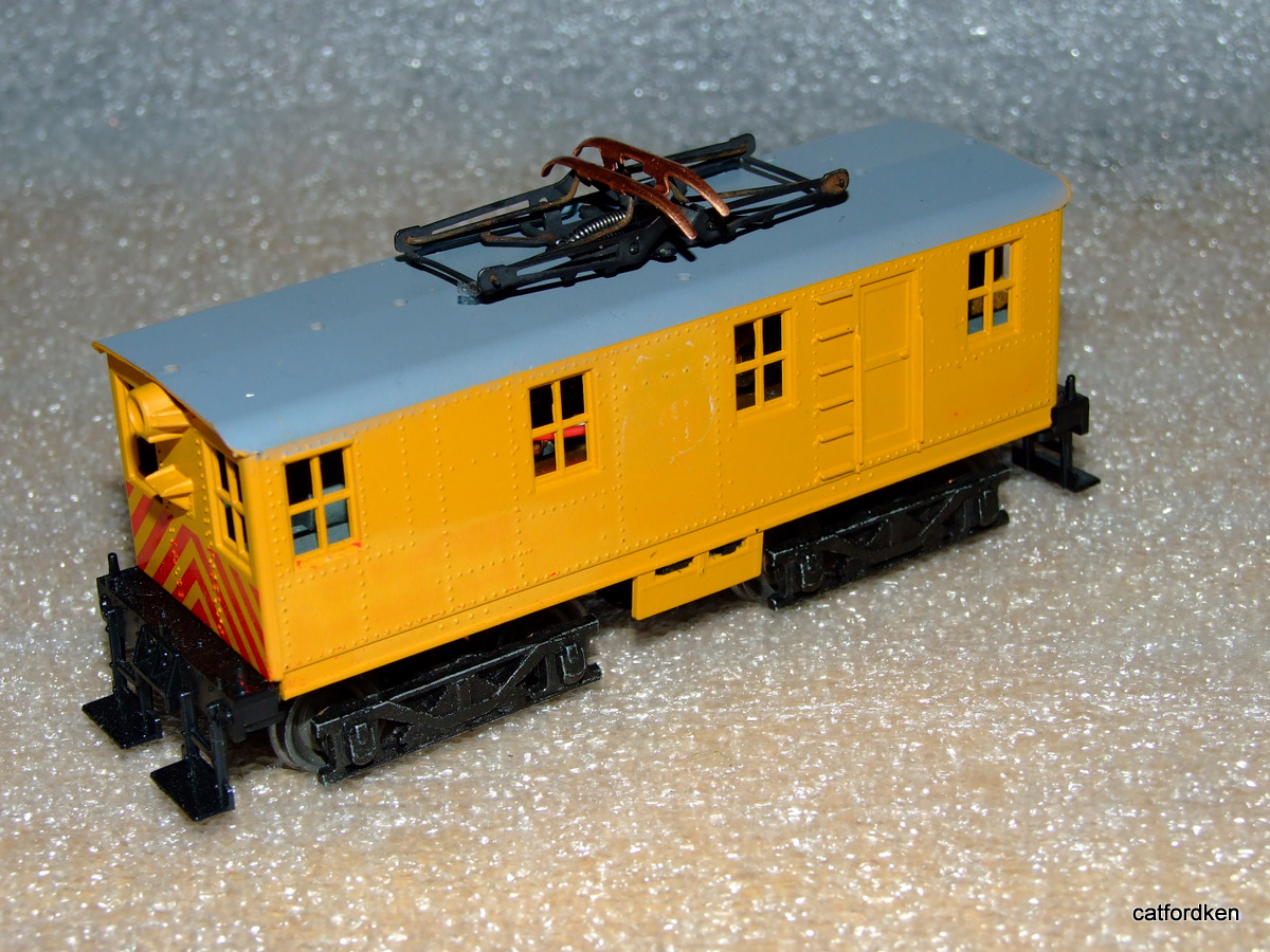

 Posted - July 22 2011 :  12:50:36 PM Link directly to this reply  Show Profile  Send catfordken a Yahoo! Message  Add catfordken to Buddylist
got a pair of these coming,which i think look better ken
Edited by - catfordken on July 22 2011 12:56:06 PM

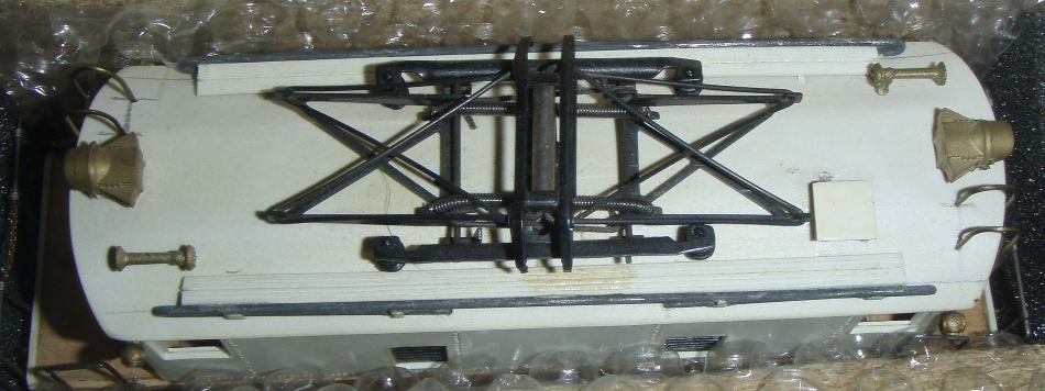

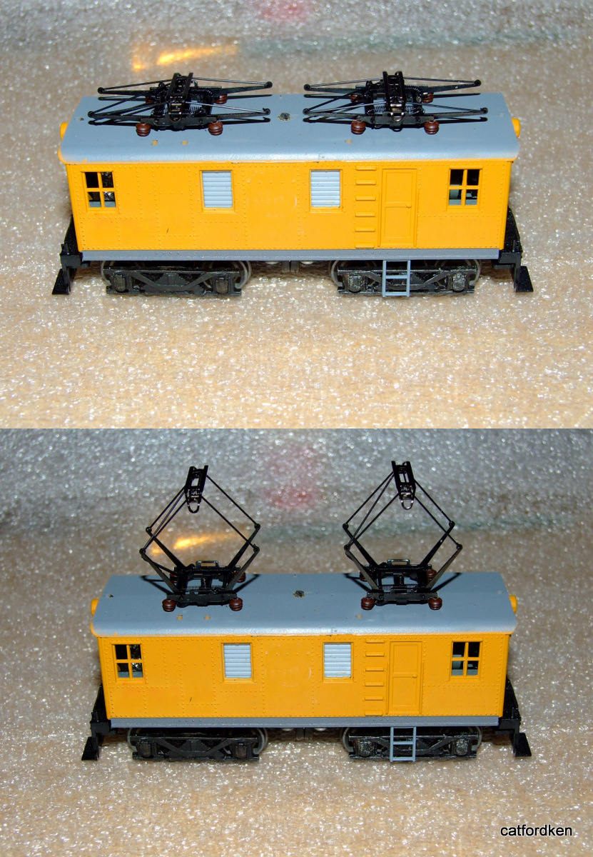

 Posted - July 26 2011 :  08:02:04 AM Link directly to this reply  Show Profile  Send catfordken a Yahoo! Message  Add catfordken to Buddylist
new pantographs i think they look much better ken
Erich
train
 Posted - July 26 2011 :  12:26:33 PM Link directly to this reply  Show Profile  Add Erich to Buddylist
[quote]new pantographs i think they look much better ken
because of the isolators! - Erich
 Posted - July 26 2011 :  12:43:15 PM Link directly to this reply  Show Profile  Add NickelPlate759 to Buddylist
Definitely better looking pans. Who made the two versions?
 Posted - July 26 2011 :  12:46:38 PM Link directly to this reply  Show Profile  Send catfordken a Yahoo! Message  Add catfordken to Buddylist
triang made the one in first pics,sommerfeldt the last pics ken

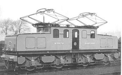

http://www.btinternet.com/~beckits/Pantos/pantoho.htm
Edited by - catfordken on July 26 2011 3:52:54 PM

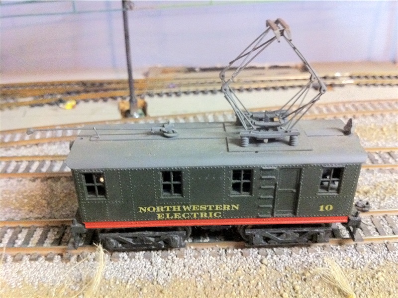

 Posted - July 26 2011 :  1:04:01 PM Link directly to this reply  Show Profile  Add toptrain to Buddylist
Ken ; Here is a boxcab of a slightly different size. Two bodies put togrther with a Athearn drive.
 Posted - July 26 2011 :  1:26:33 PM Link directly to this reply  Show Profile  Send catfordken a Yahoo! Message  Add catfordken to Buddylist
frank,that is a good conversion,love it ken
