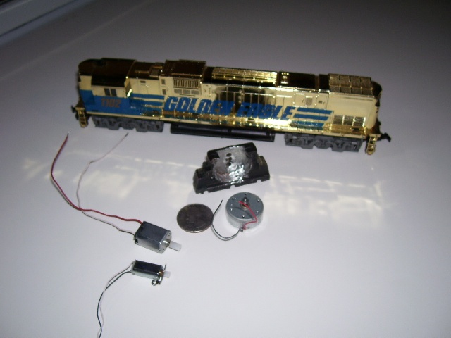

Here are some motors that I found while tearing apart an old abused Lenoxx CD player. The big flat can is the main motor and the next larger size ran the laser. The skinny one came from the first player I scrapped and also ran the laser. I wonder what the small ones might work in? All seem to run strongly from track power.

 Posted - May 15 2008 :  01:40:19 AM Link directly to this reply  Show Profile  Add Ray Marinaccio to Buddylist
I have one similar to the small one in the photo that I put in an N scale Bachmann 0-6-0. I don't have it ready for a test run yet so I can't comment on how it runs.

 Posted - July 03 2009 :  8:28:40 PM Link directly to this reply  Show Profile  Add Alco Fan to Buddylist
Thanks Ray,
Looks thin and promising for clearing the middle axle on the 630s.
 Posted - July 04 2009 :  7:45:14 PM Link directly to this reply  Show Profile  Add Mike to Buddylist
Ok, I'll admit I am not an electrical type guy, but don't these motors have to be 12 volt?
If not, boy I am interested...

 Posted - July 05 2009 :  3:53:36 PM Link directly to this reply  Show Profile  Add NickelPlate759 to Buddylist
It depends, Mike. Many of these motors are that are rated at 5.9V will run comfortably at 12 or 15... I've used a number of them for remotoring projects without any overheating issues. Either the listed rating is the nominal voltage instead of the maximum, or they're just very durable. Wiring a pair in series like Ray suggests will halve the speed, and make them last forever.
AF, that's the smallest can motor I've seen from a disc drive. It would definitely be a candidate for N scale projects, assuming it can handle the voltage. The medium-sized one would be a good fit in a Bachmann old-timer 4-4-0 tender.
