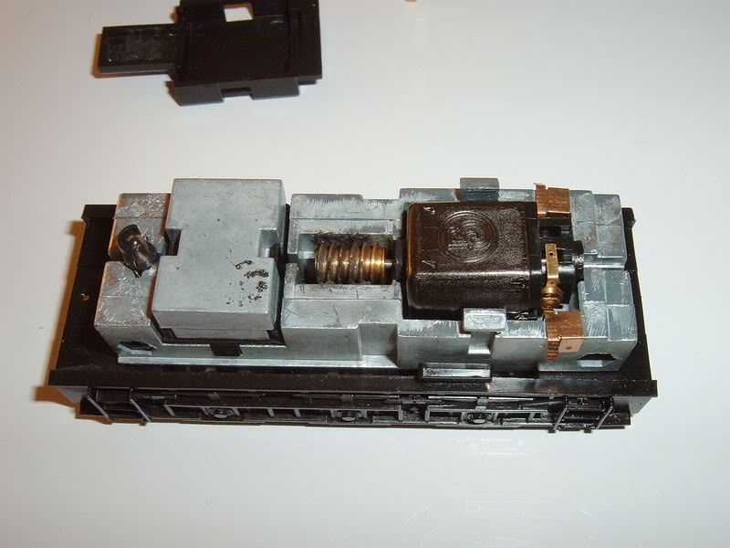

The old version features the pancake motor, but the new version has a small can. It has very low speed gearing appropriate for a switcher. Power is picked up through the heavy split frame. The center axle is ungeared.

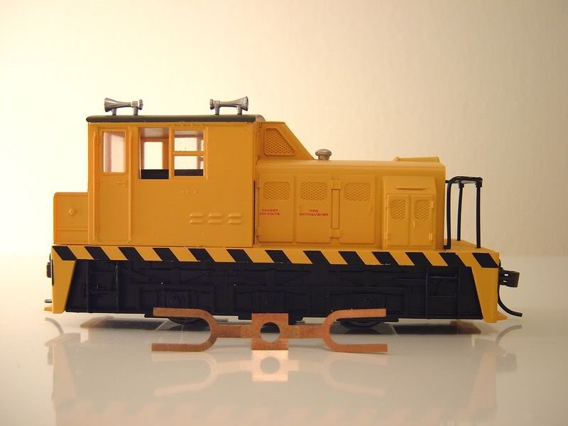

I used modified IHC E8 front truck wipers to reinforce the current pickup from the front and rear wheels.

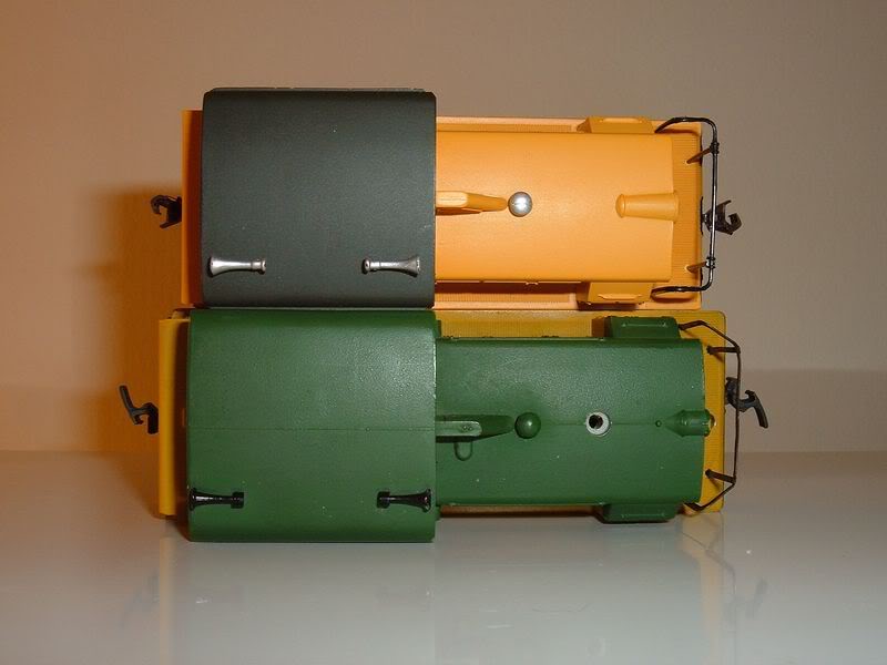

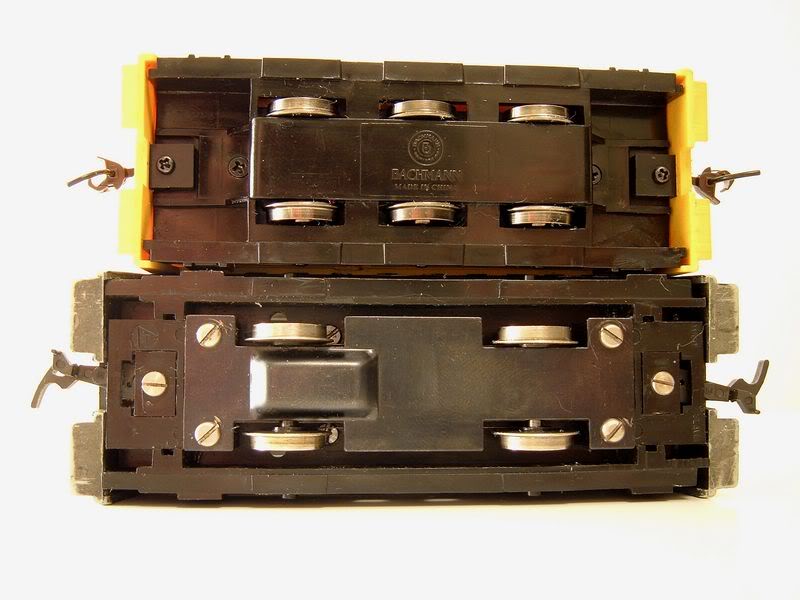

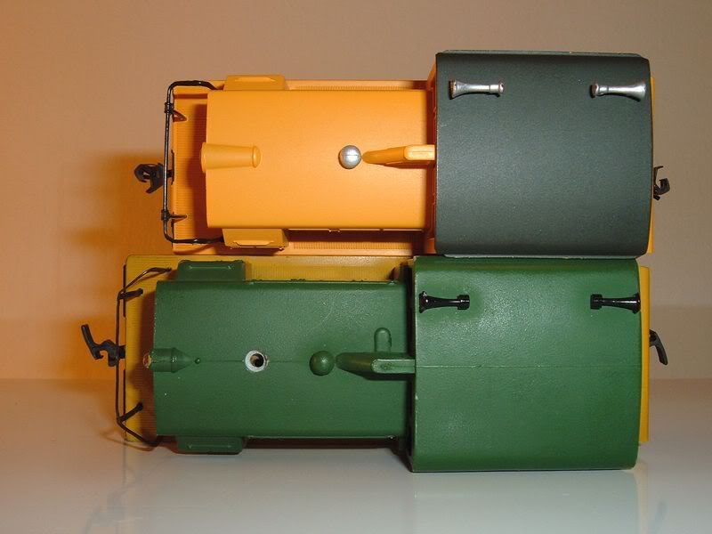

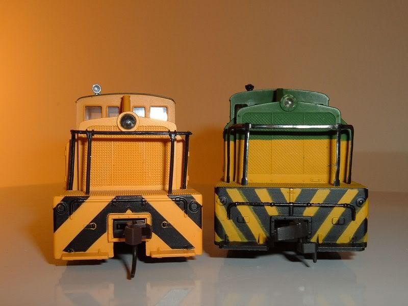

Okay, in true GIC tradition, here's a side by side comparison of the New Bachmann MDT switcher, and the old AHM/Mehano 1960's version.
This next shot shows the difference in overall length.
Here is one of the E8 wipers I modified to improve electrical pickup. The hole in the center goes over the center axle, and the lower wipers get snipped to clear the underframe. The upper wipers rub the back of the powered wheels, while the center of the contact rests against the metal frame. No soldering necessary. [:D]
This is what the chassis looks like with the motor cover removed.

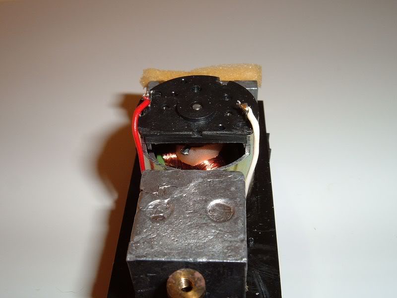

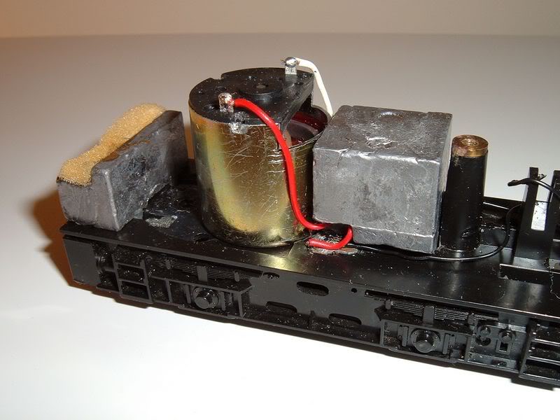

And finally, this is the motor I installed in the AHM. It's a Canon motor from All Electronics that runs at only 4000 RPM at 12V, so this baby crawls. It runs better than the Bachmann now. You can see I had to do a little surgery to make it clear the hood, so imagine my shock when I discovered it only has 3 poles. Still, you can make this engine move so slowly you can't see it. It's really cool to watch the armature barely revolving.

Thanks for the photos of you motor "adjustments"! I picked up a couple of those Canon motors for the exact same purpose. Now I know not to panic if it doesn't fit the first time. Cutting into the motor for clearence would never have occured to me. Thanks again for that!!

No problem, Hypop. Pry the tabs up carefully on top of the motor, remove the armature, reassemble and cut about 1/4 the diameter away with a razor saw (I used an old Atlas track saw). There's plenty of room if the lugs are parallel to the saw blade. As you can see in one photo, there is plenty of clearance for the magnet. I cleaned the filings out carefully before reinstalling the armature.
The old motor shaft is larger than 2mm, so I used thin silicone tubing from an old grill lighter as an adapter for the worm, then secured it with CA. I tried clear tubing for electronics applications, but it must not be even because the worm always ended up eccentric.
