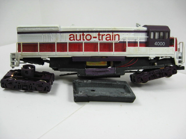

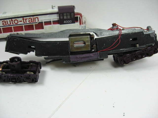

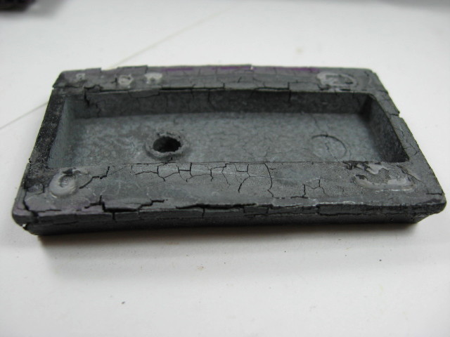

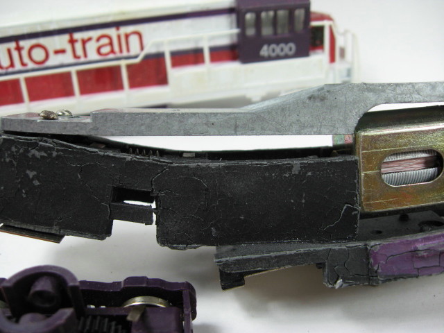

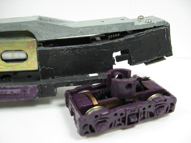

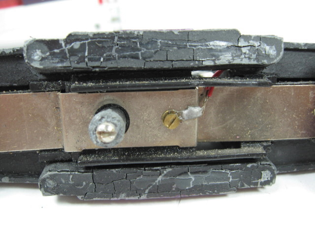

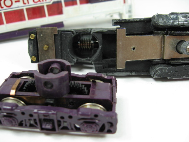

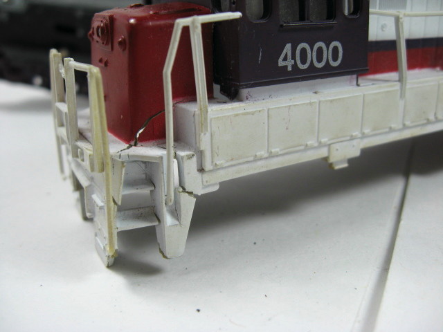

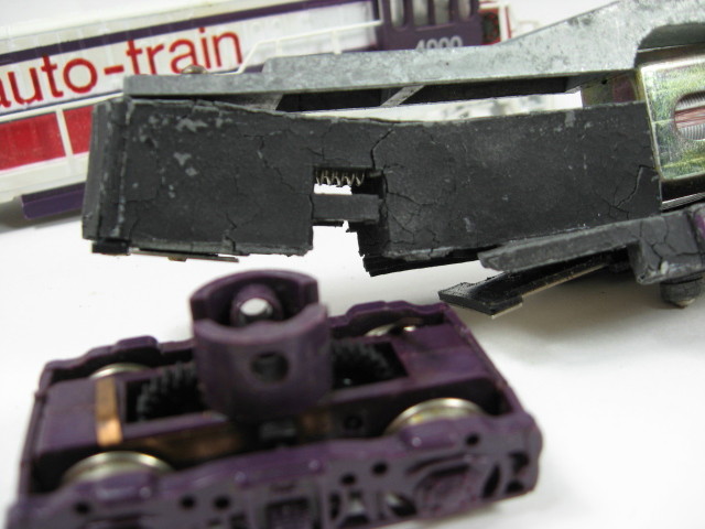

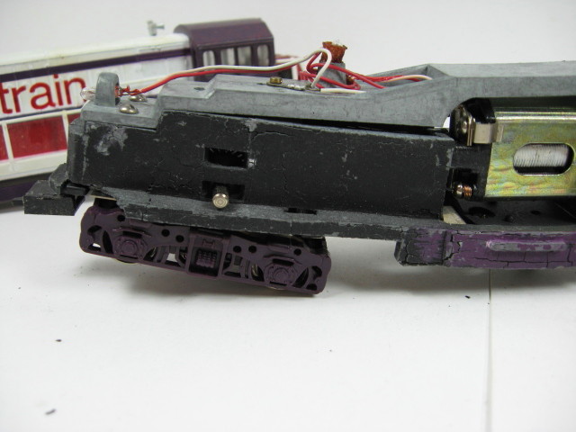

THIS WAS IN ONE OF THE TRAIN TUBS I PICKED UP - APPEARS TO BE BRAND NEW UN USED -DEFINITLY NOT USEABLE - MOTOR RUNS FINE - THIS IS SEVERE ZINC ROT / PEST. iT EVEN CRACKED THE SHELL ON LEFT FRONT STEP/PILOT AREA FROM THE STRESS FROM BOWING. THIS IS 70'S BACHMANN -SOME TYCOS HAVE HAD ZINC PEST - BUT I HAVE NEVER SEEN A TYCO BOW UP -THEY USUALLY CRUMBLED - THIS IS CAUSED FROM MOLD NOT BEING CLEANED PROPERLY DURING CASTING. BAD QUALITY CONTROL
FUEL TANK
SEVERE ZINC PEST / ROT
BOW- BOW- BOW- YOUR TRAIN -TIL IT BREAKS FROM STRAIN
STRESS WAS SO SEVERE IT POPPED THE REAR TRUCK COMPLETELY FROM CHASSIS
THE FUEL TANKS SCREW MOLD SHAFT WAS SNAPPED OFF FROM STRESS OF THE BOWING OF FRAME
LEFT SIDE VIEW - ALL OTHER PICS ABOVE WERE RIGHT SIDE
STRESS EVEN BENT THE WEIGHT UPWARD
THE SEVERE STRESS EVEN CRACKED THE SHELL ON LEFT SIDE AT STEPS AND HOOD/PILOT AREA

Zinc Pest is caused by lead impurites mixed in with the zinc alloys (Zamac for zinc magnesium alloys). I have some "brand new", in the box Varney stuff - an 0-4-0 shifter and a couple cars with Zamac weights that have the same thing. The 0-4-0 frame is a banana and the weights expanded and cracked the car bodies. The alloy recrystalizes and expands and eventually crumbles.
What usually happened is somebody got a "good" price on the Zamac (because it wasn't of good quality. There was a lot of this stuff in the 50s-60s when hard type printing was on the way out. A lot of companies (even Maerklin) bought lin-o-type metal when people stopped using it. It has lead mixed in to make it easy to melt and cast the type. It looks just like pure Zamac, but since you melt down the type from yesterday's newspaper and recast it for today's, life was never an issue with lin-o-type metal.
There's no cure.
Sorry for long explanation - I'm an engineer/metalurgist

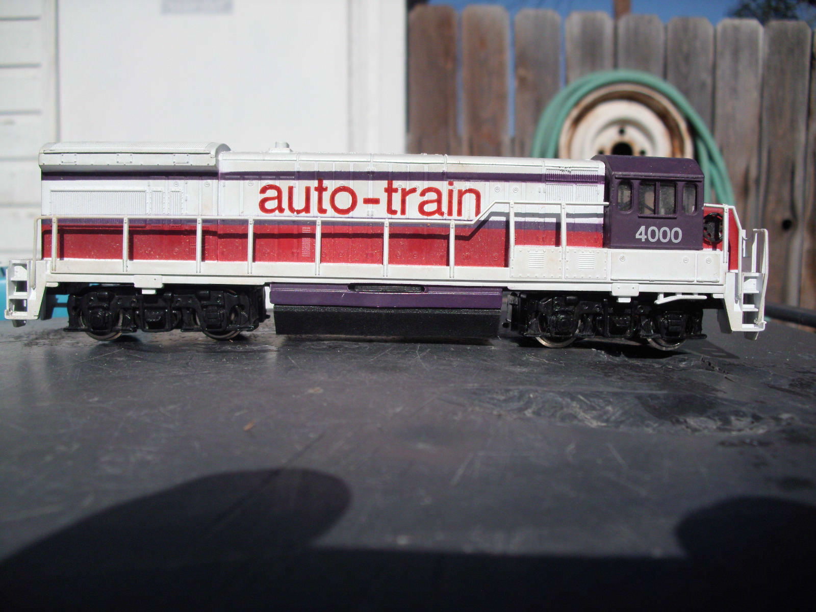

 Posted - October 20 2011 :  10:25:05 PM Link directly to this reply  Show Profile  Add microbusss to Buddylist
Ok here is mine with another chassis I think it looks good black & this chassis is only front drive not AWD
This is the same loco Brain sold me & thanks, man
