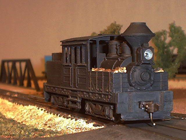

Hey Guys:
This of all my locomotives, is my Favourite:
It is the only piece I have left from my youth. I bought it in 1972 I think it was for $25. I still have the original box as well.
Last year the chassis went off to Ron LaFever in Paris, Texas for a rebuild and upgrade. The improvements include:
CHASSIS CONFIGURED TO YEAR 2001 SPEC'S. DRILLED/MILLED FOR HARDWIRING. (MDC had upgraded)
REGEARED WITH STOCK MDC GEARS.
ALL PARTS SMOOTHED AND POLISHED. PRECISION ASSEMBLED.
GEAR HOUSING SHAVED FOR CLEARANCE OF 321 MAGNETS, ROAD CROSSINGS, ETC.
ENGINEERING PLASTIC PROBLEM RESOLVED.
HIGH-TORQUE CAN MOTOR INSTALLED, MOTOR IS BRUSHLESS, SELF-LUB'D FOR LIFE.
MOTOR ISOLATED FROM FRAME - DCC COMPATABLE. A DECODER SHELF IS PROVIDED.
CUSTOM NWSL PRECISION BRASS FLYWHEEL INSTALLED.
NWSL #29 GAUGE (51 STRAND) SUPER FLEX STRANDED WIRE USED TO PROVIDE EIGHT- WHEEL POSITIVE VOLTAGE PICKUP.
EXTRA WIRE-LENGTH IS PROVIDED TO EASE MAINTENANCE AND LUBRICATION - EXTRA WIRE LENGTH TAPED TO MOTOR
JACKSHAFT WORM GEAR DIAMETER OF .310, .005 ABOVE MDC MINIMUM SPECS, FOR POSITIVE EIGHT WHEEL DRIVE.
BACKLASH IN BOTH TRUCKS EQUALIZED TO MAINTAIN FIRM CONTACT WITH AXLE GEARS
CHASSIS WILL CRAWL THROUGH PLASTIC FROG TURNOUTS AT LESS THAN 0.3 SCALE MPH.
TWO-OUNCE + TOTAL WEIGHT ADDED - (1.25 OZ ON CHASSIS, .75 ON SHELL) 25.O % TOTAL INCREASE. WEIGHT DISTRIBUTION CENTERED OVER BOTH TRUCKS.
KAYDEE #58 TRUE SCALE MAGNETIC COUPLERS INSTALLED
TWO YEAR GUARANTEE
Mine was the last one Ron LaFever built! He's now retired.

This is an MDC Climax I rebuilt.
Ray

OK, I can see the machining for the sake of machining but WHY use a CD motor? You muct have several "junk" motor's kicking around? Sure as hell your belt drive version must be quieter than the original Roundhouse one.

 Posted - January 24 2008 :  11:15:41 AM Link directly to this reply  Show Profile  Add Ray Marinaccio to Buddylist

Yea, I have all kinds of "junk" motor's kicking around. I figured if I used one then I would hear the motor noise since the gear noise would be gone. The CD motor makes no noise at all.

Hey Ray,
Got a question regarding that CD motor: What voltage is it listed for? Your photo looks like it says 5.9 volt. If that is true, how does it work at 12 volt? Also, where did you get that motor?

 Posted - January 25 2008 :  12:04:12 PM Link directly to this reply  Show Profile  Add Ray Marinaccio to Buddylist
The motor is 5.9V and was taken out of a CD ROM from an old computer. I just don't run it at full throttle. I have put voltage reduction circuits in a few locos using Zener diodes too.

 Posted - January 25 2008 :  12:12:19 PM Link directly to this reply  Show Profile  Add romcat to Buddylist
Hey Ray:
So the diodes act as a resister?
Whats the throttle response like? As a CD-Rom motor it's stepping motor right, so on throttle up is the response linear?

 Posted - January 25 2008 :  7:53:56 PM Link directly to this reply  Show Profile  Add Ray Marinaccio to Buddylist
Hey Ray:
Originally posted by romcat - January 25 2008 : 11:12:19 AM
The Zener diodes limit the voltage to the motor.
I'd have to draw a schematic to show you. There are a few ways to do it.
On way, From 0-6v of your power pack is used by the motor. Once the voltage reaches the rated voltage of the Zener diode (6v in this case) any additional voltage is dissipated through a resistor.
The other way, the first 0-6v is blocked by the Zener diodes from the motor (this voltage can be used for constant intensity lights) and the motor uses 6v and above from the power pack.
The drawback is that you are only using half the throttle and throttle response can be touchy with low end power packs.
I am working on an on-board PWM circuit but haven't gotten it all figured out yet.
The CD-Rom motor is the motor that opens the CD tray, not the one that spins the CD.[:p]
