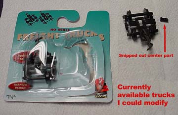

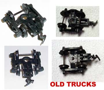

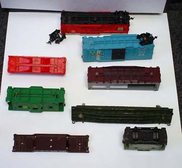

Most of the trains work, but I have about eight cars that either have broken couplers, or completely missing trucks/couplers. I'd like to get them working again and have been searching all over the place for these type trucks. They are the horn-hook type, but unlike the snap on replacements, these have a hole so you can attach via screws. (Please see first top picture). My father had converted some older cars to the horn hook style (see the red car in the rear of the cars picture).
I know I can take the currently available type trucks (Lifelike 1413 trucks), snap off the plastic pin, add some washers and attach (see my enclosed photo at bottom). But I'd like to see if there is any other alternatives.

The trucks in your first photo do look to me like plastic Tyco trucks. They are the good version with thin metal axles. The kingpin holes are for attaching them to the legacy (blue/redbox) era cars (think pre-1965) with screws... or the post-1965 tooling using scarce adapter pins. In the brownbox era, when these trucks were sold new on blister cards, the pins were included. In the early 70's they began using the molded-in kingpins.
A Tyco truck can be identified by the long, narrow coupler centering pin that extends from the back of the coupler pocket. Most other makes had a short stubby pin that extended from the front (Life-Like), or used a separate cap to hold the coupler in (AHM / early Bachmann / Lionel HO / Model Power / etc). Most Bachmanns used tiny, hard-to-find screws to retain the couplers.
Not all of these variants are interchangeable. In fact, few of them are. Your best bet is trial and error. Most other makes will NOT fit into Tyco cars... but sometimes LifeLikes will.... there's no hard and fast rule.
Of the cars in your second pic, the only one that looks like Tyco is the 4-wheel caboose... but this is a model that I'm not aware to ever use talgo (couplers attached) trucks. There should be some very narrow pockets for the coupler... you will need to find the cover and special spring that was used, which might be tough.
The other cars look to be a combo of Marx (now sold by Model Power) and possibly Life-Like, but I am not 100% sure.
You can try a few things to attach the trucks without kingpins: fill the bolster holes with putty... Or melted plastic styrene.... Or glue on some sheet styrene covers....THEN use a screw that fits.
Or look for a screw or pin or other scavenged parts that's an otherwise lucky fit without modifying the car.
Or once you identify who made the cars, you can also look for other inexpensive secondhand ones with donor parts.

As far as just the couplers are concerned, short of finding Tyco couplers, in a pinch, I've used Athearn couplers. True, the pivot hole is much larger than the Tyco, but installed in the coupler box, they actually work for me until I can find something better.
Ray Marinaccio
RayAvatar
 Posted - January 08 2008 :  11:06:02 AM Link directly to this reply  Show Profile  Add Ray Marinaccio to Buddylist
I have used Athearn couplers in the Tyco coupler boxes also.
I have also used the KD talgo adapter (the T shaped thing that comes with a set of #27 KD couplers) and the Athearn coupler on trucks that have broken coupler boxes.
I've cut off the tabs on L/L and other trucks, filled in the hole(s) in the truck, then drilled a new hole in the truck and then fit them to the car. It is a little bit of work but will get the car going.

Hi all. Well the solution is....Ebay! I searched and found a lot of these exact type of older trucks with the hole for mounting. Just like in my top picture.
Last night, I repaired most of the cars. Some I screwed on with some screws and washers I got from the local hardware store. Some of the cars which had the metal posts were even easier! I added a nylon washer as a small shim and snapped on the replacement truck. Done!
