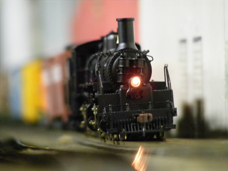

Here's a thread showing a rebuild of a Mantua 2-6-6-2.
I did some improvements of the electrical pickups on it and replaced the open frame motor.
http://www.2guyzandsumtrains.com/Forums/viewtopic/t=4859.html

Well tonight was good. Ever since I picked up my logger I noticed things weren't quiet right with it. It seemed like it always spun on the rails, sounded like someone rubbing two nickels together really fast. My life-like F7 would pull loads that would make the logger almost stop dead on the tracks. The logger has a factory can motor with a flywheel it should be able to pull lots of stuff easily. Also seemed like I had electrical contact issues every so often. Something didn't add up. Tonight while packing the engine up to take home I noticed how strong the springs were pushing the front & rear pilot trucks down. I set the engine back down on the rails and lightly lifted up the cab using my finger. With barely any effort the rear pilots helped me lift the rear drive wheels off the ground. So as a test I pulled the springs pushing the front & rear trucks down and set the engine back on the rails with a fairly heavy load behind it.
Engine had no trouble at all pulling the load. It sounded alot quieter since the wheels were no longer spinning. Also electrical contact was much better since the drive wheels were staying closer to the rails. We were amazed it was like a new engine in front of us. In fact we had probably the 2nd heaviest train load on the layout behind it (custom made real log cars haha) and it was moving right along. In fact I was having issues with the rear pilot derailing over a rough section of track, now it stays on. However without the springs pushing them down you'll notice the pilot wheels don't touch the ground all the time. So my mission now is to just find some lighter springs for the trucks so at least there is tension on them. Again I wanted to share, mine is new so maybe older ones don't have this problem. But I don't recall it being mentioned before. Driveshaft kit should be here this week, along with a few other small upgrades it should really be a good engine (finally haha). Here is a pic of it doing its thing, check out how the front is leaning as it follows the track.
