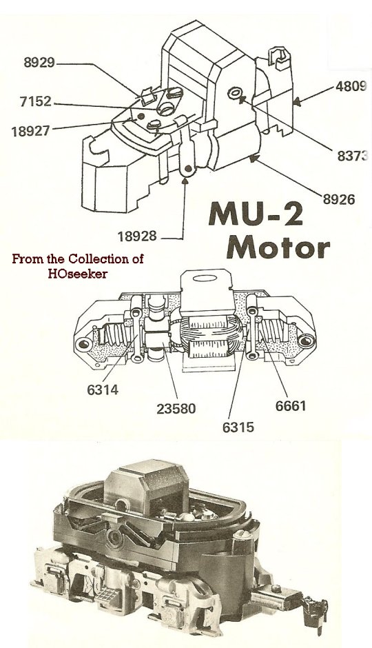

OK, you have an earlier Mantua MU-2 powered EMD GP20
Follow this link to see your motor and power truck:
http://hoseeker.net/assemblyexplosionMantua/mantuamotormu2.jpg
They are more than likely jammed from sitting for 20+ years. You can try getting the wheels moved manually. Try a set of needle nosed pliers and grip the wheel sides and try to rotate it slightly.
If this doesn't work, Ray M. will respond here when he goes through the list probably tonight. He's one of our best Tyco-techies.

I'd be careful about trying to manually turn the drive wheels. In my experience, they generally can't be turned at the wheel because the axles have a spur gear that is turned by a worm gear attached to the motor shaft, and you can't really turn a worm by turning the spur. What I would do is 1) clean the metal wheels on both trucks 2) try applying electricity 3) oil the motor bearings--which can be tricky--there are two holes in the bottom of the power truck through which to place the small stem of a hobbly oil bottle (like LaBelle). You kind of have to feel when you are touching the bearing area, kind of aiming the tube at an angle 'outward' at each lube hole, or else you'll get oil on the motor itself. You could also put a dab of oil on each axle gear. Hope this helps. If the loco is important to you, I've got tons of spare parts, and have worked on a lot of these. Let me know if I can be of help. Chris
