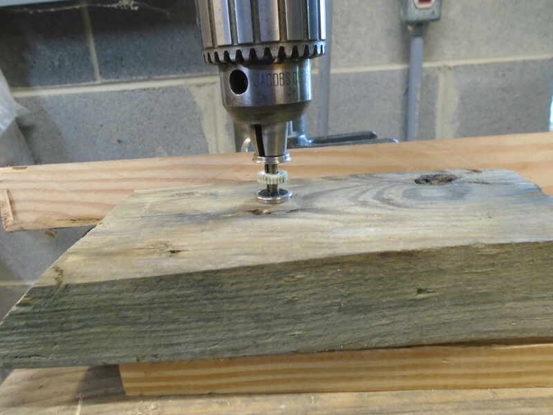

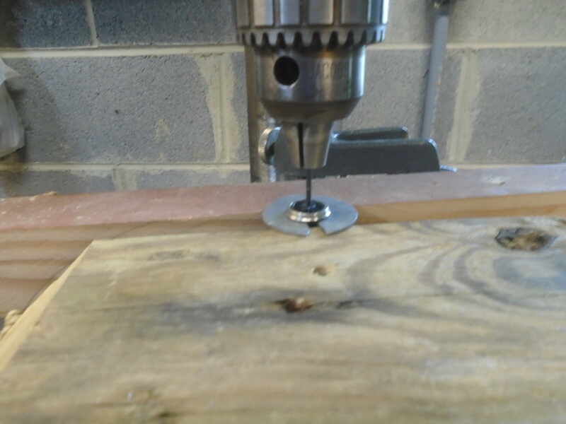

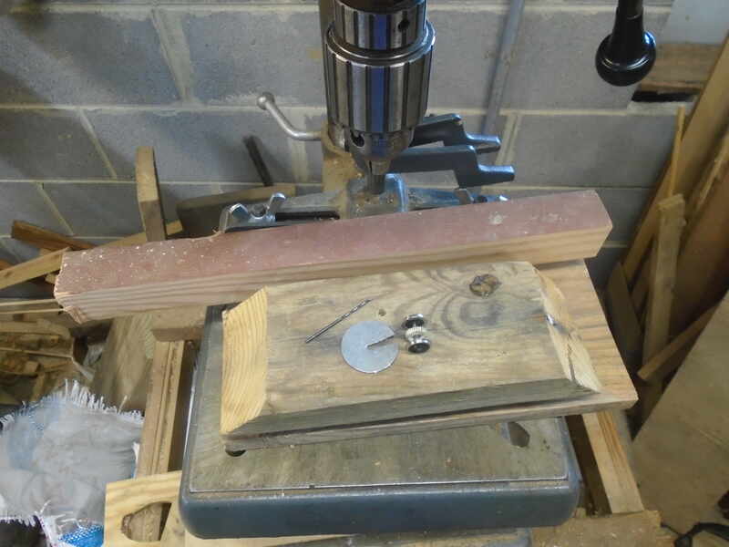

Most of my rolling stock is 60+- years old. "Tuning" all my axles using a NMRA standards gauge so that the wheel flanges are at the minimum distance has solved most of my problems. Flanges fit easily but snugly into the gauge notches. If there is any wiggle room then I press the wheels together for a precise fit. Steam locomotive drive wheels are a pain to press but I have improved tracking performance on the ones I deemed needing to be "tuned".
I use a drill press, a notched electrical box slug, and a 1/16 inch drill bit.
Narrower - the chuck is open to press on the edge and the axle can protrude
Wider - drill bit installed shank out

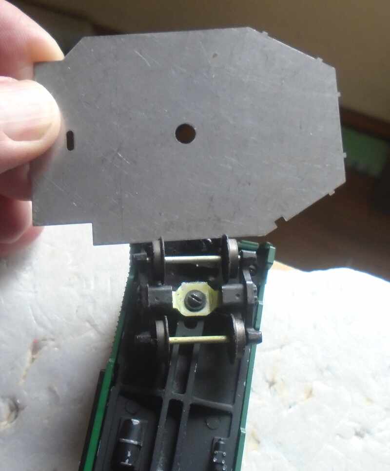

You are correct about flangeway width being too wide on most switches. In HO the proper width is also the width of a hacksaw blade so they make an easy guage. In the past I've successfully used strip styrene to narrow that flangeway, with some success. This works best on the switches with plastic guard rails. For me this is now a moot point as I handlay my own track, and can build it to the proper specifications to begin with.
