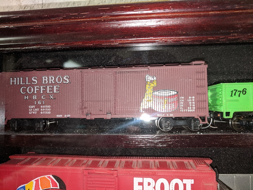

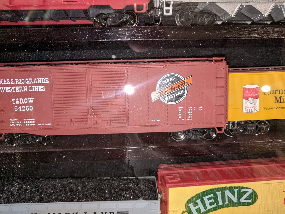

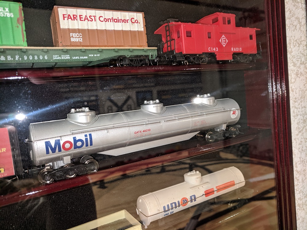

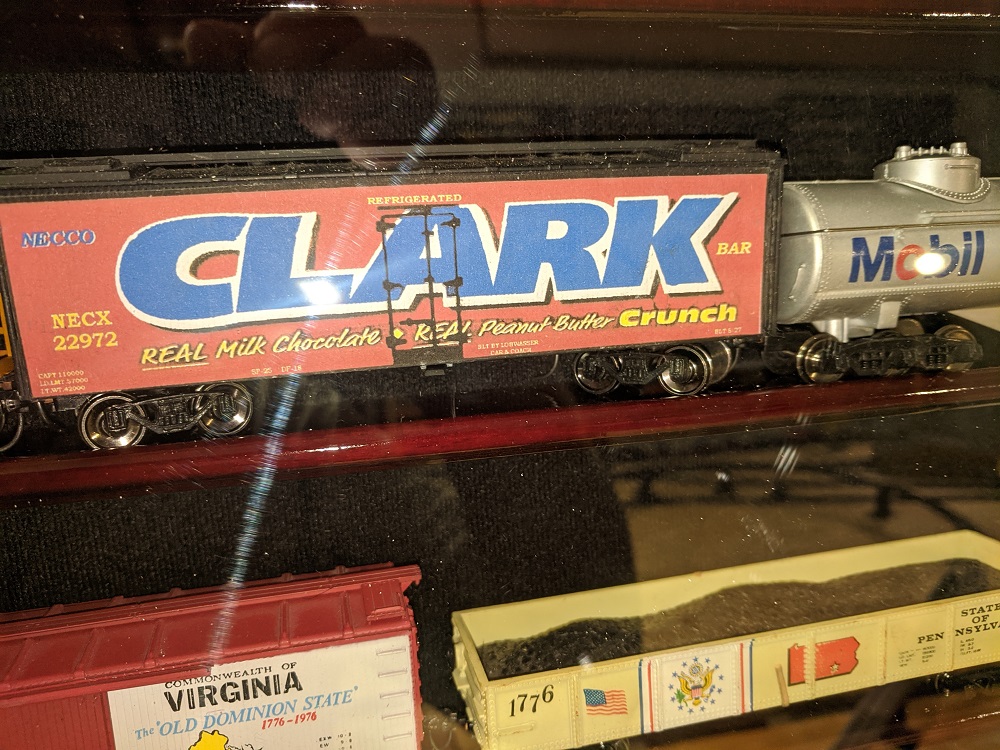

Here are a few photos from Jimmy's collection, taken before the battery quit.
Jimmy's collection is such that when I gaze upon it, I generally see something I didn't see before.
Jimmy really loves his Tyco six axle tankers, at last count I saw 24 of them! I'm not entirely sure,
but I think this Mobil is rare. In any event, definitely a major cool factor.

 Posted - April 14 2022 :  12:50:48 PM Link directly to this reply  Show Profile  Add microbusss to Buddylist
I'd like to find the Hills Bros Coffee & Clark Bar boxcars

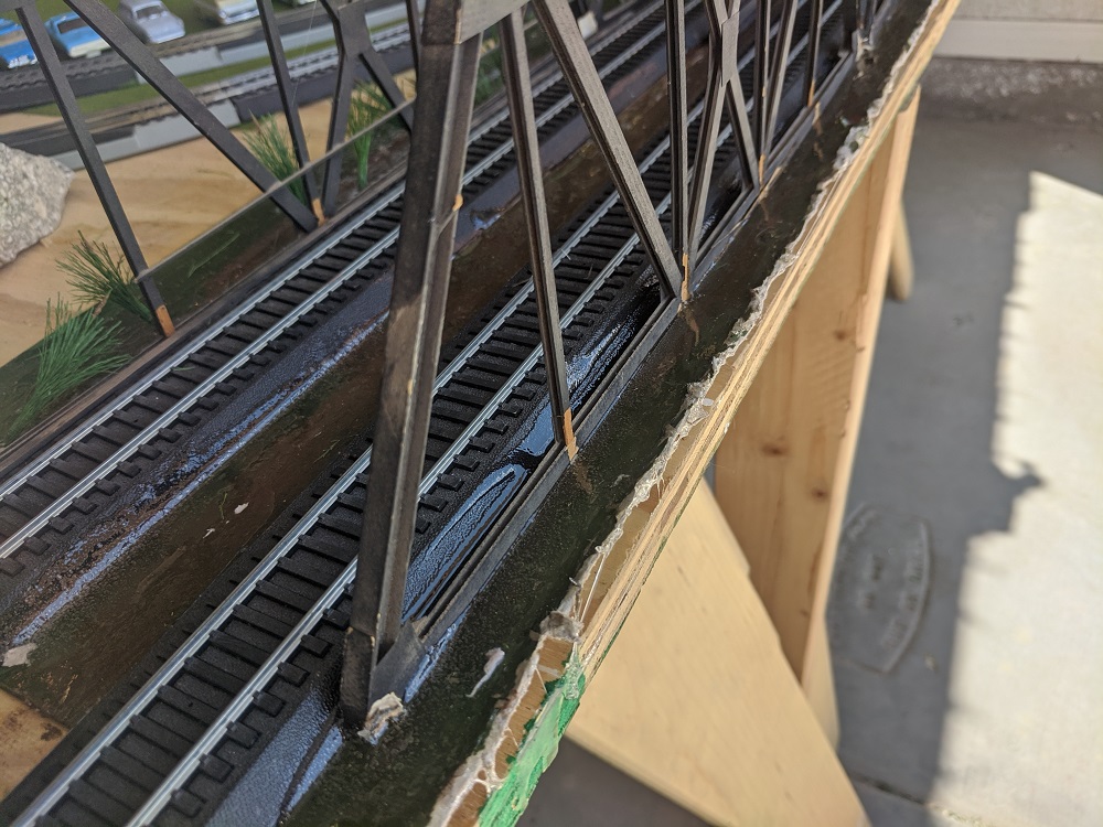

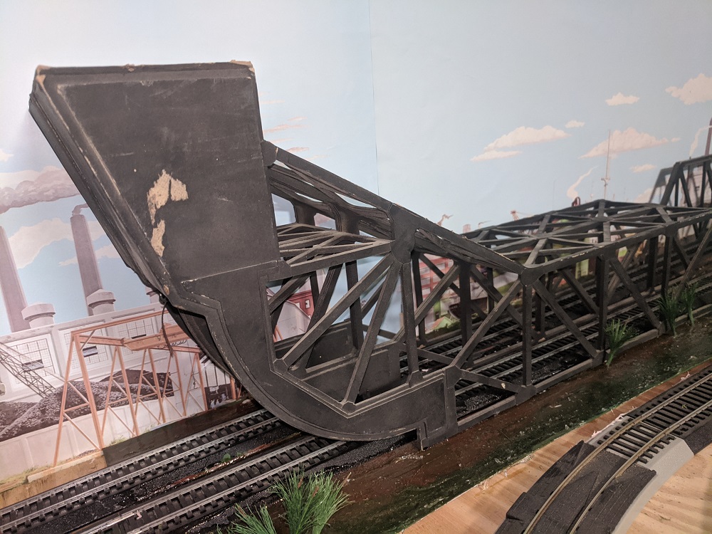

 Posted - June 14 2022 :  8:46:07 PM Link directly to this reply  Show Profile  Add Chops124 to Buddylist
Jimmy and I were laying in some water on his layout. Not a lot of room to work with, so we worked
with the concept of suggesting water, confined to an area perhaps not much more than six inches
deep, traversed by a draw bridge, and bounded by other tracks.
Using a thin layer of Clear Gorilla Glue, a layer was put down upon a painted sheet of poster board, using
cheap tempera paints to create a muddy green color one might find near an industrial area around NYC.
This stuff is more viscous, and hence easier to work with, than commercially available resins. It also doesn't
bubble.
The bridge was then set into the puddle and weeds added. The next day, we placed a Walther's back drop
to force some perspective, gluing it to foam poster board and a spray adhesive. This in turn was glued to
the baseboard edge, and affixed with some carpet tacks to hold it snug while the glue set. This turned out to
be surprisingly strong, although we might firm it up a little by some perpendicular extensions.
