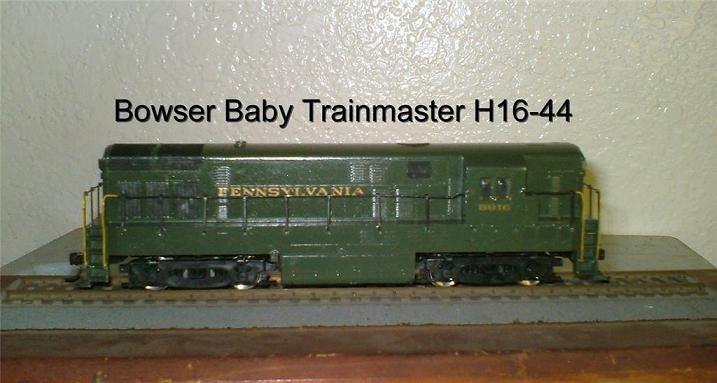

Hey Guys:
Show & tell for the big kids:
One of my favorite Loco's is a custom tuned Bowser/Athearn Baby Trainmaster that was tweaked a lot by an old Master Builder in PA:
OK, so whats special about it???
It has a tuned Athearn drive with the Athearn flat can motor and brass flywheels,
"Crystal Clear" cab glass,
MV lenses and Kadee couplers.
This is an all metal loco and weighing about 2lbs! on the rails.
It has been lubed and tested.
MODEL IS AIRBRUSH PAINTED AND HAS MICROSCALE LETTERING,
ALL STANDARD DETAILS AND RAILINGS ARE PRESENT,
CORRECT SMOKEY VALLEY C-LINER SIDEFRAMES ON THE TRUCKS WITH BRAKE CYLINDERS -
MOTOR HAS BEEN BALANCED AND POLISHED AND CLEARANCED
ERNST MACHINED GEARS ARE INSTALLED.
NWSL NICKLE SILVER DRIVERS THAT HAVE BEEN NMRA GAUGED.
IT IS IN THE ORIGINAL FOAM PADDED BOX.
THIS IS A PROFESSIONALLY BUILT, TUNED AND PAINTED LOCO. PAINT IS A "LIGHTENED" GREEN TO SIMULATE FRESHLY PAINTED AND SCRUBBED LOCOS IN BRIGHT SUNLIIGHT THAT I REMEMBER FROM THE 40'S AND 50'S WHEN 8 PENNSY TRACKS RAN THROUGH OUR TOWN NEAR ALTOONA.
Well thats it guys, and oh yeah, there is nothing in it's scale that it'll likely loose a pulling contest to save an all metal Steamer with more drivers. [:D] [:D] [:D] [:D] [:D]

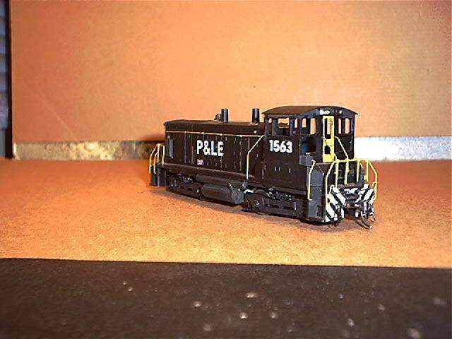

That has to be a great pulling locomotive Gareth.
I have an Athearn/Cary SW1500 I put together.
The drive is basically stock.
The electrical system was hardwired.
I added pilot details, railings, sunshades and a few other details before painting.

Nice EMD, what's the P&LE?

P&LE is the Pittsburgh and Lake Erie. It was a subsidiary of the New York Central System.

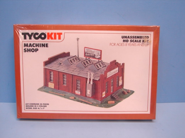

I also got a shrink wrapped Tyco Machine shop for $10.00!
