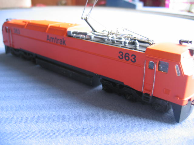

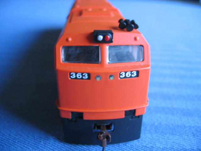

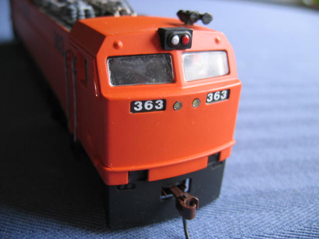

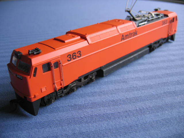

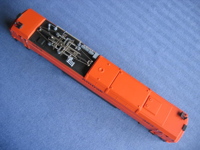

I finished the Amtrak MoW E60CP today. I have been working on the last few months. I had to do this over I think 6x. It was a black shell, to get the orange brighter I had to use a Testor's classic white enamel undercoating. I tried painting it with Testor's Mango Orange but the color wasn't right. So I went back to using Badger Western Pacific orange. This is not an enamel or acrylic paint. I used my Satin Dull Coat mix of Testor's Dull Coat/Gloss Coat finish. I had it completed earlier but I had a problem with the Satin finish as it did't come out right. So I did it over completely again. I have used it on all of my other MoW engines. This was a Walthers E60CP kit I got off of Ebay last year. I added has front and rear directional 2mm LED headlights. After these pics were taken, I painted the chassis flat black to make it look better.

Wow! love that e60. Sad to hear about bosco. He looked like a great dog. It's a shame that had to happen.
Hope you are feeling better!
 Posted - November 15 2019 :  3:40:34 PM Link directly to this reply  Show Profile  Add RP model railroads to Buddylist
What an incredible Amtrak locomotive! Excellent work!
So sorry to hear about Bosco, as he sounds like he was the perfect companion. :( Also, I do hope that you are somehow able to recover dexterity, because your kitbashing/custom work is absolutely amazing.

 Posted - November 17 2019 :  2:49:26 PM Link directly to this reply  Show Profile  Add microbusss to Buddylist
I could see Amtrak running this up & down the Northeast Corridor uses as a MOW train

get a second look at your great E60. Does it run on its
Bachmann PT motor? I ended up retrofitting mine with
a cut in half Athearn BB SD chassis. Fantastic model, but
oh Lord help us with those PT motors.

Originally posted by Chops124 - April 25 2020 :  10:34:17 PM
Thanks on my dog....
The E60CP is an American GK model. They originally used Athearn parts. It has an Athearn motor and directional 2mm LED lighting....
