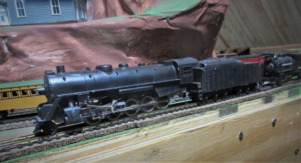

I own a Mantua 2-10-0 and never cared for how it looks. Has anyone reefer swapped in drivers from a 0-4-0/0-6-0? I think a lower driver height would look better than the taller drivers. Especially since one goes behind the fire box. Bluh! I'm sure I'll have to modify or swap the side rods as well. It's essentially a 2-8-2 with a added driver to the very back of the frame so the drivers are from a 2-8-2.

The side rods are keyed to the distance between the drivers, not their size, so if you plan to just drop the smaller drivers in the same frame, you should be fine with the old side rods. On the other hand, if you plan to move the drivers closer together, you'd have to change both the frame and the side rods.
Using smaller wheels would change the height, so the pilot would probably ride too low, and the drawbar and cab probably wouldn't line up the same with the tender, so some modification would be in order there, too.
