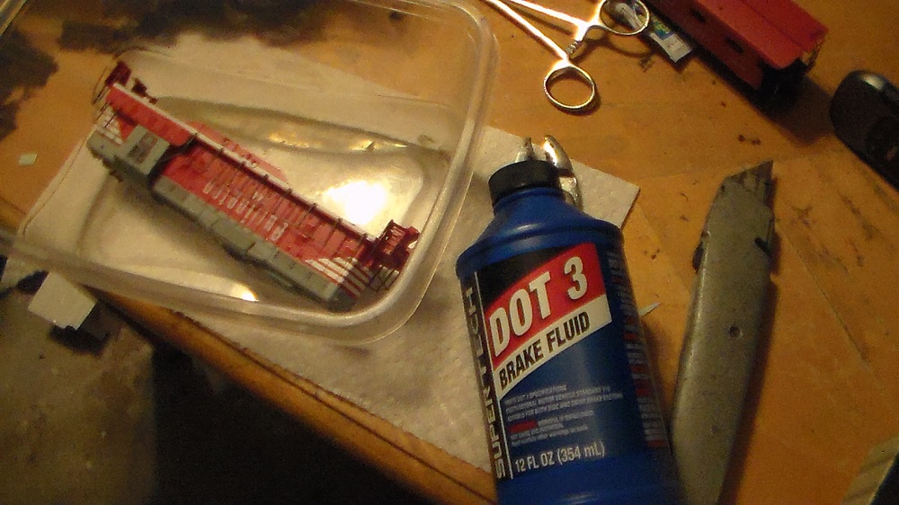

I bought some of the DOT 3 brake fluid at Walmart, and have been stripping the century 430 and booster.
It works!
It does take time, however. Over the past 3 days I have been at it. Hoping to finish today. I got an airbrush and compressor for xmas () and will hopefully be painting tommorow. I also got the model railroaded book on painting and weathering, so I'm all set to learn. I will be doing some mods to the 430. Stay tuned. The painting process will be posted here.
 Posted - December 26 2019 :  6:09:30 PM Link directly to this reply  Show Profile  Add Chops124 to Buddylist
I am looking forward to what you come up with. I find a
tooth brush helps a bit, usually 24 hours is enough to
rid most of the paint.
