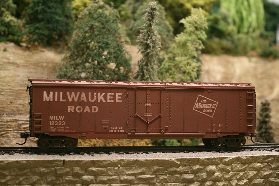

 Posted - January 04 2016 :  10:54:00 PM Link directly to this reply  Show Profile  Add Srenchin to Buddylist
Here are some examples of cars I have already completed.....
This car is a basic rebuild, Kadee Couplers, New Trucks, Repaint, Decaled and weathered.
This car is for GIC, this is how a Tyco BN boxcar should look!
This car has additional upgrades including new stirrups and extended cushioned draft gear.
This car features a sliding door from Accurail and wire grab irons.
The Frisco used ladders on all four corners of their cars, mine are from Accurail.
This car also uses an Accurail sliding door, note the use of roller bearing trucks.
By the time I made this car I had standardized with wire grab irons and stirrups.
All cars also feature Kadee brake wheels.
More cars to come....
Edited by - Srenchin on January 04 2016 11:20:19 PM

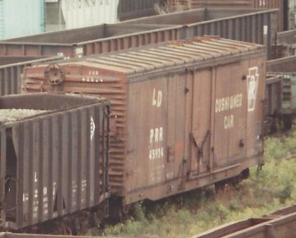

I found this picture in one of my photo albums, it's a cropped picture of PRR 45924 spotted at Conrail's storage yard in Altoona Pennsylvania in 1990. This particular car will make an excellent candidate for a Plugger project, note that the car ends are the original Dreadnaught style just like on the Tyco Shell...
Edited by - Srenchin on January 10 2016 4:21:52 PM
 Country: USA  ~  Posts: 822  ~  Member Since: December 26 2009  ~  Last Visit: November 20 2026 Alert Moderator  Go To Top Of Page
 Posted - January 10 2016 :  12:33:29 PM Link directly to this reply  Show Profile  Add Barry to Buddylist
Cool to find a photo to prototype your build.
Srenchin
CNRedAvatar
 Posted - January 10 2016 :  1:32:09 PM Link directly to this reply  Show Profile  Add Srenchin to Buddylist
Yes, PRR 45924 was built for this project! There are certain details that stick out for me besides the Dreadnaught ends (a huge plus, very few 50 foot cars have this style).....
1. The Modern style brake wheel
2. The side sill that extends to the end of the car
3. Square Stirrups
4. Post 1960 lettering scheme
5. Journal Bearing Trucks, (you can just make out the journal cover lids)
6. Brown roof, This is basically a "dip job" paint scheme
7. Plug Door
8. Grab irons on the corners rather than ladders
The one glaring difference this car has from the Tyco shell is the roof walk (or lack there of) but these were removed after this car's last trip to the paint shop. As a result, my model will represent this car as it would have been in the 1960's before roofwalks were banned.
Edited by - Srenchin on January 10 2016 1:34:59 PM

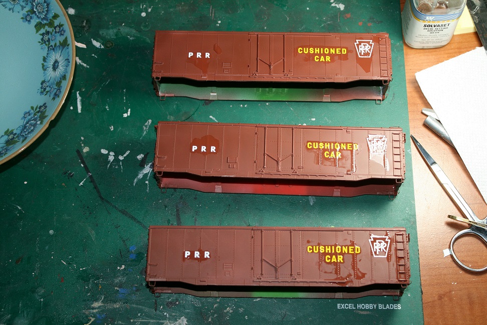

 Posted - January 10 2016 :  2:52:47 PM Link directly to this reply  Show Profile  Add Srenchin to Buddylist
Just tried to order decals for PRR 45924 only to find that nobody makes them, at least not in one easy set. I will have to kitbash decals from at least 4 sources in order to properly decorate a model of this car.
The Keystone emblem will come from a pre-1960 set. The older Keystone had shadow lines making the emblems look almost 3-D, but by the time this car was painted this effect had been dropped. Fortunately I can just trim the shadow lines off of the pre-1960 keystones to get a correct emblem.
The yellow lettering will come from a "cushion car" decal set.
The PRR reporting marks and numbers will come from a hopper car decal set.
The dimensional data will have to come from a generic box car data decal set.
Edited by - Srenchin on January 10 2016 2:55:59 PM

Good news for those of you following the progress of my model of PRR 45294, the prototype car has been preserved !!! You can actually visit this car at the Danbury Railroad Museum located in Danbury, Connecticut.
Check out the link below....
http://www.danbury.org/drm/prr45924.htm
I discovered this when I googled PRR 45924 looking for more pictures of it. Sure enough, several railfans have also uploaded pictures of this survivor. I see that Conrail put roller bearing trucks under it to get it too the railroad museum (probably for interchange rule reasons).
I for one am happy that the preservation movement is focusing on old freight cars, often times lowly boxcars get forgotten in the rush to save locomotives and passenger cars.

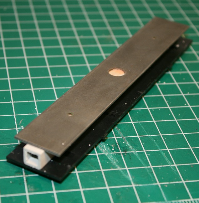

In this post I will describe the modifications I make to the Tyco Frame.
This is what the Tyco plugger frame looks like before modification...
Start by removing the sheet steel weight.....
Remove all mounting lugs on floor of the frame and file smooth so that the frame will lie flat when turned upside down....
Now that the frame can lie flat, chisel away the center sill detail that will interfere with mounting a Kadee coupler draft gear box....
I then use a quarter inch drill bit to open up the original truck mounting hole on the body bolster.
After opening up the bolster holes, use quarter inch diameter round styrene plastic rod to fill the bigger hole...
Then trim the plug and file smooth....
My next step is to add a "stiffening" sill on the floor of the frame, this is done to add some rigidity to the tyco frame and to provide some extra material for the draft gear and truck screws to bite into without needing to drill new holes in the Tyco weight...
Then use Walther's "Goo" to attach the Tyco weight to the stiffening rod...
Lastly, trim back the shell mounting pegs clear the hole plugs on the modified car shell.
Now the frame is ready for new trucks and couplers....

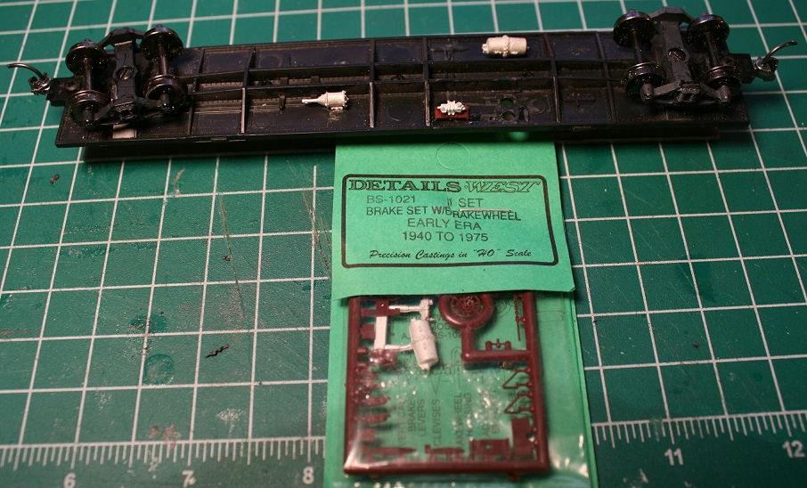

In this post I will show the basic remodeling of the air brake details I do on my Tyco Frames. These modifications are important if you plan on running your cars on a layout that provides an "eye level" view of your equipment.
Now before I go on I have to point out a mistake that Irv Athearn originally made and practically all other manufactures, including Tyco, faithfully reproduced when cribbing off Athearn's work...
THE AIR BRAKE DETAILS ARE PLACED BACKWARD!!!
The mistake was a natural one of course, schematics of freight car air brake systems are usually drawn from a prospective above the installation. I.E. As you would see the parts laid out if you could see through the floor of the car. Unfortunately Mr. Athearn assumed that the schematics were drawn from a view of what you would see if you simply turned the car upside down. The general rule of thumb to remember, the air brake piston cylinder (the apparatus that has a cone shape on one end) must be located on the hand brake side of the center sill with the cone shape pointed toward the hand brake.
Fortunately this problem is easy to fix with an AB Brake System set by Details West. Similar parts are also produced by other manufactures.

In this post are pictured some of the decal sheets used for this set of cars....
and decal application in process....
Srenchin
CNRedAvatar
 Posted - January 20 2016 :  1:19:17 PM Link directly to this reply  Show Profile  Add Srenchin to Buddylist
In this post the decaling of the PRR cars is almost finished....
I had to use several different decal sets in order to finish these cars, the most unusual was a Louisville and Nashville box car set from which I got the "LD" lettering above the reporting marks. (The L and D came from a "Dixie Line" slogan). Unfortunately I did not have enough L and D letters to finish all three cars so this set is on hold until I get more decals.

In this post, I we will cover weathering and final assembly. Since I am waiting for decals to finish my Pennsy cars I will shift to my Soo Line Plugger to demonstrate the final phase of rebuilding....
In this photo, the car has just been decaled...
First step is to give the car a light mist of paint, this helps blend the decals into the side of the car...
Next step is to coat the car with weathering chalks, these are the colors I used....
Next step is to brush the chalk colors on the car, note that I use a mixture of colors in a single application....
Next step is to seal the weathering chalk and Decals with a light misting of Testors "Dull-Cote", note that much of the weathering chalk disappears in this process, if the car looks too "clean" apply more chalk and then Dull-Cote again....
Next step is to add the trucks, if the trucks have oil-lubricated journal bearings, paint the wheel faces with thick black paint to represent leaked oil....
Once your trucks are finished, its time to perform final assembly. Next step testing the car on your layout!!!
At this point the car is essentially finished, however I like to make sure the car is properly weighted to conform with NMRA standards. I will discuss this in my next post....

Feel free to experiment with different products to test the effectiveness of sealing decals and weathering chalks. I use Dull-Cote because I am familiar with the product and know it works. If you are going to experiment with other products I recommend that you perform your initial testing on plastic scrap materials rather than on a model that you have invested time and money into!

I prefer to use a spray can for my Dull-Cote applications.
