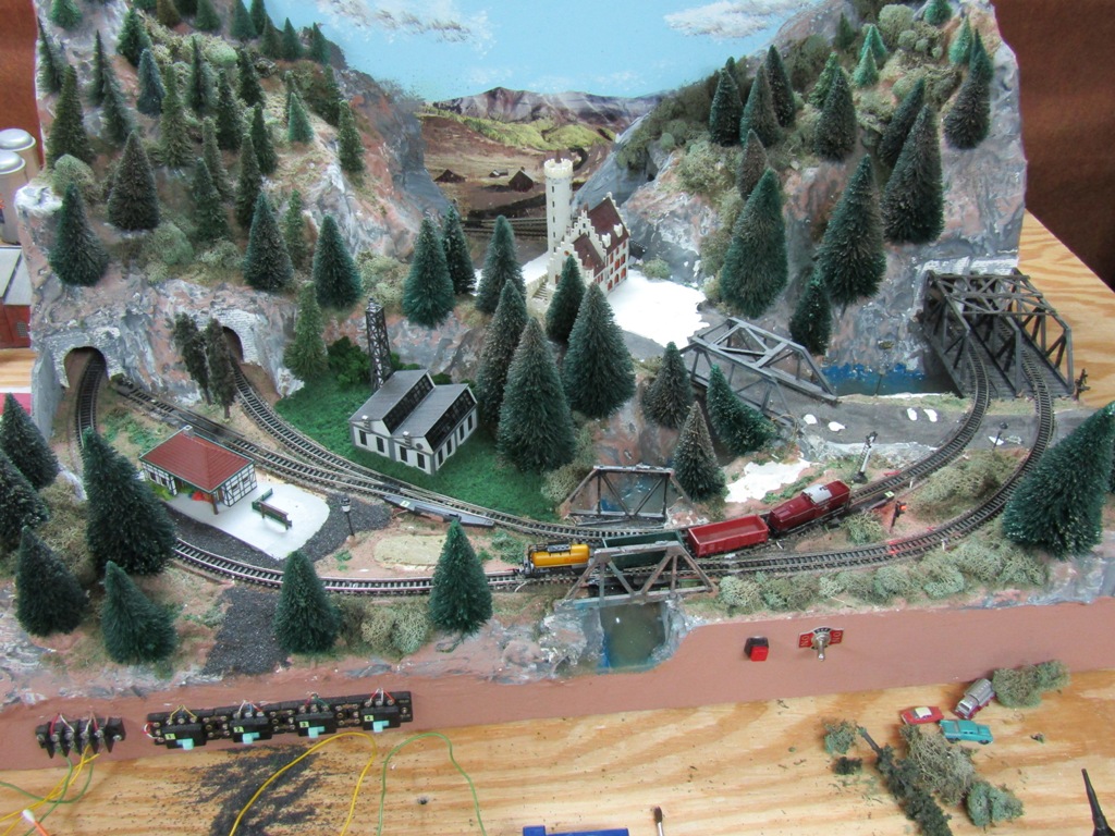

Even after cleaning all track well on my N-Scale Alpine Railway with rubbing alcohol, I still am having issues with my trains shuttering when running over the switch tracks....all 4 of them to be exact. Is there any way to fix this problem? I already checked to make sure the switch tracks were secured-down good enough, which they all are.

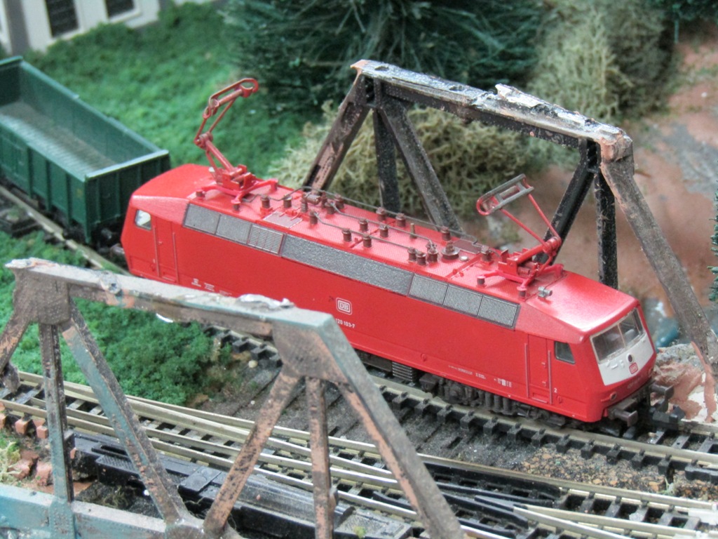

Here's a photo of one of the switch tracks on the Alpine Railway...technically there is still a plastic slider, but the switch track operates both electronically and manually. This particular one and another one on the layout are not working for some reason. Still working on deciphering that. But, as I mentioned before, some of my trains still stall over the functioning switch tracks as well.
It is happening to all of my N-Scale German locomotives (2 Fleischmanns and 1 Minitrix.) All 3 locomotives have fairly clean contact wheels, and the track itself is quite clean.
As far the rail joiners go, they are all tight-fitting, although there is some slight gapping.
The switch tracks themselves do indeed close tightly up against the rails, so that's not the issue.

A couple of possibilities occur to me. It appears, in the pictures, that the switch frogs are plastic and therefore not powered.
1) If your engines are designed so that each truck only picks up from one rail, you could stall when the wheels that pick up power are on the plastic frog.
2) It may be that, even if your engines pick up on all wheels, you could have a problem if the points are not getting power to them, for example if the hinged part is old and loose.

It's the plastic frogs that are the problem.
You need to add electrical pickups on your locos or go to a powered frog setup.

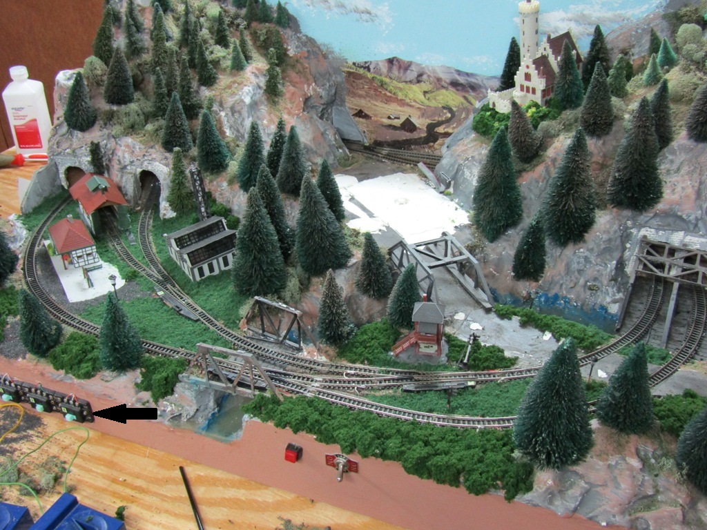

I thought mine already were electric, as they are controlled electrically through switches on the front of the layout (as seen below).....as I said, 2 of them are not working properly yet.
