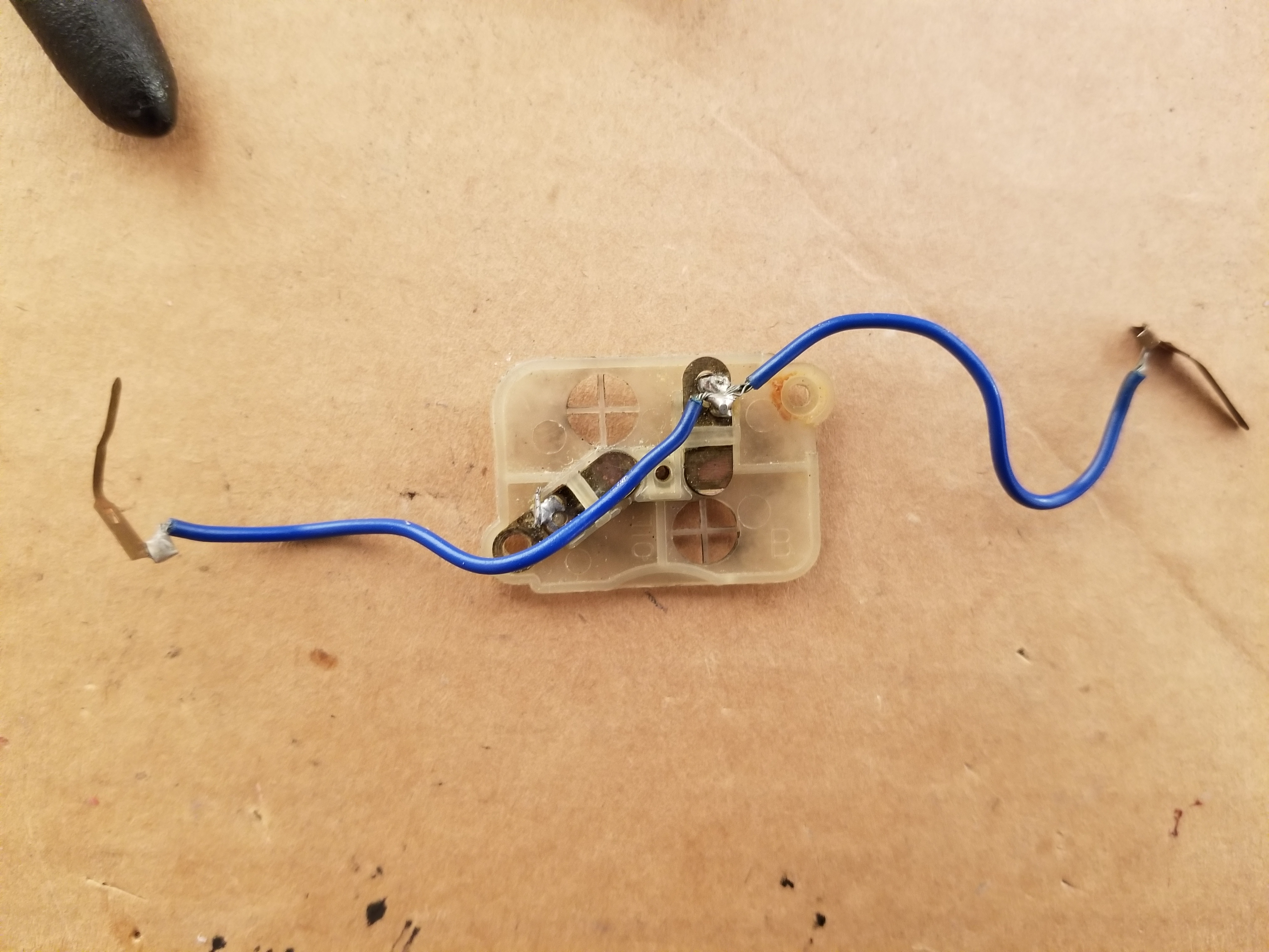

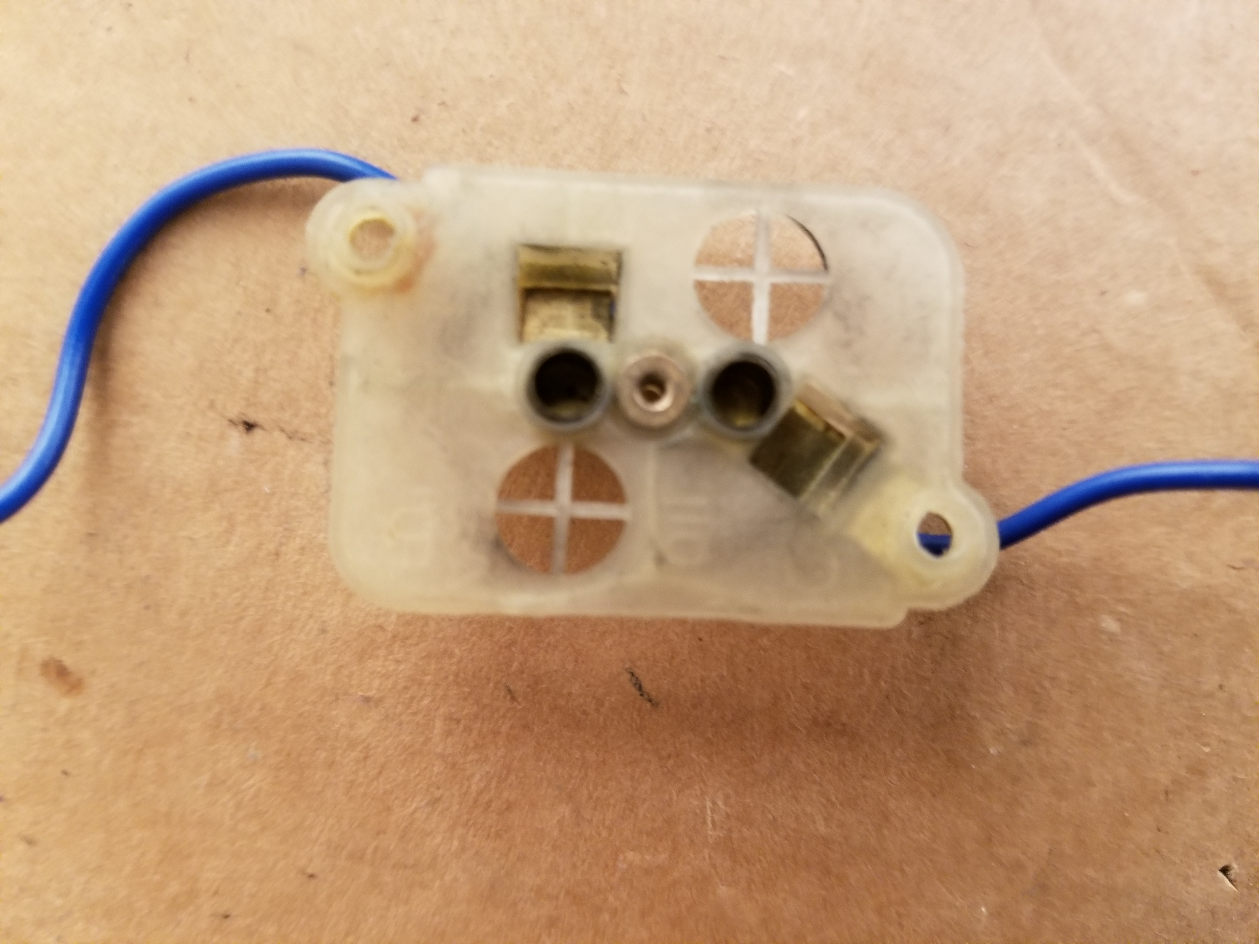

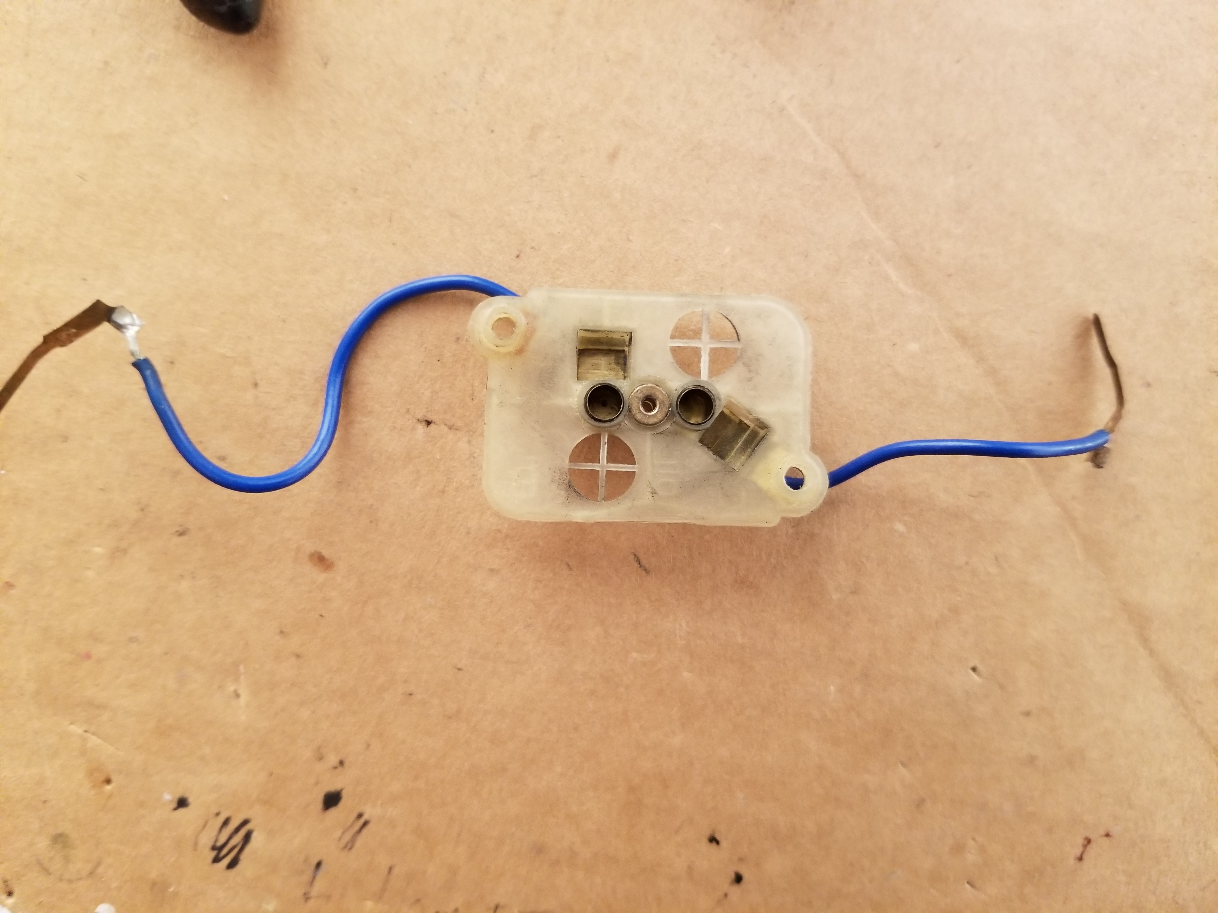

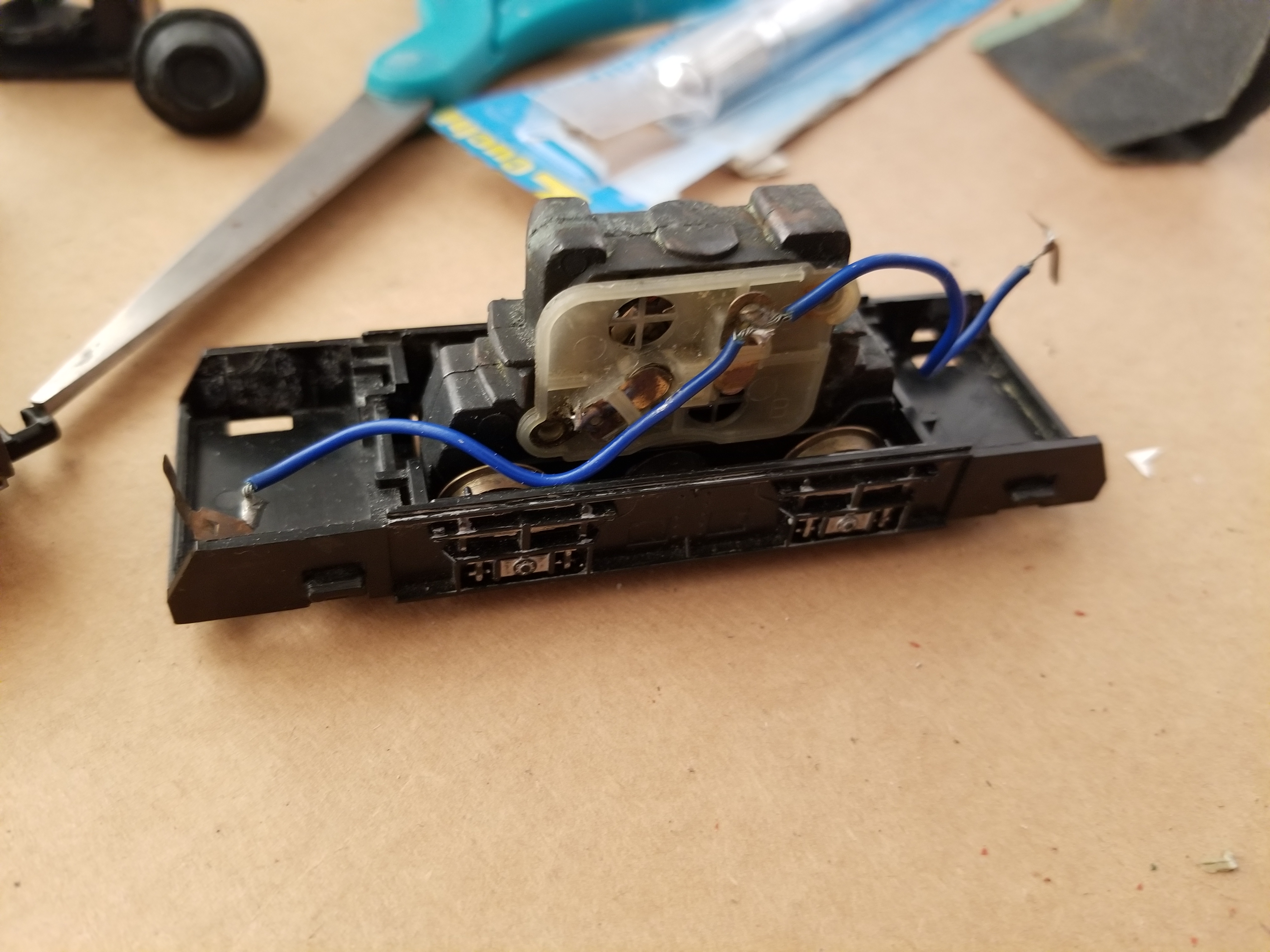

Just as it sounds, I am restoring this old tyco Plymouth switcher (It's the Transformers one, with the radar dish, but without stickers) And it was one of my first locos that I got at my first train show way back when. My dad really likes it because of the radar dish so I decided to pull it out of my 'shops' and try to restore it. I've fully cleaned it, but obviously, the carbon brushes are missing. No wonder it never ran before. Does anybody have replacements or know where I can get some similar carbon circles to fit?
Also, are those two wires to the pickups on the right spots? It doesn't look like there should be two wires on one joint. I think there should be one on each, leading to the carbon brushes.
Thanks Guys!
 Country: USA  ~  Posts: 1549  ~  Member Since: October 10 2019  ~  Last Visit: January 04 2024 Alert Moderator
 Posted - October 24 2019 :  6:08:13 PM Link directly to this reply  Show Profile  Add RP model railroads to Buddylist
You're 100% right - It should definitely be one wire soldered to each contact....not sure who did that, but that's another reason why it will not run.
As far as the brushes go, I think there are replacement brushes for sale on Ebay. (Upon tearing down one of my PT C430 motors, it had 2 copper brushes and 2 small copper springs that went into those holes) I do, however, have quite a few extinct Tyco PT motors that I might be able to extract brushes from, if someone else here can verify that any PT brushes are compatible with a Plymouth Switcher (as I don't know for sure personally, but would assume so.)

It may be more trouble than it is worth to fix that old Power Torque mechanism.
I would recommend finding a Plymouth switcher with a working MU-2 mechanism
and simply do a shell transplant. Good luck!

Yeah, Srenchin is right there. Say you replace the brushes and springs, and then the PT pinion gear pops off....that would be quite irritating, to say the least, after having put in so much work. But, it's up to you - if you want a more reliable Tyco Transformers Plymouth switcher (go with an MU-2 motor chassis,) or an 100% accurate one (restore the PT.)
