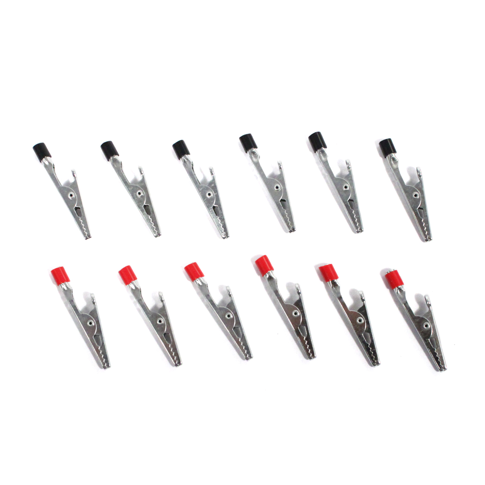

I easily made some testing leads with some clips I bought at radioshack(a pack of 10 is around $2), and some electrical wire.
I put a clip on each end of a wire, and I made 2 of em.
Here what the clips look like:
