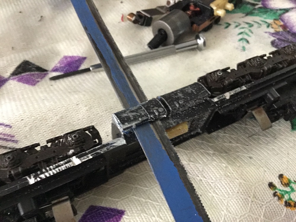

After trying to coax this NOS Bachmann PT motor into any sort of movement,
I gave up and went forward with the dreaded task of cutting this Athearn
SD40 chassis to be narrow enough to fit in the shell. I will also have to
saw it in half and divide the chassis, maybe staying with one power truck,
or devising a long, flexible drive shaft.
In any event, this stuff is harder than granite, certainly not zinc, I am
guessing steel. Wearing out to brand new hack saw blades in the process
of sawing the fuel tanks, and every now and then the blade slips, nicely
sawing my thumb or fingers.

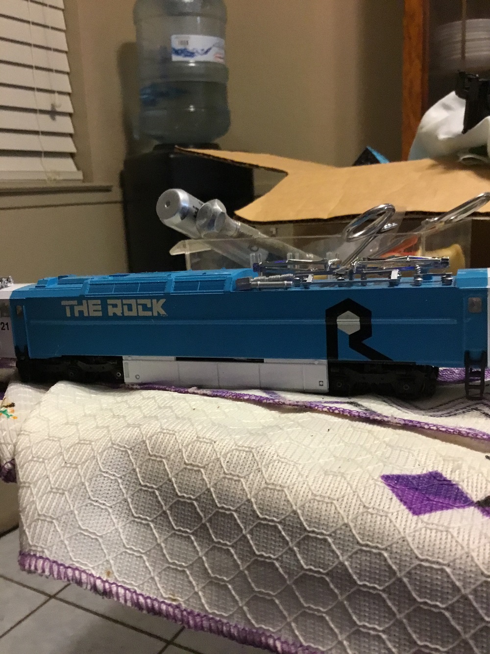

I'm pretty confident the design concept will work
once I get all the chunks cut off. That and some
JB Weld to hold the contraption together. It justs
frosts me solid that yet again, another
Bachmann with an impossibly unreliable PT motor.

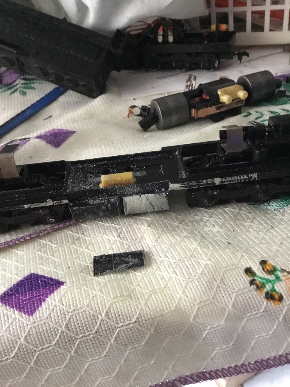

And the build goes on:
Now I've got the chassis narrow enough, the next issue is the length, which is way too
short. Going to saw off the back half, maybe I'll try to rig up a drive shaft using rubber
tubing, or maybe just leave it as a six wheel drive, which will probably be enough for
the light duty I have in mind for it.
