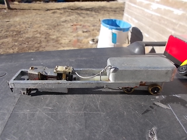

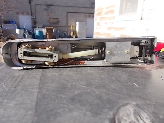

 Posted - December 29 2018 :  11:55:17 AM Link directly to this reply  Show Profile  Add microbusss to Buddylist
do you need a pic of the bottoms of my loco since it is POWERED?
 Posted - December 30 2018 :  12:46:20 AM Link directly to this reply  Show Profile  Add Chops124 to Buddylist
Please!
 Posted - December 30 2018 :  4:25:49 PM Link directly to this reply  Show Profile  Add microbusss to Buddylist
well since you used The Magic Word!
The motor is garbage since it runs slooowww even at full power!
you likes?
Edited by - microbusss on December 30 2018 4:26:54 PM
 Posted - December 30 2018 :  11:20:18 PM Link directly to this reply  Show Profile  Add Chops124 to Buddylist
Hooo, what a contraption! I am an eyeing a doodle bug chassis
for possible conversion. Thanks for posting.
