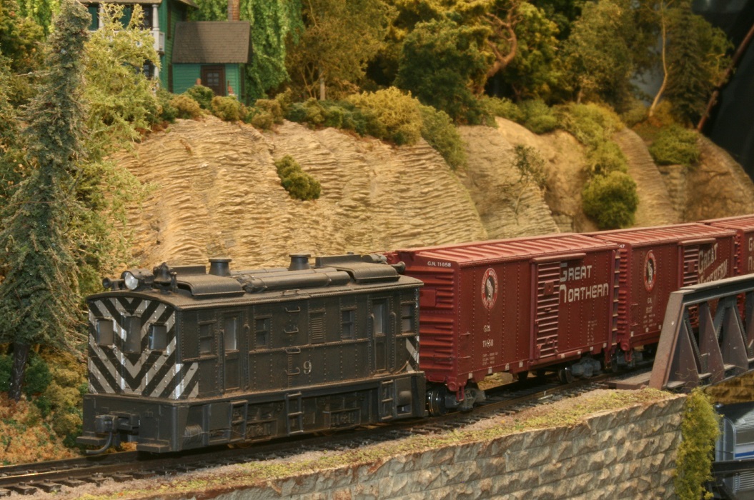

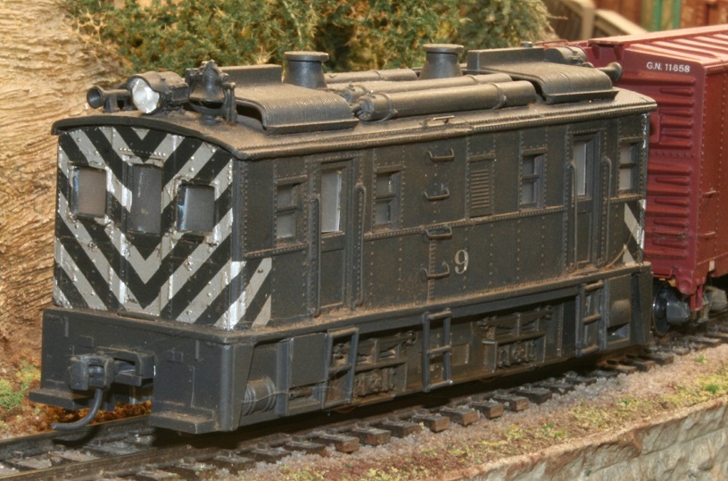

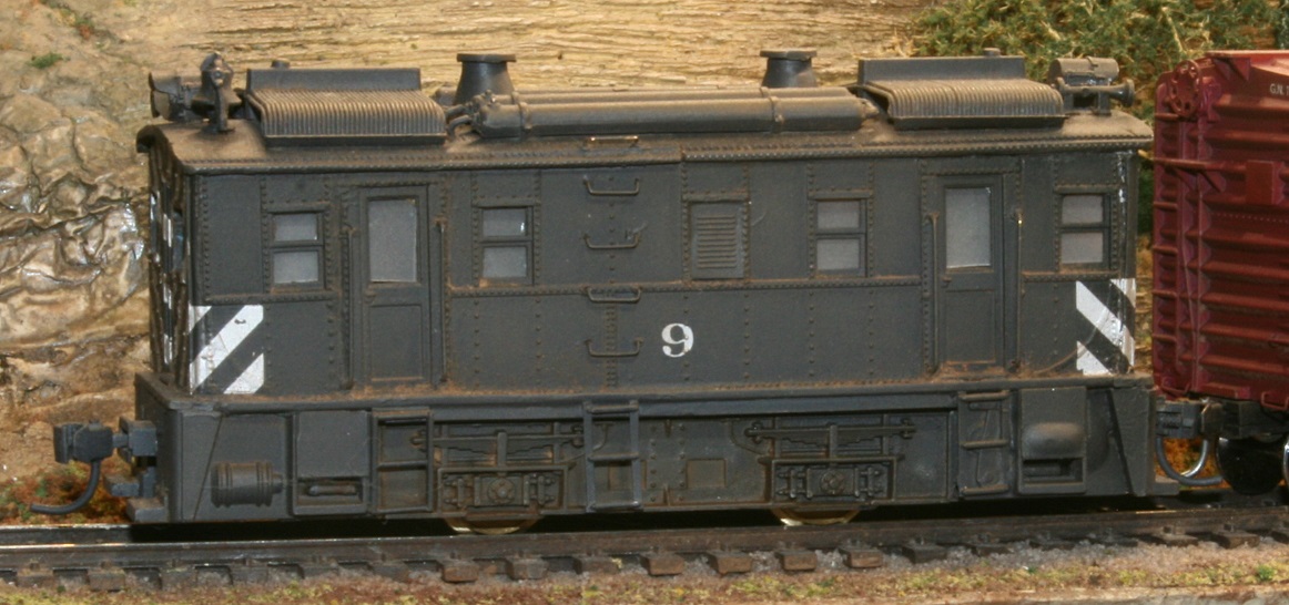

Below are some pictures of one of my latest Tyco kitbash projects, my Tyco Boxcab switcher....
The mechanism is from a Tyco Plymouth switcher and the superstructure is made from Santa Fe style steel caboose shells. If your interested in trying this project for yourself check out the how-to article in the March 1983 issue of Model Railroader.

Nice work, Srenchin!! Wow!
 Posted - December 26 2018 :  7:15:42 PM Link directly to this reply  Show Profile  Add microbusss to Buddylist
I want one!
tho I would add some modern touches to it
Like operating directional ditch lights for 1 hehe
 Posted - December 26 2018 :  10:22:45 PM Link directly to this reply  Show Profile  Add Chops124 to Buddylist
Me too! Me too! That is the BOMB!

As for the plucky Number 9, it is simply an old Plymouth Switcher with an MU 2 drive. The conversion into a box cab was started by removing everything above the frame and then building a new shell on top of it. The detail parts and the decals give the model some character.
Surprisingly it makes a good switch engine, all my turnouts on my layout have powered frogs so the four wheel pickup gives me little trouble. This little engine actually can run pretty slow so it does make a good switcher, of course as a true tyco at heart, it can run pretty fast at full speed too!
