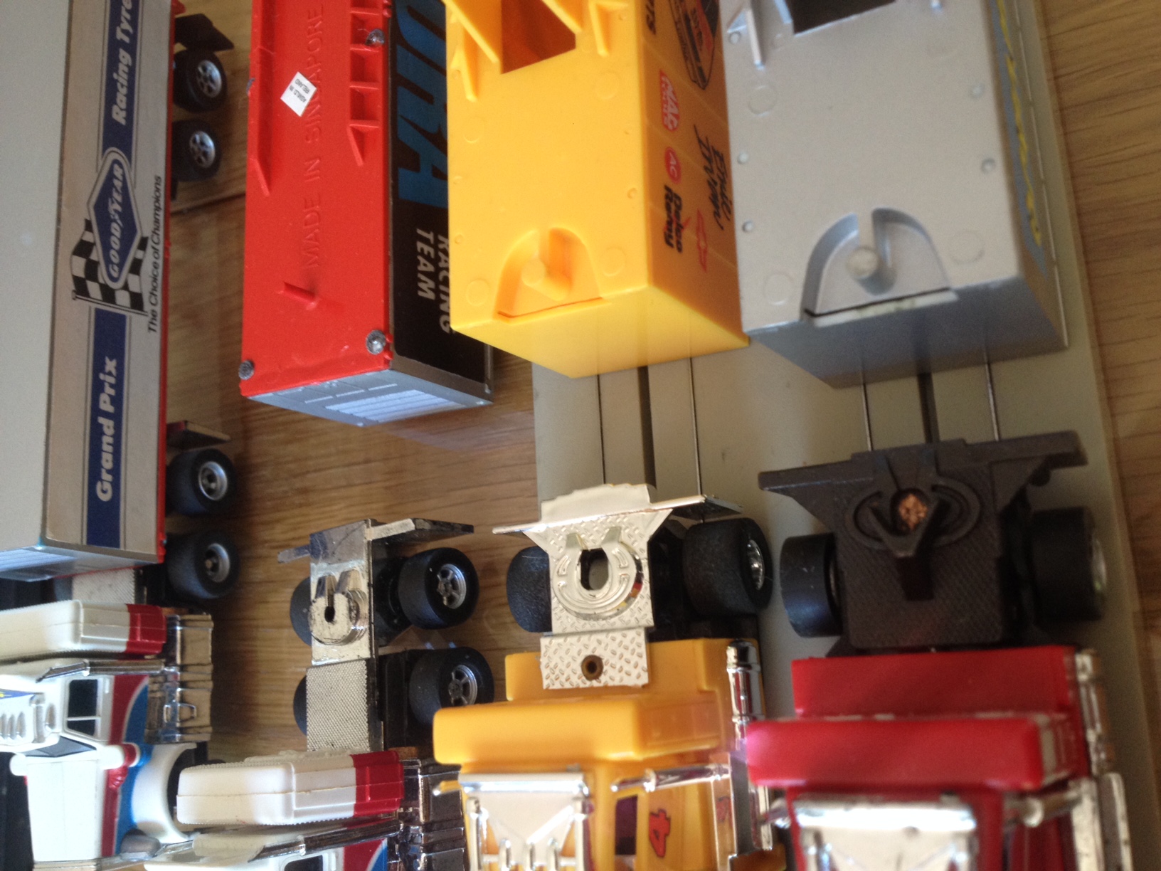

Having just dug out my magnetic rigs and trailers and then compared them to each other and US-1 I realised that my memory was playing tricks on me...
Picture one shows from left to right - Aurora, Tyco Magnetic and Tyco US-1 Rigs and the coupling arrnagements on the corresponding trailers.
As can be seen the Tyco US-1 and Non-US-1 trailers have the same coupling arrangement. The hole on the US-1 rig and the Tyco Magnetic Rig is the same size and they are therefore interchangeable. The Tyco Non-US-1 rig has only got pick ups and a guide pin at the front though, so it is not reversible. Also there is no guideway on the coupling, so automatic coupling to the trailer is not possible. I think that this rig is essentially the same as yours?
It was the narrow pin of the Aurora arrangement that I was thinking of when I replied yesterday. Sorry!

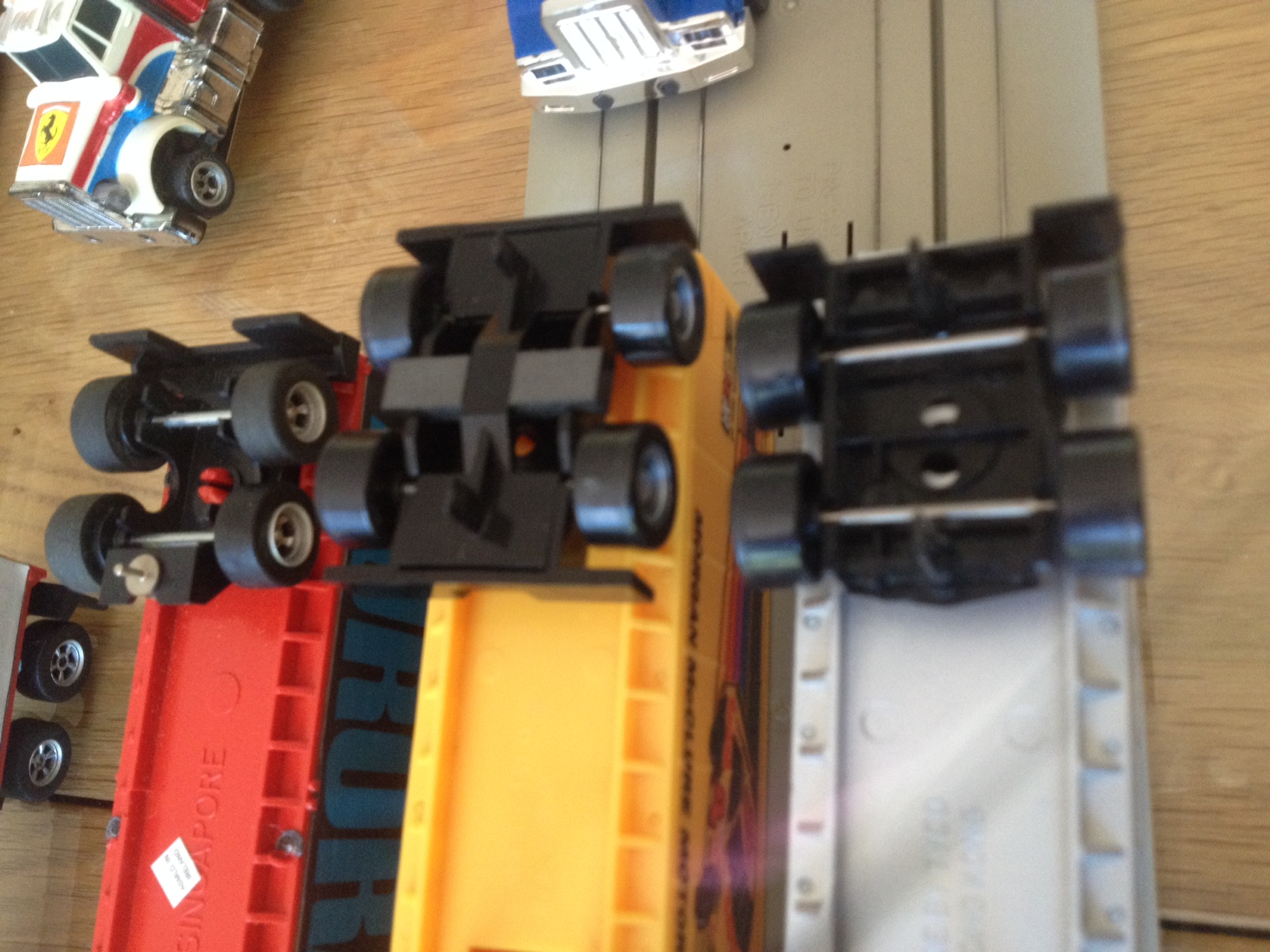

The next image shows the trailing bogies of the same three trailers:
Next image shows the bogies of the three tailers. Both Tyco trailers have two guide pegs and the non-US-1 verion has magnets too. The Aurora one has no magnet and only one peg, but the bogie has limited rotation, which coupled with the two guide pins on the tractor means that this can be reversed, but it won't couple or uncouple remotely.

However, herein lies the confusing part - your Kodak? Tyco non-US1 truck has a bigger pin-hole than both of my Tyco non-US1 Peterbilts.....(please see photo above) and the skinny pin-holes on my 2 Tyco non-US1 rigs look like they would better accommodate an Aurora trailer.....and do not work with Tyco US1 trailers (they don't have to work like going in reverse, or automatically-detaching - it's just that the trailer's pin won't even fit in the hole..)
Please Advise.

Pukka US Trucking Peterbilt tractor units do NOT have plastic third wheel assemblies, nor the facilities to take them. I.E. three holes on the flat horizontal area behind the sleeper, one for the central rivet and two smaller for alignment pins.
ALL other Peterbilt cabs -- those with plastic fifth wheels - are 'racers' not haulers.
The different sized holes in the plastic fifth wheels are age-related.
There are small holes in the early trucks plastic fifth wheels. These were contemporary with, or followed on briefly after, the US Trucking range at the time and were usually on HP7 or earlier chassis.
Large hole plastic fifth wheels came much later with proper racing rigs. These were mounted on 440X2 chassis and came with the Harley Davidson, Kodak, Du Pont, Goodwrench and KMart box trailers. There were matching NASCARs and a matching motorbike.
The earlier small fifth wheel hole can be drilled out. Remove the body from the chassis to do so.
Likewise, ANY of the plastic fifth wheels can be removed by drilling out the retaining rivet and the Peterbilt bodies sans fifth wheel can then be fitted on the appropriate US-1 chassis with diecast fifth wheel. I prefer to do this as the US-1 chassis brings all the functionality required to run and operate a Trucking 'service'.
There are further nuances on this but few and far between and I'd have to dig into my collection to find the odd exception.
One I've come across with the diecast fifth wheels is that the majority have blind holes to take the trailer pin BUT a very small few have holes right through the casting. I don't know why, as the trailer pins are all the same length as far as I've found.
The only thing I can think of is MAYBE it was a money saving exercise? Fractions of gramms of metal saved per unit but over thousands it could add up?

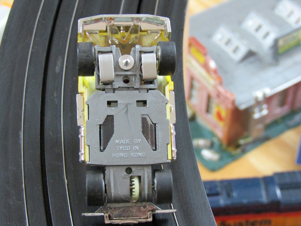

Can't tell which pickups you need without seeing the underside of the chassis. Those you show are for a late 440X2 chassis but your baby blue Peterbilt is most Likely on a Curvehugger chassis - quite different. Photos of the undersides please.

 Posted - June 19 2018 :  1:45:08 PM Link directly to this reply  Show Profile  Add RP model railroads to Buddylist

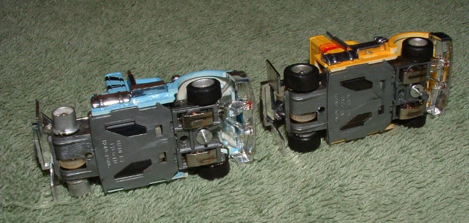

There's a photo of the undersides of both (credit to Ebay seller.) I do believe both trucks would be considered "curve-huggers" and both already had wear "slot holes" in the left pick-up shoes when I received them, so I know it couldn't be my slot track.
Of course, not knowing that much about slot cars, I ignored these holes, until a lightbulb of discovery went off when I began experiencing contact issues in operation.....

Would these be the proper pickup shoes???
https://www.ebay.com/itm/Hand-built-pickup-Shoes-Tyco-slot-cars-HP-HP2-curve-hugger-5pair-mild-stainless/263757982266?hash=item3d69336a3a:g:jKMAAOSwQN5aahdS
Top Down
 Posted - June 19 2018 :  4:16:49 PM Link directly to this reply  Show Profile  Add Top Down to Buddylist
Yes, those are the right pickups - and with a 'money back guarantee' you shouldn't go wrong with them. Be careful not to lose the springs from under the existing pickups when you change them - and keep the holed orignals to use as a pattern for final finessing of those hand made items.
Doug
Edited by - Top Down on June 19 2018 4:48:39 PM
 Country: United Kingdom  ~  Posts: 18  ~  Member Since: May 22 2018  ~  Last Visit: June 26 2018 Alert Moderator  Go To Top Of Page
 Posted - June 19 2018 :  5:03:27 PM Link directly to this reply  Show Profile  Add RP model railroads to Buddylist
Perfect! Thank you for confirming.

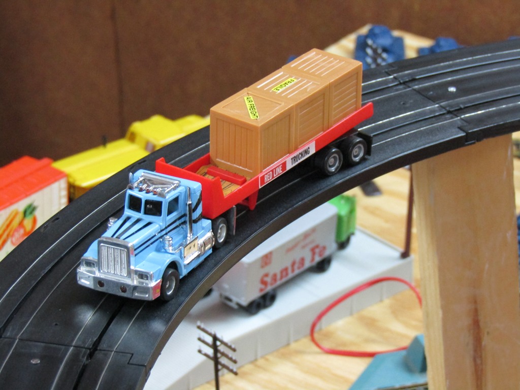

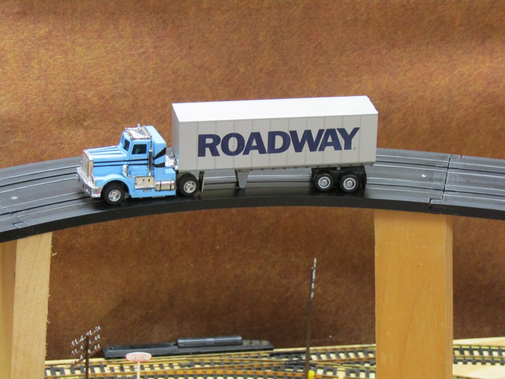

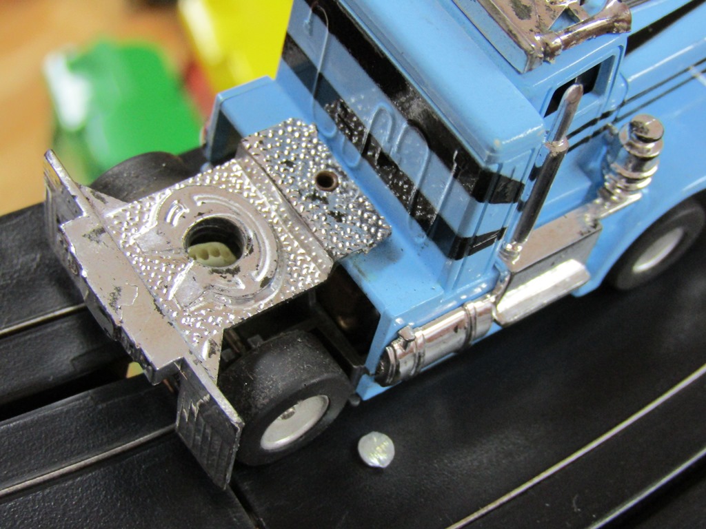

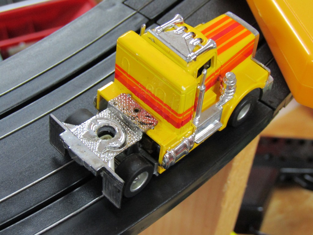

UPDATES:

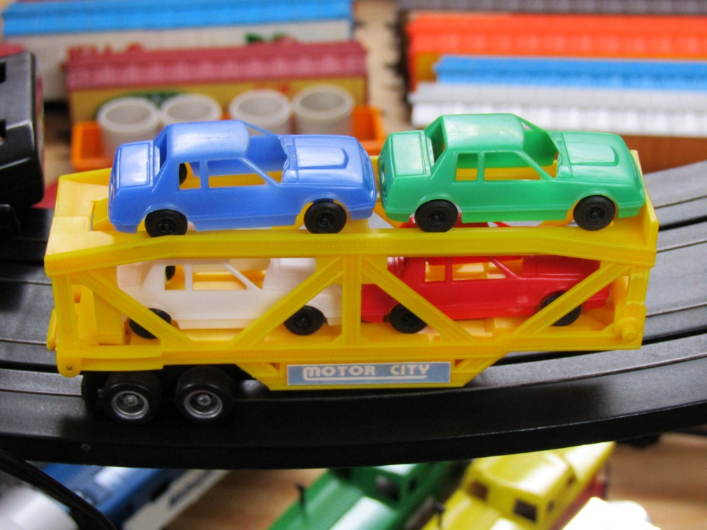

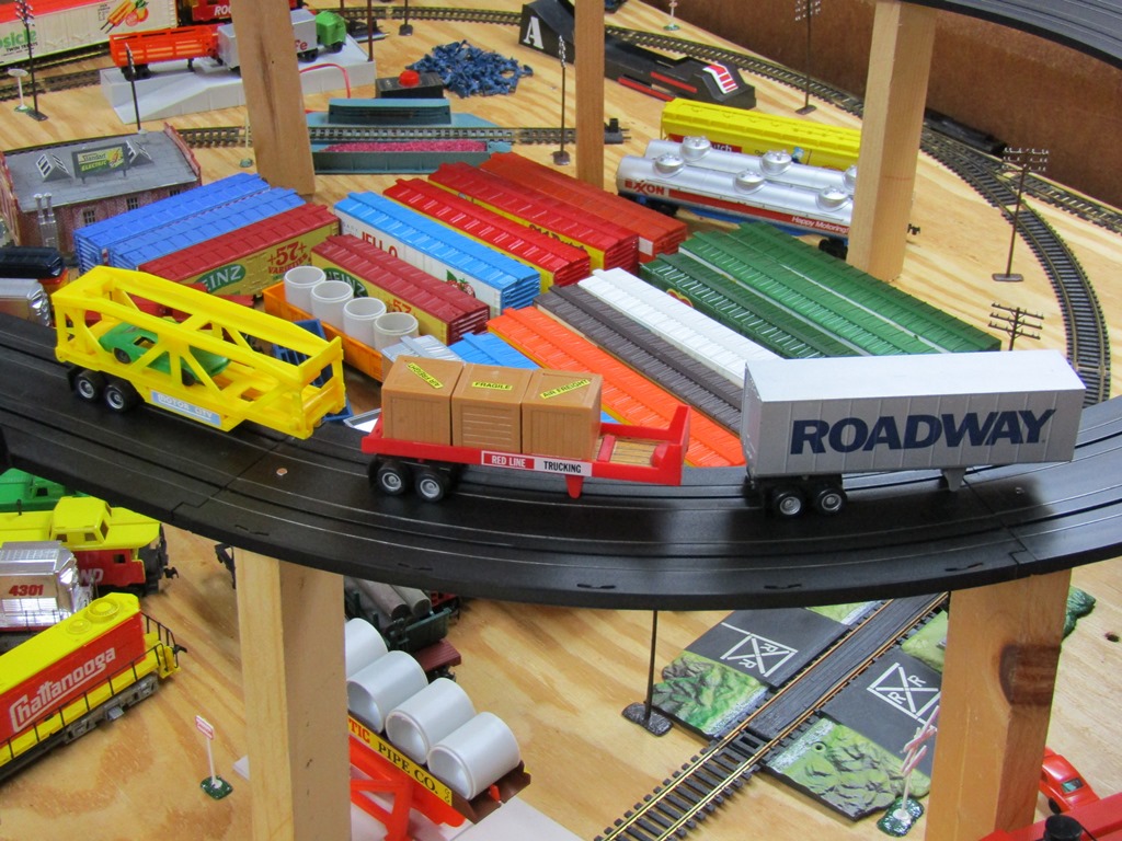

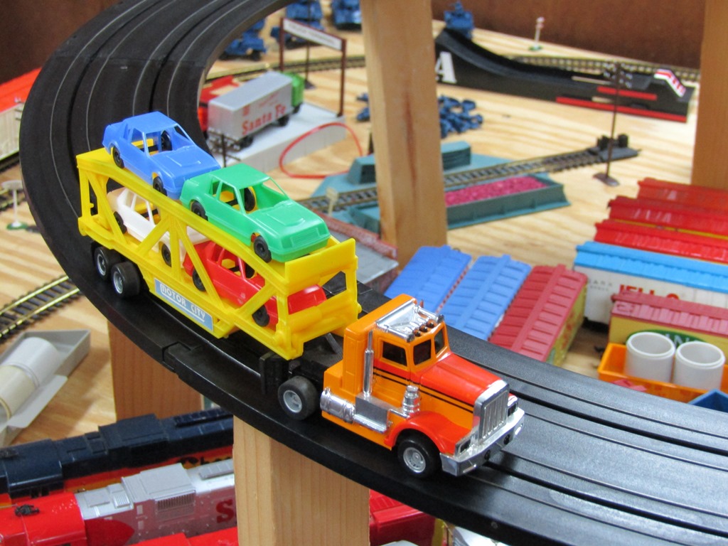

Received these 3 awesome Tyco US1 trailers in the mail today....I got the Car Carrier trailer for $15.00 even with free shipping, and both the Roadway & Red Line Trucking trailers as a pair for close to $30.00. I personally think I got good deals on these 3 trailers from Ebay...beings that just one can go for anywhere between $15.00 - $40.00, or more (as in the case with tanker trailers.)
First of all, I equipped my Car Carrier with 4 Tyco '80's era Mustangs....and the only truck it pairs with is my only "official" US1 Peterbilt -- the yellow/orange with black stripes one.

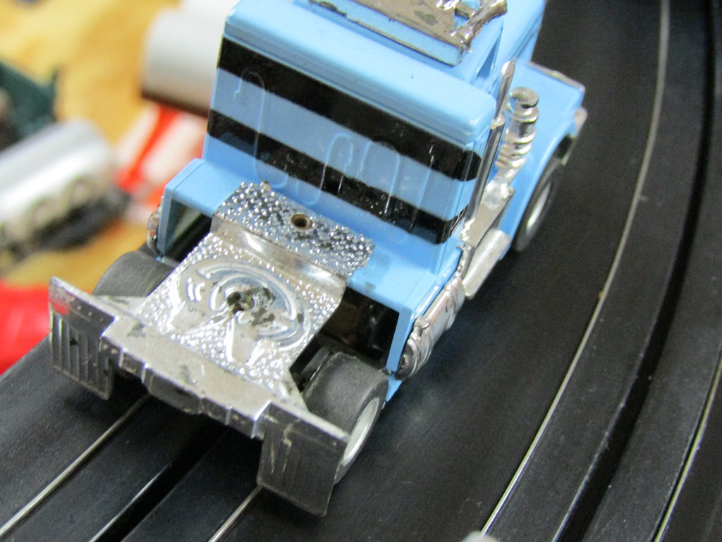

Now...if anyone was thinking I would settle for 2 of my Tyco Peterbilt slot trucks to be incompatible with US1 trailers, you were completely wrong. This evening, contrary to my former fears, I took the battery-operated drill and using the proper-sized bit, I VERY CAREFULLY drilled the pin holes in the back of my 2 Tyco slot trucks larger, and used a scalpel to protect the drill bit from striking the gears beneath. The result was a complete success, and although I do need to wait for new pickup shoes for the yellow Peterbilt, the blue one w. black stripes is now performing excellently at hauling trailers. Yahoo!!
What do you guys think? I think the drill job worked very well, in fact, even better and quicker than I expected.
Highwayman97
 Posted - June 20 2018 :  8:13:02 PM Link directly to this reply  Show Profile  Add Highwayman97 to Buddylist
RP
Good work and neatly done, but you can always unclip the body if you need to drill any more.
What lovely images!
What a nice collection too.
Those brown crates are nice too. Not got any of those, yet.......
How do you find the speeds of the Magnetic rigs versus the US-1 versions? I ask as aroadway fan rather than a racer....

 Posted - June 20 2018 :  9:58:23 PM Link directly to this reply  Show Profile  Add RP model railroads to Buddylist
Thank you, James, for your complements on both my craftsmanship and photos!! I have found that the magnetic Peterbilts tend to run a bit faster, and slightly quieter, than the US1 versions, but other than that, I haven't seen too much of a difference.

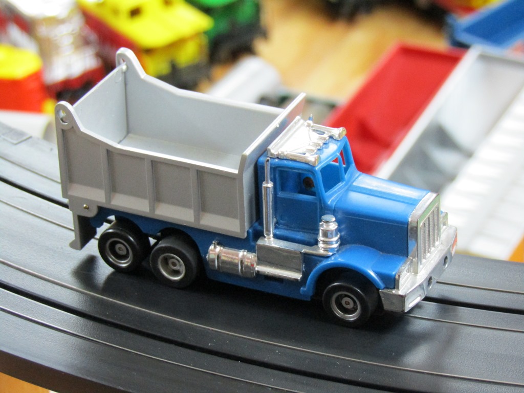

Also, I got this awesome blue&silver Tyco slot Dump Truck in the mail today too - which thanks to Ebay's "offer" option, was snagged before anyone could bid for about $27.00. I believe that this was an excellent price, considering this version of the slot Dump Truck is a bit harder to find. With a bit of lube, and 2 new tires, this Dump Truck is running very well! Stay tuned for it to be featured in a future video.

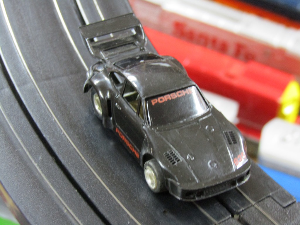

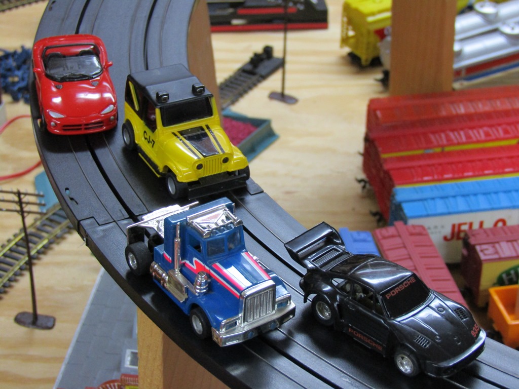

 Posted - June 27 2018 :  8:54:58 PM Link directly to this reply  Show Profile  Add RP model railroads to Buddylist
UPDATE:
Okay....ON YOUR MARK...GET SET...GO!! I just received these 4 awesome Tyco racing slot vehicles today in the mail, and could not wait to post them on the TF. All were obtained from the same seller last Sunday evening, (whereupon I bid upon each, and received surprisingly no rivalry) - between the prices of $14 - $17 each, with the truck being the most expensive, clocking in over 17 bucks. All run super well, and I cannot wait to feature them in future action videos aboard TYCO SPEEDWAY.

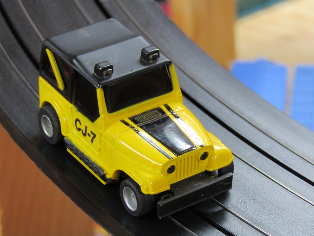

Tyco yellow&black CJ-7 Jeep

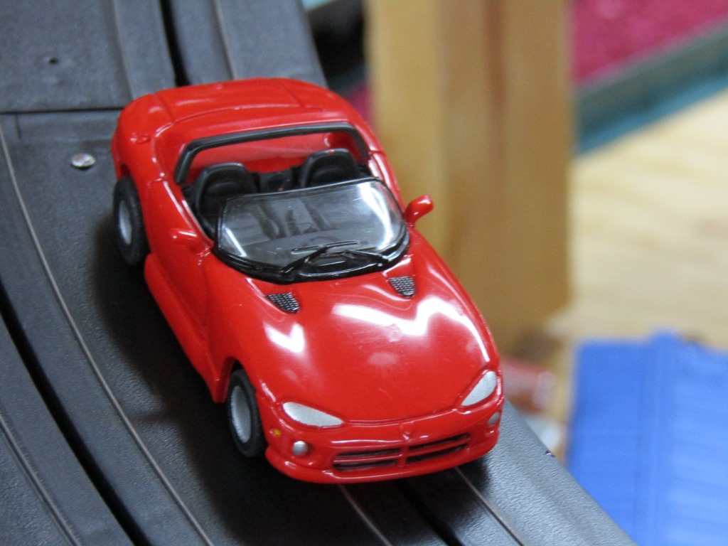

Lastly, a Tyco red Dodge Viper Convertible
I think all of these make splendid additions to my Tyco slot car collection, and each one was obtained at an excellent price, with a great combined shipping cost. What do you guys think???
 Posted - June 27 2018 :  10:42:04 PM Link directly to this reply  Show Profile  Add microbusss to Buddylist
the cars on the trailer are 1980s era Mustangs
Or did you know this?

Great images and videos.
Loving this thread!
Didn't realise those little hollow brightly coloured cars cars were Mustangs! That is not how I think of Mustangs- Where's the muscle?

Indeed, Microbuss, I knew that - thanks to you in the past! Yes, those little HO-Scale plastic cars by Tyco are 80's era Mustangs "Third Generation." https://en.wikipedia.org/wiki/Ford_Mustang_(third_generation)

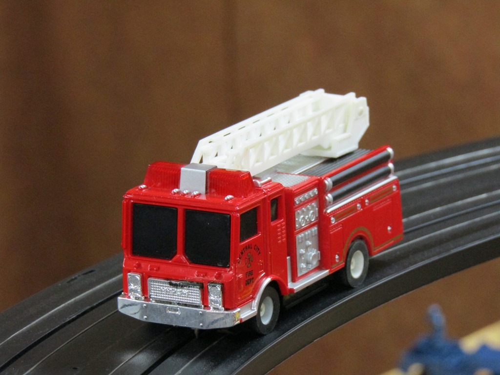

UPDATE:
YES! I now have my very own Tyco slot fire truck, made for the US1 series. This Mack "MR" model ladder truck is highly-detailed, and runs well, with a fully operating light bar and bell-siren. As a train and fire buff, I am really excited to have a piece of both Tyco, and model firefighting, history. Stay tuned for a future video featuring the Tyco Mack "MR" ladder truck.
Close to the real deal, note that this fire truck has an extra tandem. (Photo Credit Entirely to Original Photographer)
Edited by - RP model railroads on June 30 2018 11:33:39 PM
 Posted - July 01 2018 :  12:18:41 AM Link directly to this reply  Show Profile  Add microbusss to Buddylist
Matchbox made a Mack fire truck like that but it was a floodlight truck

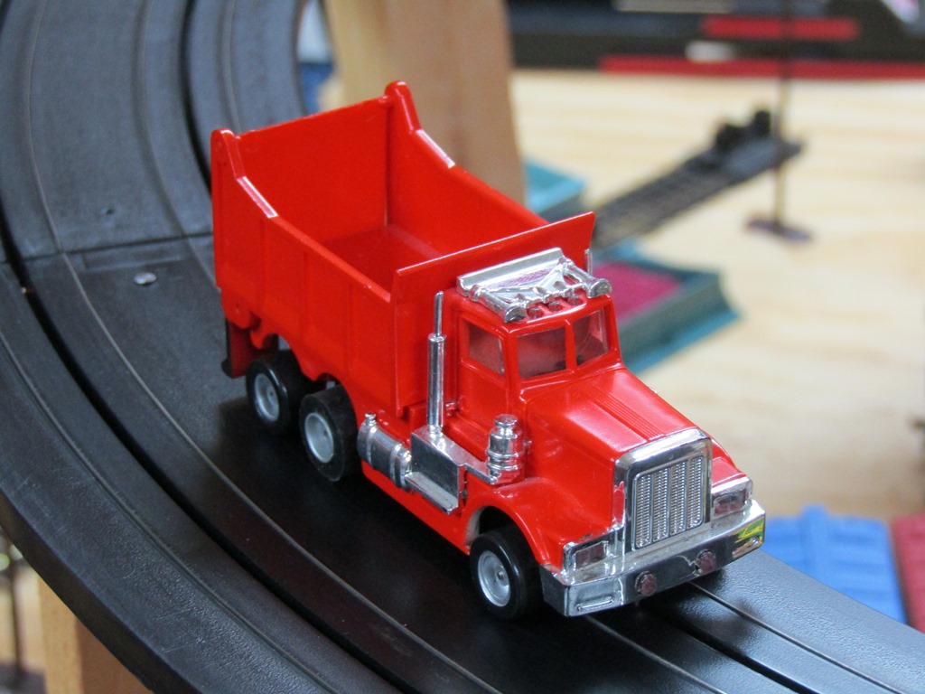

This mint red Dump Truck was the 2nd one obtained from the same seller, at a great price. It already featured 2 new drive tires, and runs very well. Both of these are awesome additions to my rapidly growing Tyco slot vehicle collection.

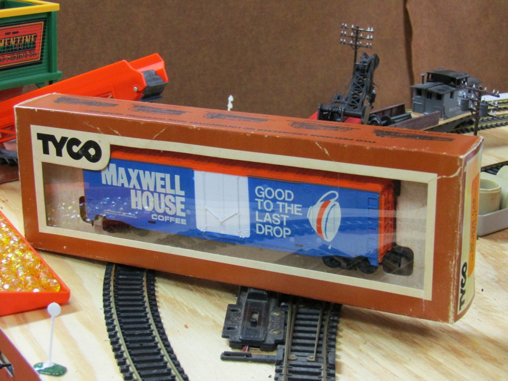

I finally have it - the scarce Tyco Maxwell House 50' box car, in mint condition with its original box!!!!! I'm very excited since I've been seeking the Maxwell House car since my interest in Tyco officially began over 2 years ago and although there have been many listings on Ebay, all have gone off for $40.00 or more. I recently stumbled across an auction going off at 1am, and since the car was still at a reasonable price, I put in a max and discovered in the morning that I had won this car for $26.00. Now, that is rather expensive in my opinion, but considering the car is in practically new condition and the original box with label is intact, I think that this price was quite good.
The Maxwell House car is featured in one of my latest videos, entitled: "Silver Streak" ALCO C430 Express
 Posted - December 24 2018 :  2:46:02 PM Link directly to this reply  Show Profile  Add microbusss to Buddylist
I needs that boxcar too!
it also came in a grain hopper too
THAT one I DO have
