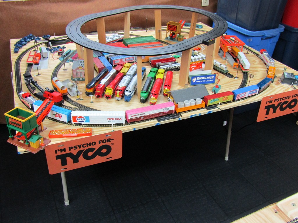

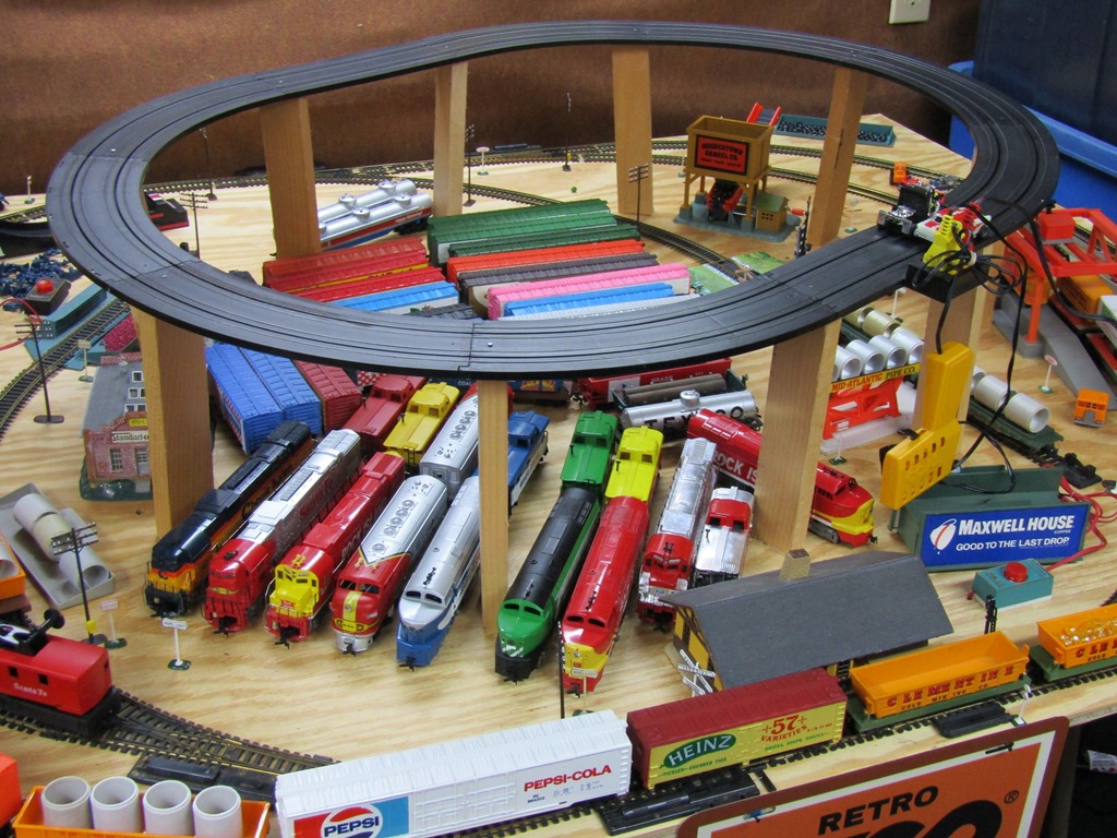

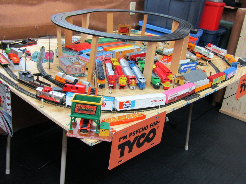

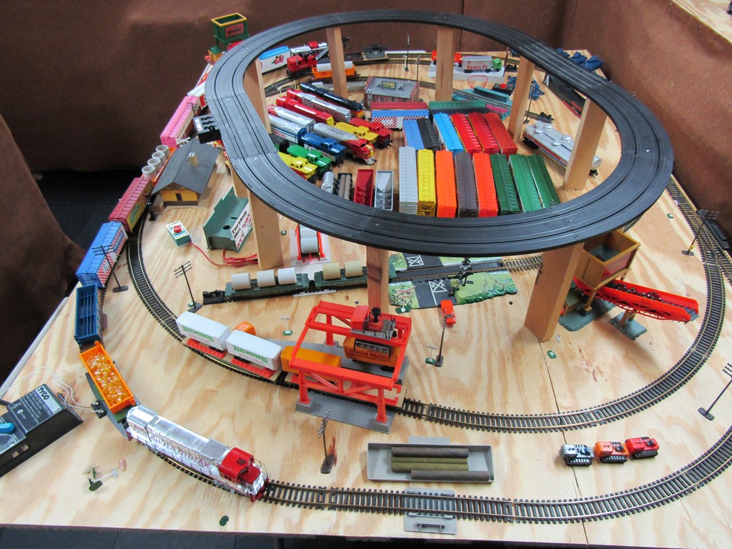

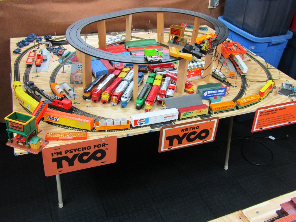

UPDATE:

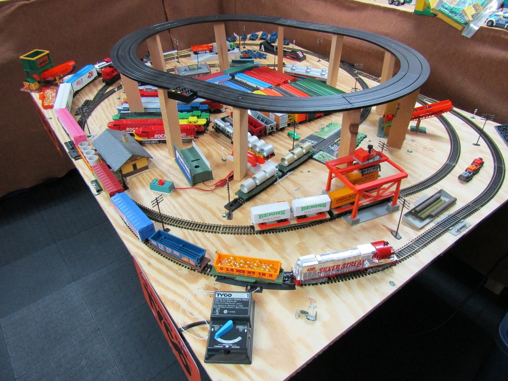

Yep, the slot car track has been installed on RETRO TYCO! This afternoon, I received assistance in cutting 10-12 9inch pieces of wood (all from 2 long left-over wood sections), and tonight, I alone tediously nailed all sections of the slot car track oval to the 9inch wooden supports, and then - upon clearing the center of RETRO TYCO - proceeded to lift the slot car track into place. Lastly, I hot-glued each support down to the platform. The final result, a sturdy oval of slot car race track (made by Aurora/AFX), which will be perfect for a small Tyco slot car/truck racing section.
What do you guys think? And, to the "pros" at Slot Car Racing, how does this look? To me, it is #Road&Rail to the supreme.
In addition, all of my Tyco locomotives and rolling stock acclimated perfectly to being stored beneath the elevated slot car track, and honestly, where the locomotives are sitting, it kinda looks like a roundhouse.
I already obtained 2 Tyco slot car controls and 1 powerpack at the cheapest price available on Ebay, and (stay tuned) got my first slot car -- really a truck! I'm so excited to see RETRO TYCO coming along so well, and truly appreciate all of your support and continued inspiration in this endeavor.
 Posted - June 01 2018 :  11:16:11 PM Link directly to this reply  Show Profile  Add scsshaggy to Buddylist
How well do slot cars stay on the track?
It looks like a long way down.
 Posted - June 02 2018 :  06:32:21 AM Link directly to this reply  Show Profile  Add RP model railroads to Buddylist
Originally posted by scsshaggy - June 01 2018 :  11:16:11 PM
Interesting question.....and I have no idea yet. Guess if it don't work I will be destroying everything.
I just need to wait until Monday/Tuesday for my Tyco controllers, powerpack, and slot truck to arrive, and then I'll know.

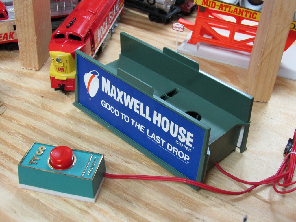

UPDATES:
A lot of stuff for RETRO TYCO arrived today! Let's get started....

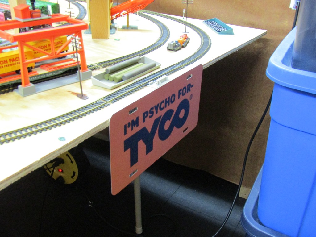

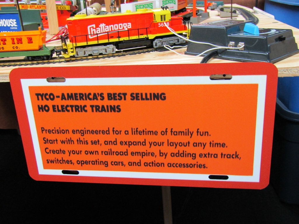

First off, I received the final 2 license plates I created using Build-A-Sign.com -- The "Retro TYCO" plate was hung appropriately in the center-front of the layout, while the Tyco official train "slogan" plate was hung in front of the powerpack (thus relocating the other "I'm Psycho for Tyco" plate to the right side of RETRO TYCO.) I really think these signs/plates add character to the layout, and serve to show my Tyco-MANIA.

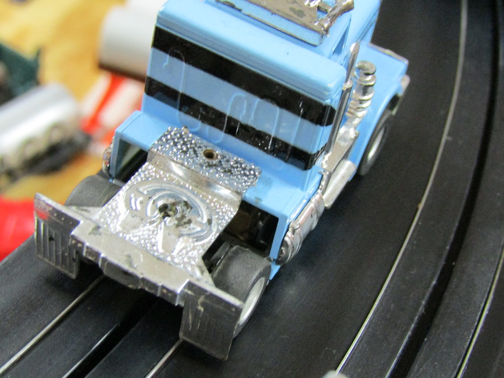

Next, I received weight pieces from thesiding thanks to a recent trade - and upon installing them on my Tyco Operating Crossing Gate, I'm pleased to state that it is now working (well, working...as best it can.)
Also from thesiding, the 2nd topper needed for the Billboard Steam Whistle accessory - looks sharp.

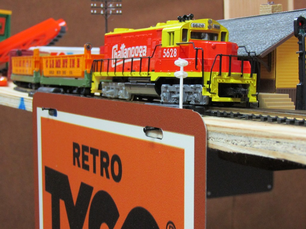

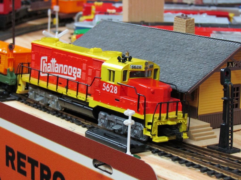

Lastly, I finally received the for-parts Tyco "Warbonnet" Santa Fe GP20 that I won at a cheap price on Ebay last week. After switching trucks, replacing a bottom plate, installing traction tires, and lubrication, my Chattanooga GP20 with PowerTorque is Now Working, and very well at that!! Thanks to a fellow Tyco Forum member for the shell w. plastic handrails, which I mounted on MU-2 style trucks a while ago.
Here are some shots of Chattanooga GP20 #5628.
 Posted - June 02 2018 :  8:51:41 PM Link directly to this reply  Show Profile  Add Barry to Buddylist

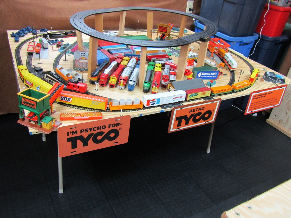

Robert, you put that Retro Tyco set-up in a store window and the kids will go nuts.
 Posted - June 02 2018 :  10:45:13 PM Link directly to this reply  Show Profile  Add Chops124 to Buddylist
Yep, hope it makes its way to an exhibit, sometime. Too nice to
keep it under a basket, that. I am intrigued at the elevation
scheme of the USA 1. How, if, are you going to scape the
vertical sides?

I jelly you have that much "gold"
Also I wants the "I'm psycho for Tyco" plate hehe

LOL, Microbusss, I might have to start an order of "I'm Psycho for Tyco" license plates.....if more individuals want them, I can turn it into a business.

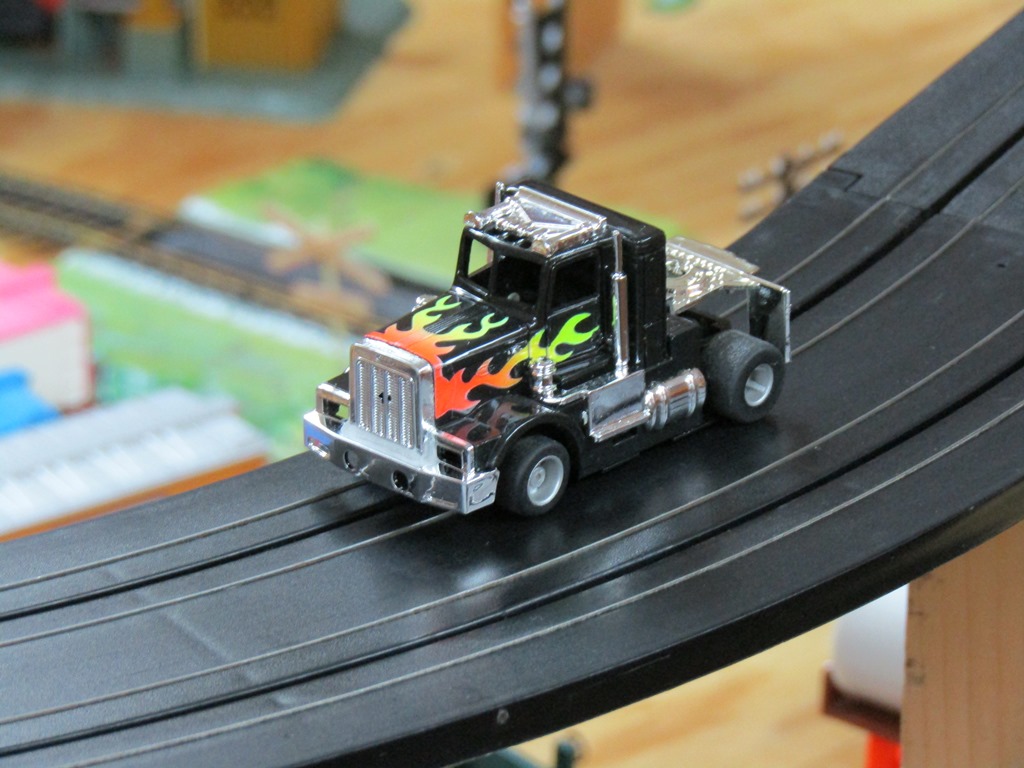

Well, nothing new has come for RETRO TYCO....except for the fact that I received my first Tyco slot truck on Monday -- this nice black w. flames scheme on a Tyco Peterbilt cab. Now, I just need to be patient and once my power pack and controllers arrive, then I will finally be able to determine if my track even works.

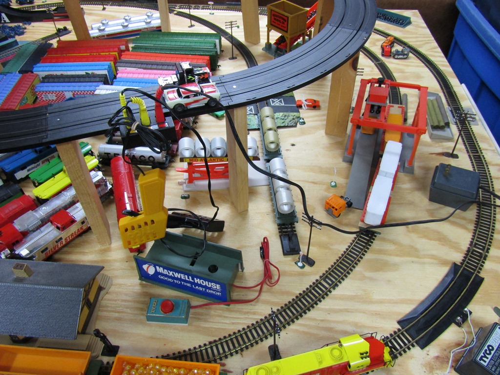

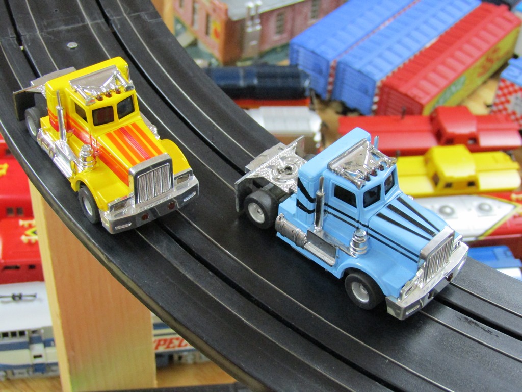

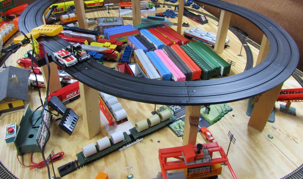

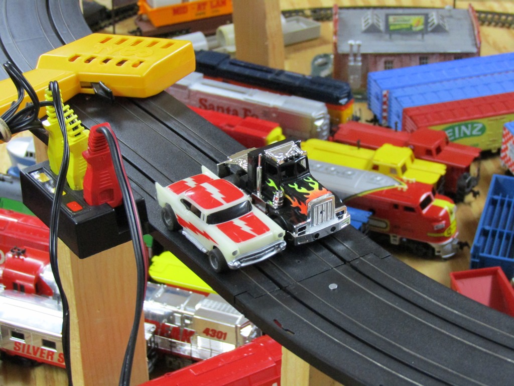

Received 2 Tyco slot car controllers and 1 Tyco powerpack plug-in today in the mail, so after work, I started installing them on RETRO TYCO's slot track. Unfortunately, I realized the hard way that the Tyco wire-plug-ins for both the controllers and the powerpack were a bit too large for the Aurora/AFX power track's outlets. :( So, I had to safely shave the rubber on the ends of all plug-ins with a scraper, and then finally each one fit tightly.
After getting the powerpack and controllers to work properly, it was time to test the slot truck. Worked perfectly, except I noticed that on both the inner and outer track, the truck stalled on both straight sections. Turns out I had a small amount of corrosion/rust on the metal "rails" inside the slot track, so with the scraper, I removed the corrosion, and ended up getting near perfect contact.
Also, thanks to a recent transaction with Chops, I received this awesome Tyco '57 Chevy slot car!! It runs well on the outer line, and has knocked off my Black Peterbilt slot truck a few times.
It took me a little bit to control both slot vehicles, as I have understandably never had slot cars before. After both the Peterbilt and Chevy flew off the curves quite a few times, and acted as Kamikazes -- propelling off the track and smashing into train cars below due to yours truly......I finally got the knack to control them. Now, I just need to obtain more Tyco slot vehicles (more trucks for sure!) and maintenance both the present slot track and vehicles.
I also plan to devise a way to hang the controllers safely on the wooden-support pieces.

 Posted - June 08 2018 :  11:07:52 AM Link directly to this reply  Show Profile  Add Chops124 to Buddylist
Clever modification to the Aurora controllers. I am fiddling with
trying to see how to best install my Tyco USA1 track, too. Is
a bit of a challenge! Spent six hours trying to straighten
out my Tyco inventory- feels like I hardly made a dent.
Hopefully more progress in days to come. The round house
effect is a good one. Maybe some straight sections of track
to suggest the effect further?
 Posted - June 08 2018 :  11:58:58 AM Link directly to this reply  Show Profile  Add RP model railroads to Buddylist
Thanks Chops! The straight track idea is a great suggestion - thanks!
Also, good luck on getting your Tyco US1 stuff to run well on Tycomania.

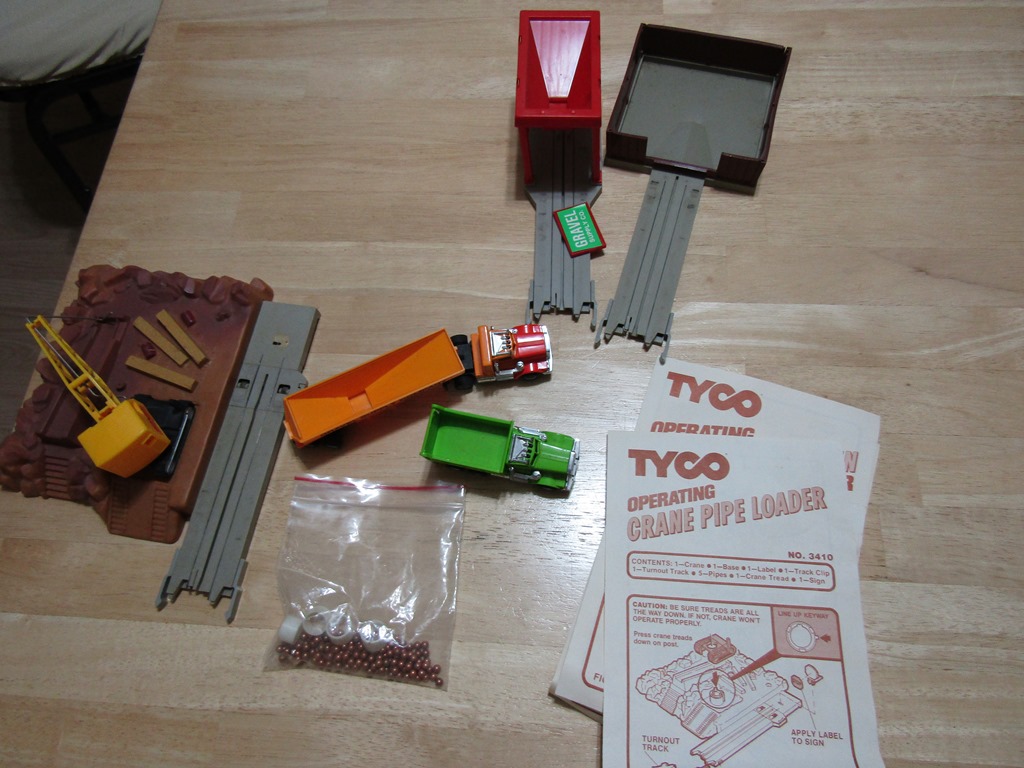

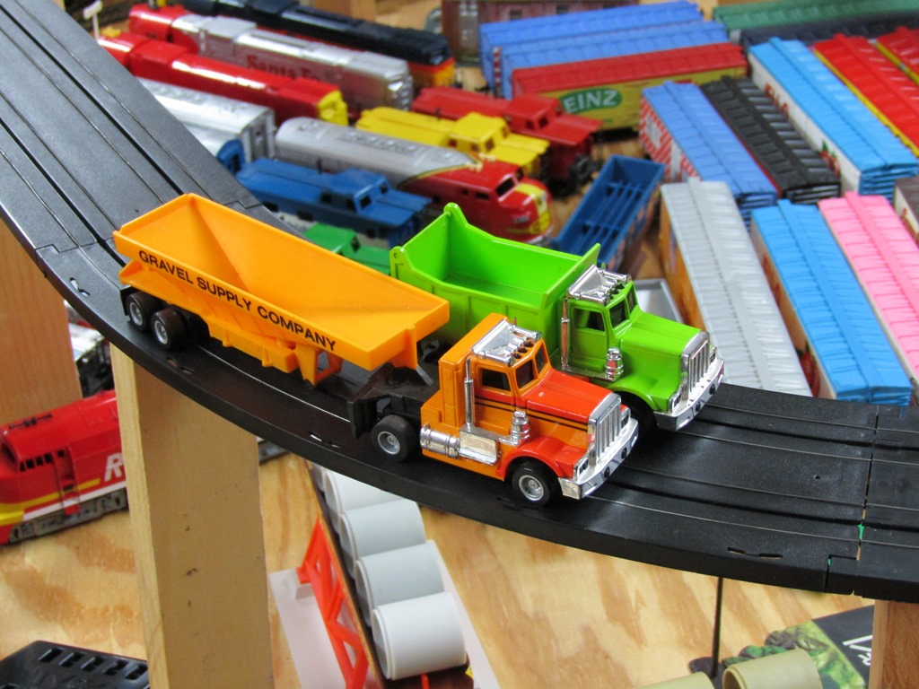

Today, I received this large Tyco US1 Slot Trucking lot in the mail, that I just purchased 3 days ago. All of the operating accessories I will be listing under the Trading Post, so if you are interested, then please read my post for trading. I have currently retained the bag of gravel and pipes, but if I decide that I cannot use them on RETRO TYCO's slot track, than I will be putting the whole bag up for grabs as well.
After a small bit of cleaning, and lubrication with Liberty Oil, both the Green Dump Truck and the yellow Gravel Tractor-Trailer are running well on the slot track!!! These hallmarks of Tyco's US1 line of products are the perfect complement to RETRO TYCO, and I'm so excited to now race these trucks!
Check out this video featuring all 4 of my Tyco slot vehicles, operating on RETRO TYCO's slot track. By the way, I need a name for my slot racetrack.......any suggestions? Perhaps PRO RACETRACK, named in accordance with "TycoPro."?

UPDATE:
My latest video of action on RETRO TYCO, this time both train and slot truck operation. I present....TYCO ROAD&RAIL #2.

I'm glad to see that video, it gives me just enough steam in my cylinders to get out of this
chair and fiddle around a bit with my USA1. That neon green dump truck has a fairly good
low end speed, but still it makes quite an impression salloming about the curves.
The track with which I corresponded to with James in the Day, above, is exactly what you
have their, plus the gray track for the original USA1 set up. Having just a little more available
real estate, I wanted to lengthen out the run just a tad bit and found the black track on line
for not too many clams.

Thanks Chops, and good for you! The Tyco Green Dump Truck is one of my best-running slot vehicles, and stays on the elevated slot track pretty well. In regards to the Tycomania slot track....will it be elevated, and if so, how is the project going so far?

Got these 2 awesome Tyco Peterbilt slot trucks in the mail the other day.....with one missing 2 rear tires and the remaining tires on both trucks entirely dry-rotted. Luckily, a lot of 16 US1 trucking silicone tires arrived yesterday as well (which were ordered from Ebay at the cheapest available price), so I gave both trucks all brand-new tires.
Lastly, I lubed both slot trucks and after a few run-arounds on the slot track, they were performing well. Both have light capabilities, although only one's headlights actually work. These Tyco trucks are nice, with my favorite of the 2 being the light blue one with black streaks.
The only problem I foresee is that....the holes in the rear of the trucks where trailers would be attached, are too narrow for my US1 trucking gravel trailer, and I'm afraid that the 2 trailers I successfully won in-auction on Ebay at a great price last week, might not be compatible with these trucks.
Is there any way I can widen the holes? Already thought about a drill, but I DO NOT want to risk injuring the gear mechanism below. Anything where the end result will look smooth, and not like I hacked-at the back of the truck? Any advice would be appreciated.

Those are beauties, RP. No experience with modifying them.

Awesome trucks!

As a rule, I think it is safe to say that only US-1 trucks will only mate with US-1 Trailers.
If you think about the design of a US-1 tractor and trailer they are designed to pick up well, stay in the slot when reversing and have added weights to help with traction.
Both TYCO and Aurora did trucks and trailers with magnetic chassis and I faintly recall some trailers having magnets too, but the trailer couplings were very different to US-1 and not compatible at all. the pivot pin was narrower.
I vaguely recall that some of these could reverse but others won't, but I need to check.
I know the Ideal Peterbilt from the Knight Rider race and chase set (see image in the slot car of the week thread) was designed not to have a trailer but I am not sure if Tyco or Aurora produced rigs like that too.
I have a few non US-1 trucks and trailers tucked away upstairs and need to dig them out to take pictures later in the week. Sadly tomorrow is probably too busy.
It would take a lot of work to change a non-US-1 rig to pull a US-1 trailer, so my suggestion is don't. Only a real US-1 rig was designed to push and pull the trailer reliably, coupling and uncoupling at the bespoke docks.
James
