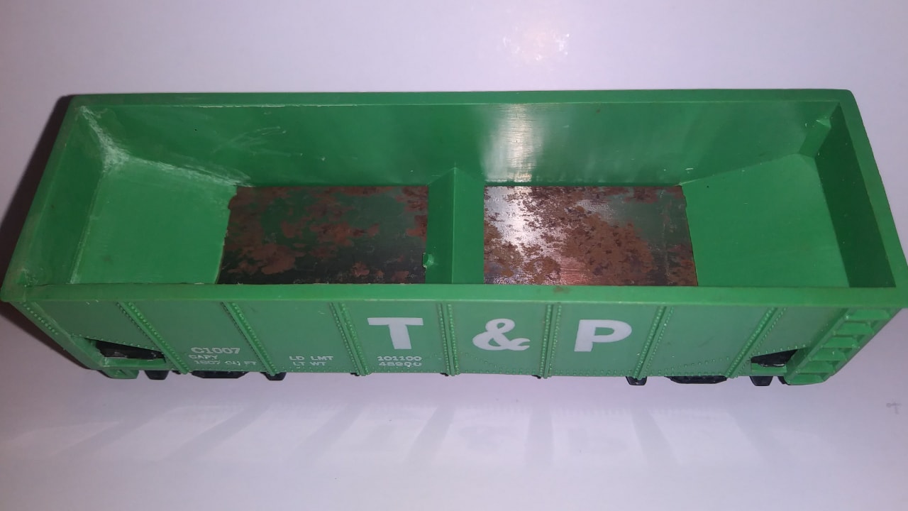

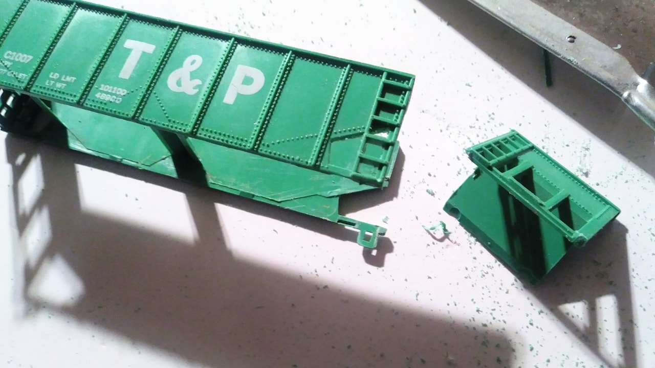

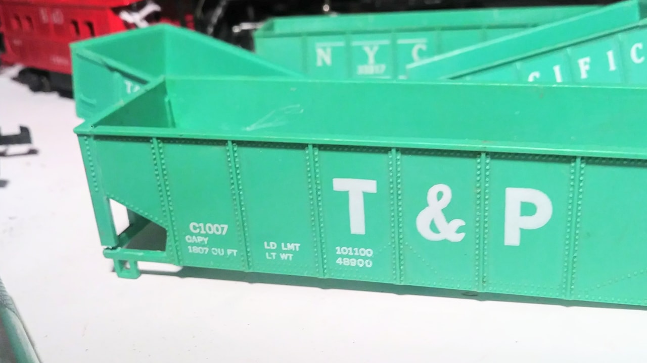

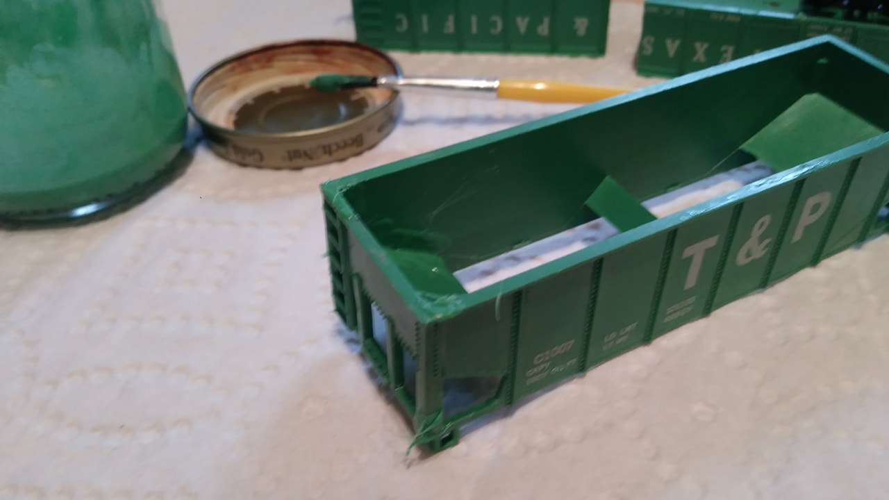

I picked this uncataloged C1007 T&P hopper up some time ago. The car has beautiful graphics but has 2 1/2 broken steps and a huge chunk missing from the end of the car. Given the scarcity of the car I figured it was worth saving...
This is the car before.

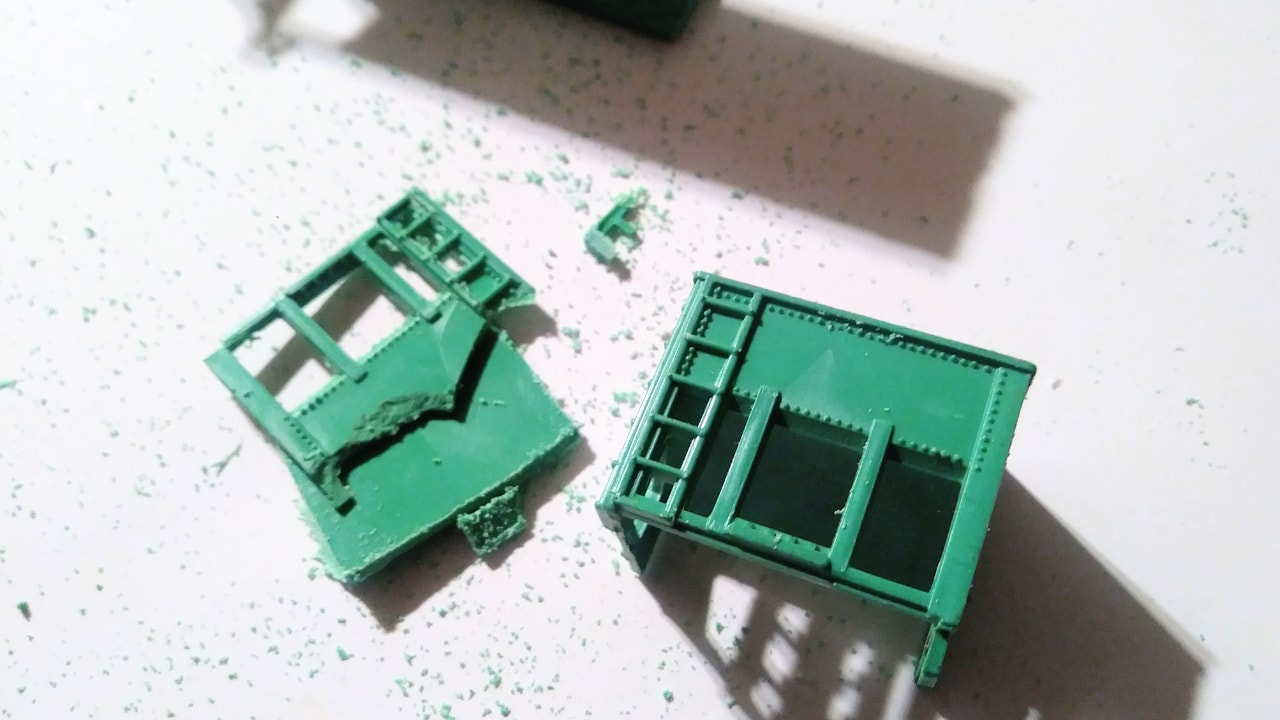

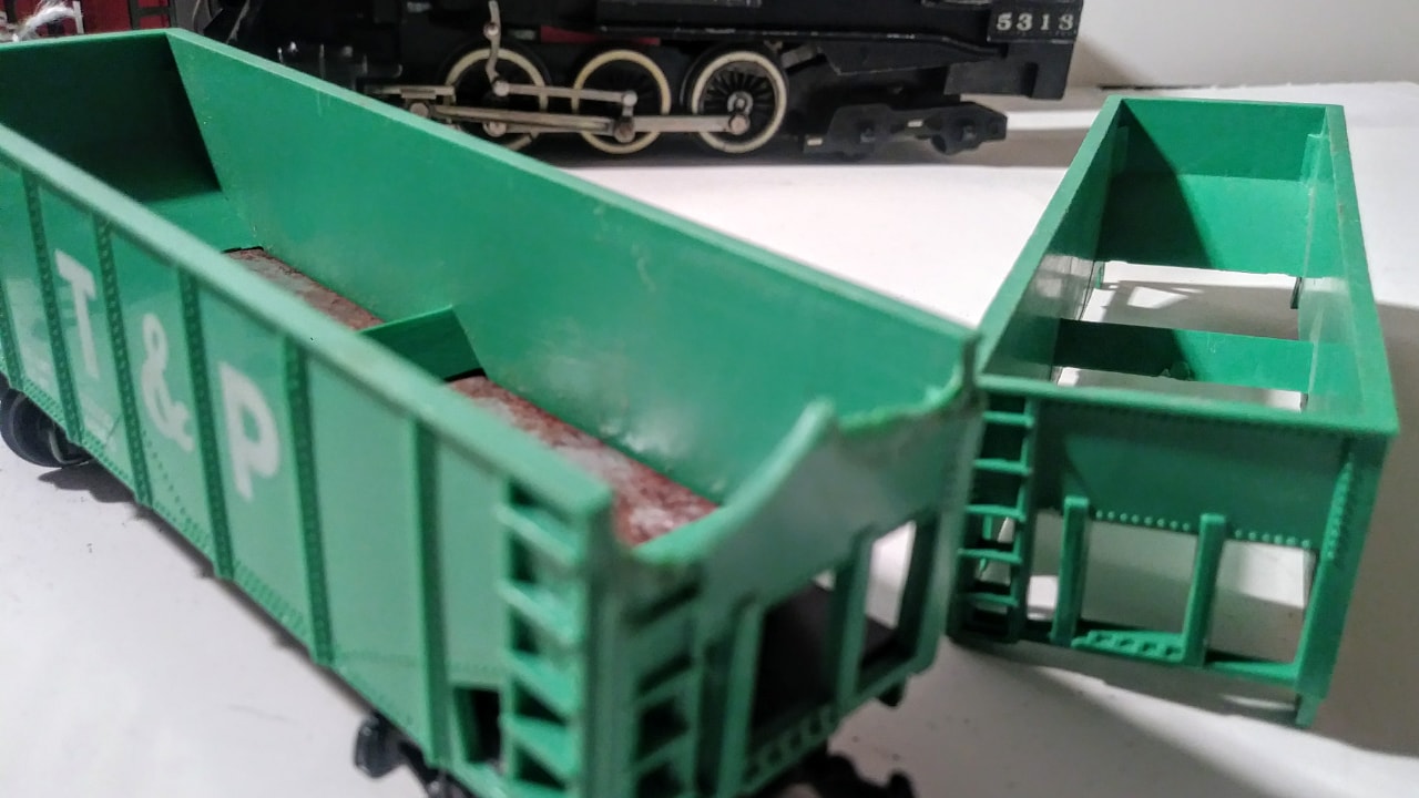

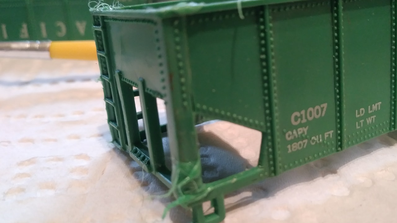

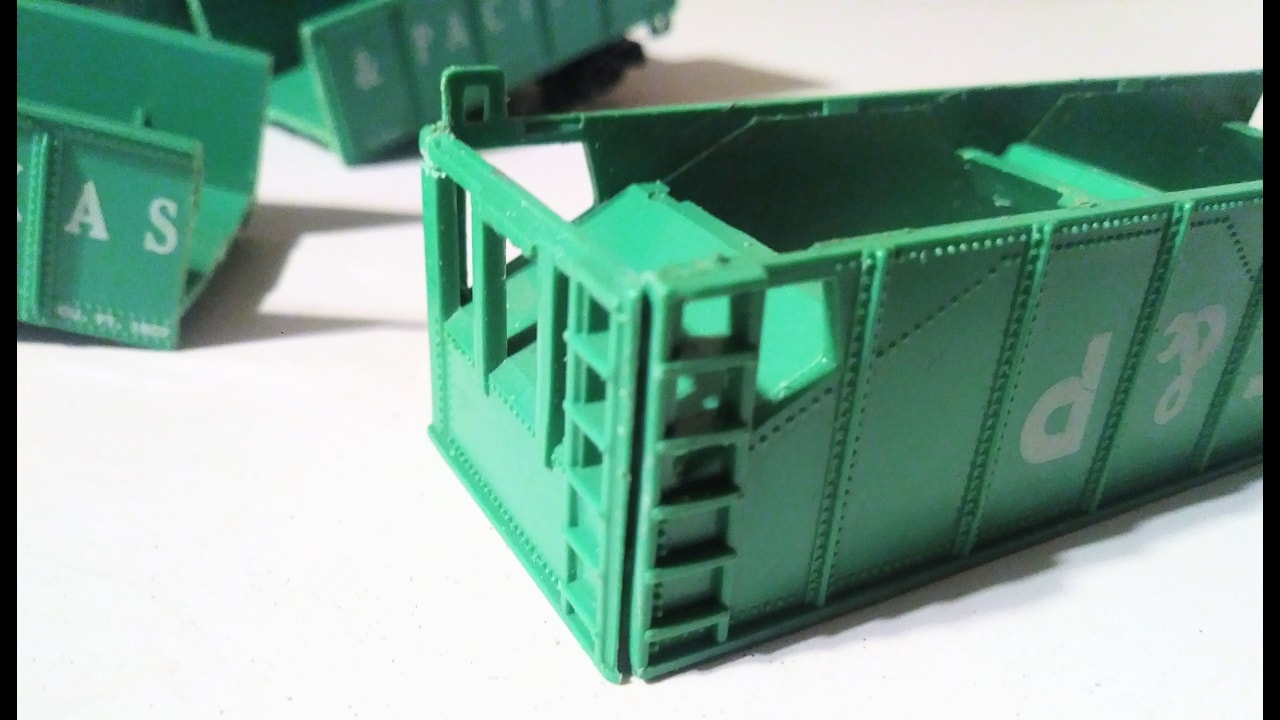

Here is the broken end and the donor shell I'll be using to repair this car.
No turning back now...

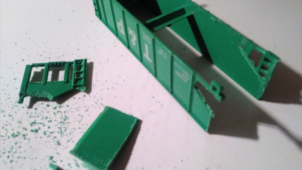

End from the donor car cut off...

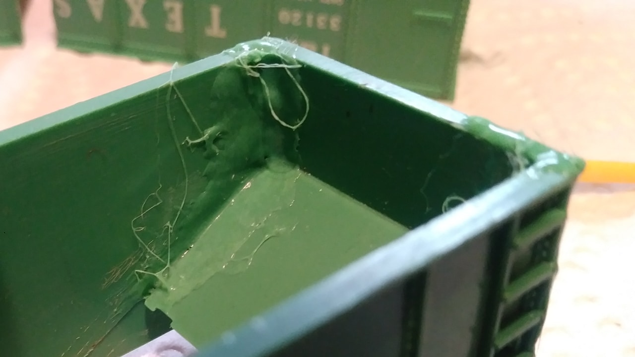

Trimmed down and ready to test fit...

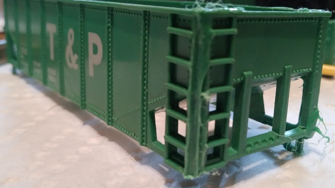

Fit looks good...
Starting glue up.

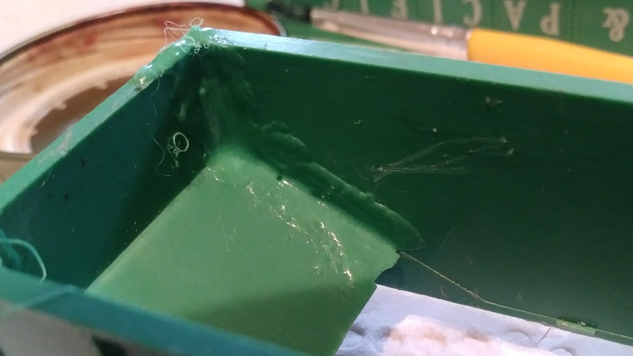

Thanks guys. For putty, I like to disolve the plastic that I'm repairing in a baby food jar with plastic model solvent cement to make a liquid plastic the color of the base material I'm working on. End results are very close to being unnoticeable on bare plastic.

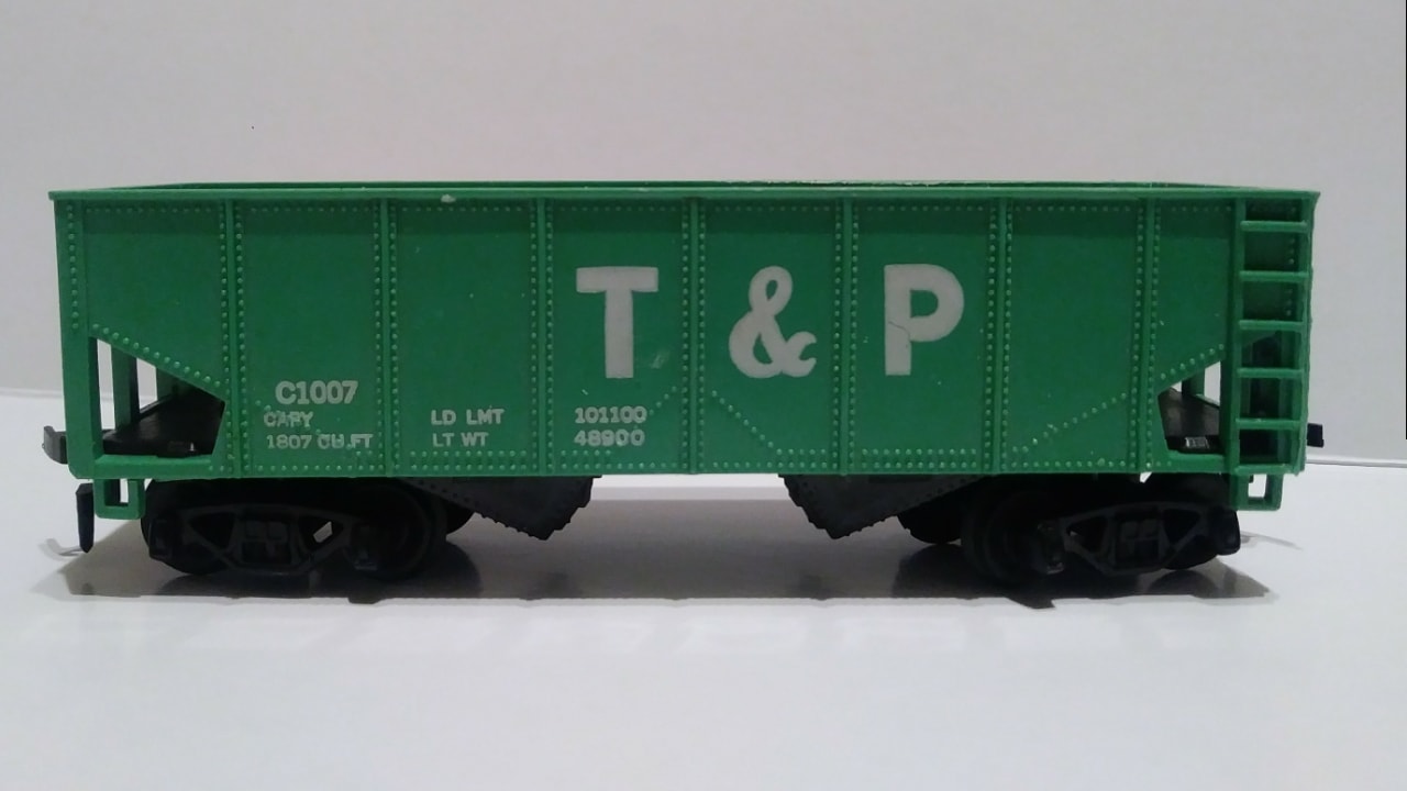

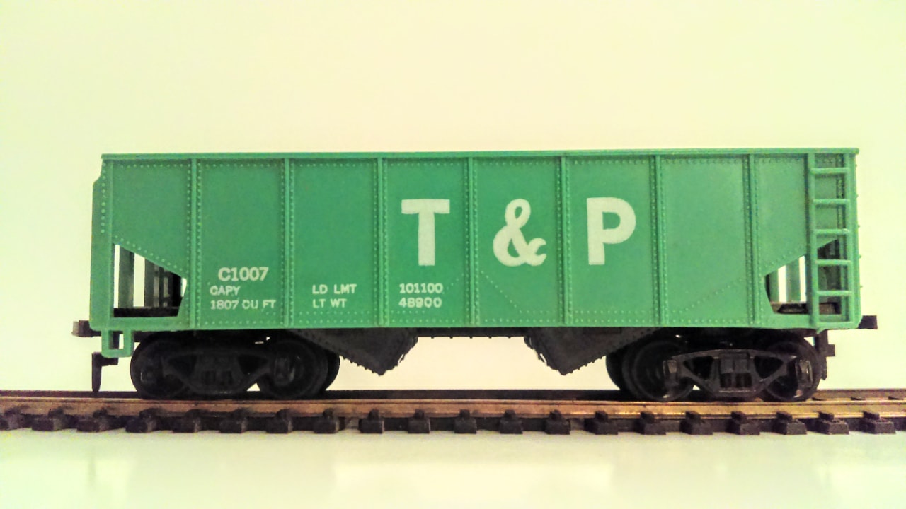

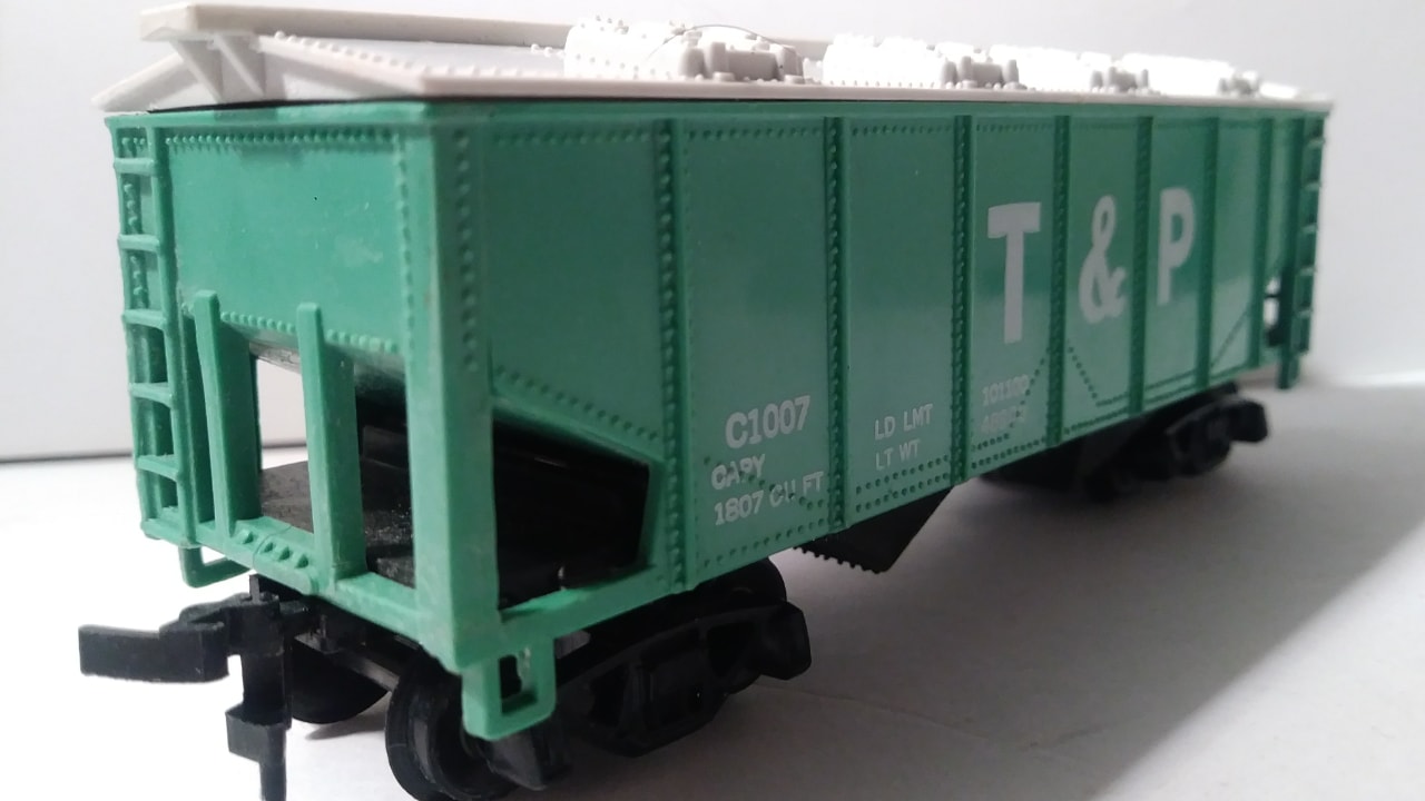

Here it is. Needs a few details worked out but all in all it came out pretty good.

...disolve the plastic that I'm repairing in a baby food jar with plastic model solvent cement to make a liquid plastic the color of the base material I'm working on
If I didn't see it, I wouldn't have believed it. The idea of using the existing plastic as glue is innovative. Thanks for sharing.

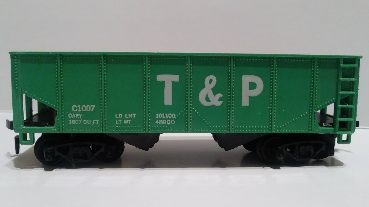

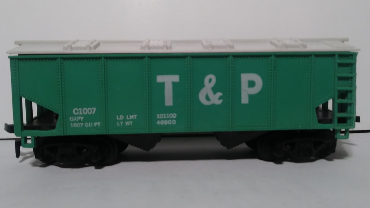

Thanks guys! Took a few days off to keep the wife happy and got around to finishing this off. Here it is completed as ready to roll again...

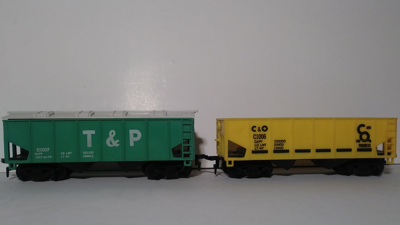

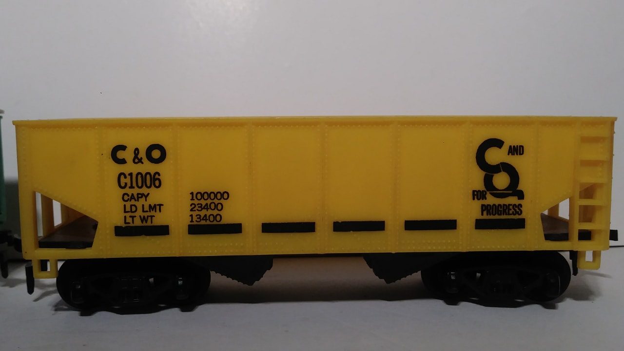

Chops, this is a very rare uncataloged Gilbert HO car from 1961 that was part of the Sears set number 30057. The set contains a lot of scarce and desirable cars and commands a premium when found. You and some others may remember the empty set box for it that sold a month or so ago for close to $900. I atrached a pic of the other uncataloged hopper from that set which is also extremely hard to find, the C1006 C&O.

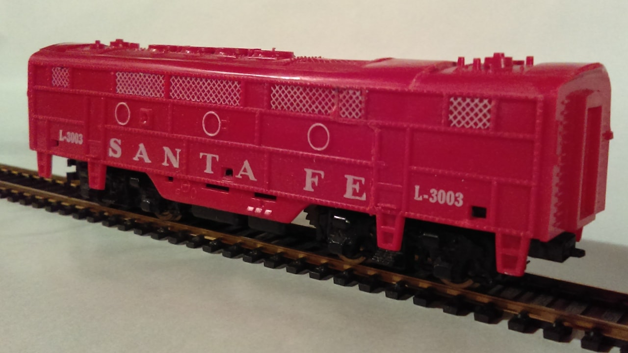

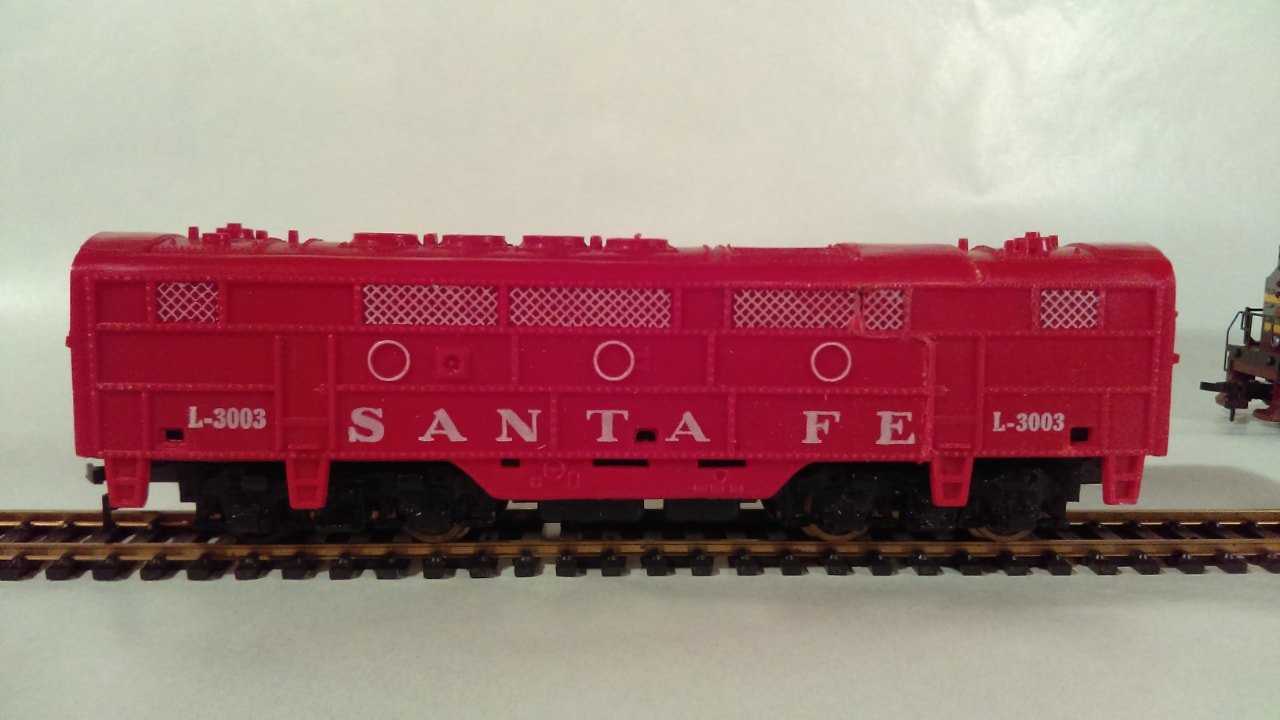

Thank you... Is a technique I borrowed from my old model car building days in the search for a better potty that would actually feather into the existing body. I have been using it for decades... Here's another example of what I've done with it... Gilbert never offered a B unit for their Pikemaster diesels so I've made some myself. Here is one of the Santa Fe B units I made using two broken A unit shells.

bad71burb,
I had to download the pics and zoom way in to see exactly where the cuts were. My compliments as this is a VERY nice job. This "B" unit could fool some buyers out there.
