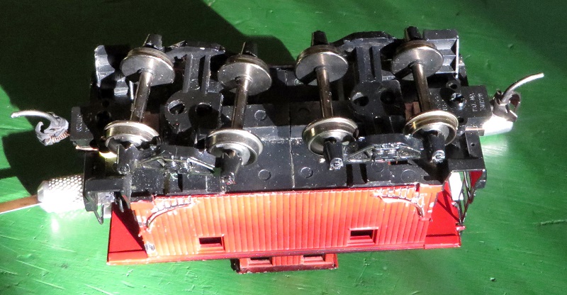

The title is something of an oxymoron since, by definition, a bobber is a 4-wheel caboose. Railroads did, however, sometimes convert bobbers to 8-wheel cabeese because 8-wheel cabeese tracked and rode so much better.

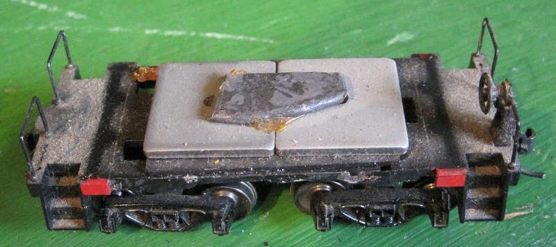

Some years back, I bought a bag of odds and ends which included a bobber caboose body and an 8-wheel caboose chassis. I shortened the chassis to fit under the body, back then:
I left the body looking pretty toy-like and kept the truck-mounted couplers because I was just using it on a circle of track under a table top Christmas tree. It occurred to me, lately, that if I body mounted the couplers and got the body looking a little more realistic, I could use the caboose on the layout when it wasn't a Christmas decoration.

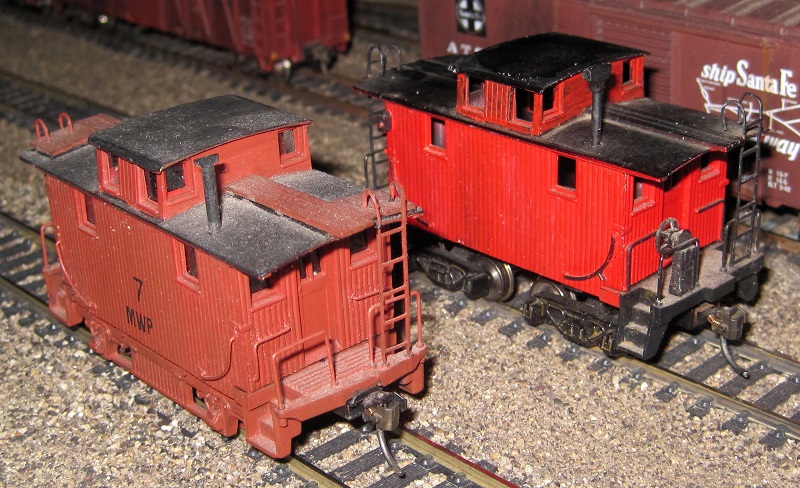

Here's a shot of a bobber I fixed up to look better and the 8-wheel conversion in its toy-like form:
I never do anything the same way twice, but the goal is to have the 8-wheel caboose looking about like the bobber.

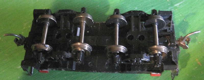

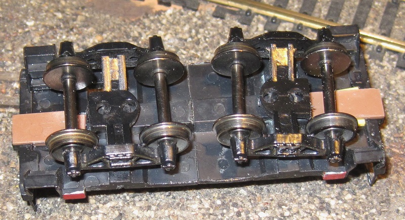

Here, the truck mounted couplers have been removed and plastic pads have been glued on for body-mounting couplers:
After the glue thoroughly dries and hardens, the pads will be drilled and tapped and coupler boxes will be screwed on. Then, all the colors of plastic will be painted black.

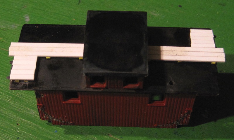

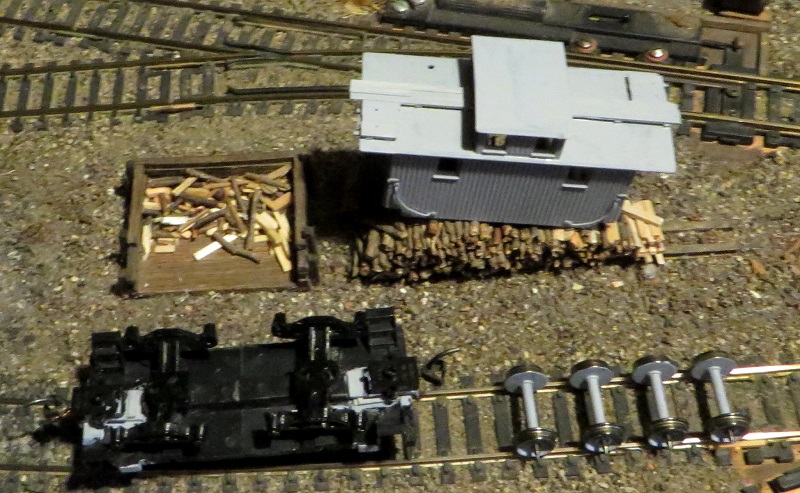

In this shot, molded on railings have been cut off of the sides of the caboose and the molded on roof walks have been filed away and replaced with roof walks built board by board.
When the glue is dry on the roof walks, I'll work on the separately applied railings then paint on a primer coat.

The new roof walks are on as are the separately applied grab irons on the sides:
The couplers are now body mounted as well:
The parts that need primer are now primed and I'm waiting for the primer to thoroughly dry. That takes a while, especially this time of year when the house is not very warm.
Once the primer is dry, I'll put on the finish coat of paint then glaze the windows and letter and number the caboose.

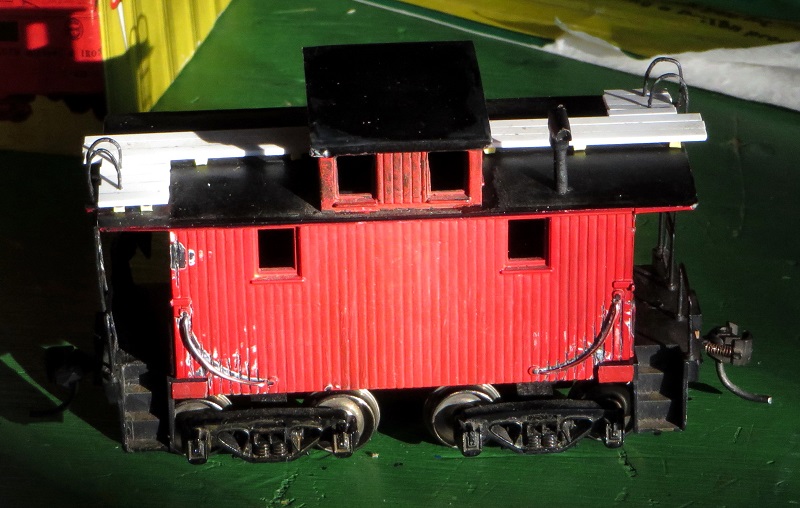

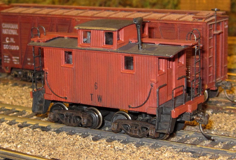

Here's the final product, painted, weathered and with windows glazed:
 Posted - November 23 2014 :  7:11:17 PM Link directly to this reply  Show Profile  Add kovacste000 to Buddylist
Just goes to show that you can make a "junky" freight car or locomotive into a masterpiece with a bit of knowledge and the materials. Very well done.

 Posted - November 24 2014 :  7:38:07 PM Link directly to this reply  Show Profile  Add Barry to Buddylist
Very nice Don. What kind of paint/primer do you use (e.g., drying time - oil?)? What does TW stand for on the side?
 Posted - November 24 2014 :  10:06:24 PM Link directly to this reply  Show Profile  Add scsshaggy to Buddylist
Originally posted by Barry - November 24 2014 :  7:38:07 PM
Thanks. The primer is Floquil primer which is not really a primer, but just a solvent based pain the color of gray primer. When I bought it, I thought it really was primer and it does stick to things pretty well, so I use it for that. It's dry to the touch, probably in an hour, but before I put acrylic paint on it, I wait for it to dry hard which is, theoretically, when it no longer smells like solvent. That takes a day or two.
The finish coat is Polly Scale. The red was Zinc Chromate, the roof was Grimy Black and the frame was Steam Power Black. Dry transfers were sealed on with acrylic matte medium. Weathering was a very thin wash of Steam Power Black on the red and a burnt umber artist's acrylic wash on the trucks.
Unfortunately, all that Floquil and Polly Scale paint is now discontinued so, when it runs out, I'll have to find suitable replacements.
TW is the reporting marks for the Tabor and Waldo RR. It's a freelance railroad I made up.
