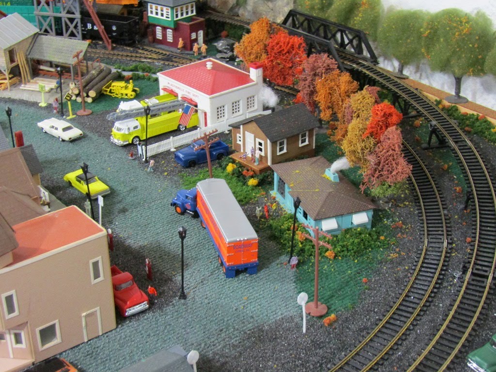

Just a general inquiry: Were Tyco PT locomotives notoriously unable to haul a load of 5 or more cars up from flat track to inclined to bridge / then off bridge?? Because, I have added new traction tires to 2 Tyco locomotives and cleaned the track near the bridge on my layout with rubbing alcohol, which worked BTW, but the locomotive can only haul about 2-3 cars tops. :(
Does anyone else experience/has experienced this issue on their layout?? Did you find a solution?

Hmmm...yeah...that is bad. :( I don't have a figure 8 type layout, here's what I'm referencing (the outer line) Just a curve up, bridge, and then curve down.....that simple arrangement is effecting certain of my Tyco locomotive roster. Ugh]

I'd suggest rearranging the risers to make the grade less steep. Lowering the bridge height would work also.

That looks like a nice little track arrangement; makes the layout interesting with those layers. I wanted to do that, but had too limited space. I did have the figure 8 set up on the floor for a while, and I had the same problem with grade. I did use 22 inch radius for the uphill climb and added more trestle pieces to ease the grade, but I believe it was still pretty much the maximum for what you'd expect a real locomotive to climb. Forget the exact number, but 2.0% strikes me. I never had much more luck with traction tires than just keeping wheels and track clean. Maybe the best thing is to just make sure you've got the rolling stock rolling as well as possible, and maybe double header locomotives, hey?
