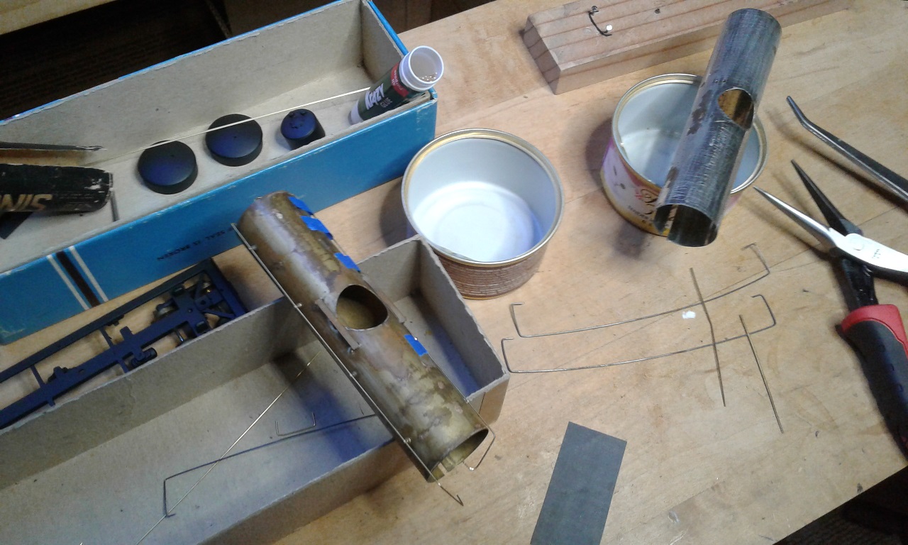

For some time I've had the thought of re-doing a Mantua Metal Products tank car in basic flat black. One reason being that I had a couple cars that were in need of a tune up, and another being that a no name flat black tank car conjures up something along the lines of an old black and white photo of a steam train. I set out the other Mantua tank cars for inspiration, and to check some assembly things. At one time, I thought my goal would be to just re-do each of the Mantua cars I acquired, but I've grown to appreciate the work done by the modelers a half-century ago, and actually, the general simple design of these cars. We'll see how this flat black business goes. So far just got the frames and a few pieces painted. Need to thread those little bent pieces of brass strip that serve as stanchions and do that handrail install before I paint the tanks; thinking I'd have a tendency to scratch the tanks all up putting the handrails on after.

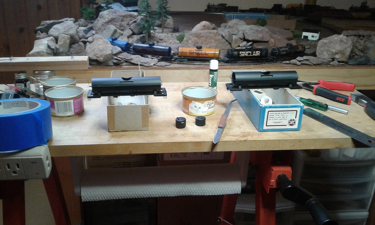

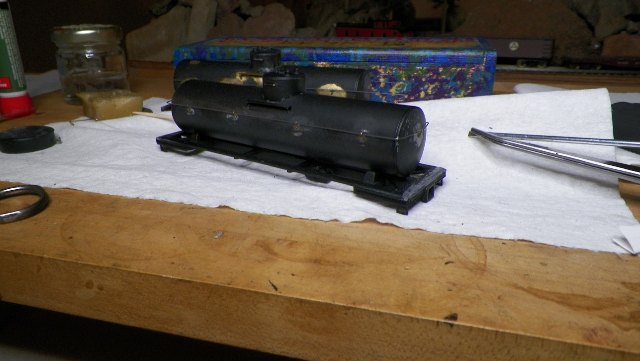

Moving along a bit . . .
 Posted - October 08 2017 :  5:18:46 PM Link directly to this reply  Show Profile  Add Barry to Buddylist

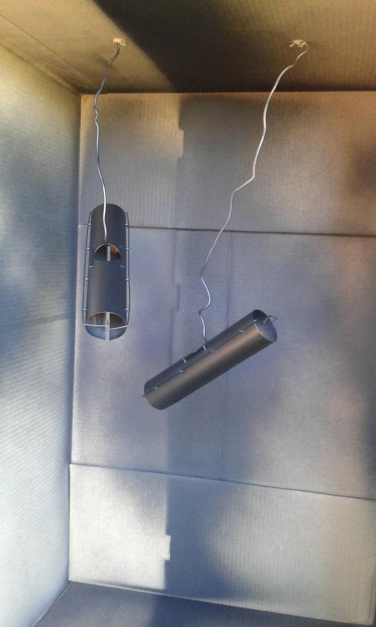

Sunshine . . . out to spray. In this rush, I see a flaw or two I'm going to need to get after. We're maybe gonna have snow tomorrow, so that was the rush.

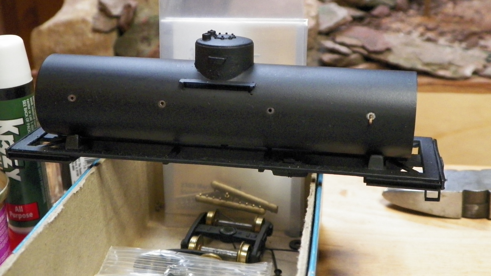

Started assembly on the most beat up one. For me, this tank car is the most tedious car I've done in a while. Thought the home made hand rail was in a decent position, but it wasn't and it's pretty much locked in place. Also, knocked a couple stanchions loose messing with the hand rails. I'm going to try and bend and trim the hand rails in place and save what's there (versus breaking off the tiny brass strip that's used for the stanchions; don't really have enough left to do all eight. I am happy, thought, that I think a flat black tank car will work for what I'm trying to image. We'll see when it's all together.

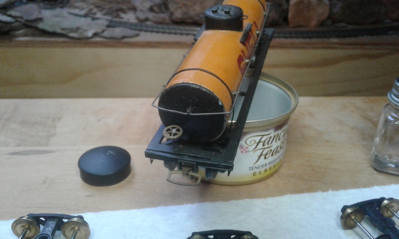

 Posted - October 16 2017 :  1:47:11 PM Link directly to this reply  Show Profile  Add Barry to Buddylist
This first photo shows the work done by a modeler of maybe 50 years ago. I'm looking at the way the hand rails are brought together in the middle of the end. I consider this example pretty darn tidy compared to the mess I was making.
Being dissatisfied with my ability to get things at least that tidy, I pulled everything apart. After looking at a bunch of prototype tank cars (just got a neat book from the library about ACF with many photos of tank cars they produced over the years), and also looking at an array of model tank cars, I do believe the Mantua Metal Products model can be improved on without destroying the integrity of the model should some purest in the future want to return it to it's factory design (more likely it will end up in someone's trash can when the kids are going through my stuff post-mortem). I didn't see any recent plastic models that didn't look garish. When I looked at the brass models, they all seemed to use molded stanchions.
My next step then is to try molded stanchions and connect the handrails in one of the stanchions along the side of the tank, rather than the end. The straight out stanchions are not prototype, but I believe they will look tidier and fit the hand rails a little more closely to the tank and a little more scale.
The last photo is from the book American Car & Foundry Company by Kaminski. If anyone knows where brackets like those in the ACF photo can be found, I would love to know. I briefly thought of trying to make something like that, but getting 10 of those tiny things to be uniform and not be a mess . . .

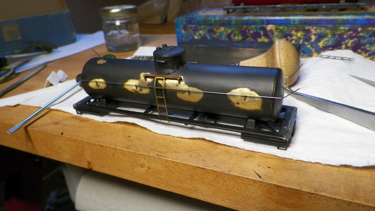

Had an accident while doing the handrails on the second car; broke off one of the end brackets. So, I got to learn how to make a repair drilling out the previous bracket mounting plug . . .
I'm thinking of doing the ladders differently than suggested in the Mantua instructions, and having them go to the valve access platform, instead of stopping at the handrail . . .
There are prototypes both [all ways]. It would help the model to go all the way to the platform instead of only to the lighter weight handrail.
