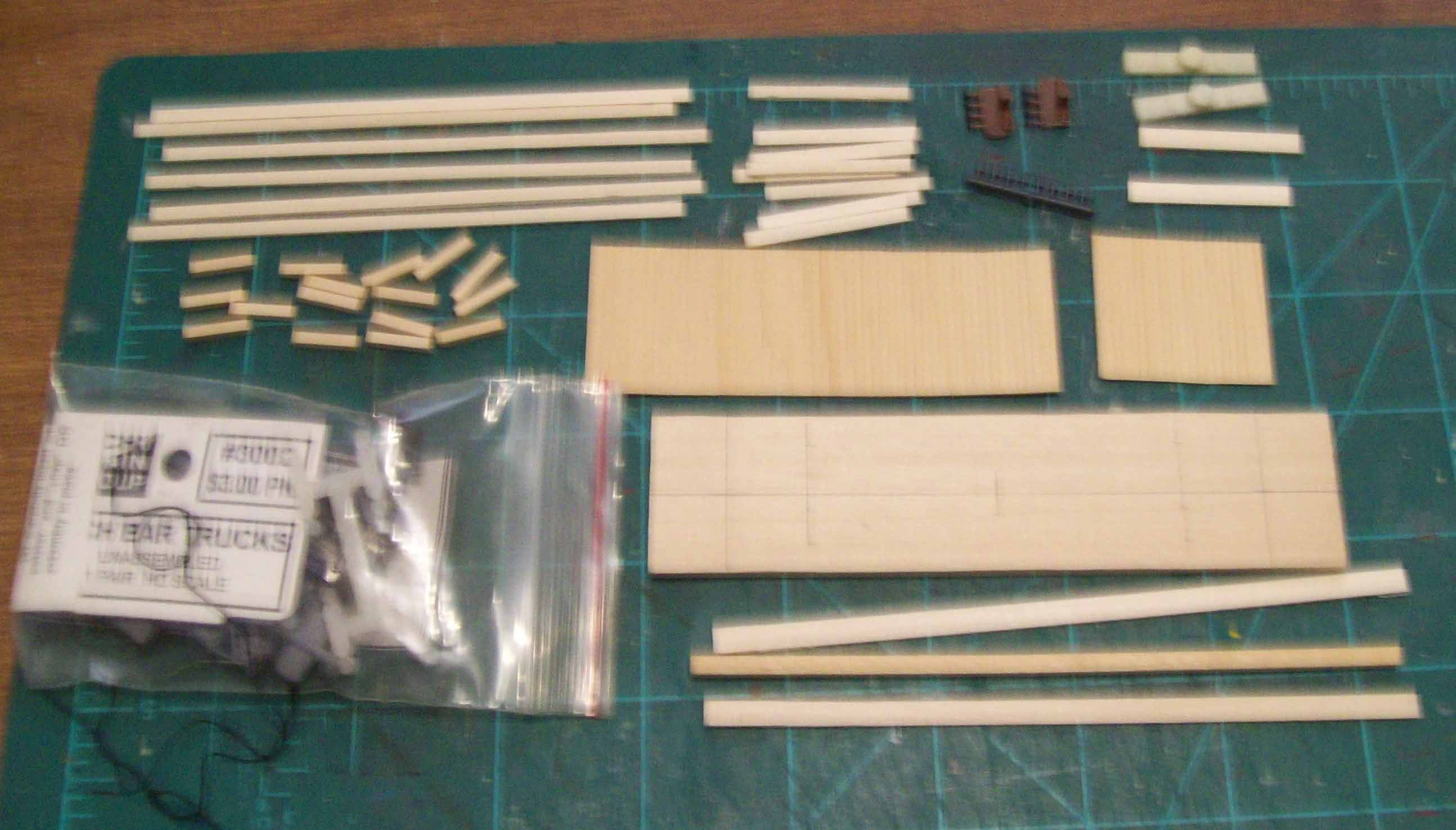

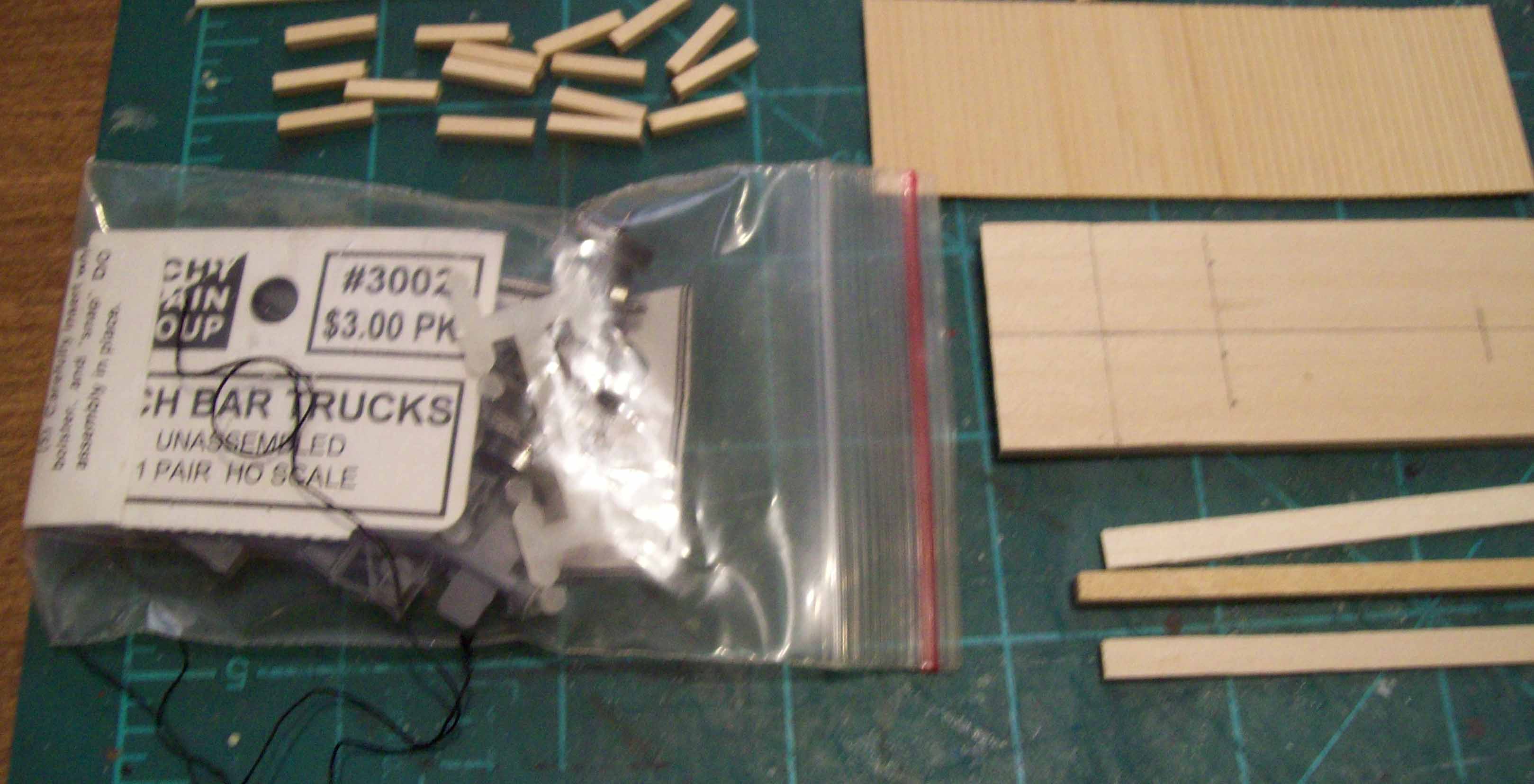

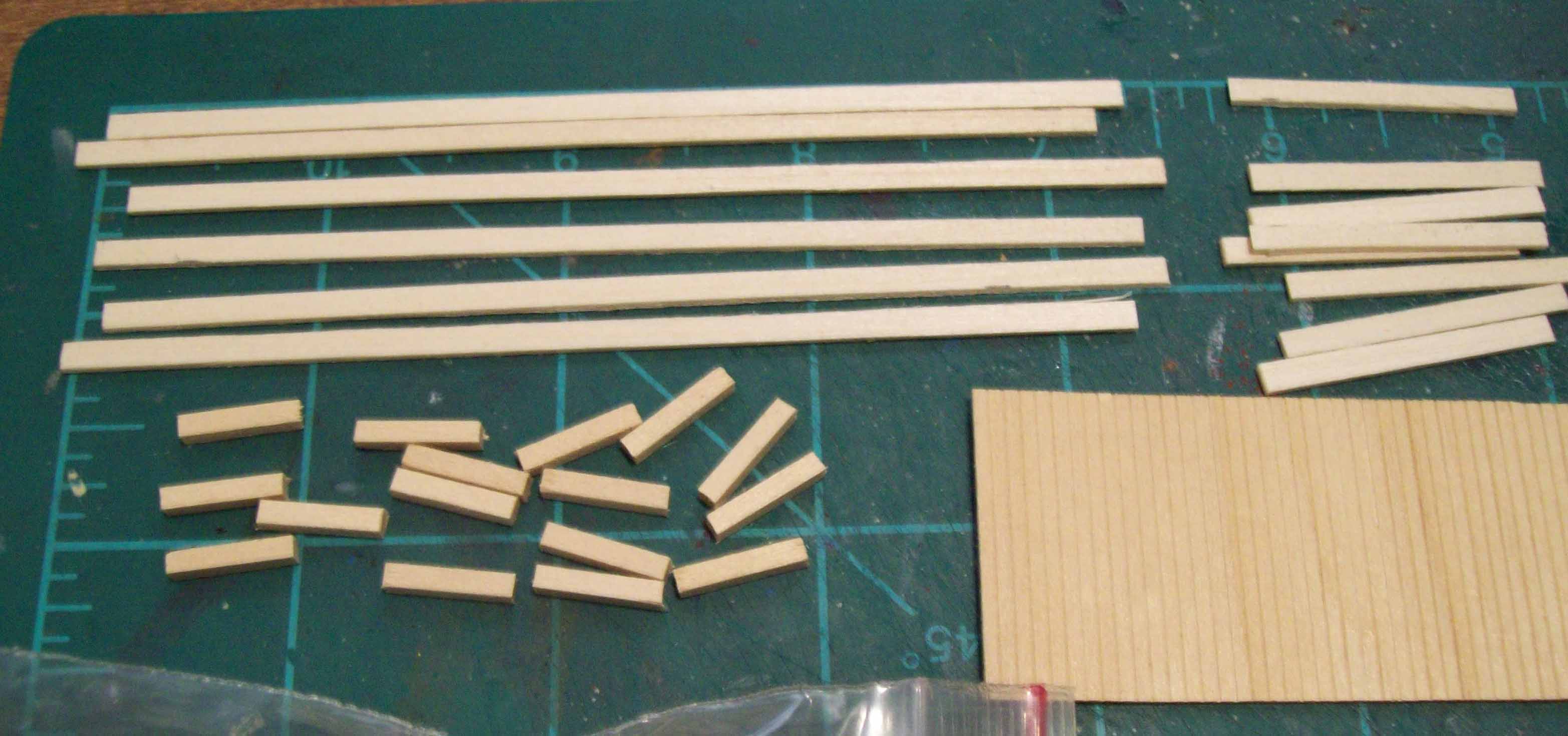

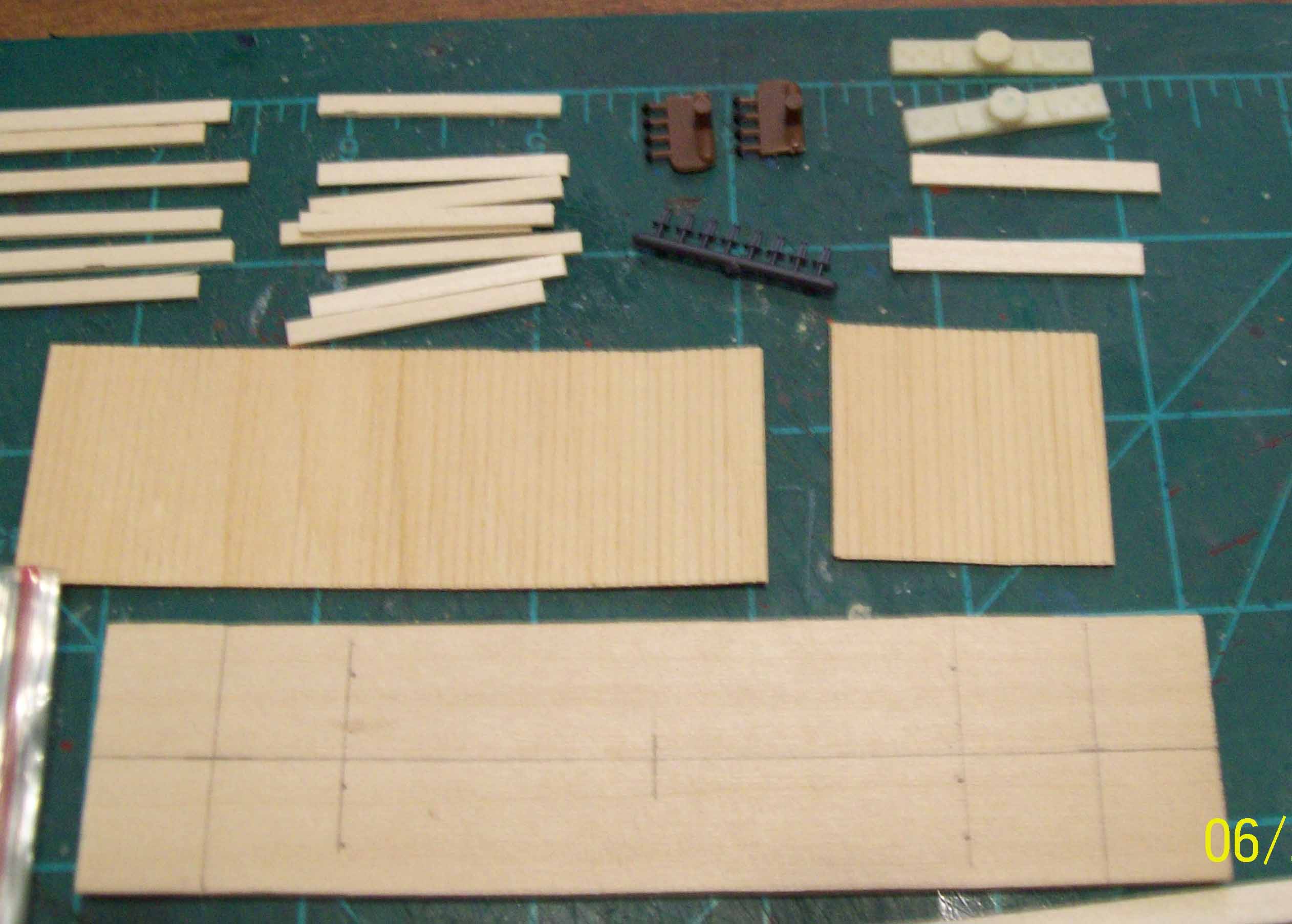

I used a copy of the Huff n Puff plans from my flat car to put together their gondola and coke
car kits. They all use the same basic frame and floor and different bodies.
This is the kit for the Gondola
Materials:
stripwood basswood, Hobby Lobby
scribed wood Northwest Lumber
queen posts Grandtline
truss rod ends Grandtline
trucks Tichey Train Group
bolsters made from my molds
Progress so far:

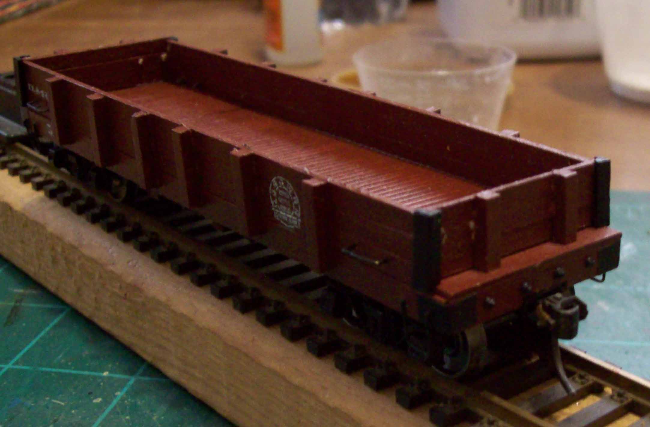

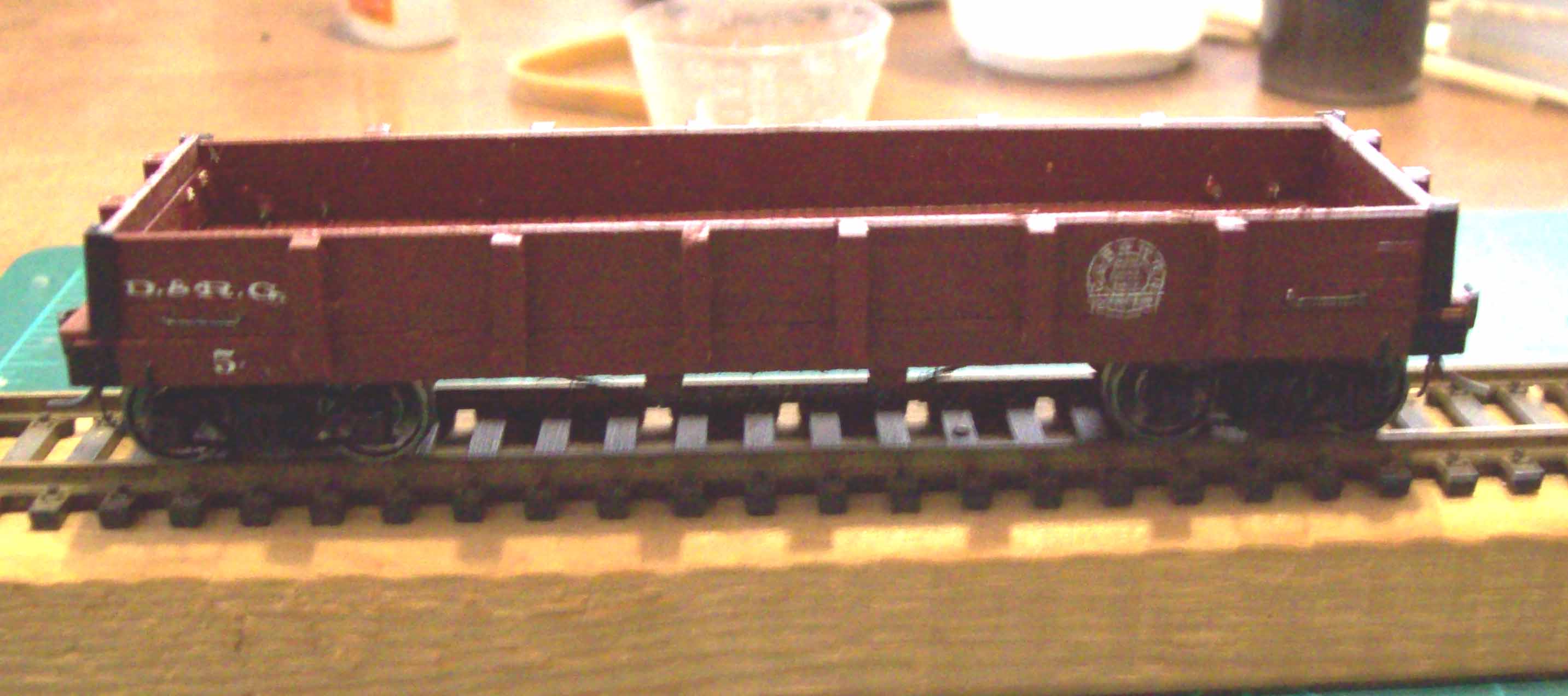

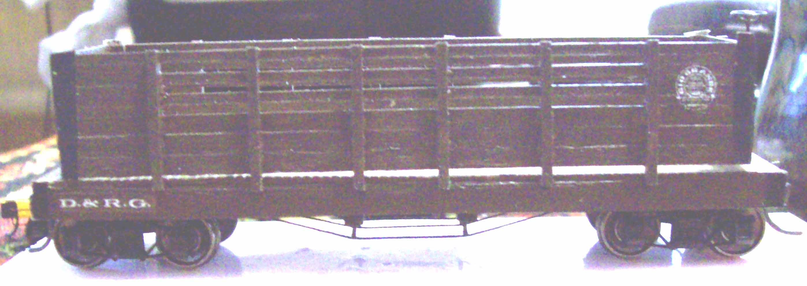

Finally got it finished. Had a few adjustments to make, but got'em done.
 Posted - July 01 2017 :  08:27:58 AM Link directly to this reply  Show Profile  Add scsshaggy to Buddylist
Nice looking car! That turned out well.

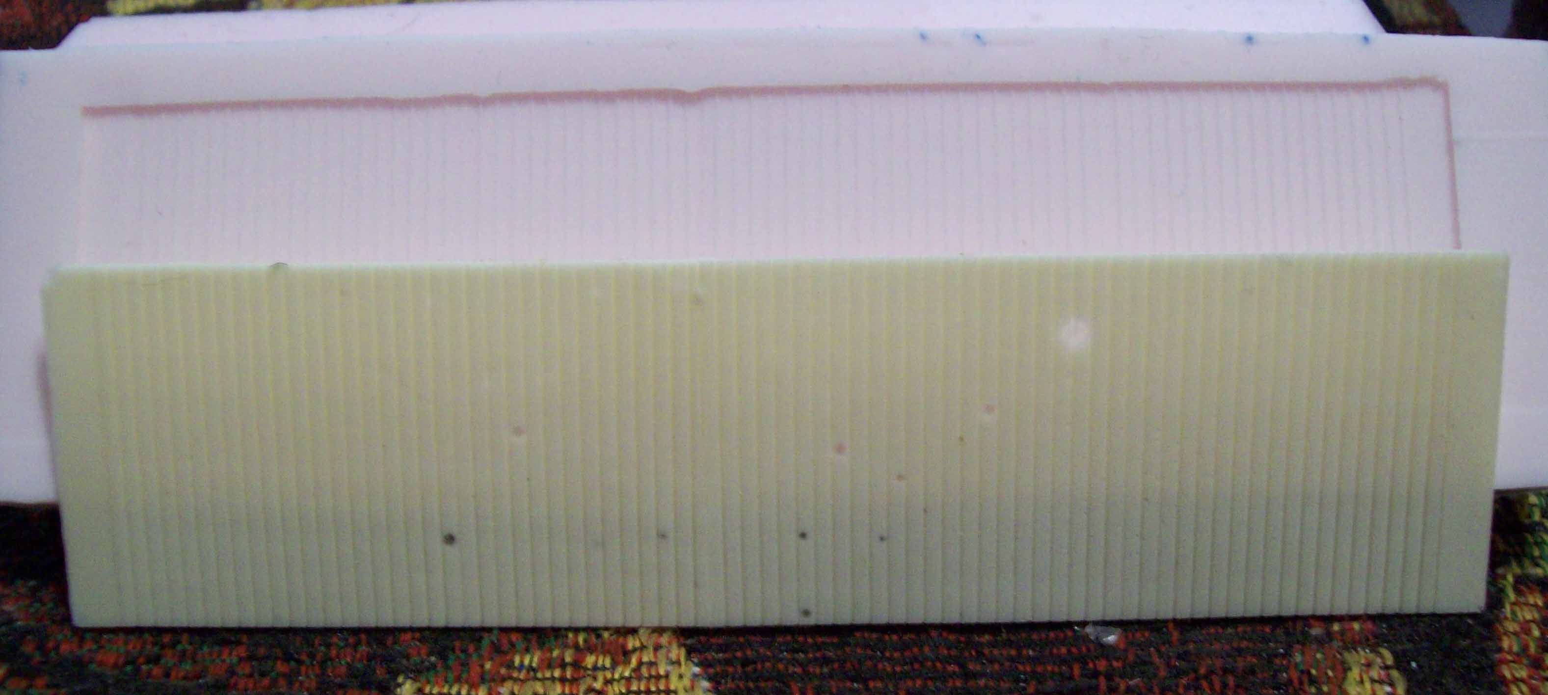

Well, I finally got to finish up with this project. I got to figuring that since they all use the
same frame/floor, why not make a mold of it and just make a complete one out of resin.
That would save a lot of time and material, so here is the results...

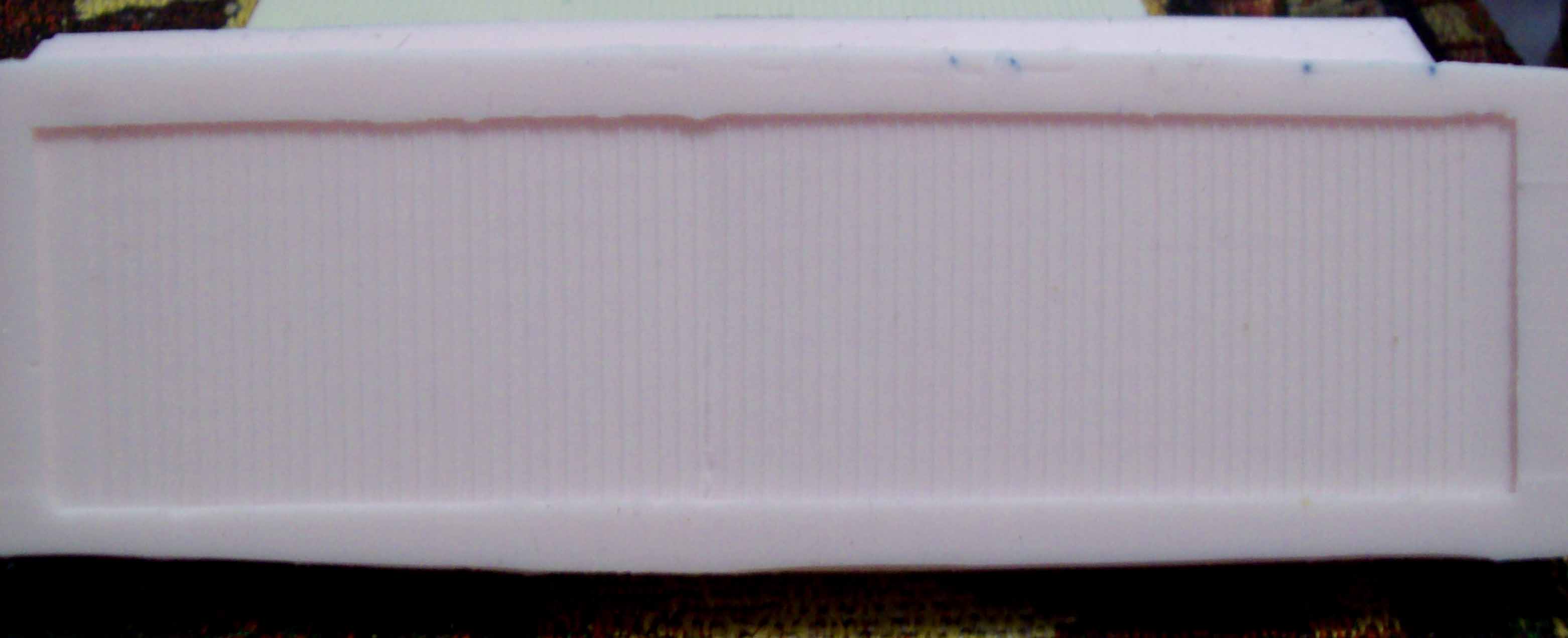

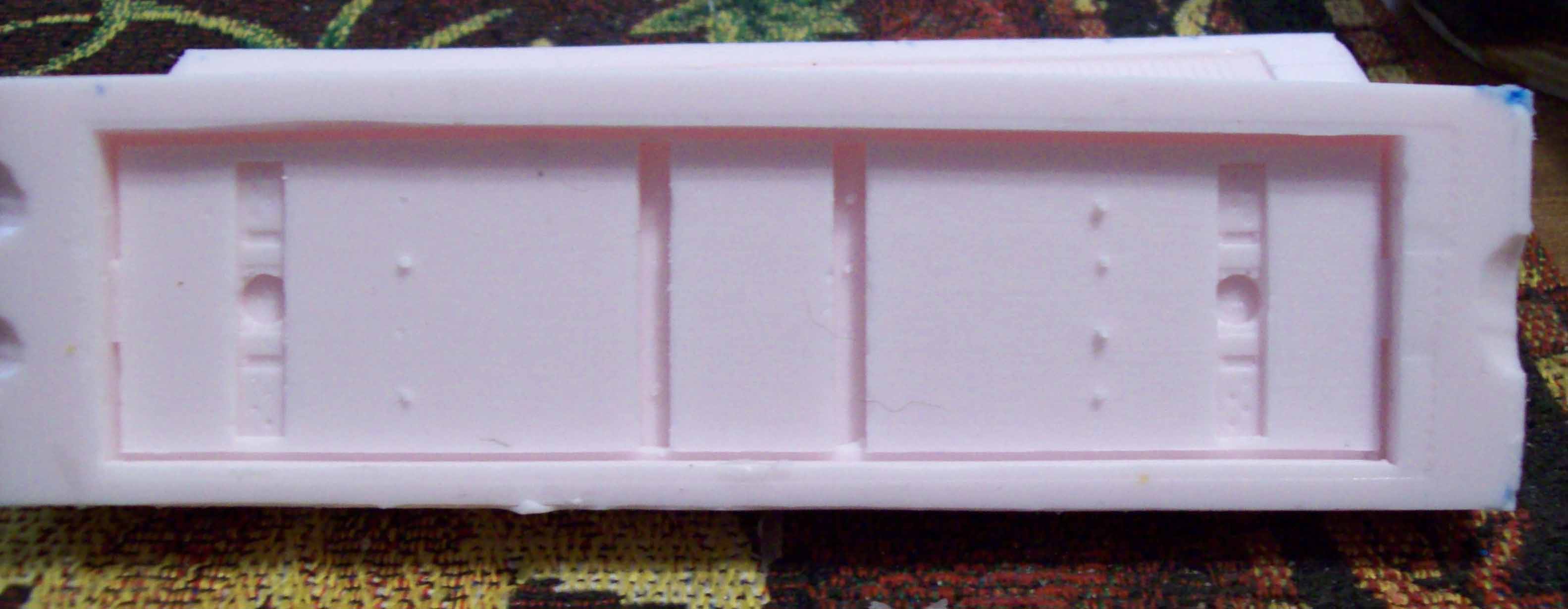

This is the mold of the underside of the frame.

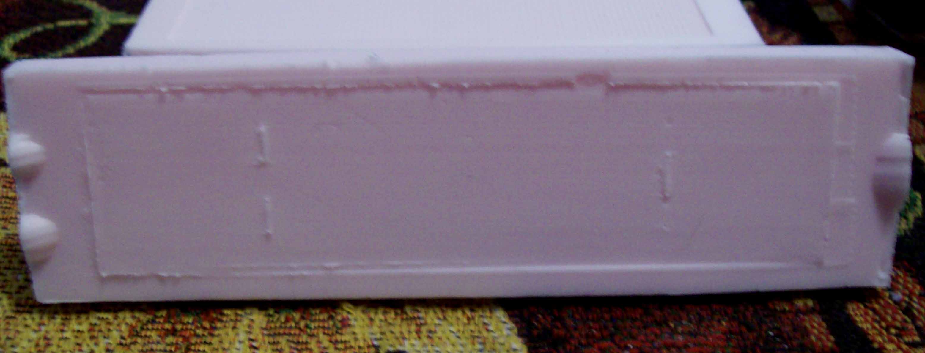

This is the top part of the mold for the frame.

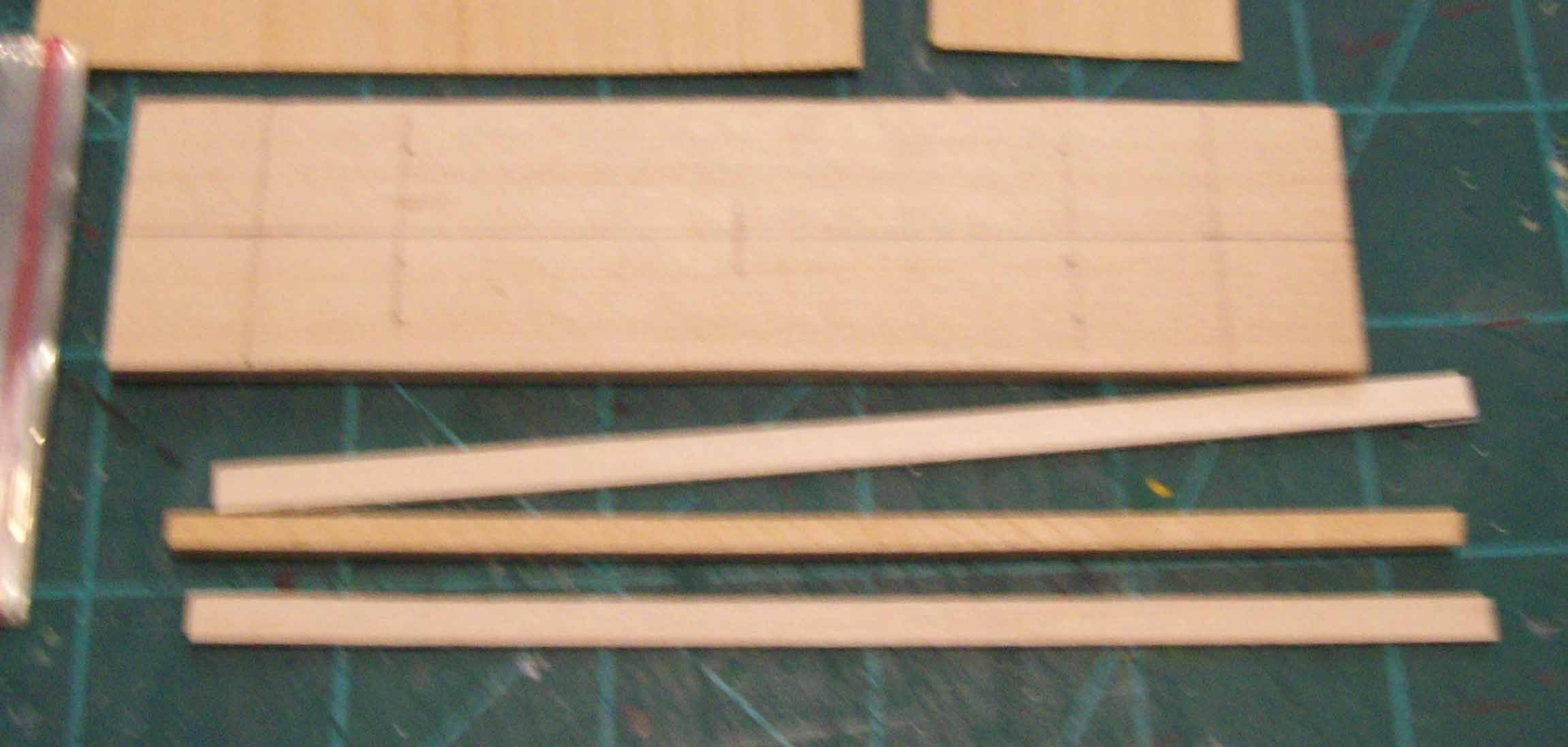

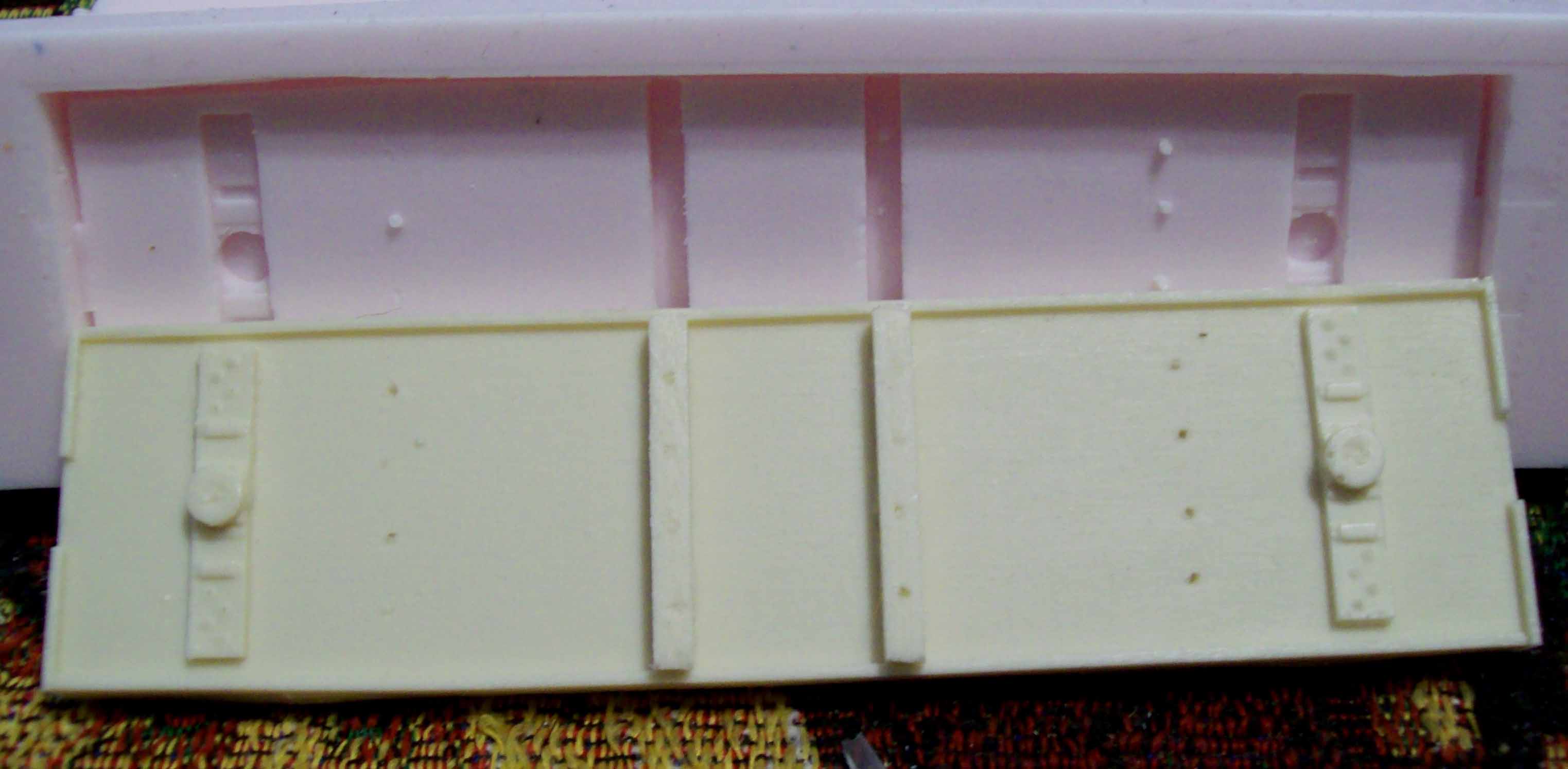

The floor of the car (used for flat cars, gondolas and other open cars.
Castings from molds.
Finished product.

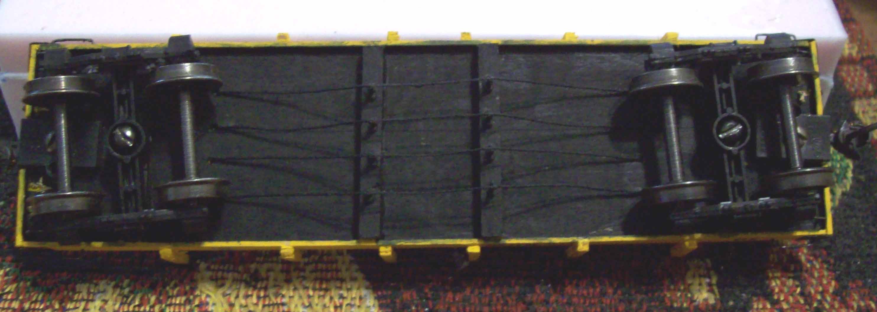

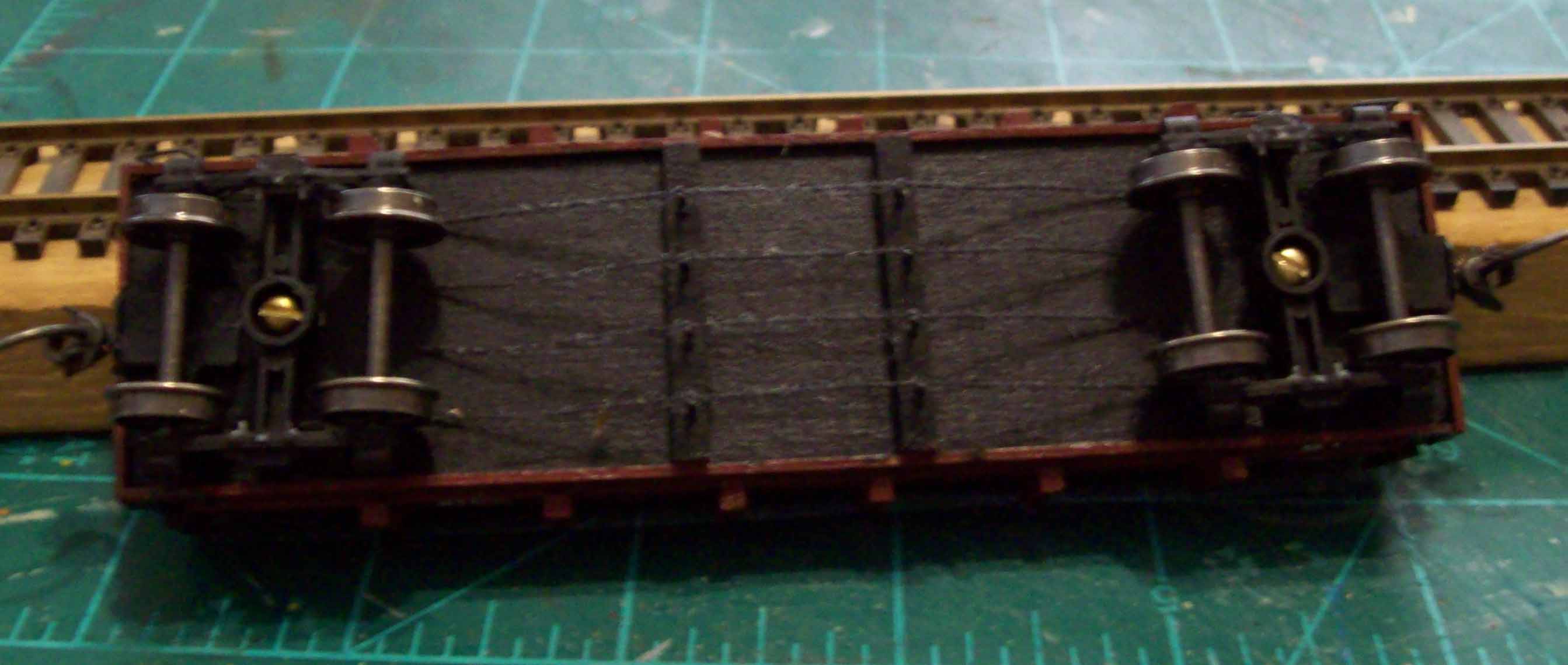

Original wood base.
Cast base.
Original model.
Model using cast base.
Overall, I think this project worked out just fine. It saves time and materials and still looks
good. I will probably use these bases for other models I have planned.

Thanks guys. I used the Alumilite silicon mold material and their resin. The silicon does pick up
EVERY little detail that is on the master, even the mistakes are truthfully replicated.
