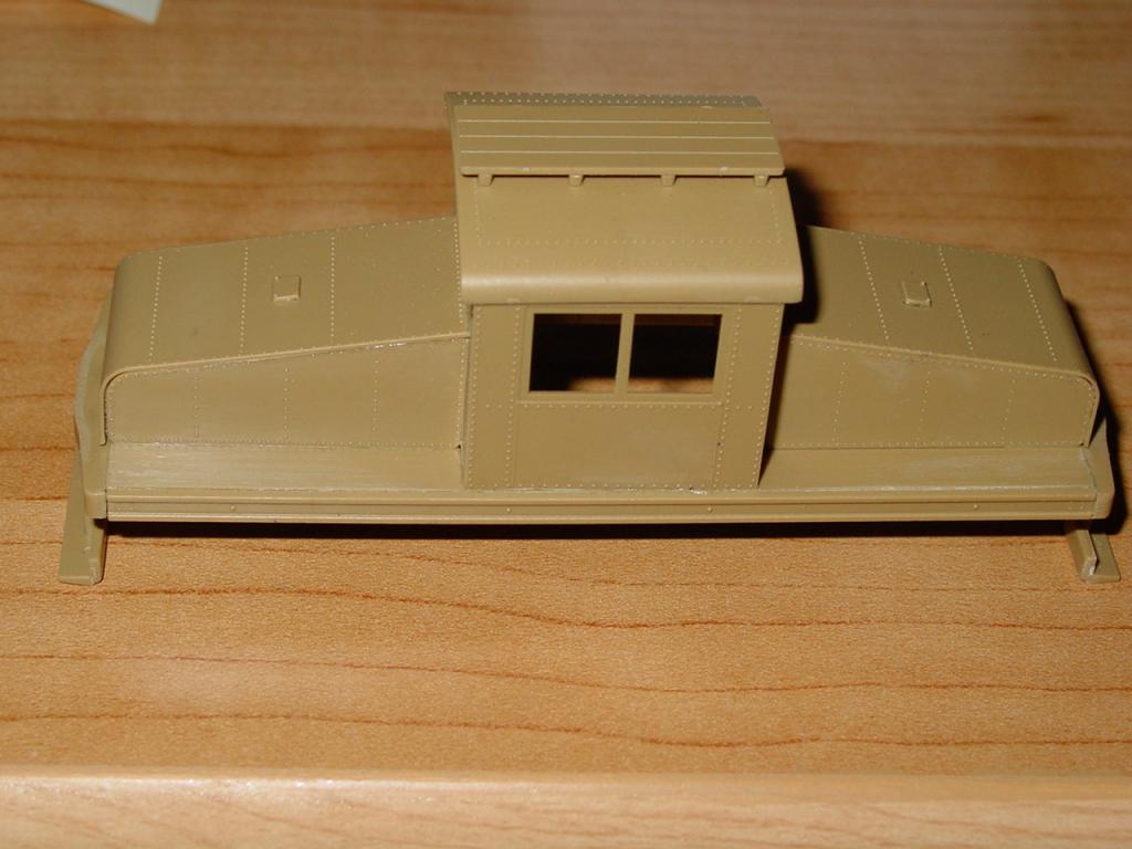

One of my gifts this Christmas was an HO scale GE Steeple Cab body kit by Cannonball. The plastic body is easy to assemble and makes a nice looking, easy to customize base for a project.
I have a bunch of details on order at my LHS, but I'll also be making some parts from scratch. Not going for a specific prototype, but it'll at least look believable.
Cannonball includes a simple frame for mounting two Bachmann 44-Tonner trucks (old style), but they're too tall as is. AMB makes a nice lowering kit for better realism. The other option is to use quality power trucks, such as the NWSL Stanton drive, but that's $170 for all wheel drive...
Forget that! I'll do it MY WAY!!!

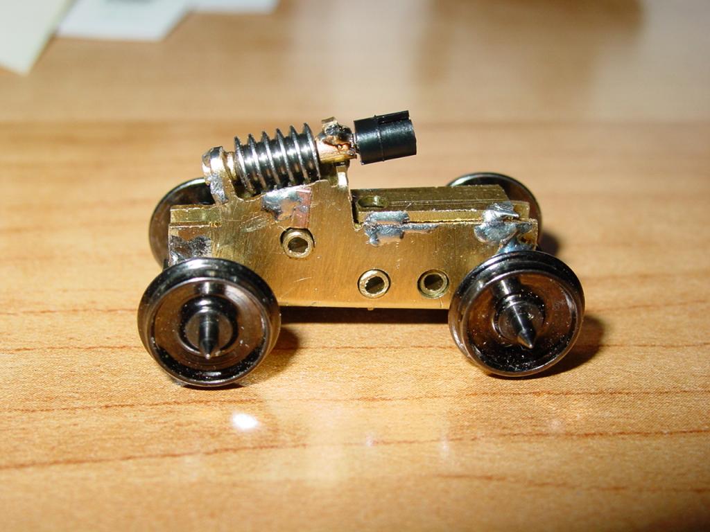

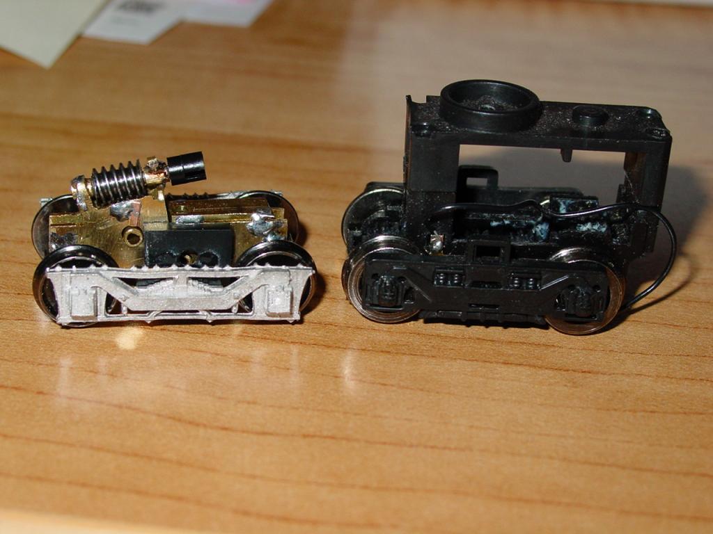

I'm making my own chassis using a motor and gears by NWSL, brass sheet and tube by K&S, and wheels by Intermountain! I'm using 72DP gears with a 20:1 ratio. Getting everything meshed perfectly has been exceedingly difficult, but I've got one truck put together and working smooth so far. I'll take pictures of the other truck during assembly so you can see my design.
Here's the finished truck (minus paint) next to a Bachmann truck with the motor removed. Quite a difference in size! The NWSL geared truck should also run smoother, and the size difference will allow me to add more weight.
This chassis is still costing me around $100 and a lot of time, but it should all be worth it in the end.

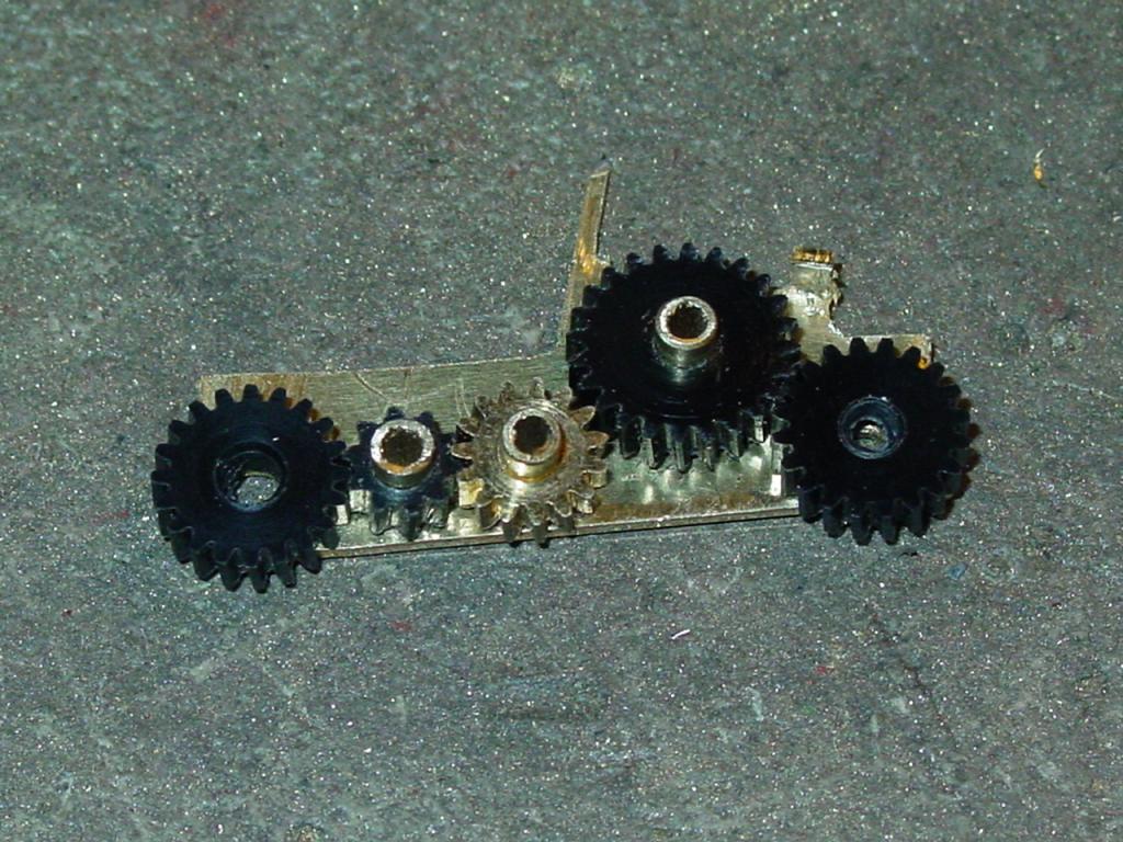

Gotten a lot done in the past week! Here's my progress.

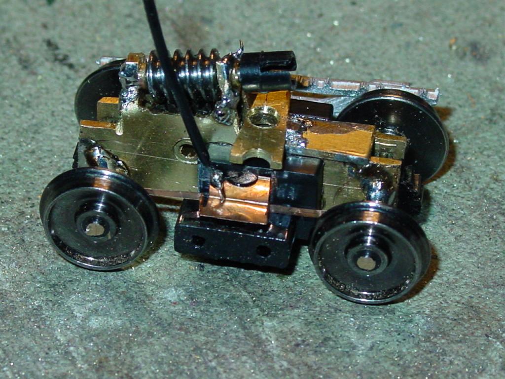

Here's the gearing setup. The main gear is a 24 tooth, the idlers are 15 and 10 tooth, and the axle gears are 20 tooth for a 20:1 ratio. I used NWSL 72DP gearing, since the selection of sizes is really good and they're a bit less expensive than their other gears.
Truck #2 assembled! Half the electrical pickup is through the frame, and the other half uses modified Kadee centering springs as wipers. It's reliable enough that it doesn't even know when it's going over a switch. Only this truck has the wide bolster to stabilize the chassis, and the other truck is more free floating for some equalization on rough track.
The assembled chassis! The motor is a 1630D-9 from NWSL, and it's the largest one I could fit in there. It's smooth, powerful, and efficient, giving the chassis excellent running characteristics. I was originally going to put some flywheels in there, but my calculations were off and they didn't fit. Oh well, it's so smooth it doesn't actually need them anyway.

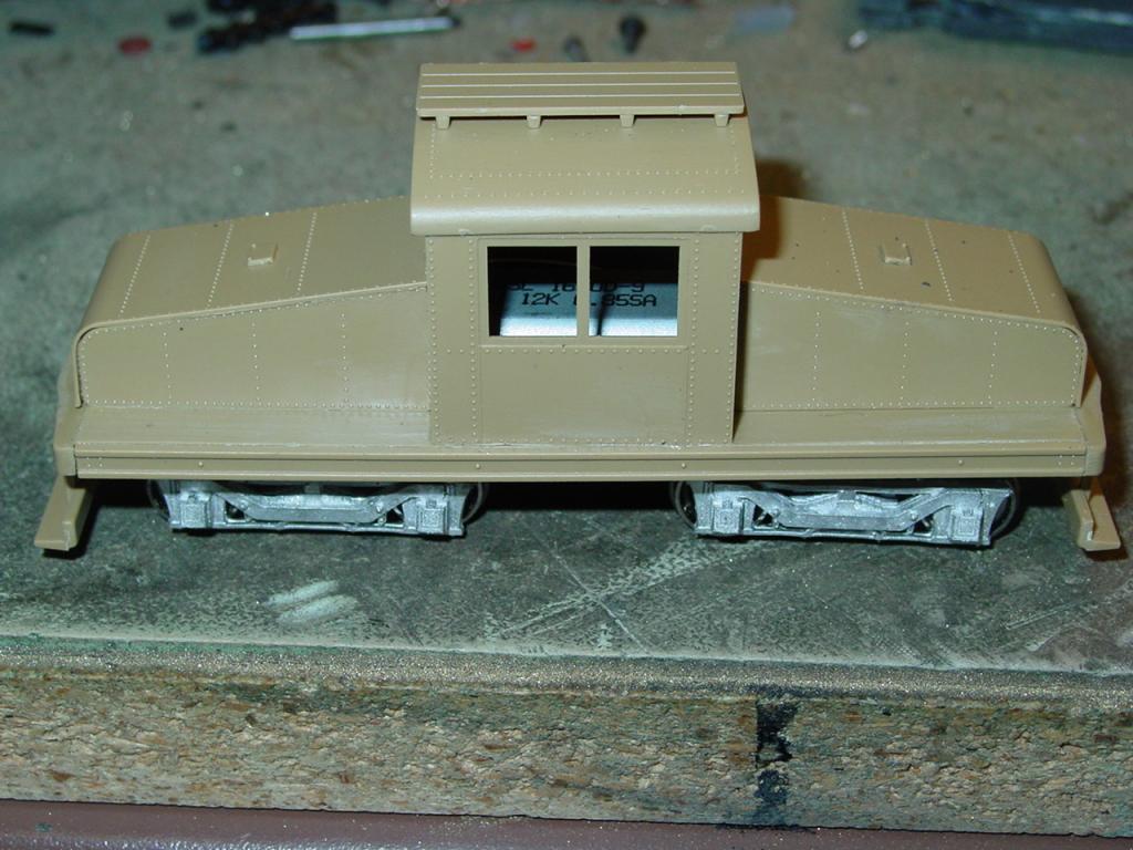

Quick look with the shell sitting on top.
To mount the shell to the frame, I tapped a couple 2-56 holes on each end of the shell and used Kadee plastic 2-56 screws. You'd think plastic wouldn't do much, but this is actually really sturdy!

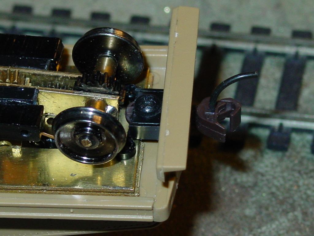

One coupler mounted! Because of the tight spacing, I can't use standard Kadee couplers. Until I get some Whiskers, I've got a Bachmann (McHenry) in there. The mounting height is perfect according to a Kadee height gauge! Again, plastic screw in a 2-56 hole tapped through the shell.

Darth,
NICE! Impressive work on the gearing of that truck!
 Posted - January 14 2014 :  1:19:45 PM Link directly to this reply  Show Profile  Add Barry to Buddylist
Hey Darth, That is some very respectable engineering and micro-machining. Man, I'd think you'd have to use a surgical robot to do that stuff. Regarding that noise business, I personally have sort of gotten into the noises these little locomotives make. I mean, what the heck, real locomotives make noise. And it's diagnostic value. And just the fact that when it's runnin' nice, you can kick back and listen to it purr or whatever, like you're enjoying a ride in your favorite just-tuned hot rod. Again, cool work. And thanks for the photo-story. If I ever get so bold as to attempt anything even half-way as adventurous, posts like yours will certainly be an asset.
 Posted - January 14 2014 :  2:27:26 PM Link directly to this reply  Show Profile  Add scsshaggy to Buddylist
Darth, thanks for posting all that. It's fun to see how you meet the challenges of fitting all that mechanism into such a small engine. I've never built anything quite so audacious, but the things I have done help me appreciate the skill and attention that go into something like that.

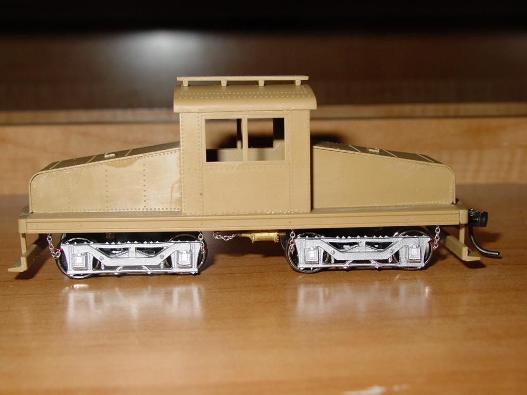

Just a little update today.
I painted the trucks silver, the frame and motor black, and added chains to all the trucks as I've seen on some prototypes. I'm also starting on some of the detail. These were probably the most tedious parts to do. The rest should be a little easier.

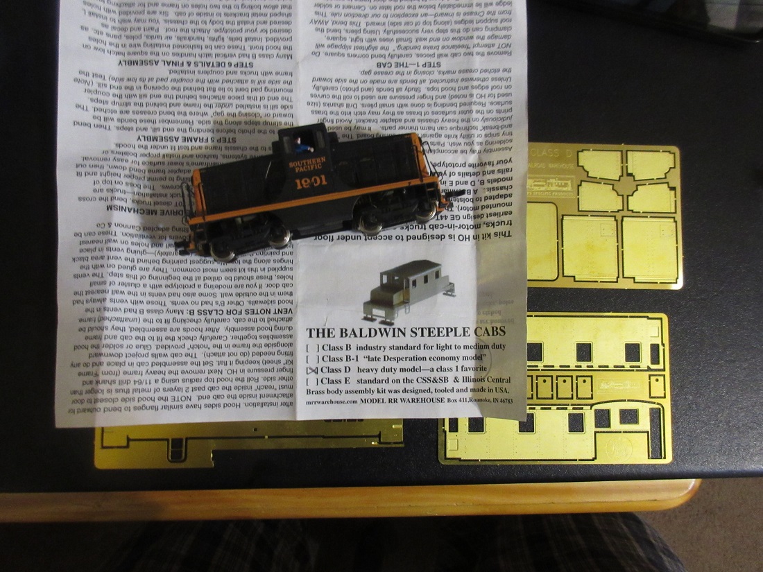

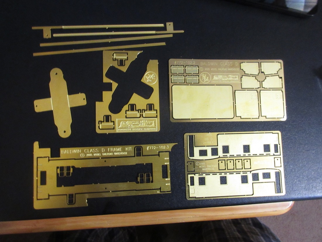

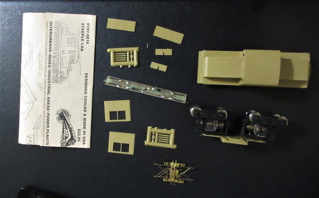

* The steeple cab is starting to look good. I spent the last 20 minutes looking for photos of the one my son made and can't find them. I still have the same project in a box waiting for me to build it. It is a cannon ball kit. I gathered the main thing necessary for it. The Bachmann GE 44 T drive is suggested as the loaner drive for it.
* This goes right there with other projects waiting to be done.
Here are my steeple cab projects. one cannonball kit and a larger brass kit by Red Ball.
This is what I have for my Cannon Ball project.
Edited by - toptrain on June 09 2017 06:33:20 AM
 Posted - June 08 2017 :  07:14:12 AM Link directly to this reply  Show Profile  Add toptrain to Buddylist
This is what I have for my Red Ball Steeple cab project. I will use the same loaner drive (Bachmann GE-44-ton) for this project.
