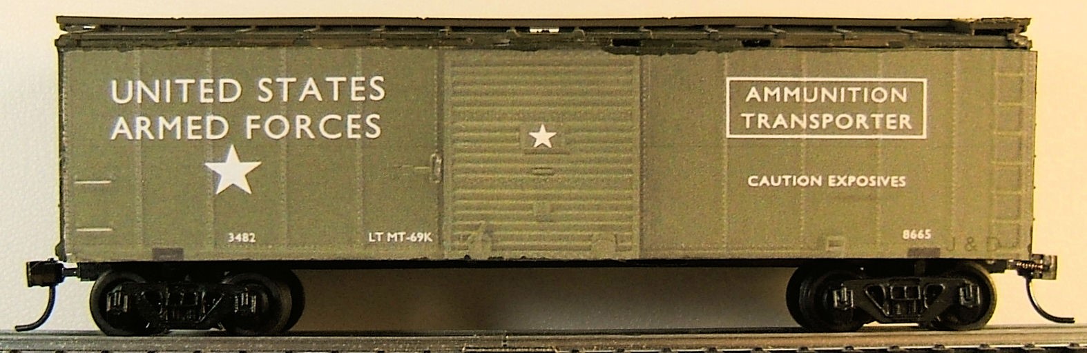

Progress updates:
And
The green isn't quite right, but it'll do for now.
Edited by - ZeldaTheSwordsman on December 22 2016 10:55:29 AM
 Posted - December 22 2016 :  12:00:51 PM Link directly to this reply  Show Profile  Add Barry to Buddylist
That's pretty slick Zelda. I'm assuming you made all the hardware for the doors as well.

That I did. I drew the basic hinge shapes on card, poked holes through them so that the dimples from the holes would act as rivet/nailhead detail, then after cutting those out and gluing them on I glued a snippet of wire where the joint in the hinge would be.
The locking bars are lengths of paperclip with the ends and middle wrapped in strips of paper, with a wire snippet glued off to the side for the handle. A snippet of paper glued over that represents the catch.
 Posted - December 22 2016 :  8:01:04 PM Link directly to this reply  Show Profile  Add Redwoods to Buddylist
It is turning out very nicely Zelda. I like how you made the hinges. The stirrups are fine too.

Thanks. The stirrups are made from heavy staples - those are flat wire instead of round, so they're a godsend for stirrup-making.
 Posted - December 23 2016 :  3:29:16 PM Link directly to this reply  Show Profile  Add microbusss to Buddylist
funnier if you left the ads you cut out on the boxcar
 Posted - December 24 2016 :  11:23:35 AM Link directly to this reply  Show Profile  Add Chops124 to Buddylist
Brilliant. I rather like the green- it is vivid.
