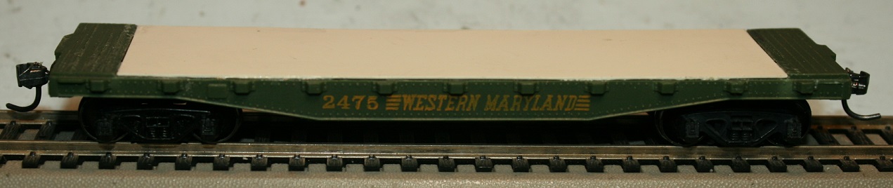

First remove the "skid" portion of the flat car deck. I used a band saw but a razor saw will work too.
Second, fill in the hole in the deck with a piece of styrene sheet plastic.

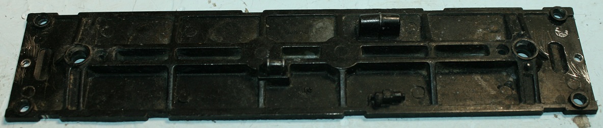

Third, using a drill press or a hand held drill, drill and tap holes on the ends of the frame for Kadee Coupler draft gear. If you want to use different trucks, refer to my Plug Door Rebuilding Program thread about drilling and filling the truck mounting bolster holes. I chose to replace the original coil spring freight car trucks with caboose trucks with leaf springs to simulate a car built for a smoother ride.
Note that I prefer to use the original metal underframes for flat cars and gondolas for weight purposes. Don't have any skid flats with metal underframes? Remember that all Tyco 40 foot cars (Box cars, reefers, gondolas, and skid flats) used the same interchangeable underframe, if your skid flat has a plastic underframe you can salvage a metal underframe from one of these other car types.

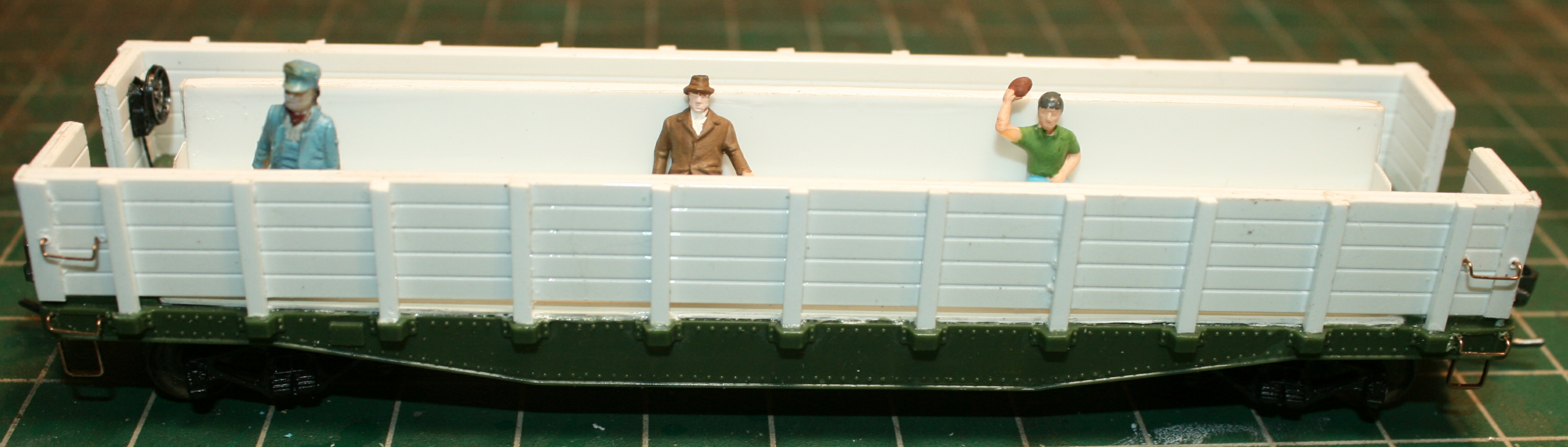

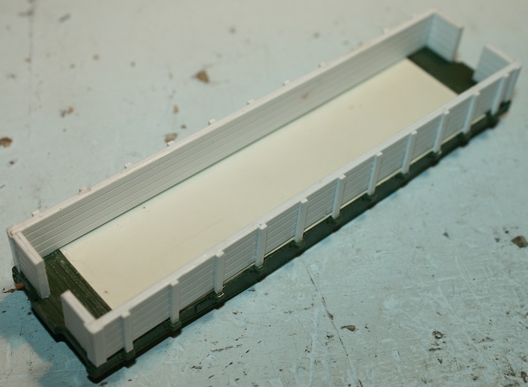

Using Styrene strips and sheets, make gondola walls to enclose the deck. Note how I used the side sill stake pockets to secure the vertical stiffeners. Be sure to leave a passage way on the car ends, most open air cars of this type need to be coupled to a caboose or passenger car with steps and end platforms so that passengers can get on board the train. Once on board passengers can enter the open air excursion flat from the ends.

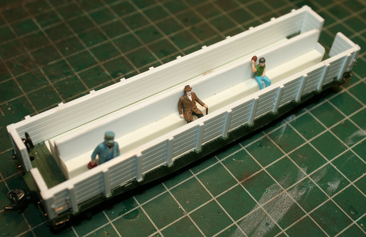

Sometimes open air cars are set up for standing passengers only, but if you prefer, a bench can be fashioned out of styrene as well. Use a scale rule and some HO scale figures to determine the proper dimensions for realistic looking seating. I chose to make a bench with a back rest but plain jane plank style benches can work too.
Lastly, don't forget to add mandatory safety appliance details for a final touch. Remember that your excursion car needs a hand brake, grab irons, and stirrups just like any other freight car. Refer to pictures or models of gondolas for placement ideas.

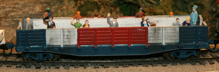

Well I got my excursion car painted....
I chose colors that would look nice running with my "Spirit of 76" Ten wheeler and coaches.
I see on closer inspection that I had some red paint bleed through onto the white areas. I may have also over weathered the car but I wanted to simulate the appearance of an excursion car that was being pulled by a soot spewing steam engine. The figures I used were ones I happened to have on hand but some of them may be a bit over dressed for a steam excursion.
Let me know what you think, should I repaint my car or leave it as is?

 Posted - December 21 2016 :  9:46:24 PM Link directly to this reply  Show Profile  Add JNXT 7707 to Buddylist
Originally posted by Srenchin - December 21 2016 :  6:59:11 PM
Leave it as it is! Excursion cars are many times painted by volunteers, and not all volunteers are professional at the task they are asked to do. Perhaps they got a little distracted?
Incredible job, thanks for posting it.

 Posted - December 21 2016 :  10:32:25 PM Link directly to this reply  Show Profile  Add ZeldaTheSwordsman to Buddylist
I think you should repaint it, if only to take care of the overweathering. It may be being pulled by a steam engine, but from what I've seen railroads that offer excursions do try and keep the equipment looking smart. And since this is supposed to be a bicentennial excursion car, well...
 Posted - December 21 2016 :  11:52:36 PM Link directly to this reply  Show Profile  Add scsshaggy to Buddylist
From an insider's perspective, how clean, or perfect or well maintained things are usually depends on the staff of a place. Where I volunteer, I have said (partly, but only partly, in jest) that things would be as dirty as the underside of a rotten log but for one person on our crew. The weathering is plausible. Steam does put a black haze of soot on things and if you run daily rather than occasional service, it can accumulate. Late in the tourist season, a daily operation can begin to look a bit run down.
As for the tourists' attire, when is your era? 50 or 60 years ago, people dressed up to travel. Things have gotten more casual, of late. I heard of a flight attendant calling the change "when the Clampets came to town."
About the only thing I'd change about what you've done would be to distribute the people less evenly. They should probably cluster in small groups like friends and relatives with the occasional lone wolf and gaps between the groups.

 Posted - December 22 2016 :  1:15:37 PM Link directly to this reply  Show Profile  Add Srenchin to Buddylist
Good points, thank you for the feed back guys!
I agree that tourist railroad equipment can vary in cleanliness depending on the operation. For example, the tourist railroad I used to volunteer for used an oil burning steam loco so there wasn't much soot. However from my experience riding behind coal burning locomotives on other excursion outfits, it's not difficult to see how the rolling stock would be covered in black grime after the end of a single day of operation.
As for era, my car is painted for my "Spirit of 76" train so I guess my era would me the mid 1970's, I suppose that that era could be considered a transitional period for travel wear.
