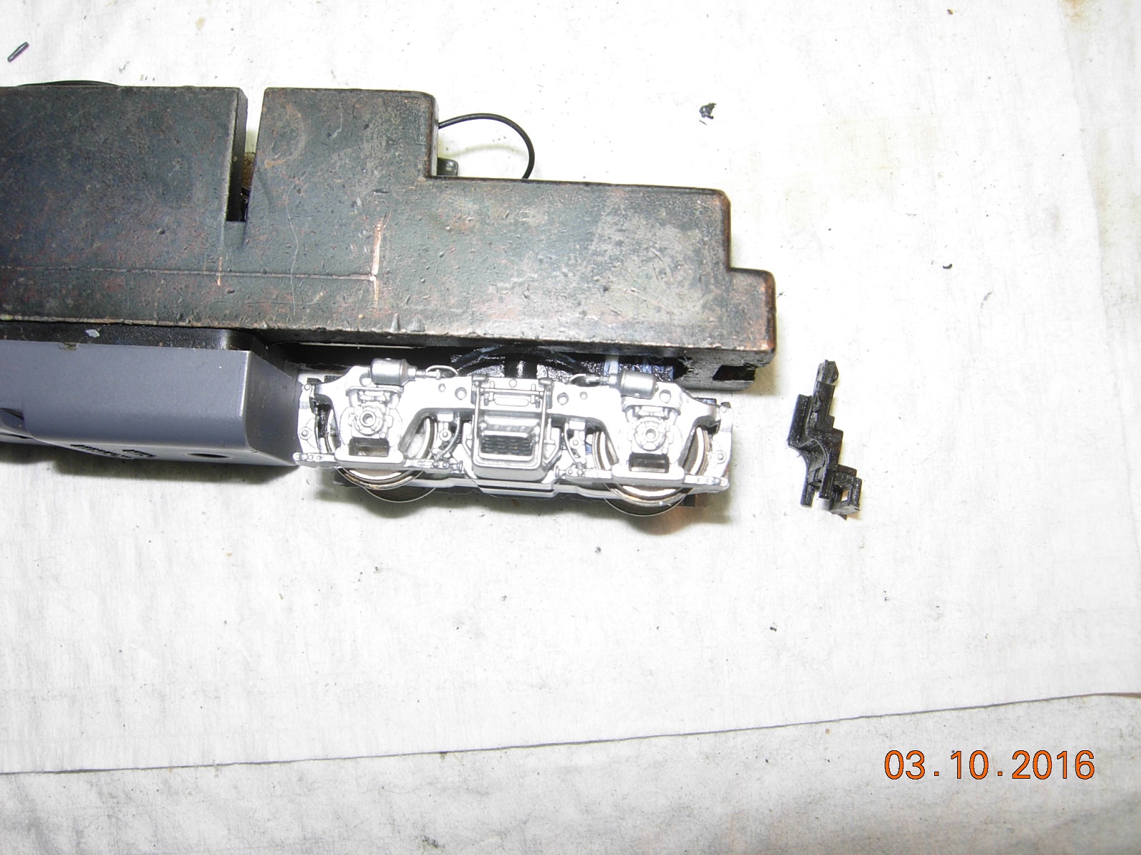

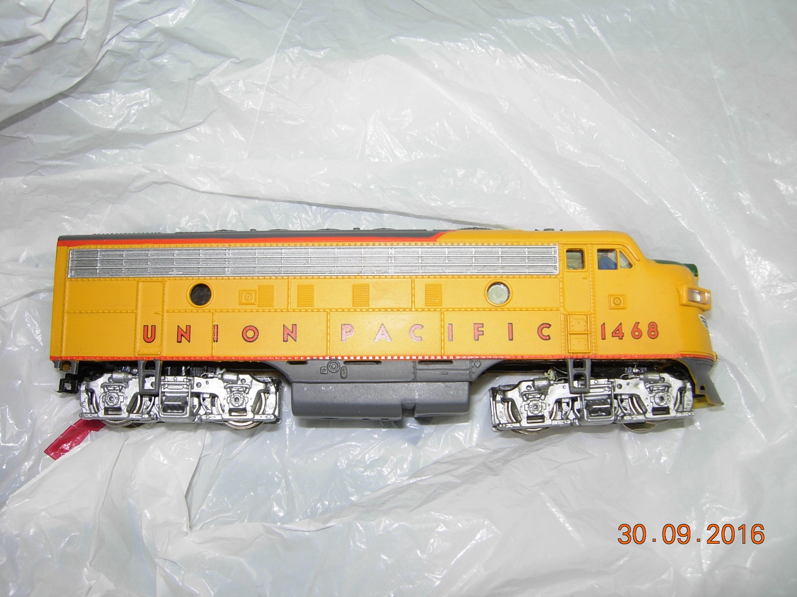

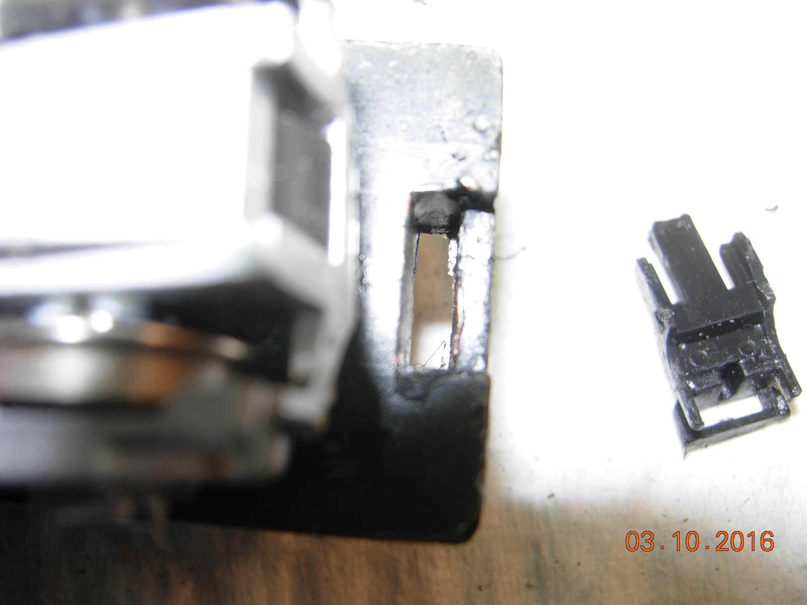

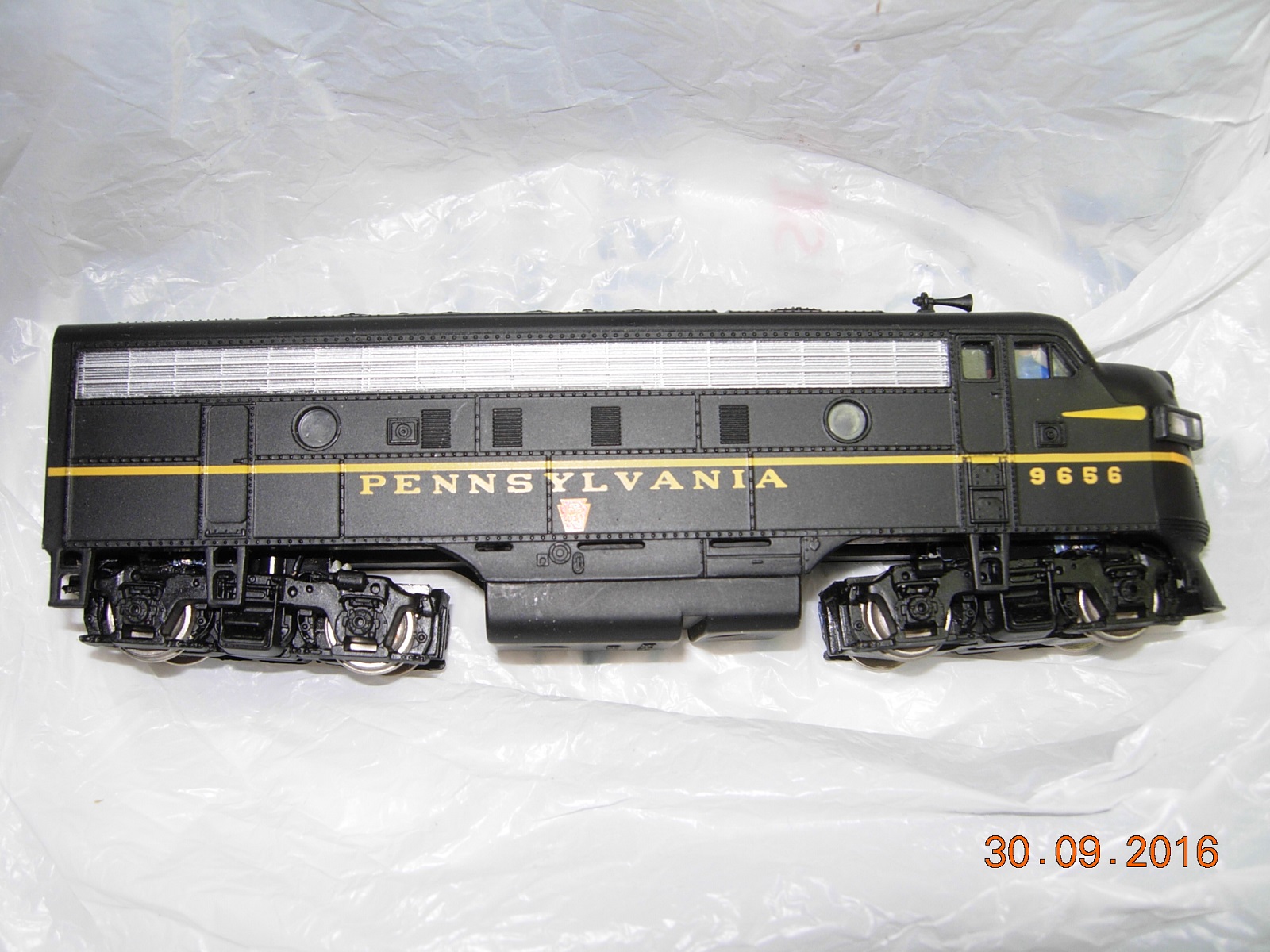

I got these two in a "gift" box recently.
Both are missing the complete coupler mechanisms.
I don't want to replace those, but install something better.
Apparently, Kadee has a part to replace it, with an appropriate screw hole,
but leaves a 5 foot scale gap between units. Meh.
Has anyone retro-fitted any kind of new mounting for couplers on these?
I've considered filling and drilling with styrene, but there's very little room between truck and chassis for this
Evan

 Posted - October 14 2016 :  12:00:44 AM Link directly to this reply  Show Profile  Add gmoney to Buddylist
Just so you know, #452 requires completely shaving off the sideframe mounting tab on the outer end of the truck to achieve the scale 3 foot spacing. The sideframe must then be cemented onto the truck. Since the clearance is so tight, you might have to do the same thing even if you cobble something together.
 Posted - October 14 2016 :  12:50:31 AM Link directly to this reply  Show Profile  Add JNXT 7707 to Buddylist
Originally posted by gmoney - October 14 2016 :  12:00:44 AM
Which is why I still haven't tried installing the #452 I have. I've not quite worked up the courage to do that sort of surgery yet!
So far, the Bachmann locomotives I have are mated to a Globe dummy unit. Globe dummy units have very close coupling, so it works out to an acceptable compromise.
