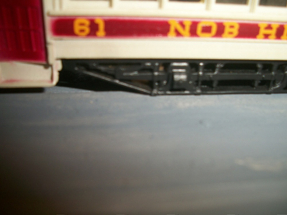

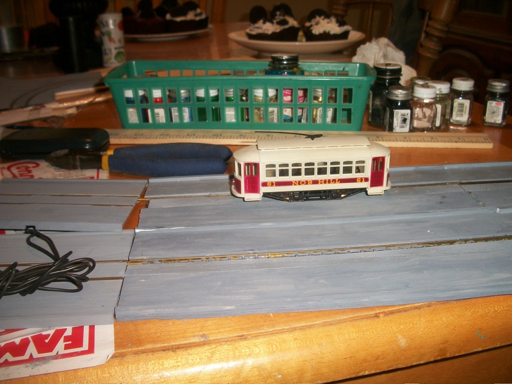

It might appear the chassis frame comes to close to the top of the
street. Too close to call. May end up taking it all up and starting
over...
 Posted - May 25 2016 :  6:57:06 PM Link directly to this reply  Show Profile  Send AMC_Gremlin_GT an AOL message  Send AMC_Gremlin_GT a Yahoo! Message  Add AMC_Gremlin_GT to Buddylist
Yeah, the rails look a bit deeply embedded in that road. Way more than scale for sure. Might need a redo at that.
 Posted - May 25 2016 :  11:18:48 PM Link directly to this reply  Show Profile  Add Chops124 to Buddylist
It hung up immediately, seems that to achieve
clearance I will need to widen the gap on the
outside rail. I thought of using a thinner layer
of balsa, but the tie spikes will raise it up anyways
and cause it to catch.
 Posted - May 26 2016 :  6:14:01 PM Link directly to this reply  Show Profile  Add Chops124 to Buddylist
So, I called the Oracle, and said, Oracle "I hath
bufagoonleyed (botched) the job. And the
Oracle sayeth, "oh, so you're going to sand
it down?"
DUH.

 Posted - May 26 2016 :  10:23:41 PM Link directly to this reply  Show Profile  Click to see DaCheez's MSN Messenger address  Add DaCheez to Buddylist
Originally posted by Chops124 - May 25 2016 :  11:18:48 PM
If you're creating a channel for the track to sit in anyway, why not just rip the rails off the ties and glue them directly to the balsa flush with the outer edges of your channel? That may be more work than it's worth with getting the gauge correct but the end results would look good. Just a thought...
What you have so far looks really good BTW!
Edited by - DaCheez on May 26 2016 10:24:39 PM
 Posted - May 26 2016 :  11:21:48 PM Link directly to this reply  Show Profile  Send AMC_Gremlin_GT an AOL message  Send AMC_Gremlin_GT a Yahoo! Message  Add AMC_Gremlin_GT to Buddylist
Originally posted by DaCheez - May 26 2016 :  10:23:41 PM
Um, #1, balsa has practically NO rigidity worth mentioning, trying to hold naked rails to a piece of balsa wood would be highly impractical in my opinion. A better way would be to buy some thin plastic sheets of styrene or cobblestone or whatever, and glue that down into the inside track gauge as well as outside of standard sectional track. Creating your own "street" basically. I looked at the Tyco 4.5 inch straight piece of trolley track, and was wondering if it could be reproduced with a 3D printer, it's a fairly simple design. and could be done to a regular 9 inch length to use snap track rail to fit in it, too. Just would have to find out what it would cost per section to do that.
Jerry in VA
 Posted - May 27 2016 :  9:31:34 PM Link directly to this reply  Show Profile  Click to see DaCheez's MSN Messenger address  Add DaCheez to Buddylist
You're probably right about the balsa having no rigidity. If I were to attempt it I'd probably just hot glue the rails to the balsa, which would then be attached to a base of some sort anyway. I would think the rails themselves would provide a certain amount of rigidity but having never tried it I'm just guessing.
