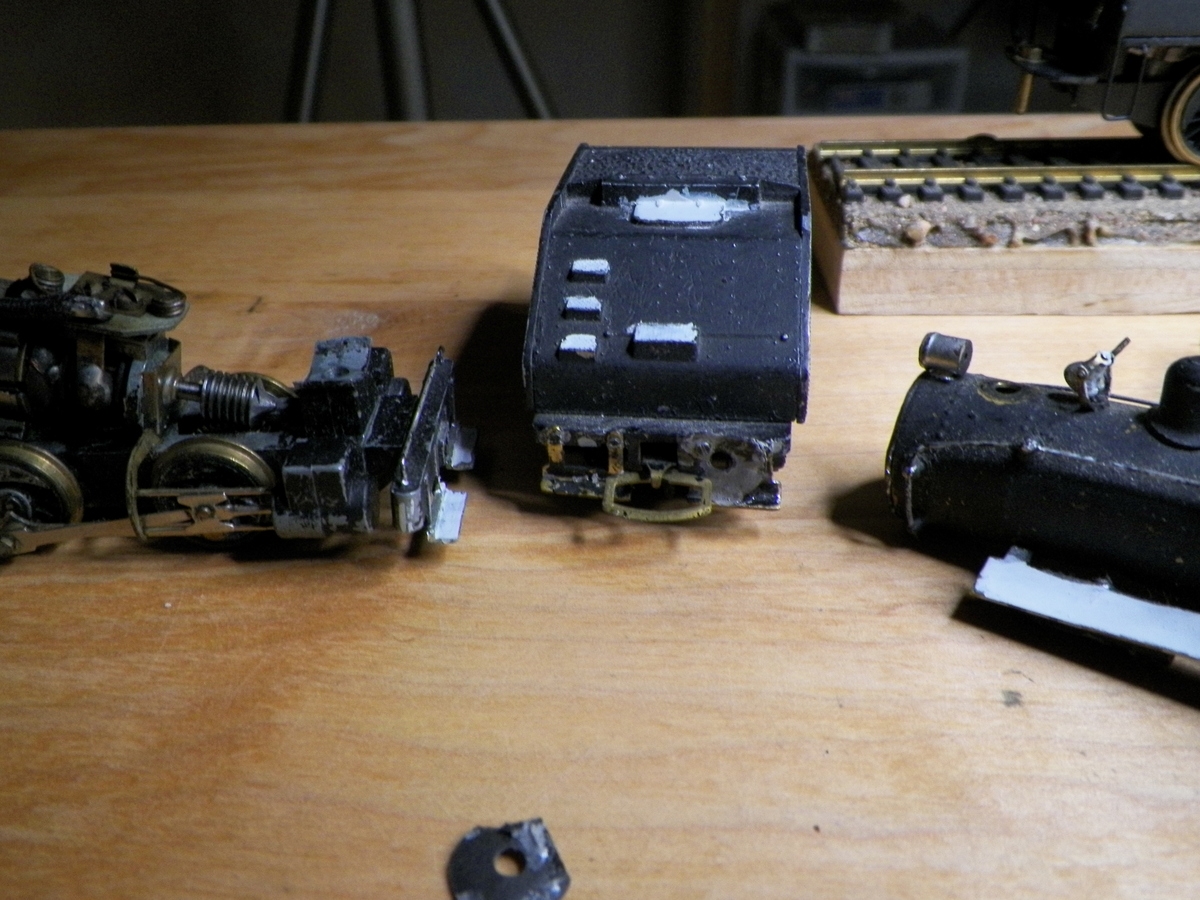

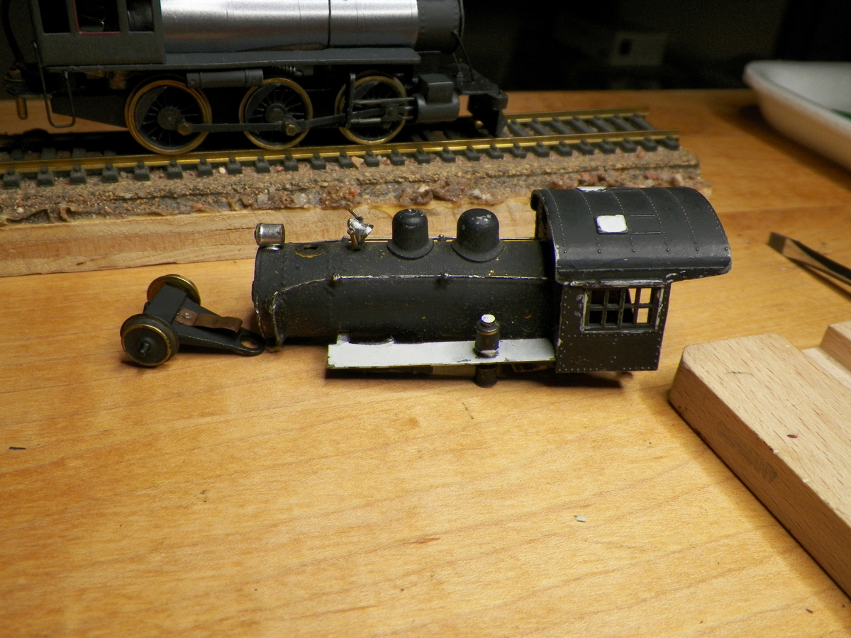

and here are a few more I took after beginning disassembly and inspection . . .

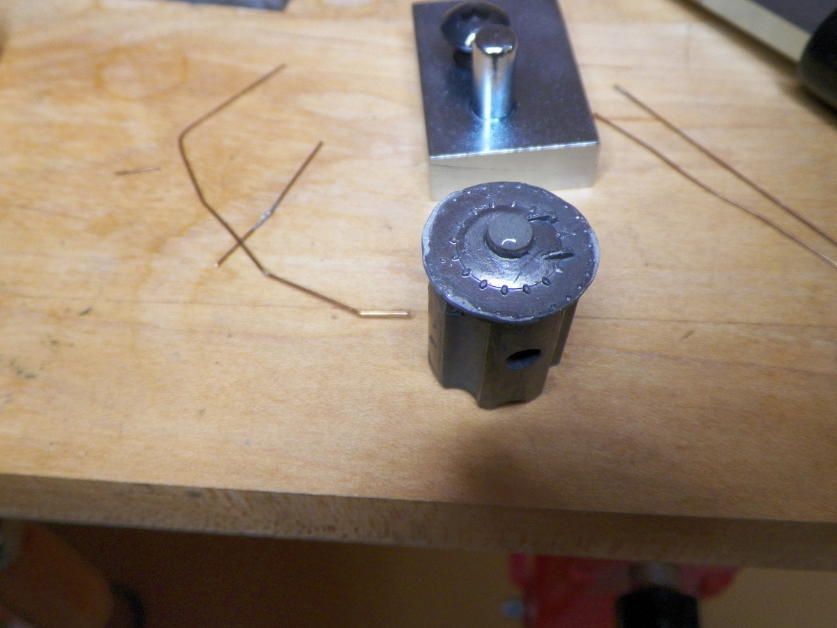

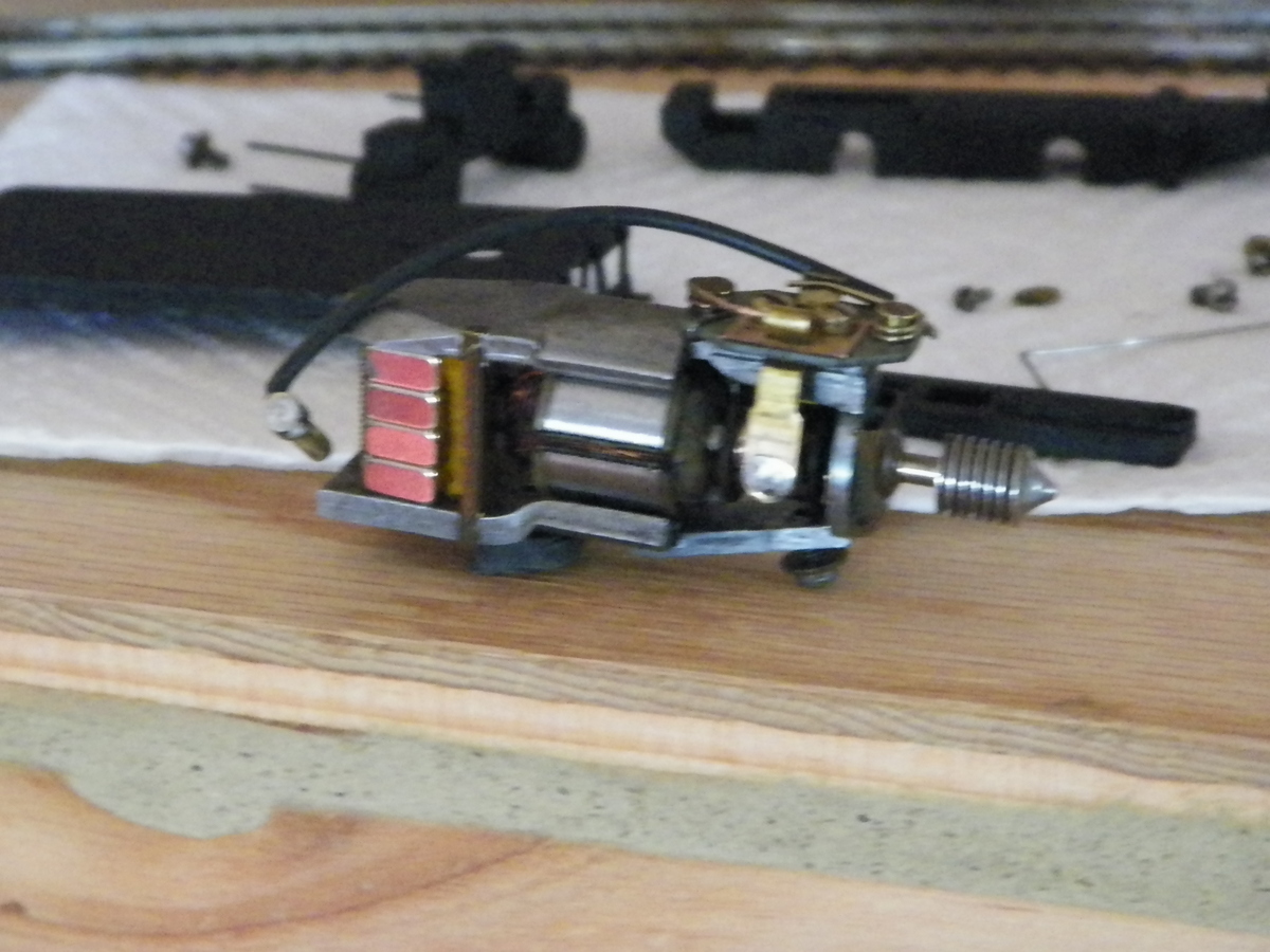

and a couple of the motor . . . I did try running this before I did anything to it, and
amazingly it did try to run. But if you look and see that the lead wire is soldered to the right hand brush (opposite of what it should be by my knowledge) . . . and the drivers would not all sit flat on the rails . . .
I didn't get a photo of the brushes, but the brush on the right side (soldered wire side) was worn pretty darn close to the arm and not suited (by me) to take a chance on mussing the commutator. I had some Tyco/Mantua brushes which I had tried at another time to use on an older Mantua motor and they didn't fit well. On the basis of that, I figured I'd have to replace the carbon myself (or wait who knows how long to find the right brush). I went about assembling the carbon and wire glue to attempt that replacement, but then I also tried the Tyco/Mantua brushes and voila!, they worked. No photo, but the motor seems to run fine now with the lead wire "pinched" between the left hand brush spring wire, etc.

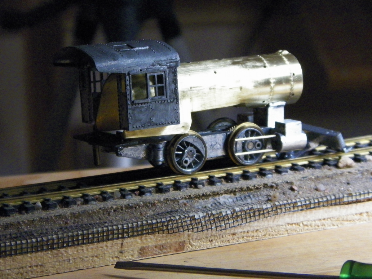

Bottom line, is that this locomotive had suffered some accidents (likely dropped and drivers knocked out of alignment; not sitting flat on rails) and some less than careful modeling techniques (big gobs of solder holding the handrail stanchions in place), but now I've got most of that cleaned up.
Worst damage seems to have been to the smoke box cover. I think when the handrail stanchions were soldered, the soldering locked the combination smoke box cover/boiler weight in place and then at some point, someone tried to removed it by prying on the edges of the smoke box cover and chipping away some pieces. Presently, I've got some JB weld in those chips and I'm hoping to be able to whittle away at that and diminish the evidence of those chips.
I did, by the way, get it to sit flat on the rails, just by cleaning up and reassembling. Looks like the frame and drivers are in OK shape.

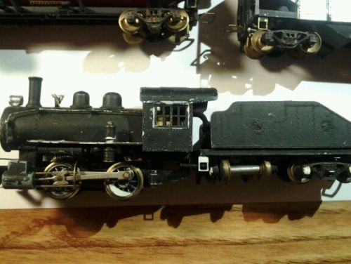

I'm interested in seeing photos of Mighty Mites that other folks have. I believe Sean probably has a bunch of them. So . . . here for your Sunday grins.

Is that a 6 volt or 12 volt motor? Some of the earlier Mantuas had a 6 volt in them. They would screem at 12 volt but eat the brushes. A later 12 volt motor will swap in no issue.

I wasn't certain myself (about the motor), but a set of instructions came with it and the advertisement on hoseeker (from circa 1950) said 12 volt, so I now feel pretty confident that this one is 12 volt. I do wonder what years 6 volts were used.

 Posted - March 15 2016 :  09:36:04 AM Link directly to this reply  Show Profile  Add richard p to Buddylist
This is from an article about Mantua's history:
"Mantua issued a catalog in 1947, the first since
1942. The entire line was back with some additions and changes.
The biggest change was a new motor voltage. 12 Volts DC had become
the standard voltage instead of 6 volts."
So it looks like 12v became the standard after the war.

In general, all Pre-War American HO was 6 volts, all Post -War is 12 volts. This would Mantua, Varney and American Flyer (Gilbert).

Motor (original I believe) with Tyco/Mantua 785 brushes (foggiest photo I think) . . .

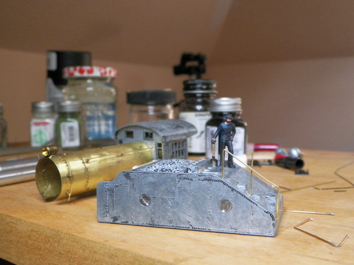

Experimenting with some tender details . . .
Continuing to try cosmetic work on the smoke box. We'll see how that works out . . .
Trying out the "Mini Wire Bender" I got from K&S in order to complete the $25 minimum. I suppose I need to mess with this more, but it seems the minimum radius with this is relatively large. Here's a photo of the wire bender and then a photo of the minimum curve as it might be applied to the boiler hand rails for the Mighty Mite . . .

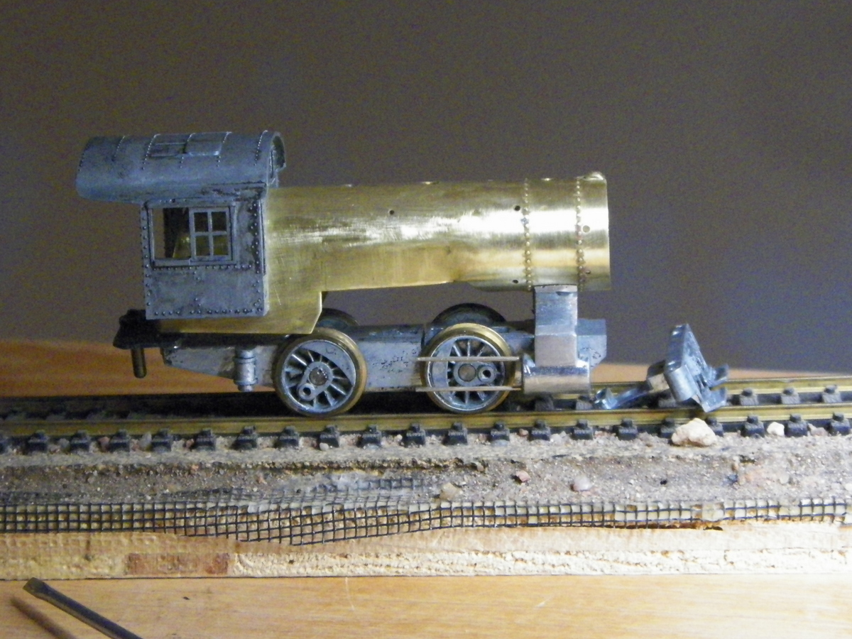

 Posted - March 31 2016 :  1:33:34 PM Link directly to this reply  Show Profile  Add Barry to Buddylist
It's coming along . . .
The smoke box may not look to bad from several feet away (e.g., repair of gouges around the perimeter) . . .
I was tossing around various ideas for painting the handrails on the boiler. I decided to assemble them first and then "fight" with sliding them back into the cab. I've tested and they move about a 1/32" or less. I'm considering using a toothpick and putting just a smidgen of oil on them near the stanchions to see if that will let them slide. Reason I assemble first, is that I thought I might buggar up a painted boiler if I tried to install the stanchions after painting it. Six of one and half-dozen of the other I guess.
Interior of cab is olive green, though it appears not much of that paint work will ever show.
The "mechanism" has been tested and seems to work fine, though needing the weight of the boiler and smoke box weight to tell better.
This will be the first Mantua locomotive I've run that uses the "plug-in" connector between the motor and the tender. It seems to me to fit a bit loose, but I like the concept. I suppose I could run a little solder around the pin to increase the diameter?
So . . . maybe a few more days.

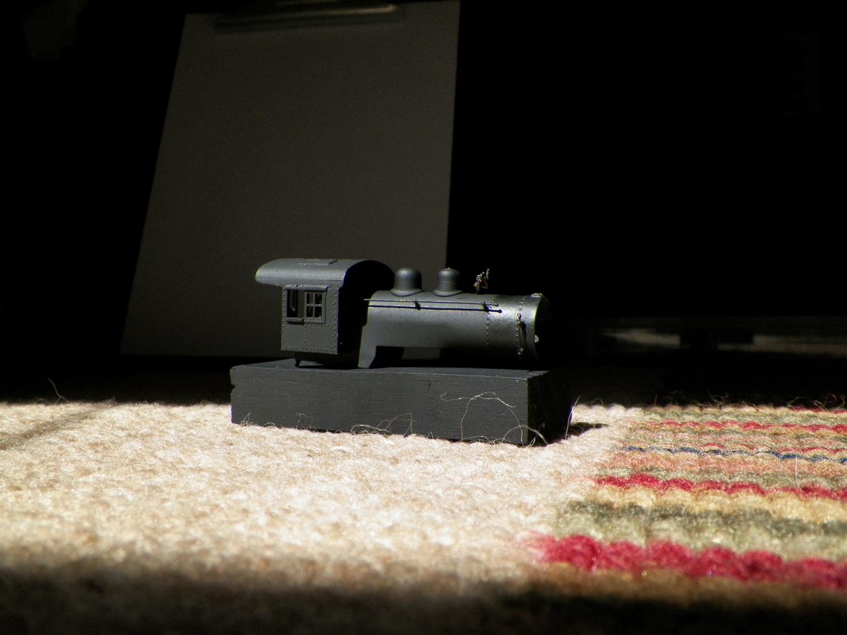

 Posted - April 03 2016 :  3:30:56 PM Link directly to this reply  Show Profile  Add Barry to Buddylist
I think these are #90 screws that are used to hold the headlight and other things on. I used Elmer's glue to hold the screw to the screwdriver blade. It wasn't fool proof, but it helped. I've searched more than one of these out that fell to the floor.
Fine sunny day here, but I had to spend a couple of hours (goes by quick) puttin' this thing together this morning. Still needs touch up, but it's up and running. Noisy little thing. This little shelf may be OK for a crude test, but it sure would be fun to run this Mighty Mite around a regular layout for an hour or so.

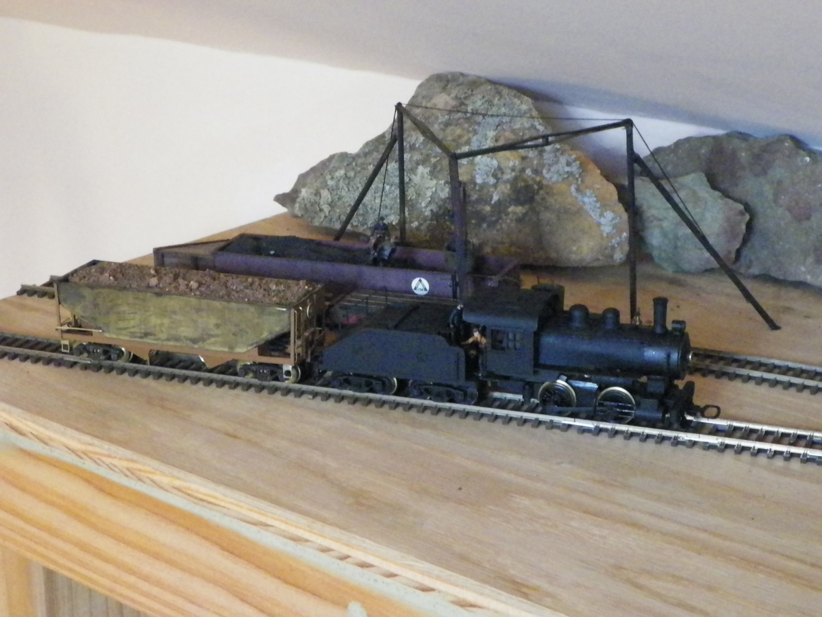

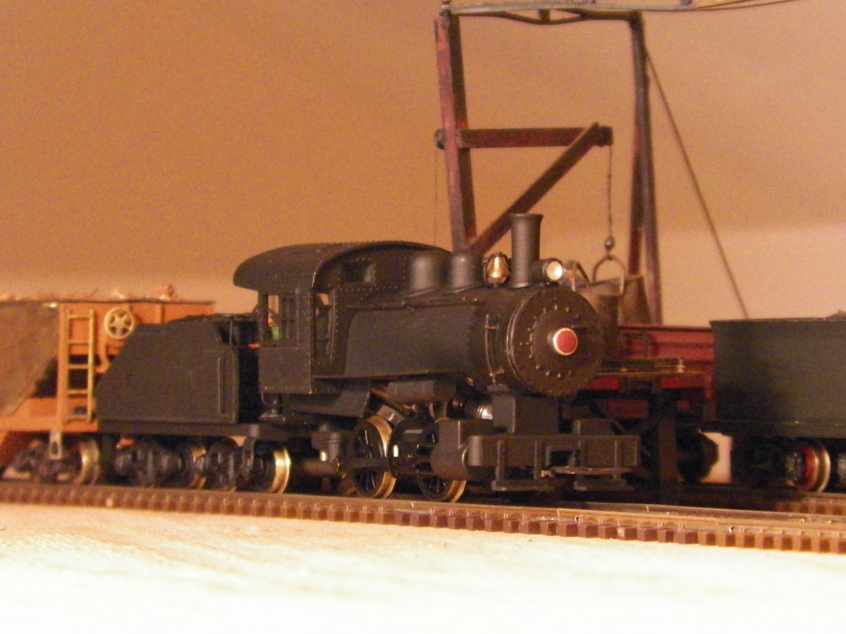

 Posted - March 13 2017 :  9:47:51 PM Link directly to this reply  Show Profile  Add Barry to Buddylist
Here it is, nearly a year and I believe I've finally got this thing to run in a half-way acceptable manner. A year ago, my only track to run on was a shelf just a few feet long. So I never really got to see how well this Mighty Mite worked. As it turned out, it did not work very well. Now, though, after a few months just sitting in a shadow box, and then time on the bench getting after an array of little problems . . . well now it seems to be running pretty reliably, though a bit rough at low speed. I'm hoping it will "break in" to cure that some.
