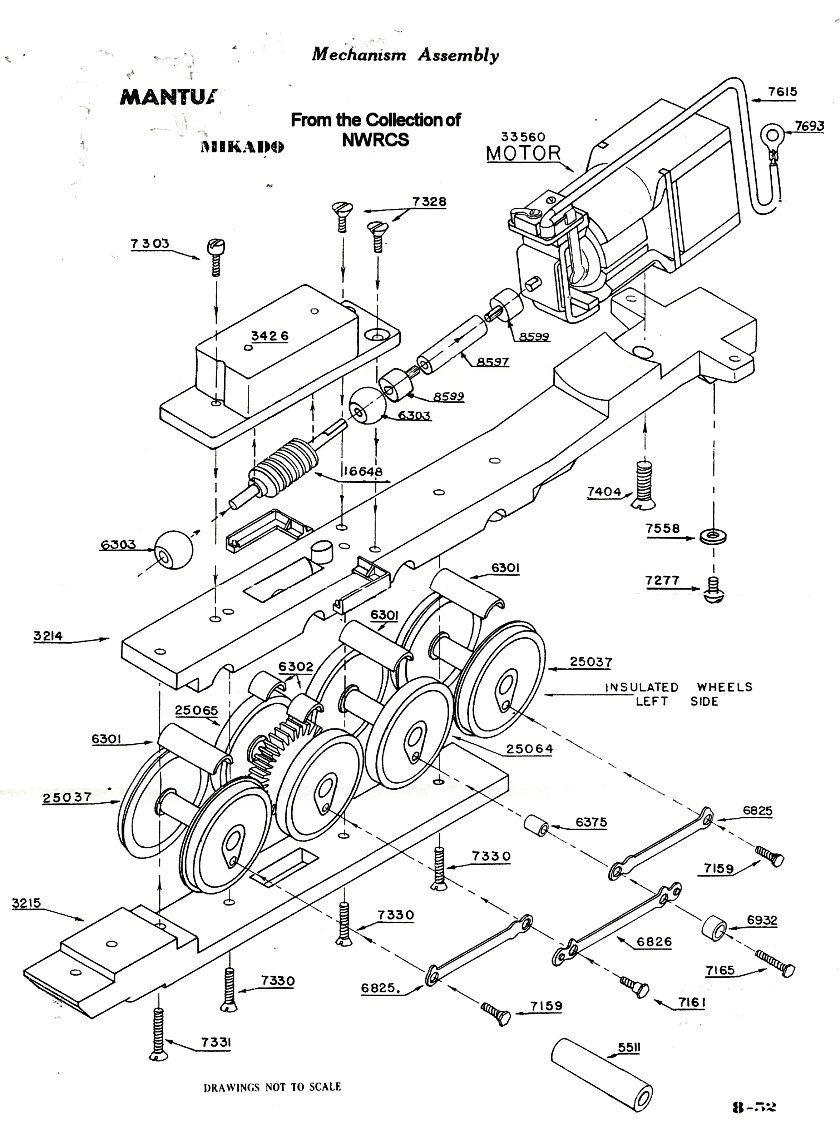

What oil should I use? And where do I put it on the motor, it is the very old motor type I believe. I did put some grease on the gears to the wheels

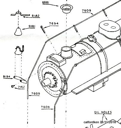

nice find,but don't forget the boiler door bell,ken

Mantuas pick up power from one side of the engine and from one side of the tender. Power is routed from the tender wheels through the frame to the wire connected to the draw bar screw on the tender end. When you dismantle the tender to paint it, make sure that the mounting surfaces between the tender and its trucks are free of paint and corrosion. A light filing and sanding with wet/dry emery cloth wouldn't hurt. A light sanding of the brass pick up wheels with 600 grit wet/dry emery cloth may be in order also.
It is hard to tell from the picture, but if the wire from the tender to the motor is cloth insulated, replace it with up to date plastic insulated wire.
I only use Labelle 107 iol for motor bearings and Labelle 108 for the running gear.
There are two lubricating points on the motor. At the rear, between the frame and the magnet there my be a fiber pad. Soak this with oil and it will keep the rear bearing lubed. At the front of the motor, oil the bearing from the outside of the frame only. You do not want to get any oil on the commutator.
Speaking of the commutator, check it and ensure that it is clean. With a Q-Tip soaked in alcohol rub each section of the commutator to remove as much of the worn carbon dust from the brushes as possible. With a new #11 Exacto blade CAREFULLY clean out each slot between the commutator segments. Rinse with another Q-Tip soaked in alcohol, let dry and and I guarantee this baby will run like it was brand new.
I have just completed refurbishing the same engine and now at 12v it purrs like a kitten and draws only .46 amps.

http://www.hoseeker.org/assemblyexplosionMantua/mantua282mikadoinst1953pg07.jpg
The brass wheels superprized me as I have seen only steel ones before. They where clean also, no gunk etc on them.

On your motor the oil pad is at the front, in the little frame that just out, oil that. on the rear of the motor in front of the magnet you can see a small washer, put 1 drop of oil there on the magnet side of the washer. You don't want too much, more is not better. Where you have "clean?" marked on the motor by the brushes, yes that is the place to clean the commutator. It should be copper shiny or as near to it as you can get. Don't be too aggressive in cleaning it. The small wires from the motor windings are soldered to the segments of the commutator and easily broken.
On the tender trucks, the wheels can be removed by unscrewing the 2 screws on each truck and removing the plate. Mark the position of the brass wheels so you get them back on in the correct orientation (side). The small screws hold the plate on, the large screw holds the truck onto the tender. Oil the axle tips where they fit into the frame (one drop from the end of a toothpick) and oil the axles where they rub on the cover plate. again be sparing on the roil, more is not better.

Keith; As to oiling and greasing a loco. If it moves and rubs against anything put oil on it. Axels all where the axel makes contact and axel points at truck frame, all springs, side-rods at wheel connection, rivets, main-rods, piston shaft, piston slide, motor shaft both ends, light grease on gears. And anything else you can think of. For better electrical pick-up screws that hold on metal trucks.

Perhaps the major thing that could be done to assure engine performance (without altering the engine in a way that cannot be reversed) would be to replace the magnet with neodymium magnets. With that vintage motor, you don't have to pop a rivet to get at the magnet, you can just unscrew the frame and then, when it comes down to it, the magnets will stay in place by themselves . . . but you can put the screw back in, just to keep track of it.
 Posted - November 29 2016 :  10:35:00 AM Link directly to this reply  Show Profile  Add Barry to Buddylist
I should have looked more closely at your photo. The brush springs on your model are different from what I was talking of, so you may not be able to pinch the lead wire in the brush spring.

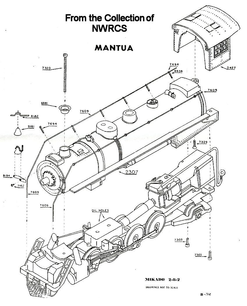

Those holes in the gear box look like they may or may not be for oil. If the gear box is reasonably easy to take apart, it might be a good idea to do it once to make sure there's no dried up grease in there and to see just where the holes do go. There should be a worm on the shaft that meshes with the gear on the axle. That would get a light grease such as LaBelle 106 or Vaseline. The shaft should be in two bronze bushings that should get a light application of oil just like the ones on the motor.

If this is correct it looks like 3 screws hold the cover on, will have to look at mine when I get off work.
http://www.hoseeker.org/assemblyexplosionMantua/mantua282mikadoinst1953pg02.jpg

 Posted - November 30 2016 :  08:02:24 AM Link directly to this reply  Show Profile  Send catfordken a Yahoo! Message  Add catfordken to Buddylist
this is the 3rd version of mantua mikado,the bell is on the side,whereas the 1st and second have their bells on the front boiler door,and tender on first 2 have a skeleton frame and 3 rd has 2 coloums for connecting the trucks to,ken
this was made in 1958,yours was between 1952-57

looked at the 3 screw on the cover that hold the gear box on, it looks like i have to remove the motor and the drive shaft also to get the cover off. Leary of doing that as afraid will not be able to get back together right, same thing on the bottom plate that hold the drive wheels on. I did start to take that off the other day but the drive wheels started to move around, did not want to mess that up at all!!!.
