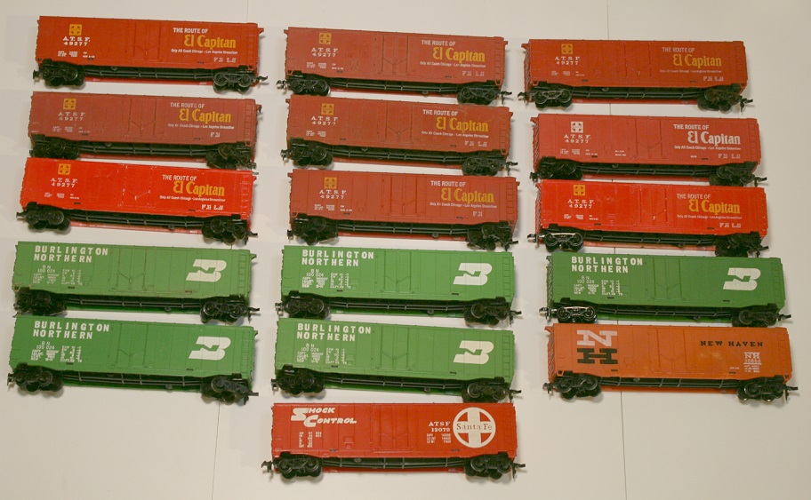

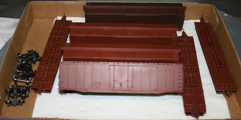

First I would like to show off some of the candidates for rebuilding....
If anyone sees a car that is of special collector value, speak soon or
forever hold your peace!!!

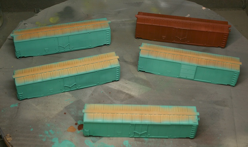

 Posted - January 04 2016 :  10:47:00 PM Link directly to this reply  Show Profile  Add Srenchin to Buddylist

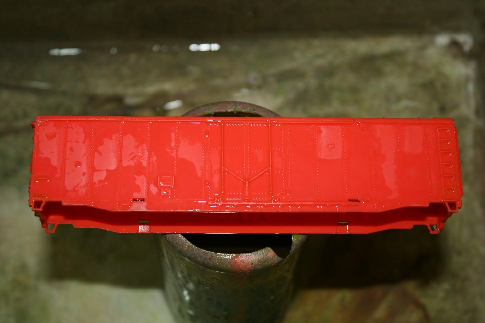

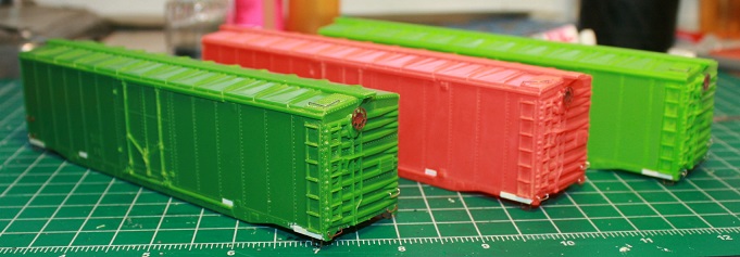

This photo shows some of the cars that I am in the process of repainting....
The jade green cars will be New York Central cars and the brown car
will be a Santa Fe car.
Edited by - Srenchin on January 04 2016 11:26:06 PM

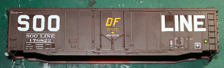

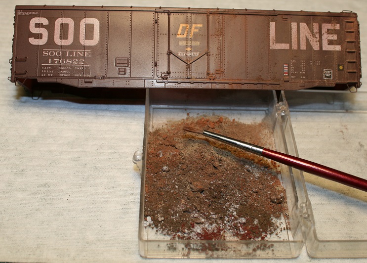

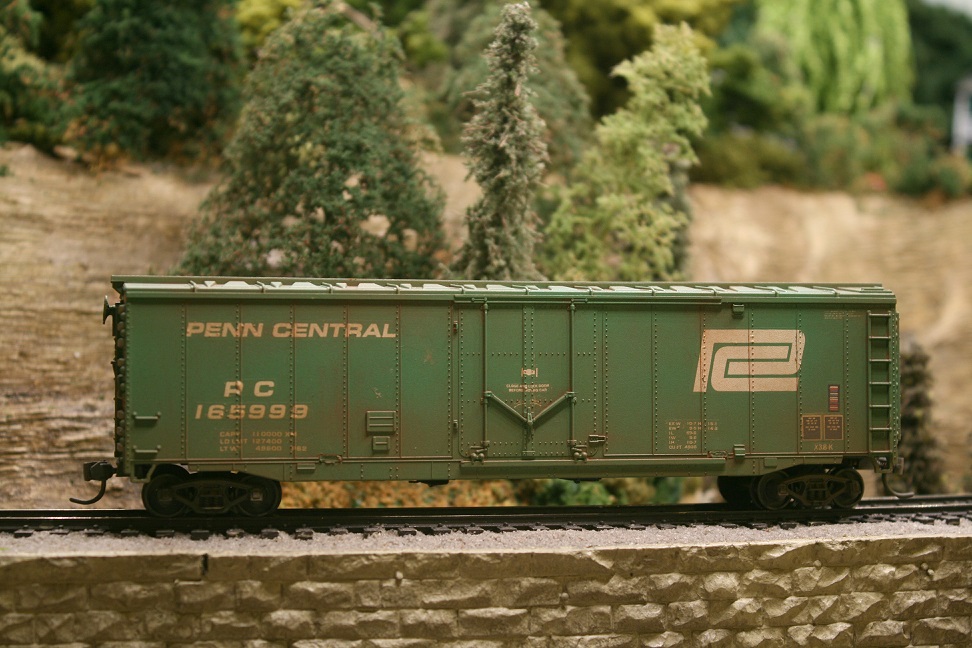

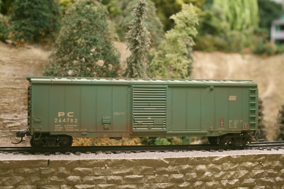

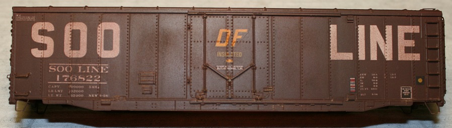

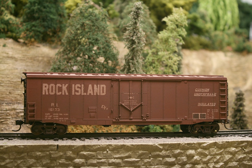

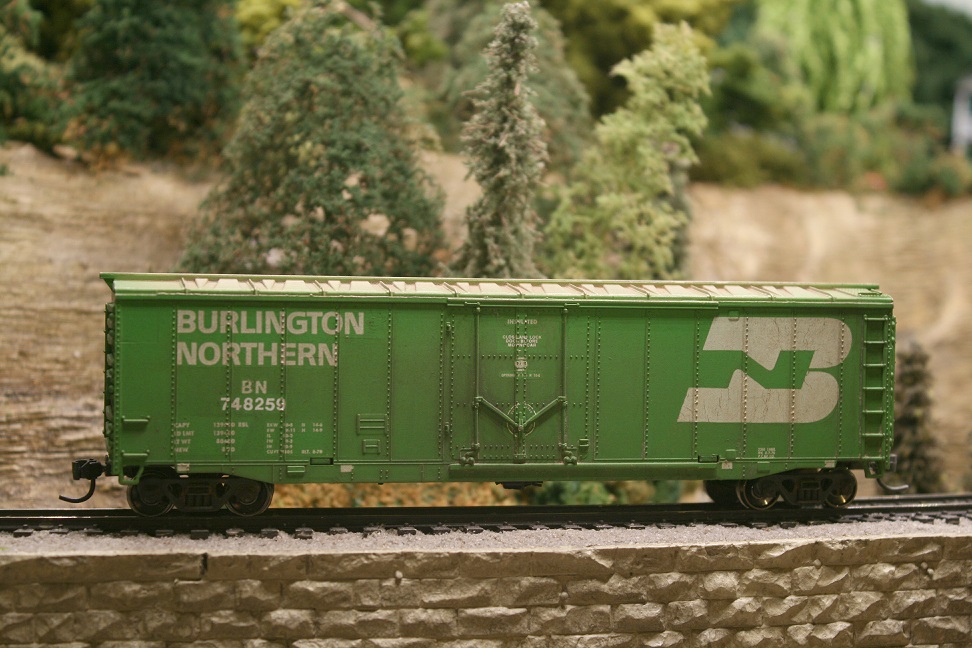

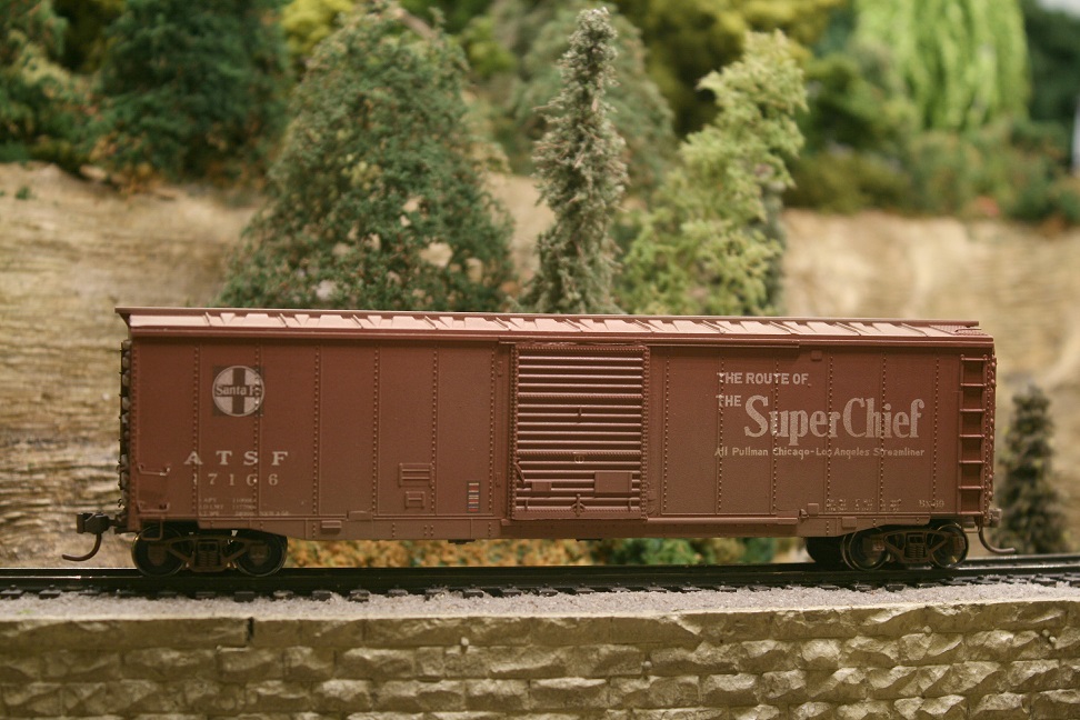

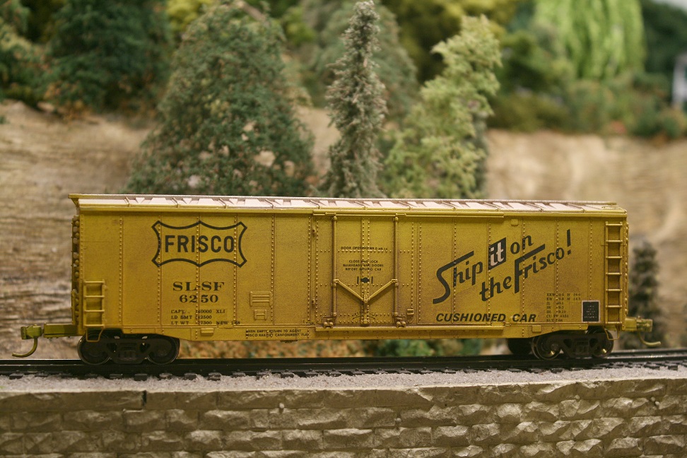

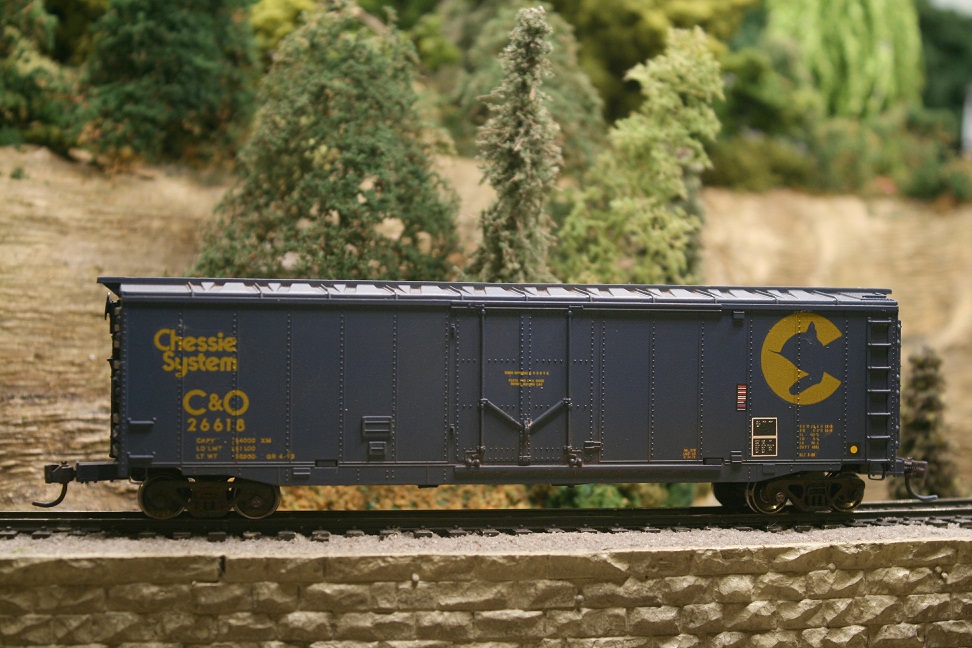

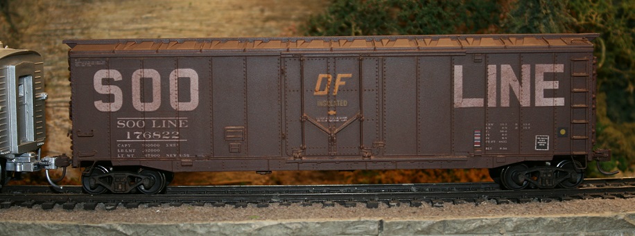

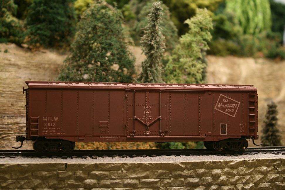

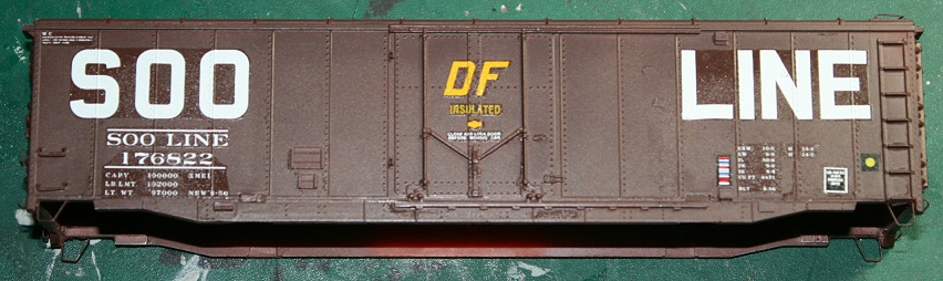

Here are some examples of cars I have already completed.....
This car is a basic rebuild, Kadee Couplers, New Trucks, Repaint, Decaled and weathered.
This car is for GIC, this is how a Tyco BN boxcar should look!
This car has additional upgrades including new stirrups and extended cushioned draft gear.
This car features a sliding door from Accurail and wire grab irons.
The Frisco used ladders on all four corners of their cars, mine are from Accurail.
This car also uses an Accurail sliding door, note the use of roller bearing trucks.
By the time I made this car I had standardized with wire grab irons and stirrups.
All cars also feature Kadee brake wheels.
More cars to come....
Edited by - Srenchin on January 04 2016 11:20:19 PM

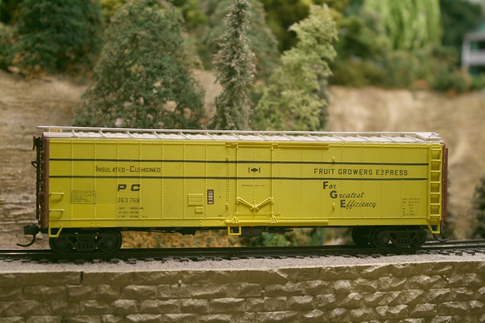

In this post there are six cars, five are just like the other and one is not quite the same.....
One of my goals with this project is to rebuild old tyco cars so that they can blend in with the higher
end equipment you can buy today. If it takes you a few moments to pick out the impostor then I have achieved the desired results.

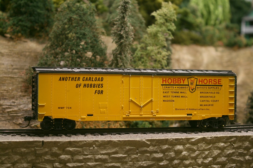

Among my potential rebuild candidates I have is this car....
Do you think it deserves to be preserved or should I just strip it?
Edited by - Srenchin on January 05 2016 10:18:00 PM
fourteen
RockIslandAvatar
 Posted - January 06 2016 :  03:23:04 AM Link directly to this reply  Show Profile  Add fourteen to Buddylist
I would save that one, was the fruit growers express the imposter?
Modeling on the cheap
Edited by - fourteen on January 06 2016 03:24:17 AM
Srenchin
CNRedAvatar
 Posted - January 06 2016 :  7:59:57 PM Link directly to this reply  Show Profile  Add Srenchin to Buddylist
Originally posted by fourteen - January 06 2016 :  03:23:04 AM
I see you know your cars, yes the FGE car is the imposter (I hope it's not too obvious).
As for the "Hobby Horse Car" I will leave it "as-is", there are so many regular Tyco pluggers available it would be a travesty to sacrifice this one.
Edited by - Srenchin on January 06 2016 8:02:36 PM

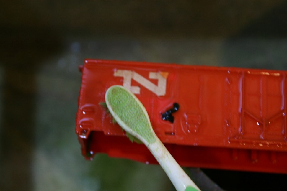

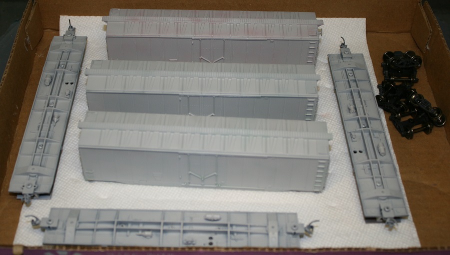

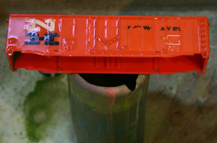

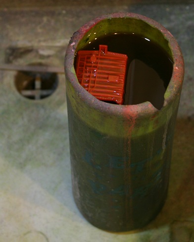

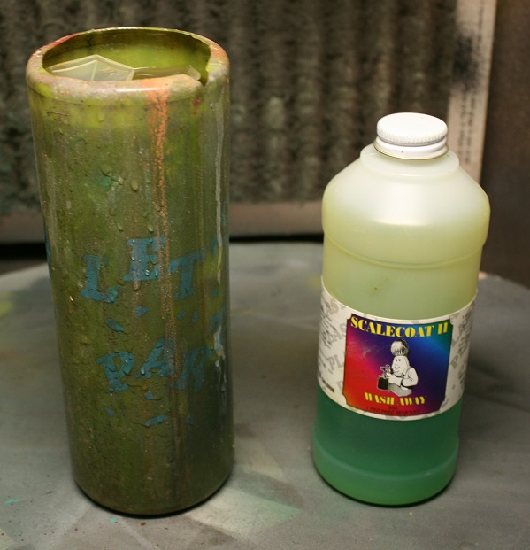

As I progress through this rebuilding program, I would like to share with you the techniques I use to turn a Tyco plugger into a passable model.....
First stop for every car going through its metamorphosis is a paint stripper bath.....
Scalecoat II "Wash Away" paint stripper is magic, the old Tyco paint will simply rinse off after being immersed in this fluid for about an hour.
Edited by - Srenchin on January 11 2016 12:10:44 AM
Srenchin
CNRedAvatar

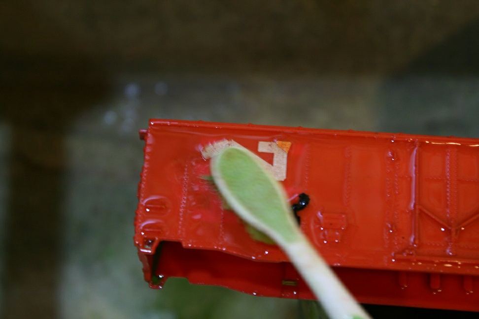

 Posted - January 10 2016 :  11:29:45 AM Link directly to this reply  Show Profile  Add Srenchin to Buddylist
After a nice long soak in the paint stripper solution...
the car comes out looking like this....
Then I use an old tooth brush to gently scrub away the old paint and lettering...
Then after a rinse in water what you now have is an undecorated Tyco plugger...
Next step, detail improvements and modifications....
Edited by - Srenchin on January 10 2016 11:31:43 AM

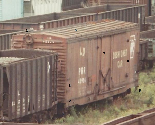

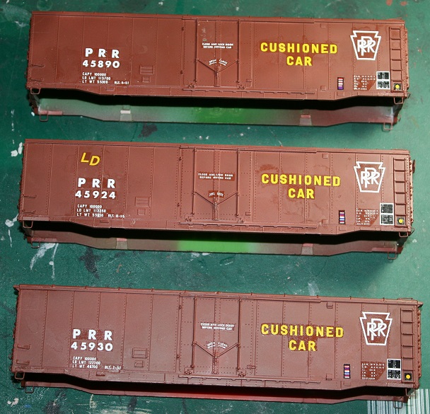

I found this picture in one of my photo albums, it's a cropped picture of PRR 45924 spotted at Conrail's storage yard in Altoona Pennsylvania in 1990. This particular car will make an excellent candidate for a Plugger project, note that the car ends are the original Dreadnaught style just like on the Tyco Shell...
Edited by - Srenchin on January 10 2016 4:21:52 PM

Srenchin
CNRedAvatar
 Posted - January 10 2016 :  1:32:09 PM Link directly to this reply  Show Profile  Add Srenchin to Buddylist
Yes, PRR 45924 was built for this project! There are certain details that stick out for me besides the Dreadnaught ends (a huge plus, very few 50 foot cars have this style).....
1. The Modern style brake wheel
2. The side sill that extends to the end of the car
3. Square Stirrups
4. Post 1960 lettering scheme
5. Journal Bearing Trucks, (you can just make out the journal cover lids)
6. Brown roof, This is basically a "dip job" paint scheme
7. Plug Door
8. Grab irons on the corners rather than ladders
The one glaring difference this car has from the Tyco shell is the roof walk (or lack there of) but these were removed after this car's last trip to the paint shop. As a result, my model will represent this car as it would have been in the 1960's before roofwalks were banned.
Edited by - Srenchin on January 10 2016 1:34:59 PM

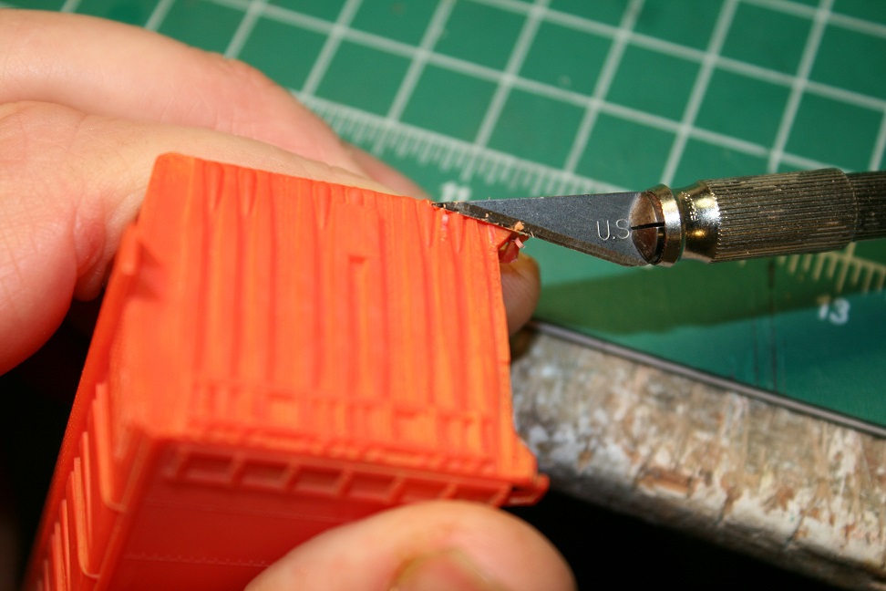

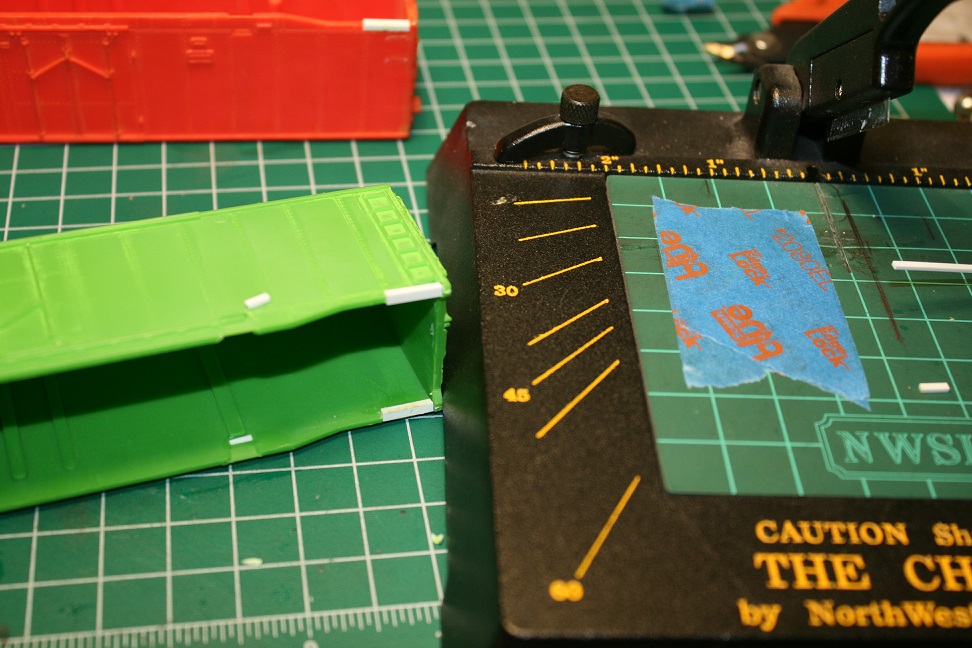

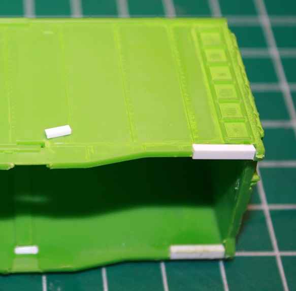

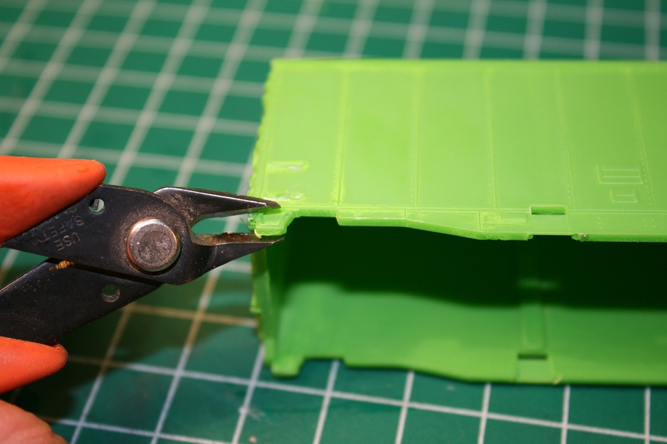

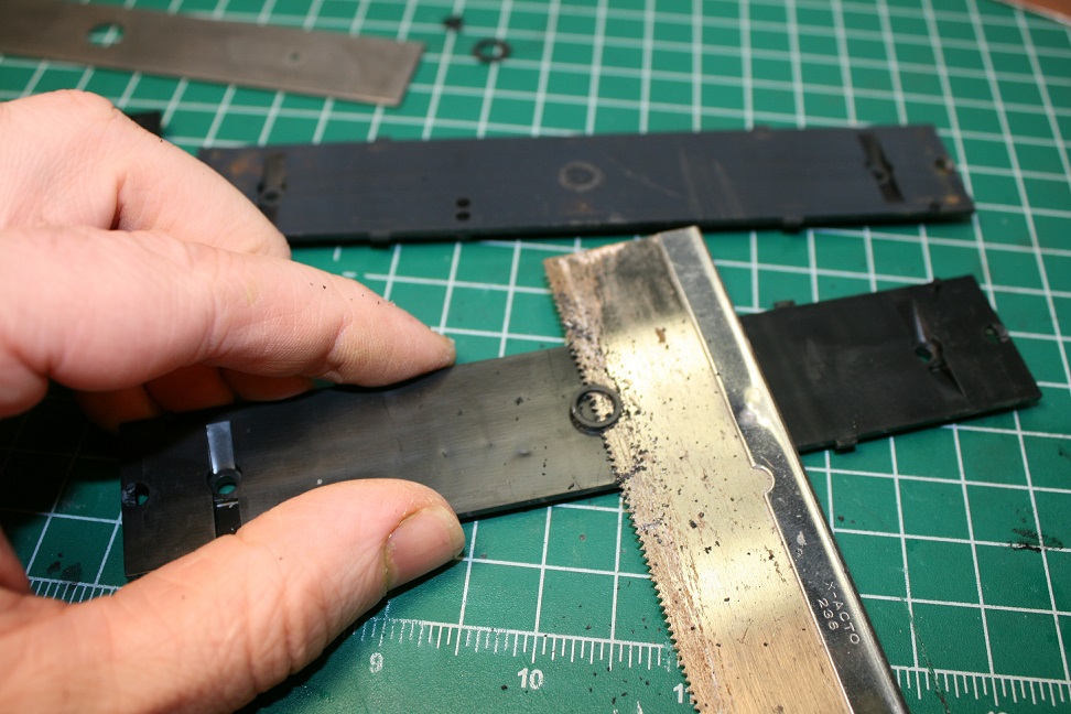

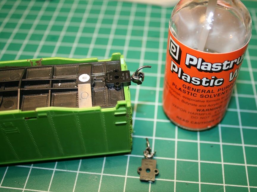

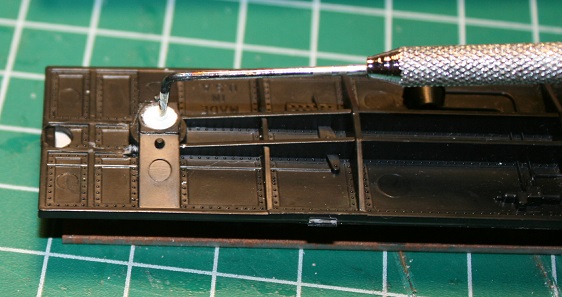

 Posted - January 10 2016 :  7:57:46 PM Link directly to this reply  Show Profile  Add Srenchin to Buddylist

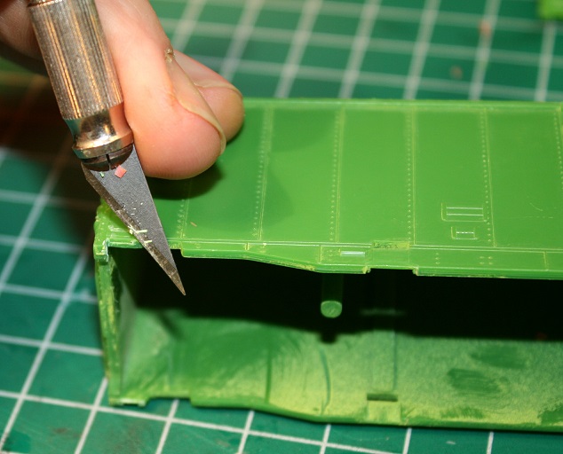

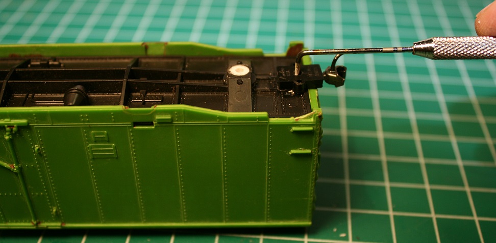

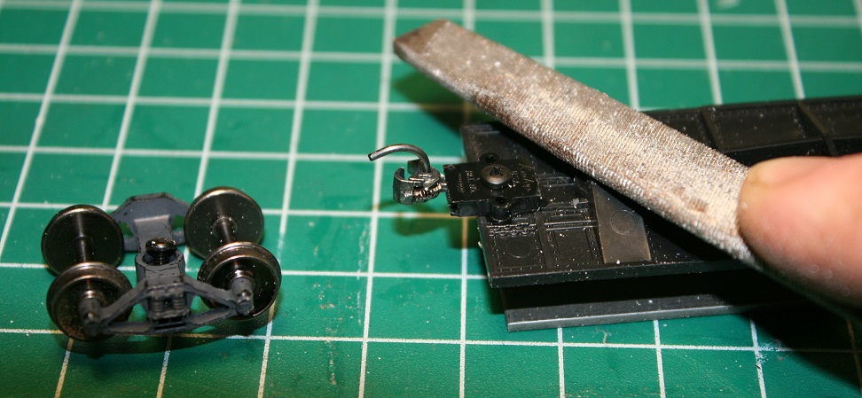

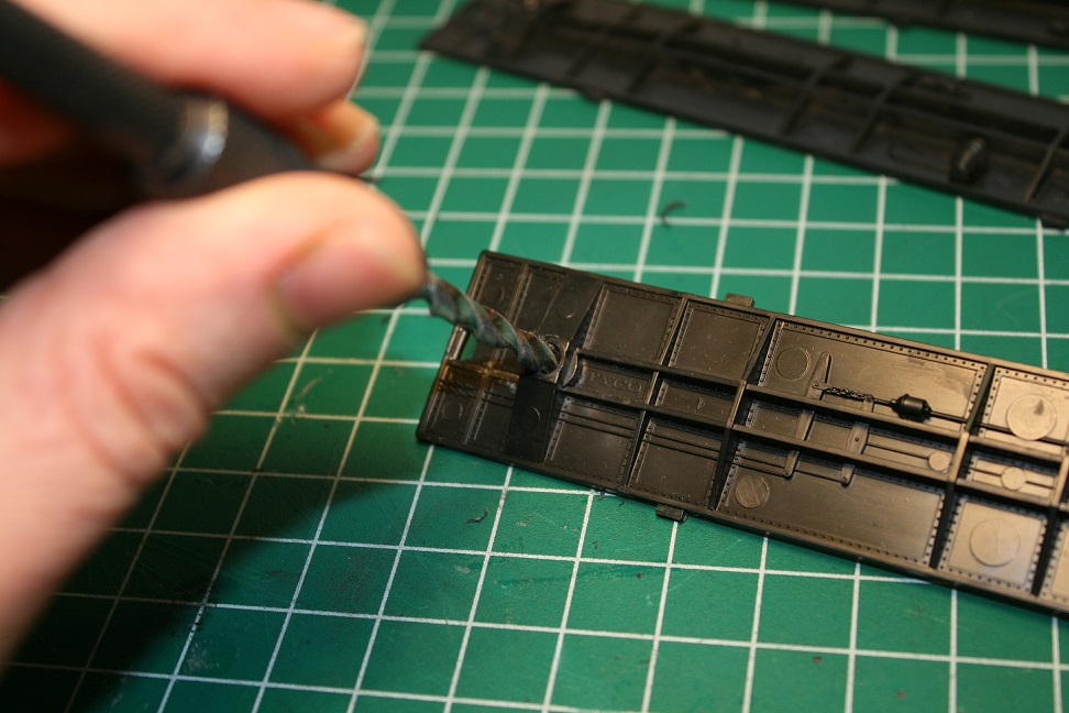

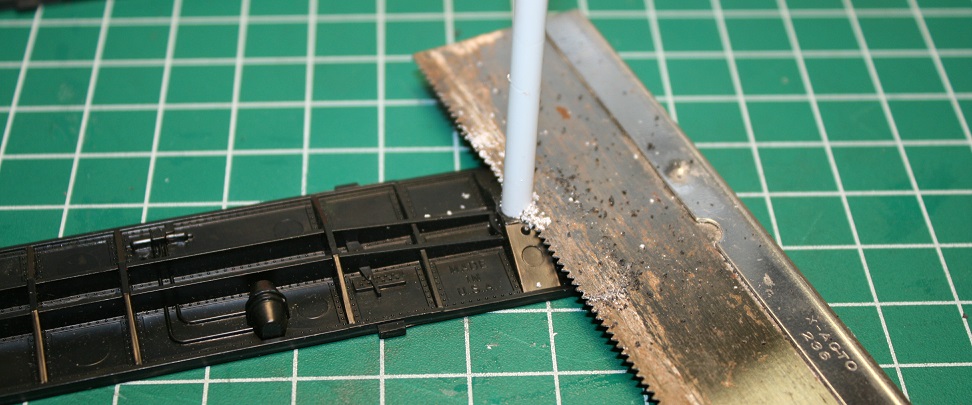

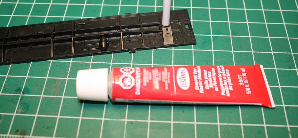

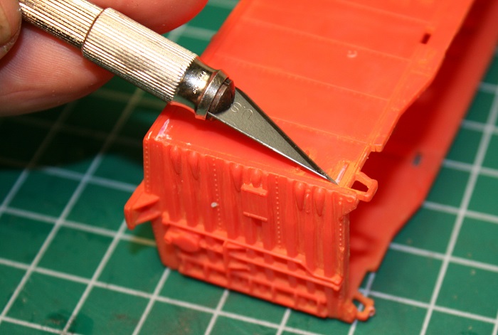

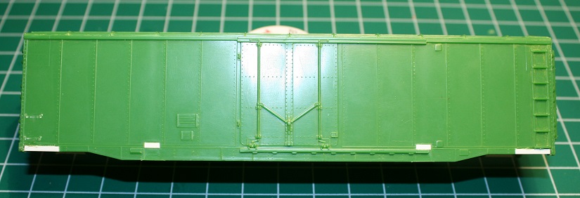

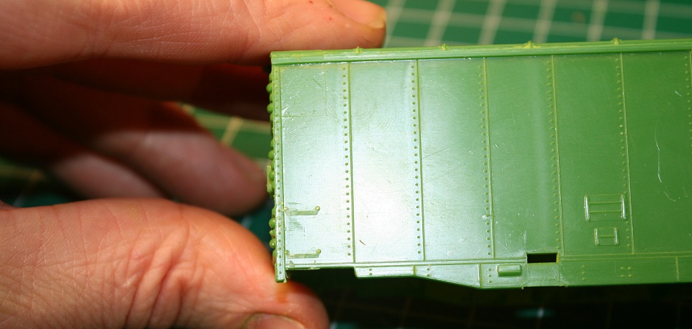

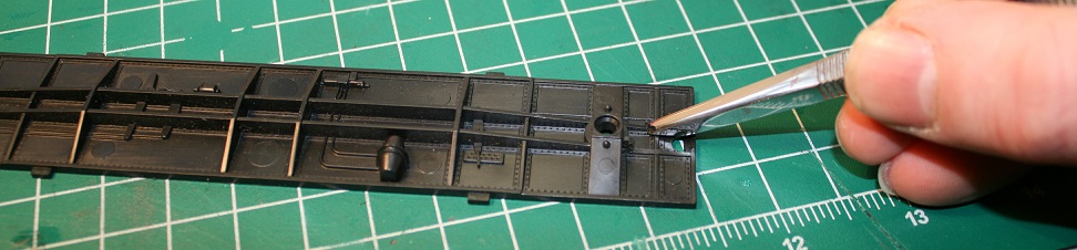

In this post I am going to show how I make my shell modifications......
First I remove the molded on grab irons, remember to remove the grabs on the sides, ends, and the "L" shaped corner grabs on the roof...
Next step is to remove the old stirrups....
Once all the old details are removed, use styrene strips to fill the peg holes and extend the side sills
Next step is to add wire grab irons and Kadee brake wheel, stay tuned....
Edited by - Srenchin on January 11 2016 12:01:44 AM
 Posted - January 10 2016 :  8:29:09 PM Link directly to this reply  Show Profile  Add Barry to Buddylist
Nice clean little modification. Keep the story coming.

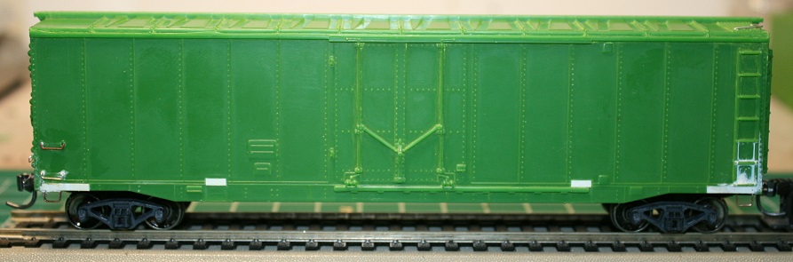

 Posted - January 11 2016 :  2:51:18 PM Link directly to this reply  Show Profile  Add Srenchin to Buddylist

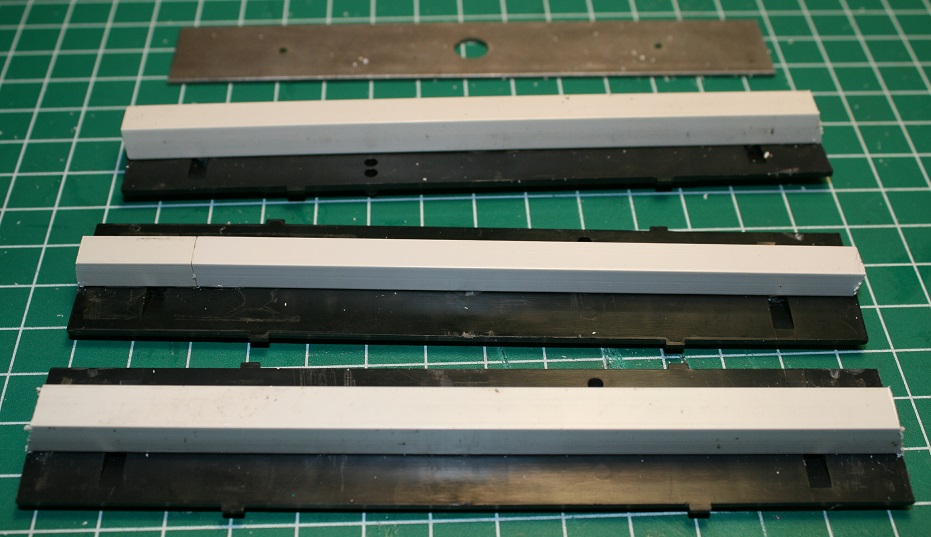

Here are my Pennsylvania cars with details added to the shells....
Note the brake wheel, grab irons, and stirrups.
 Posted - January 11 2016 :  3:10:36 PM Link directly to this reply  Show Profile  Add Redwoods to Buddylist
Originally posted by Srenchin - January 10 2016 :  7:57:46 PM
Great technique! Keep 'em coming!

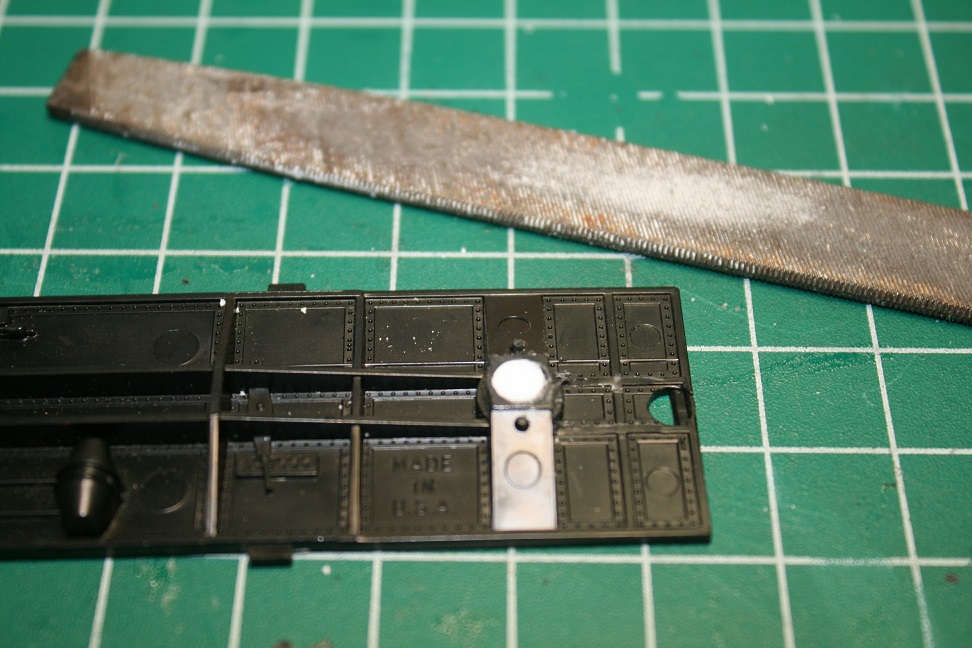

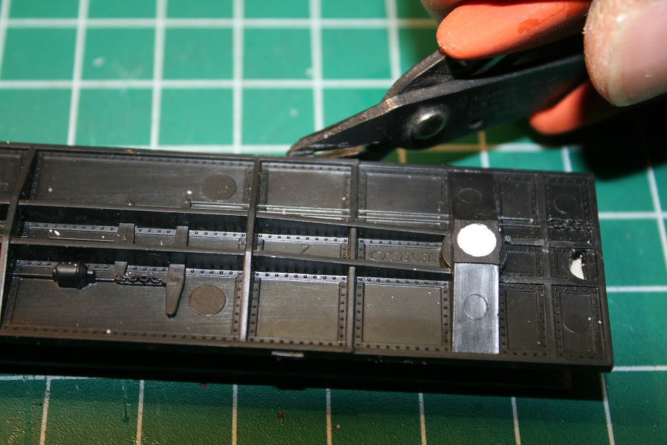

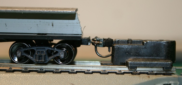

In this post I will describe the modifications I make to the Tyco Frame.

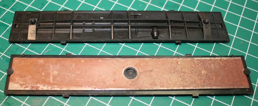

This is what the Tyco plugger frame looks like before modification...

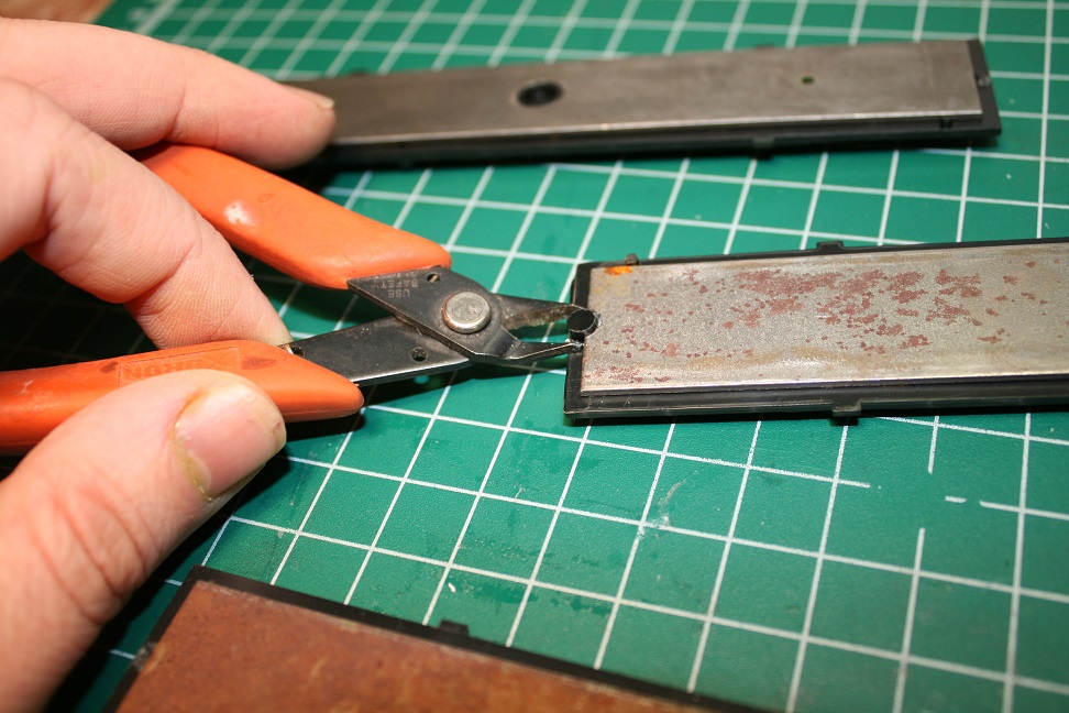

Start by removing the sheet steel weight.....
Remove all mounting lugs on floor of the frame and file smooth so that the frame will lie flat when turned upside down....
Now that the frame can lie flat, chisel away the center sill detail that will interfere with mounting a Kadee coupler draft gear box....
I then use a quarter inch drill bit to open up the original truck mounting hole on the body bolster.
After opening up the bolster holes, use quarter inch diameter round styrene plastic rod to fill the bigger hole...
Then trim the plug and file smooth....

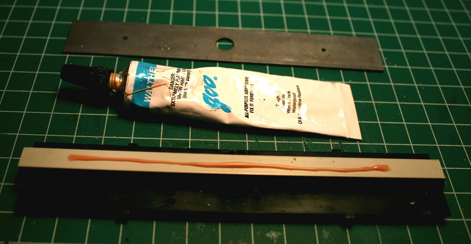

My next step is to add a "stiffening" sill on the floor of the frame, this is done to add some rigidity to the tyco frame and to provide some extra material for the draft gear and truck screws to bite into without needing to drill new holes in the Tyco weight...
Then use Walther's "Goo" to attach the Tyco weight to the stiffening rod...
Lastly, trim back the shell mounting pegs clear the hole plugs on the modified car shell.
Now the frame is ready for new trucks and couplers....

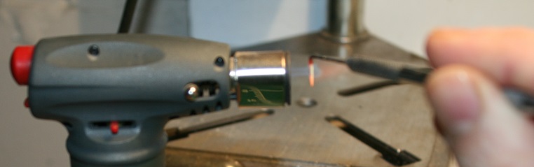

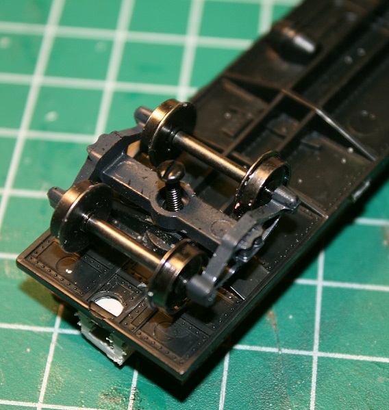

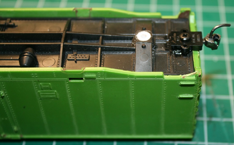

In this post I will describe mounting the trucks and couplers to the frame....
First, make holes in the bolsters to accommodate the truck screw, to do this use a butane torch to heat up a dental pick that can be used to press pilot holes into the styrene bolster plugs.....
The advantage of using a hot dental pick to make the pilot holes is that you can easily center the pilot hole in the soft plastic...

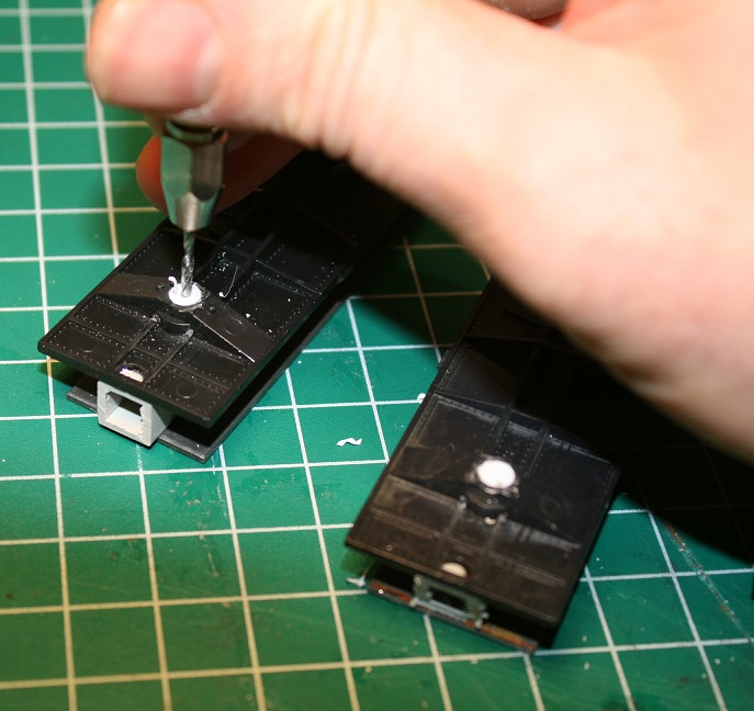

Once the pilot hole is made use a twist drill to make the screw hole in the bolster....
With the holes drilled in the bolsters attach the trucks using machine screws...
Next step is to add the coupler draft gear boxes, I prefer to assemble my couplers before installation. First use plastic cement to hold the coupler box in place. NOTE, you must have a shell attached to the frame in order to accurately mount the draft gear box on the end of the frame....
Then using a hot dental pick make a pilot hole...
Then drill out the hole with a drill bit and install a screw to permanently secure the draft gear to the frame...

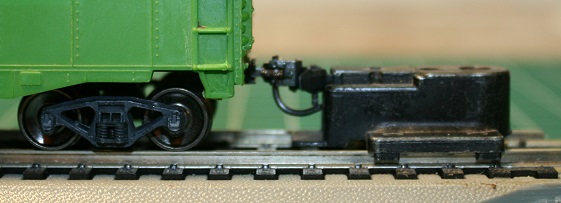

Now with the trucks attached, check the height of the couplers against a Kadee height gauge...
Chances are that the couplers will be high, remove the trucks and carefully file down the frame bolsters....
Eventually the couplers will line up with the Kadee height gauge...
At this point, the car is ready for repainting....
NOTE: In order to attach a shell with wire grab irons installed, it may be necessary to trim the edges of the frame in order to accommodate the interior ends of the wire grab irons.

If you trim back the shell mounting pegs, what holds the shell on?
Srenchin
CNRedAvatar
 Posted - January 12 2016 :  10:57:03 PM Link directly to this reply  Show Profile  Add Srenchin to Buddylist
Originally posted by thetramp - January 12 2016 :  07:55:19 AM
If you look closely at the pictures, I do not cut the mounting pegs flush with the side of the frame. If you cut back the peg to abut about 1/16th of an inch, there will still be enough of a stub left to catch the shell holes....

Trainman 280 raised a point that I have not addressed, that is "how exactly do I choose which prototypes to model for this project"?
Well beyond the obvious need to have similar dimensions as the Tyco car, I do have some guide lines that I use to select prototypes .....
1. The prototype needs to have a high hand brake
2. The prototype needs to have a roof walk (or have had a roof walk when originally painted)
3. The prototype needs to have riveted side panels
Ideally the prototype should have a plug door, if so then...
4. The plug door needs to have similar door locking hardware to that found on the Tyco Shell.
Details that I DO NOT concern myself with include...
1. Style of car ends
2. Dimension of the doors
3. Style of Roof Walk
4. Rivet patterns or numbers
With these basic parameters in hand, I next look at lots and lots of box car pictures either on line (mostly at the links mentioned in my last post) or by paging through railroad color guide books.
Then for every car I find that may make a good candidate for my project I next determine if I can find decals for that prototype. This can be a real problem because a number decal manufactures have either gone out of business or have cut back their available selection. (A special shout out to Micro-Scale and Herald King, for without their products this project would not be possible).
Then I do a similar search for appropriate paint colors, again this is a challenge because Testors has dropped their Poly Scale line of acrylic paints. Accuflex paints made by Badger are my preferred brand but their color pallet is not complete.
So far the most frustrating thing I have encountered with this project is to find a prototype of a car that is oh so close to my set of parameters but just doesn't quite match. I would like to model a "bankruptcy blue" Rock Island car but I haven't found a single picture of a prototype car with an intact roof walk. I would have also liked to model a New York, New Haven, and Hartford car, but the NH's only 50 foot cars were welded Pullman-Standard PS-1 types with the wrong style of plug doors. Ditto for the Boston and Maine.
The good news is that there are more than enough prototype cars that can fit my parameters that I can choose from. Stay tuned....

Ok, nest stop for my PRR cars is the paint booth...
First step, the primer coat...
Then the color coat...
Next step, decals!!!!

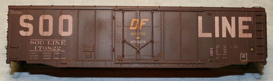

In this post the decaling of the PRR cars is almost finished....
I had to use several different decal sets in order to finish these cars, the most unusual was a Louisville and Nashville box car set from which I got the "LD" lettering above the reporting marks. (The L and D came from a "Dixie Line" slogan). Unfortunately I did not have enough L and D letters to finish all three cars so this set is on hold until I get more decals.

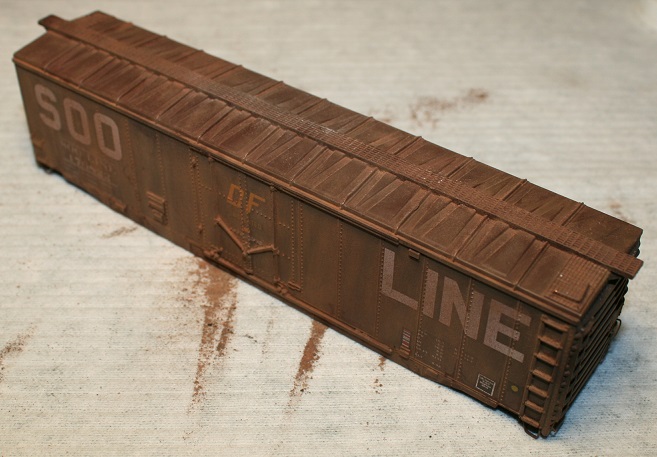

In addition I finished a Soo Line plug door car shown here...
Next step will be sealing the decals and weathering, stay tunned...

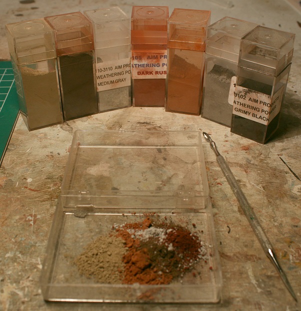

In this post, I we will cover weathering and final assembly. Since I am waiting for decals to finish my Pennsy cars I will shift to my Soo Line Plugger to demonstrate the final phase of rebuilding....
In this photo, the car has just been decaled...
First step is to give the car a light mist of paint, this helps blend the decals into the side of the car...
Next step is to coat the car with weathering chalks, these are the colors I used....
Next step is to brush the chalk colors on the car, note that I use a mixture of colors in a single application....
Next step is to seal the weathering chalk and Decals with a light misting of Testors "Dull-Cote", note that much of the weathering chalk disappears in this process, if the car looks too "clean" apply more chalk and then Dull-Cote again....

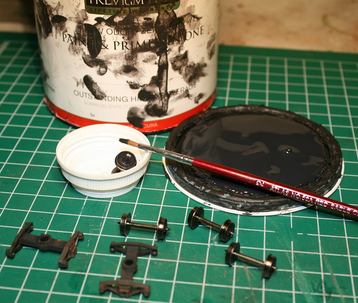

Next step is to add the trucks, if the trucks have oil-lubricated journal bearings, paint the wheel faces with thick black paint to represent leaked oil....
Once your trucks are finished, its time to perform final assembly. Next step testing the car on your layout!!!
At this point the car is essentially finished, however I like to make sure the car is properly weighted to conform with NMRA standards. I will discuss this in my next post....
Edited by - Srenchin on January 20 2016 11:07:28 PM
