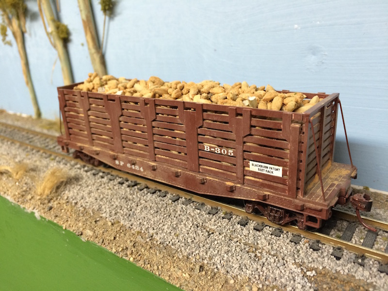

I cant figure out how to transfer the image, but this beet car that was featured in COTW by Redwoods is supper cool....
My COTW is a kitbashed beet rack car, now with beets. I scratchbuilt the rack from styrene to fit a Tyco skid flat. The beets are rye seed that I colored with clay that I collected on a fishing trip to Lake Shasta.

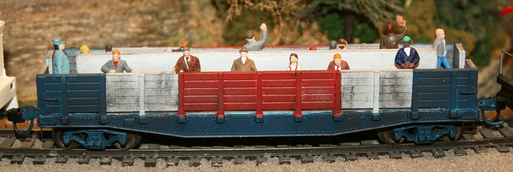

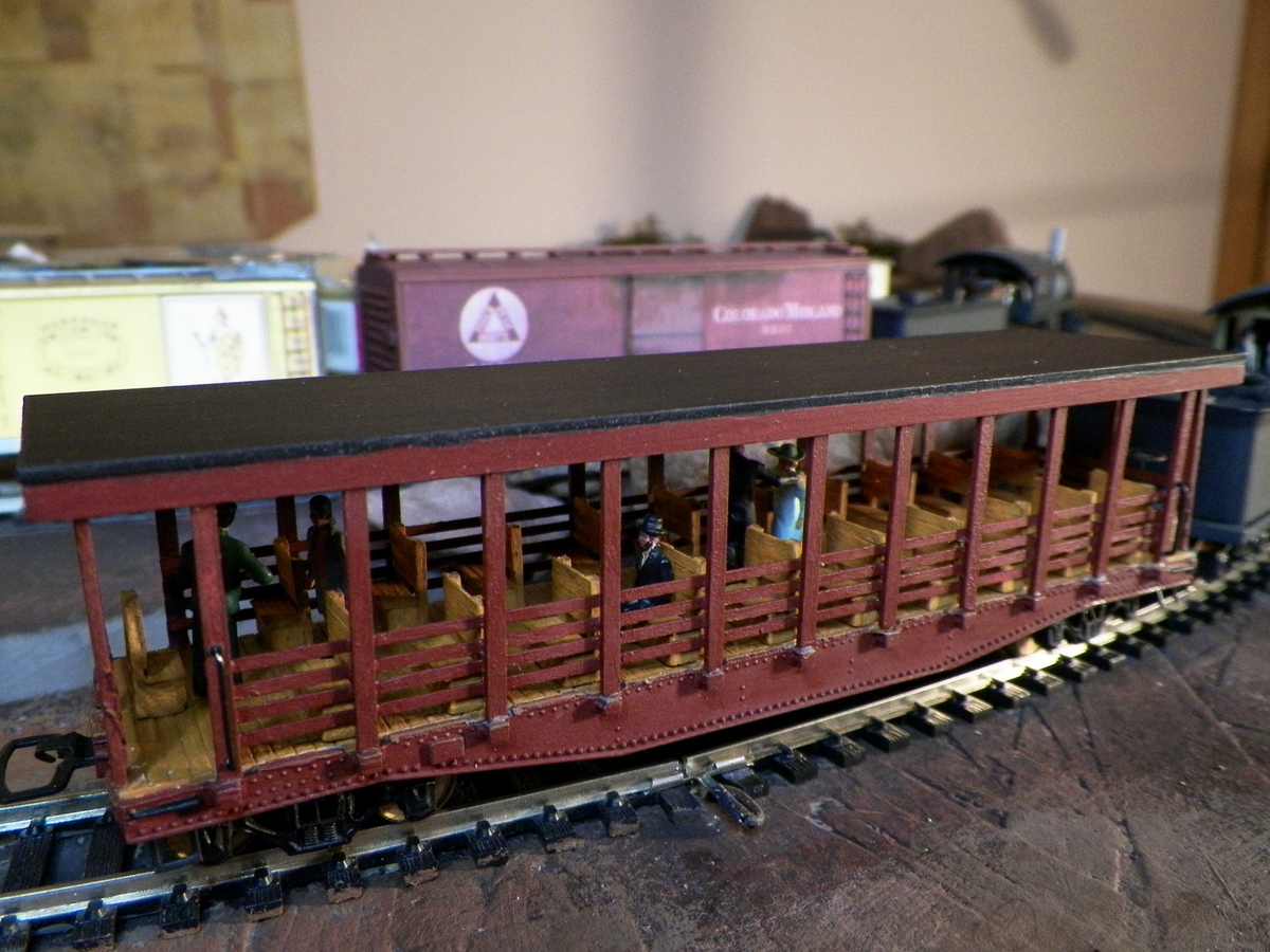

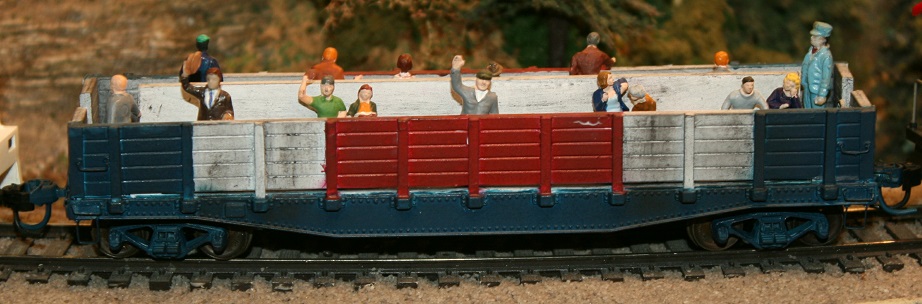

That is quite a machine. This is an excursion car I built onto a Mantua flat a while back. It looks pretty primitive to me now, but I also dig the possibilities of working with flats.

This excursion car is a great idea! Need an excuse to get that shay or climax when you model the present day? Well here you go....

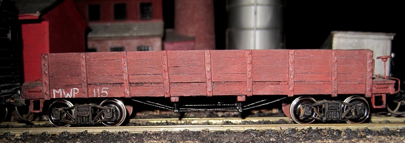

I wanted a low-sided gondola just a little bigger than the one on the MDC shorty flat, so I used an MDC tie-rod boxcar frame and cut planks out of 1/32" balsa to build this up:
The bolt heads on the stakes are just drops of glue.
These examples are a little off-topic for a skid flat conversion, but they illustrate an easy way of making a gondola from a flat.

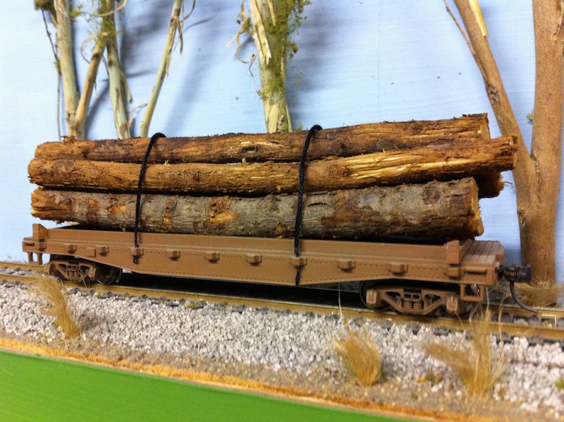

Scott, cool idea for a thread. Here are some beet cars and a log car that I kitbashed. If you look closely, you'll see that one of the beet cars is kitbashed from a Tyco dump car.
 Posted - December 28 2015 :  11:24:29 PM Link directly to this reply  Show Profile  Add scsshaggy to Buddylist
On the log car, the pointed chock-like things on the corners of the part above the deck are a nice touch. They look like they belong on a log bunk.

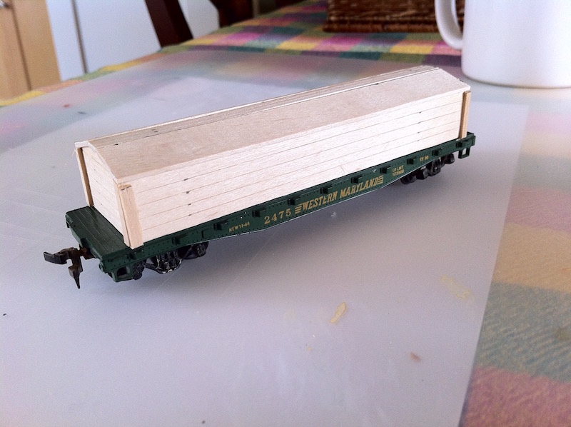

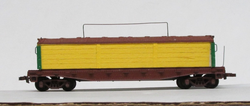

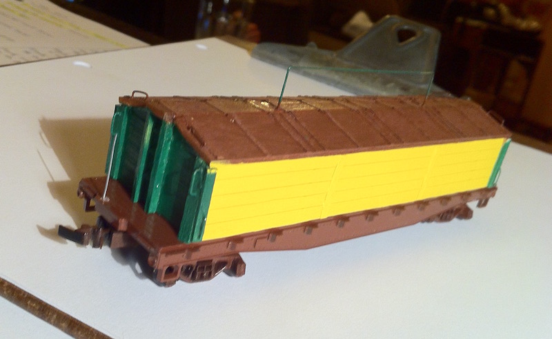

Here's another one of my skid flat kitbashes. It's a coffin style pickle car. I kitbashed the superstructure from wooden tongue depressors and coffee stirrers. I embossed rivets into cardstock for the metal straps. It's painted but I still need to create and print some decals for it.

That's a cool wood side gondola. I like the idea of using glue for bolt heads, that's a new one to me.

That's really well done. I like all the detail and seated people. It gives it a lot of personality.

hey Don't put Heinz on the side
Do some other pickle company

That "Bus Exterminator" is so clever. Barry, that excursion
car is fabulous. Primitive? My foot!

A Pickle Car! Excellent idea!!! Great work by the way!!!!

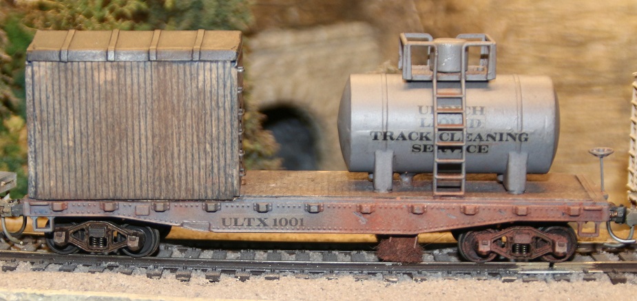

Here is an example of a Tyco Skid Flat repurposed to upgrade an old Ulrich Track Cleaning Car Kit...
This kitbash utilizes only the side sills and ends of a Tyco skid flat to dress up the appearance of the car, the core of the car remains the Ulrich kit.

Very nice Scott. Cool fix for that plain hunk of wood that makes up the body of the Ulrich kit. I'd forgotten about this thread. I still have a couple ideas percolating for a couple of Mantua Metal flat cars I have. I hope you take a notion to build a few more flat cars Scott.

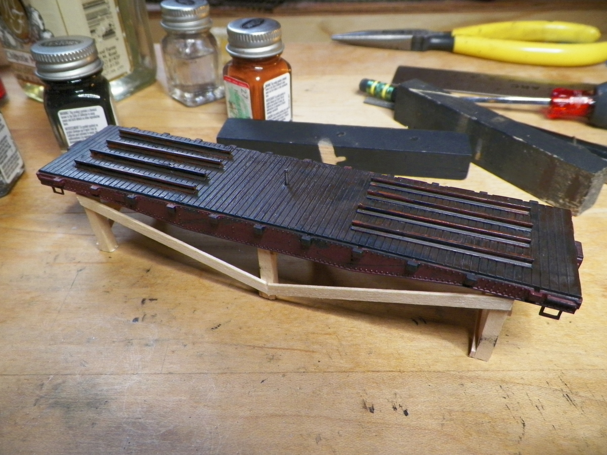

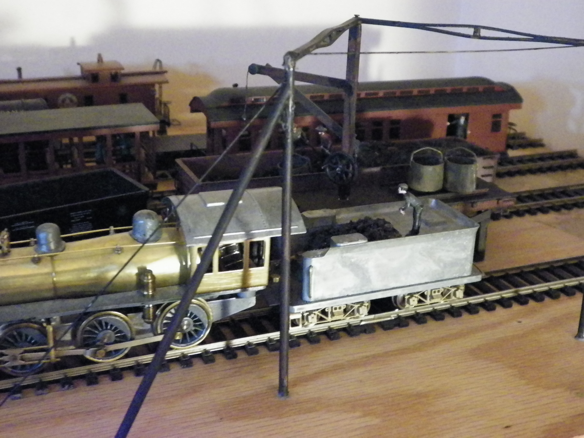

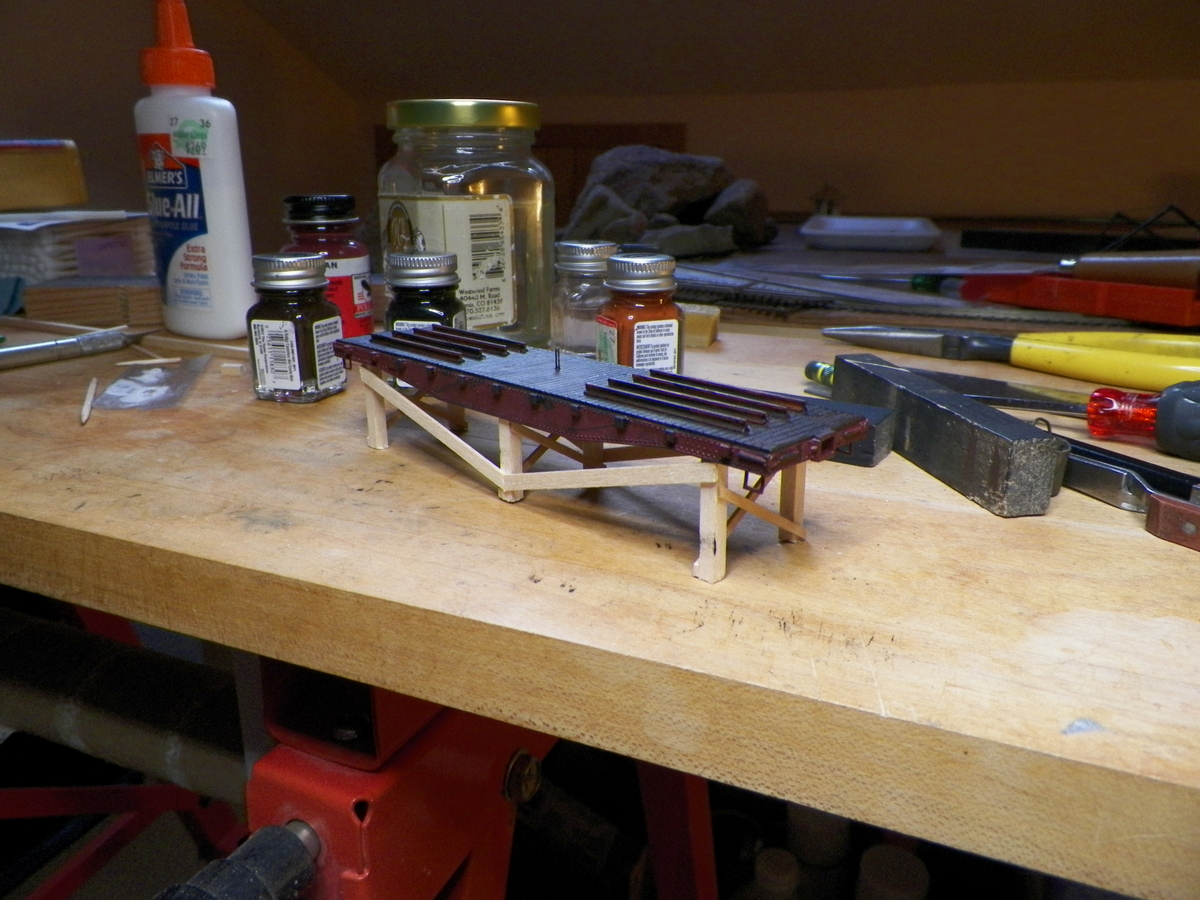

In the background is the existing bucket loader deck; built on a Bachmann Old Time flat. I wanted to redo it on a Mantua flat. Here's a couple more shots . . .
Everything else, I reused from the existing loader.

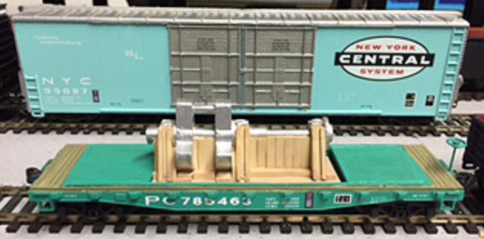

 Posted - November 22 2016 :  9:38:10 PM Link directly to this reply  Show Profile  Add el rojo grande to Buddylist
They make a really good drop center flat car. The load is a Chooch Enterprise machine load.

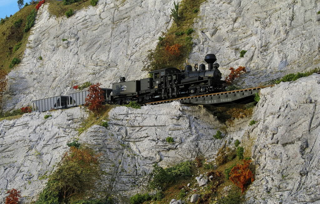

This may not be in the genre of a kit bashed flat car, but it is a unique use of a flat car. And this may not even be a Tyco flat car, but . . . I read that logging operations would make use of flat cars as bridges ? ? ?
