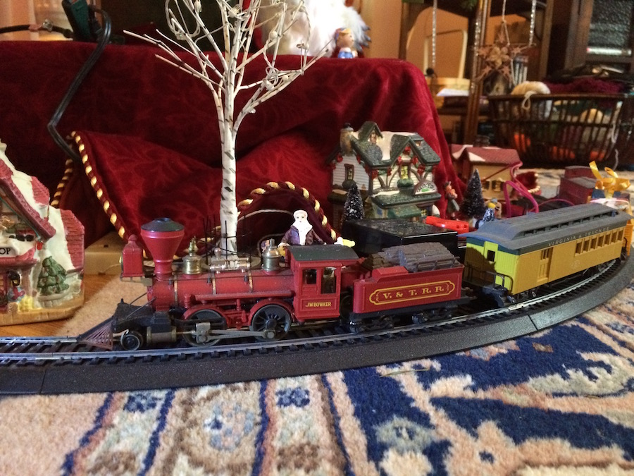

My LOTW is a locomotive doing the honors of pulling the Christmas train this year. It's a 2-4-0 Bowker (motor in the tender version).
