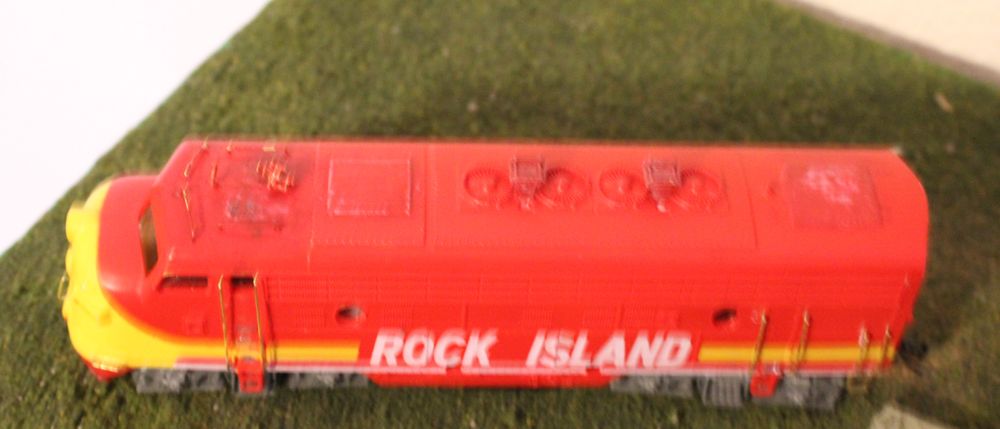

 Posted - December 15 2015 :  4:15:31 PM Link directly to this reply  Show Profile  Add fourteen to Buddylist
Here is what i have got done so far, removed and plated over dynamic brake, sanded down the steam generator detail, and started work on the pilots.
[URL=https://imageshack.com/i/p7kUBy62j] [/URL]
[URL=https://imageshack.com/i/paPIPkU1j] [/URL]
[URL=https://imageshack.com/i/pbqKYd5Hj] [/URL]
Modeling on the cheap

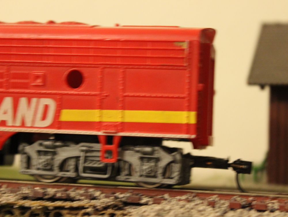

 Posted - December 19 2015 :  10:23:24 PM Link directly to this reply  Show Profile  Add fourteen to Buddylist
Was going to mount the rear coupler to the frame however there is not enough room on the frame to do that, so had to glue them to the rear truck. You can tell in the picture how little room there is behind the truck, guessing the tyco rear truck is mounted to far back, i don't have another brand f unit here to compare to it to. All mine are packed away in storage.

 Posted - December 19 2015 :  10:41:09 PM Link directly to this reply  Show Profile  Add scsshaggy to Buddylist
On a Stewart F7, the truck is about twice as far from the end as in your picture of the Tyco. On an Athearn, it's about three times as far.
By the way, have you checked that coupler height? It looks a bit low.

fourteen
RockIslandAvatar
 Posted - December 19 2015 :  11:16:05 PM Link directly to this reply  Show Profile  Add fourteen to Buddylist
Thanks for the info. Yup it's a tad low.
Not sure where my kadee height guage is at, and most of my tools. Moved a couple months ago and cant find them, and some air brush bottles, the dremal tool parts, have looked in most of the boxs in storage and cant find them. i should have put all that stuff in one box but no i was in a hurry packing and put stuff in differnt boxs.
Have bent the trip pin up so it is above the rail top. The frount end looks like it will need a # 27 coupler. I plan on putting a new drive on both of them at some future date.

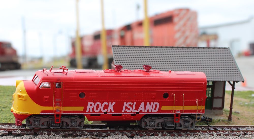

 Posted - March 14 2016 :  1:34:19 PM Link directly to this reply  Show Profile  Add fourteen to Buddylist
Just about done now, some final paint touch up, waiting on lift rings, number board decals and the side air grilles to come in. And some weathering to it also.
[URL=http://s1078.photobucket.com/user/14fourteen14/media/004_zpslzpwrp3v.jpg.html] [/URL]
[URL=http://s1078.photobucket.com/user/14fourteen14/media/003_zpsdvg8bjwi.jpg.html] [/URL]
[URL=http://s1078.photobucket.com/user/14fourteen14/media/002_zpsln3xven8.jpg.html] [/URL]

Those are looking very nice. Will you be modifying the skirts to the abridged ones common to F9s?
fourteen
RockIslandAvatar
 Posted - March 15 2016 :  01:24:09 AM Link directly to this reply  Show Profile  Add fourteen to Buddylist
Thought of doing that but decided not to as the underframe is not right, so it would look wroung. Have done some weathering on the underframe trucks etc. Even pulled the tape off the upper headlight lol.
