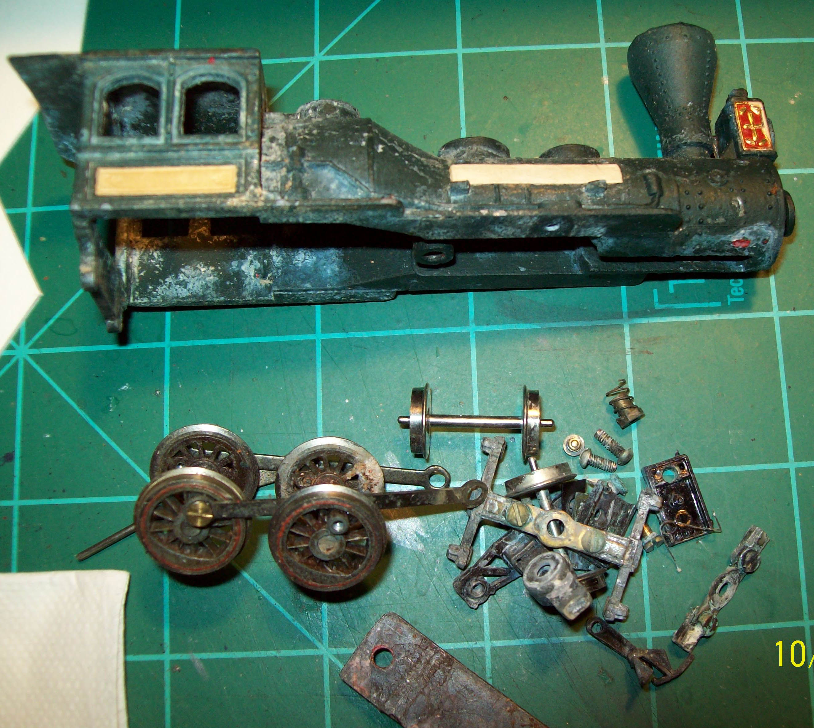

Before photos:
The body and drivers.
The parts were soaked in Super Clean for 24 hours and then brushed with a medium stiff
tooth brush to get most of the paint and crud off. Then I used a fine wire brush on my
Dremel to finish it up.

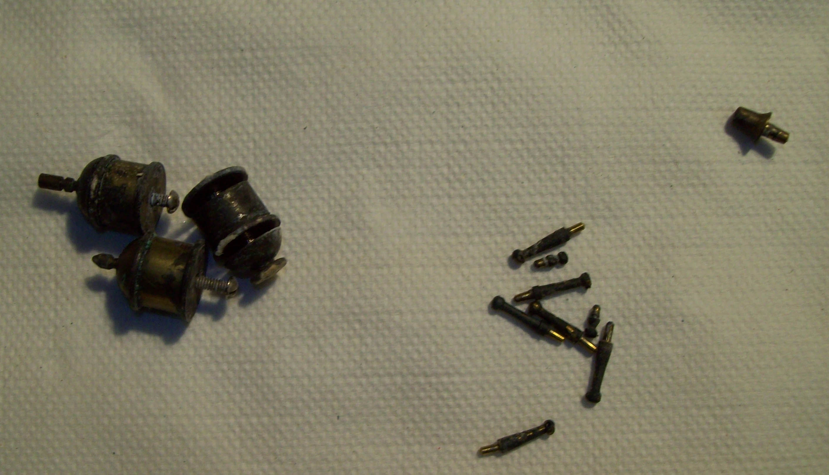

Brass fittings.
The brass fittings were soaked in Tarn-X for about 2 hours and then I used the wire
brush to shine them up.

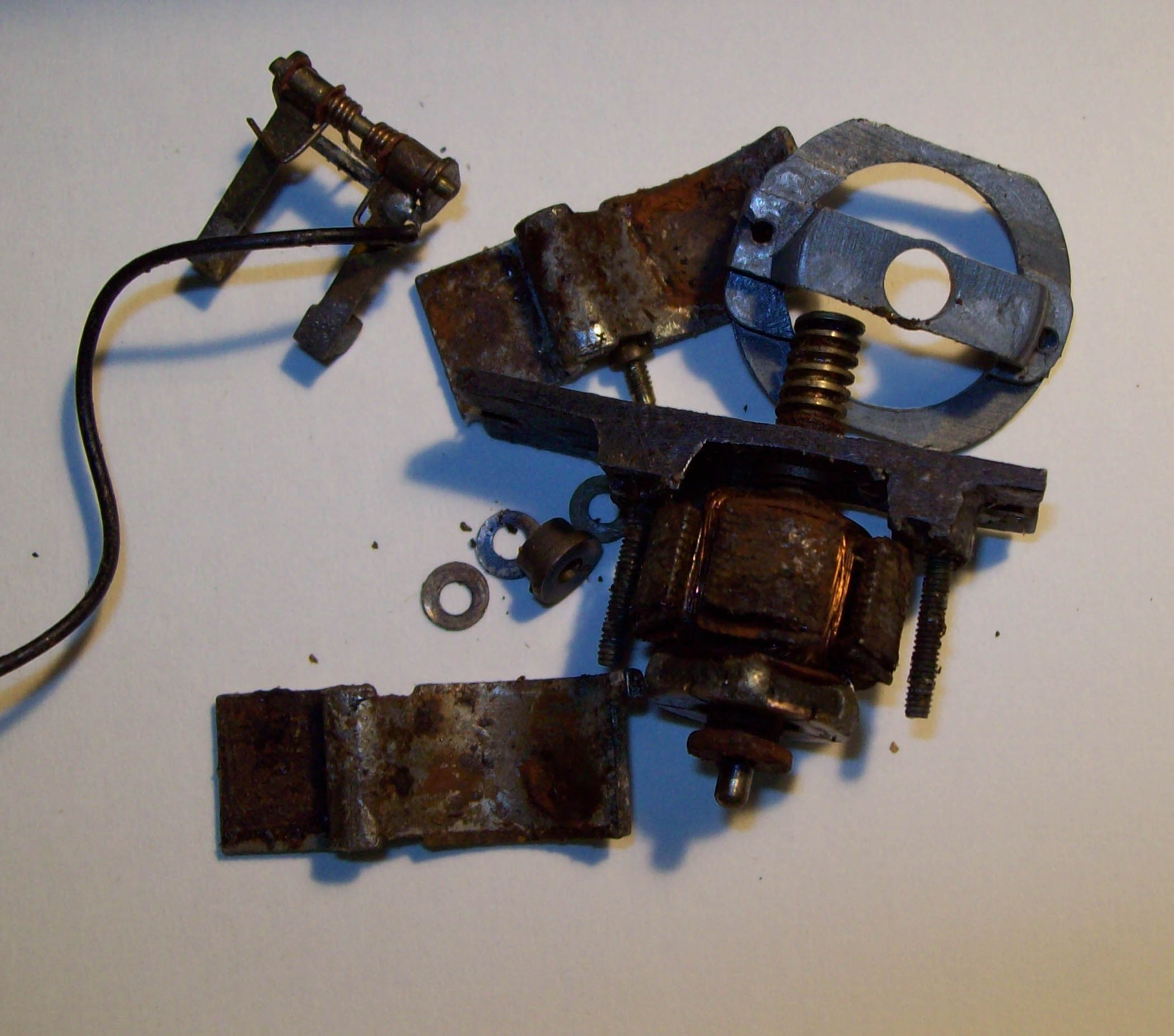

The motor.
The motor was soaked for 24 hours in Super Clean, rinsed off, soaked in rubbing
alcohol for 8 hours(to remove the water from the rinse) and then I used compressed
air to remove any leftover alcohol. The last soak was in lighter fluid to remove any
grease or oil left over and then sun dried for 4 hours. The armature and brushes
had to be replaced with parts from another motor as they were beyond repair.

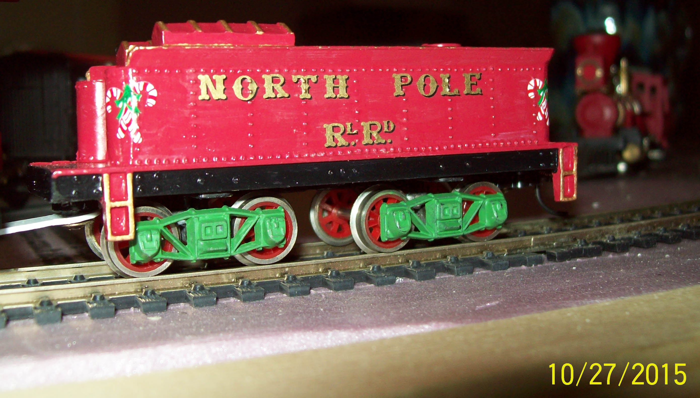

I used a tender that I had that was chipped bad and the decal was almost
completely gone.
I bought the decals from Microscale and had to use both the HO and N scale to
complete the build. The brass wire on the handrail was replaced.
I used floquil paint. ATSF Green and Red, Reefer White, Engine Black and
Bright Gold. It was given a coating of Micro Satin to protect the paint, brass
and decals.
Note: I had to replace the magnet in the motor as it sucked and was drawing
over 3/4 of an amp. I used 6 smaller Neo magnets(for now, have to get some
larger ones) and the current draw dropped to below 1/2 amp. It turned out to
be a nice running loco. Next project; complete the rolling stock for the train.

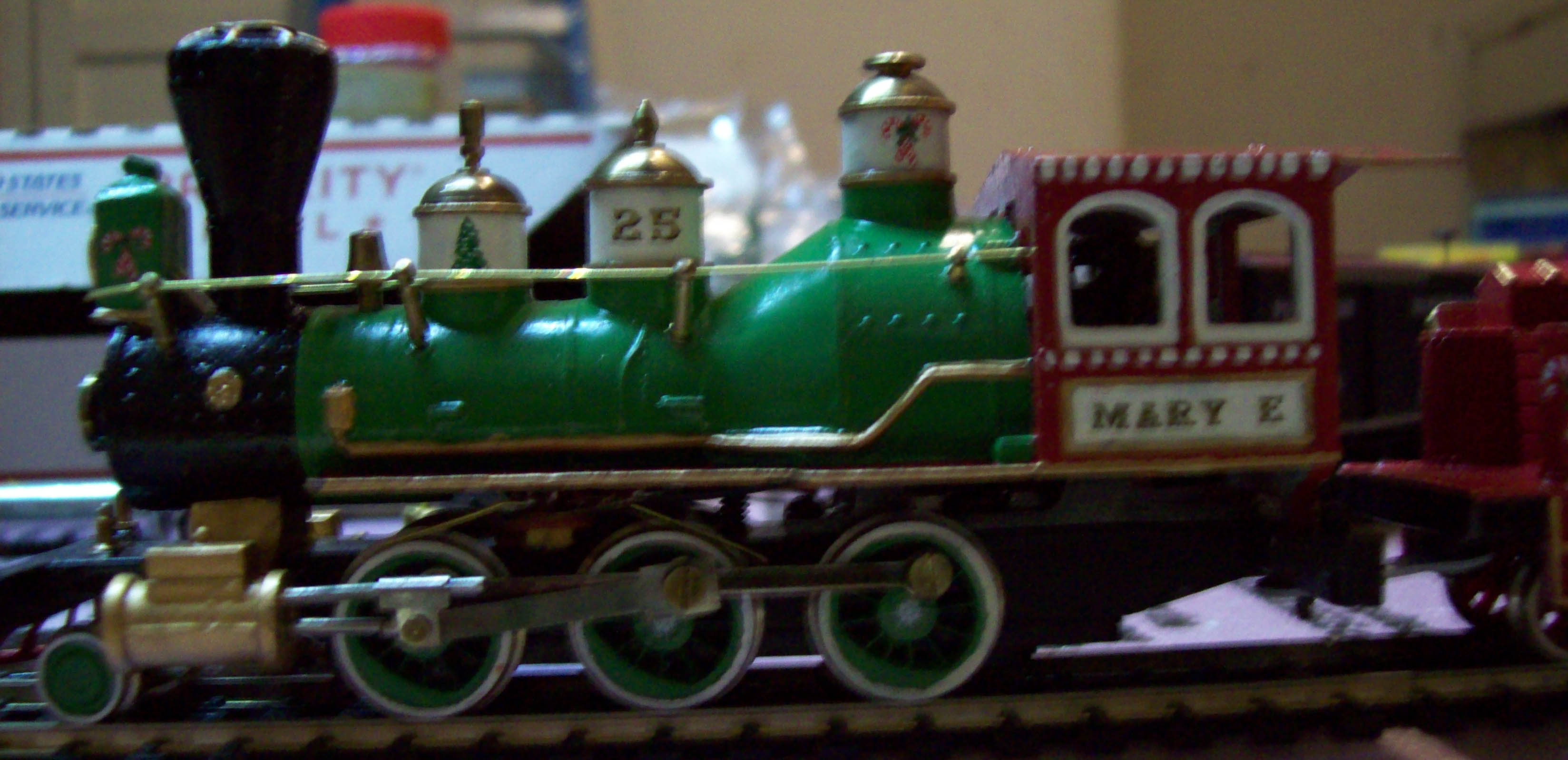

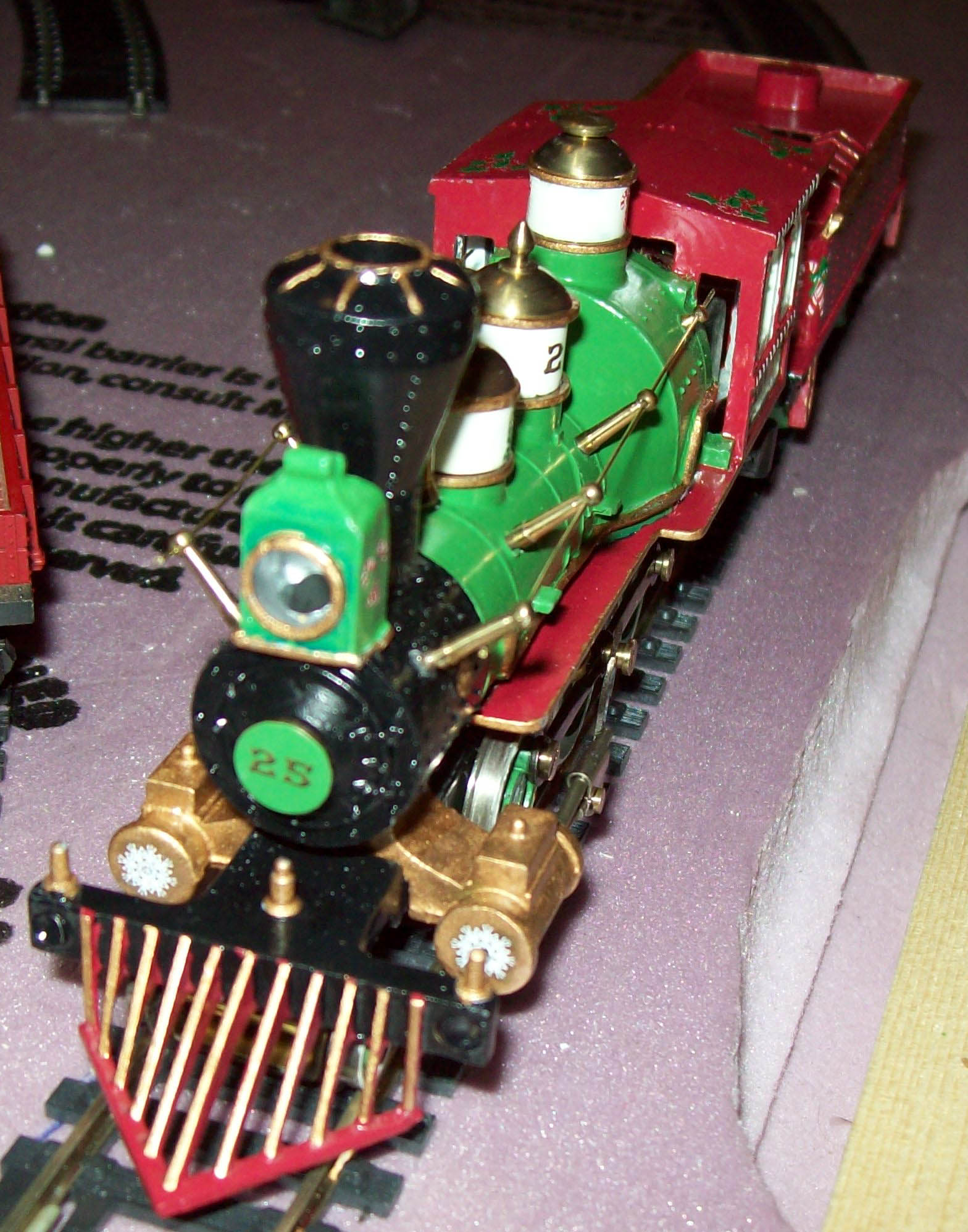

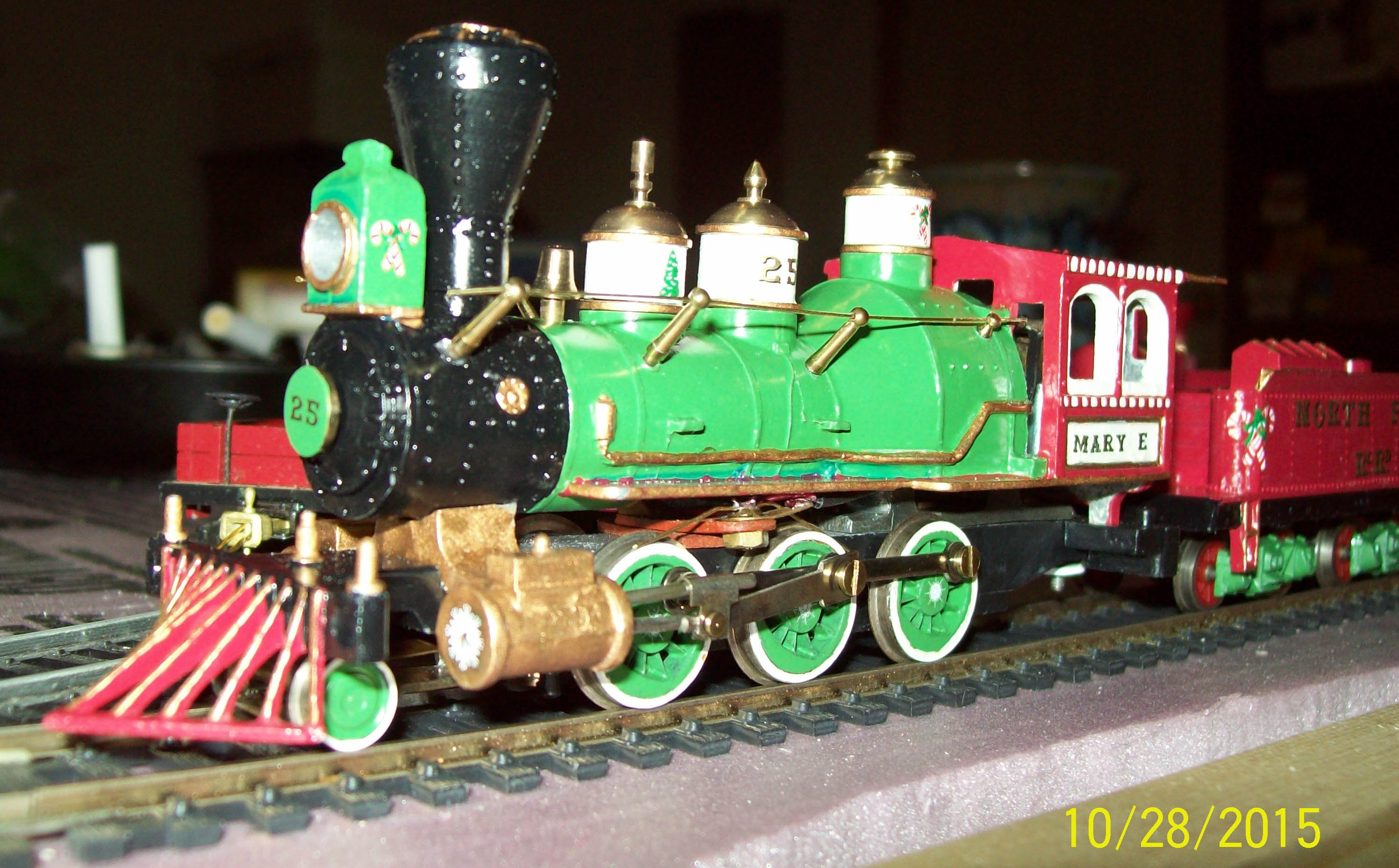

After photos:
The engine is named the "Mary E" after my mother who loved Christmas and passed away
Arpil 2014.
Overall, this build took from 50-60 hours of work and, to me, well worth it.

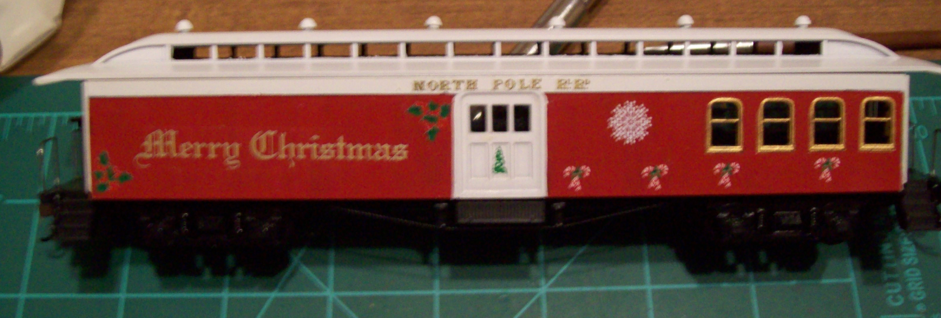

 Posted - November 23 2015 :  8:54:49 PM Link directly to this reply  Show Profile  Add oldtimer52 to Buddylist
Well, the elves have worked their little a**es off and the Baggage car is
finished.

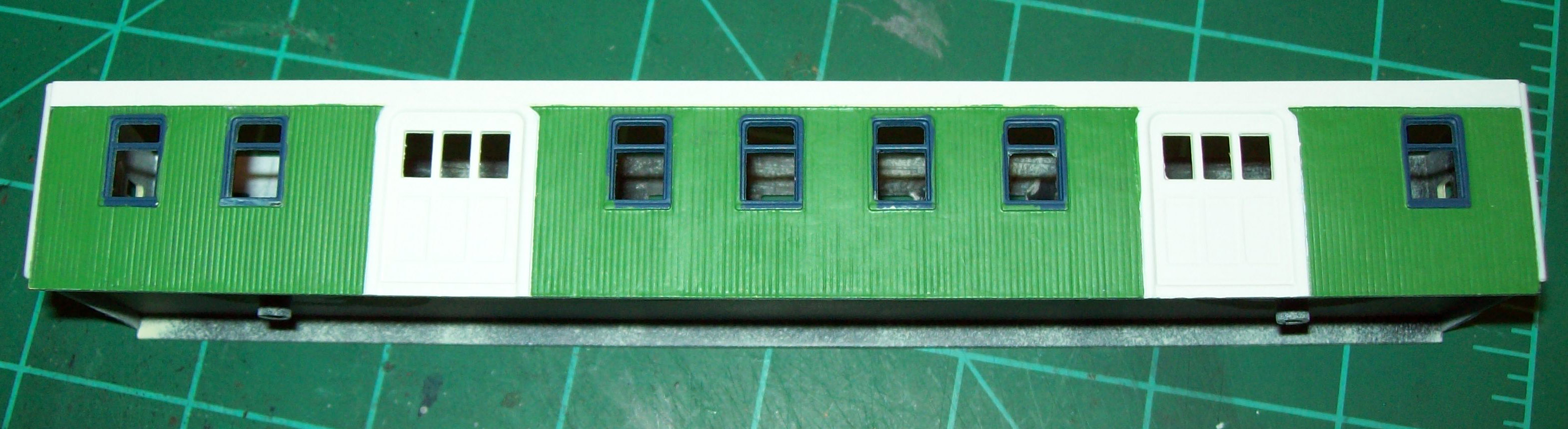

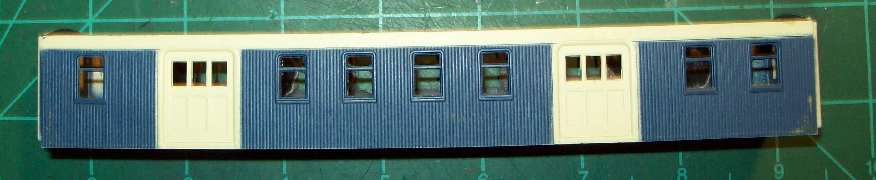

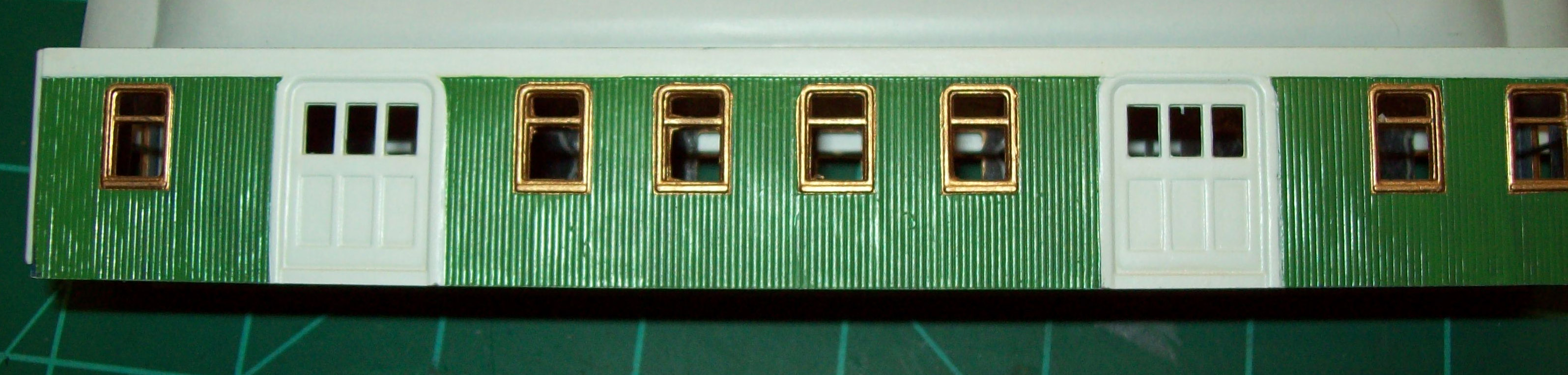

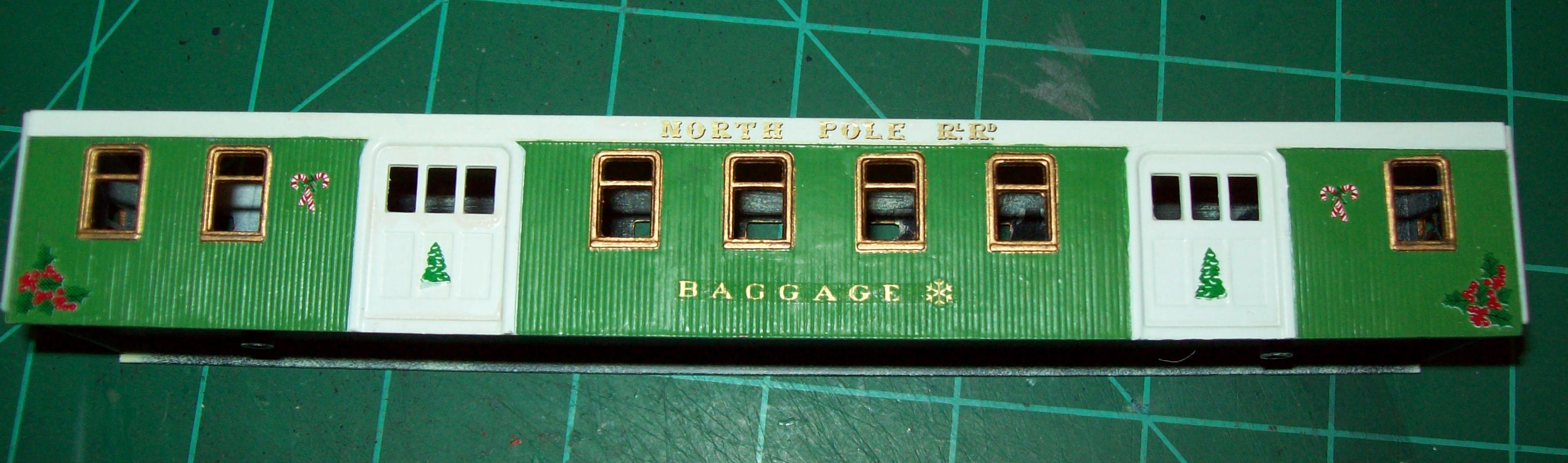

This is the basic body I started with. It's a Roundhouse 50' Baggage
Car. I stripped off the lettering but left the paint on as it provided a
really nice base coat.
Next I painted the body with a nice green and did the trim with a reefer white.
Next came the gold windows.

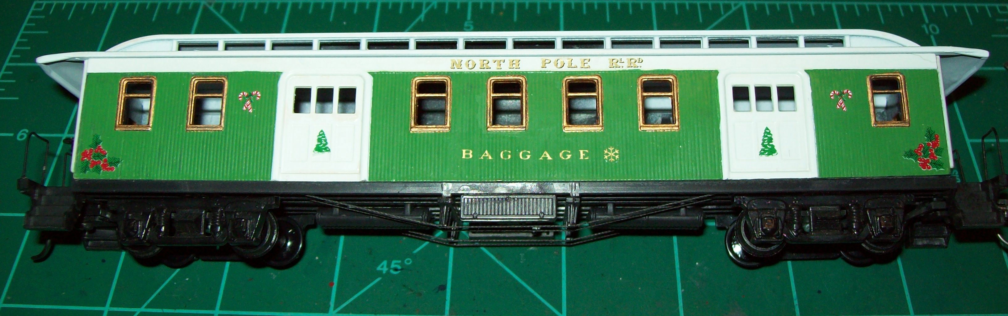

Then came the decals. Went with a laid back setup to keep it from looking like a
"toy" train.
Finally, assembly.
One down and only four more to do. Have the Combine, Sleeper, Box Car and
flat car left to finish.

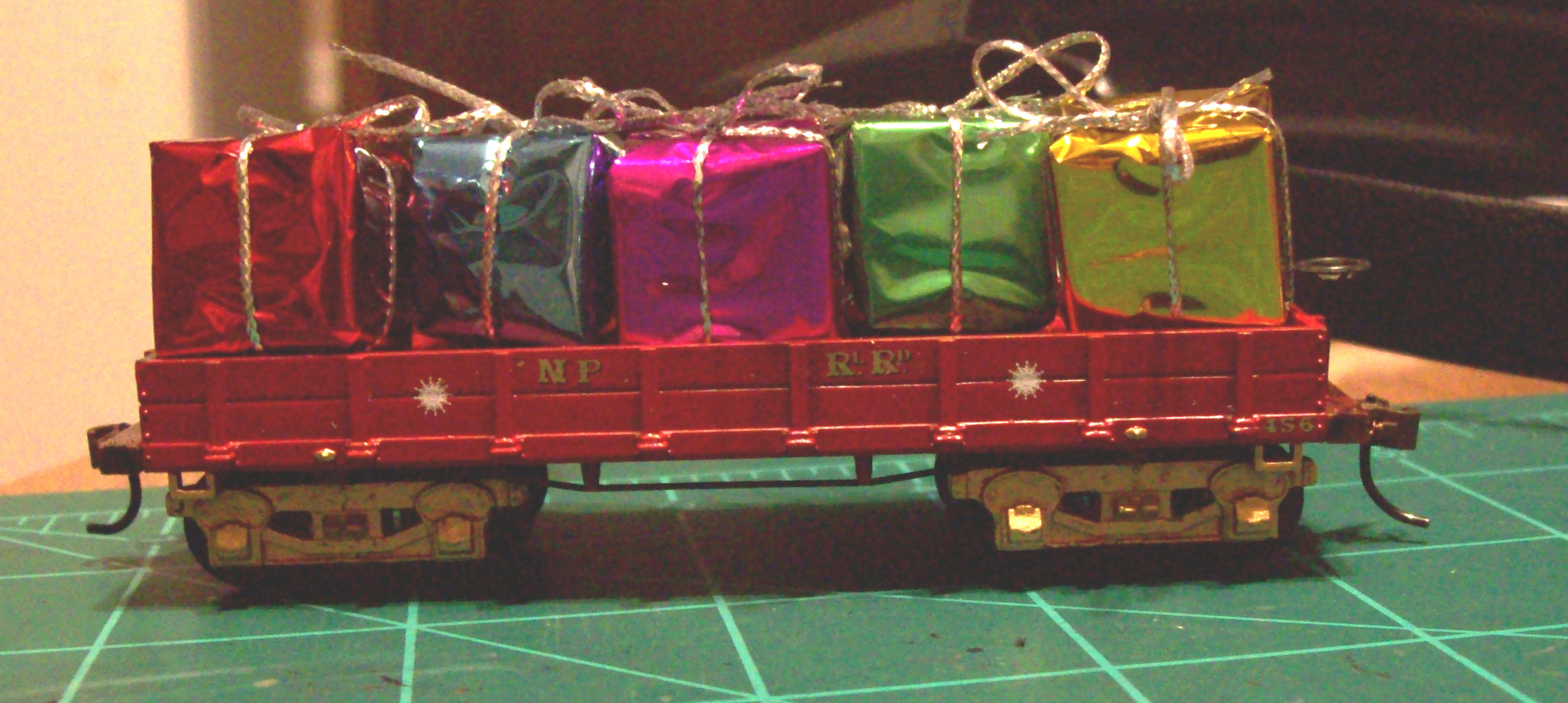

 Posted - November 25 2015 :  11:25:34 PM Link directly to this reply  Show Profile  Add oldtimer52 to Buddylist
Well boys and girls, the elves got real busy (with the help of espresso with double sugar
mixed in with the hot chocolate) and finished three more cars.
The combine.

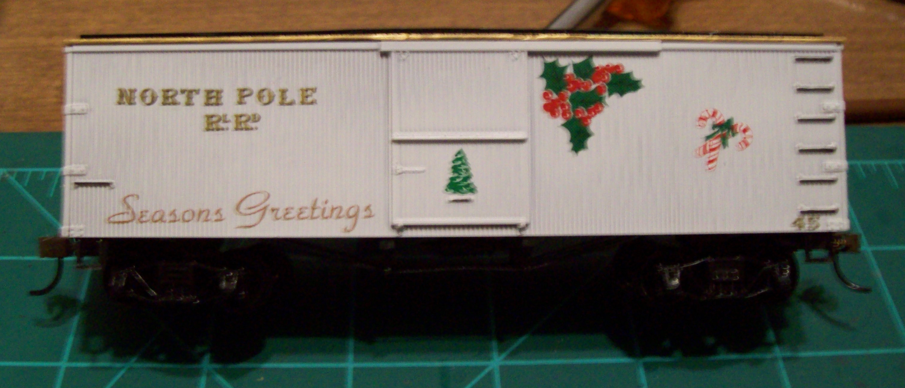

Boxcar.

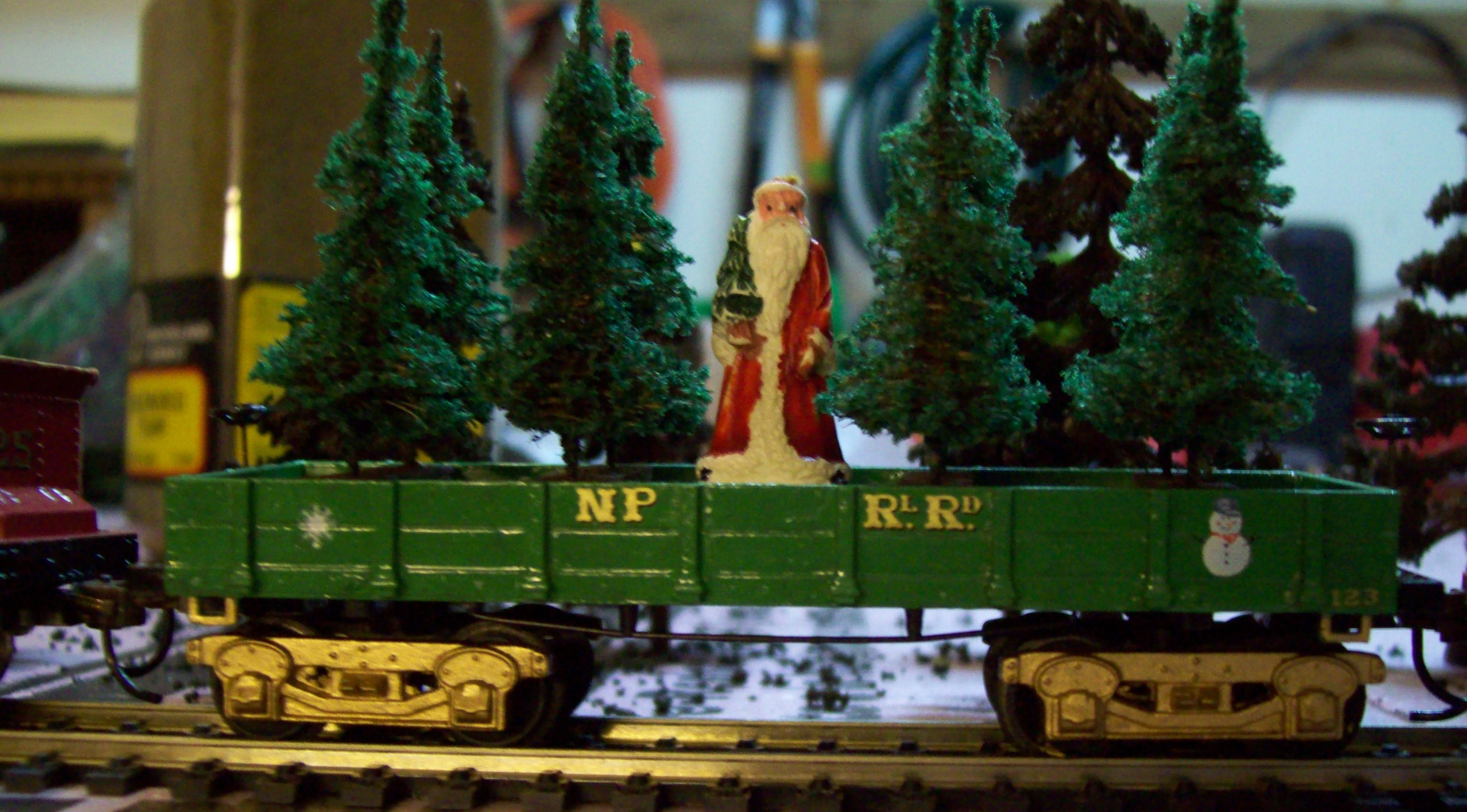

And the Gondola.

Thank you. The boxcar was made using the following:
Paint:
Floquil CN Green for the roof
Rustoleum Flat Black for the roof walk.
Rustoleum flat White for the body.
Floquil Engine Black for grab irons, etc.
Decals: Microscale
90243 Ornate Railroad Letters & Numbers, Gold with Black shadow (Roadname and boxcar number)
87-1120 Snowmen Scenes (Christmas tree)
87-1118 Greetings of the Season (Seasons Greetings)
87-1119 Candy canes, Snowflakes and Holly (obvious)
Model:
Roundhouse Old-time boxcar, undecorated.

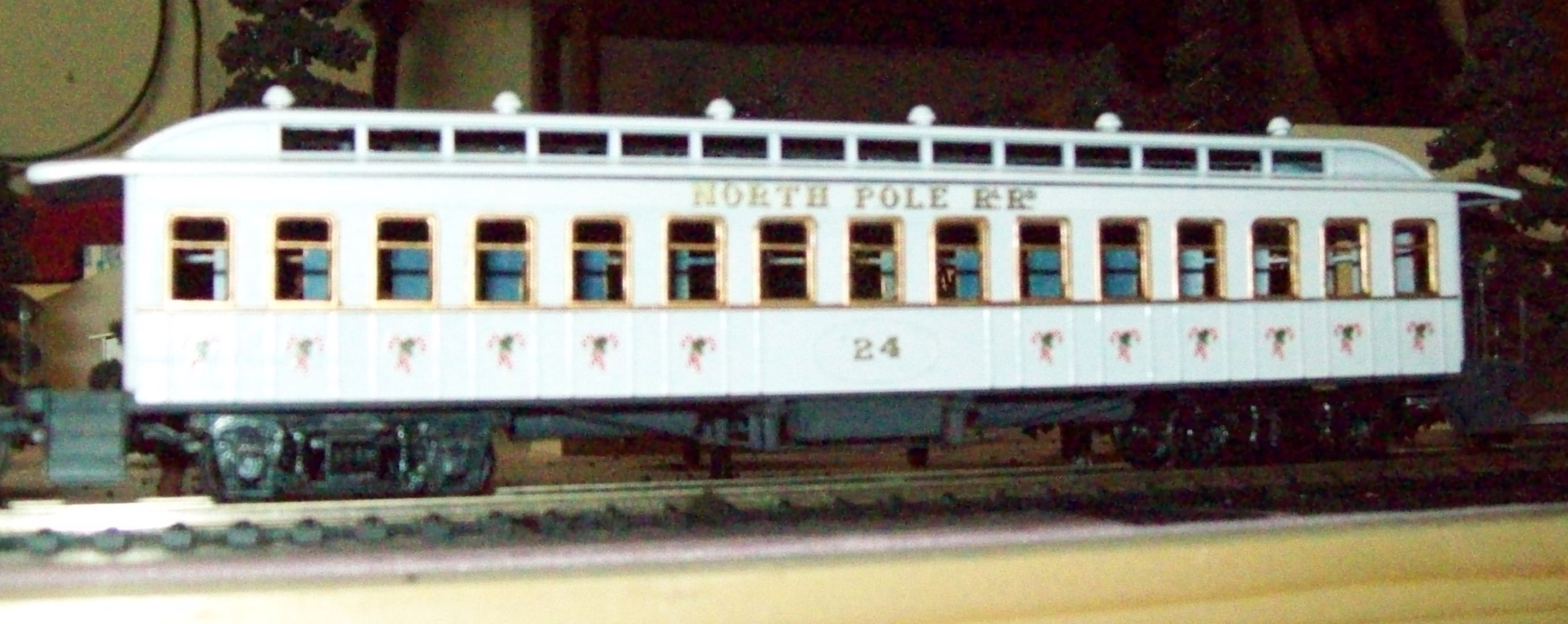

I have added a sleeper/coach and one other gondola so far. I may be adding a
flatcar, tank car and a caboose (providing I can find the right ones) to the construct.
Christmas tree gondola.
Sleeper/coach.

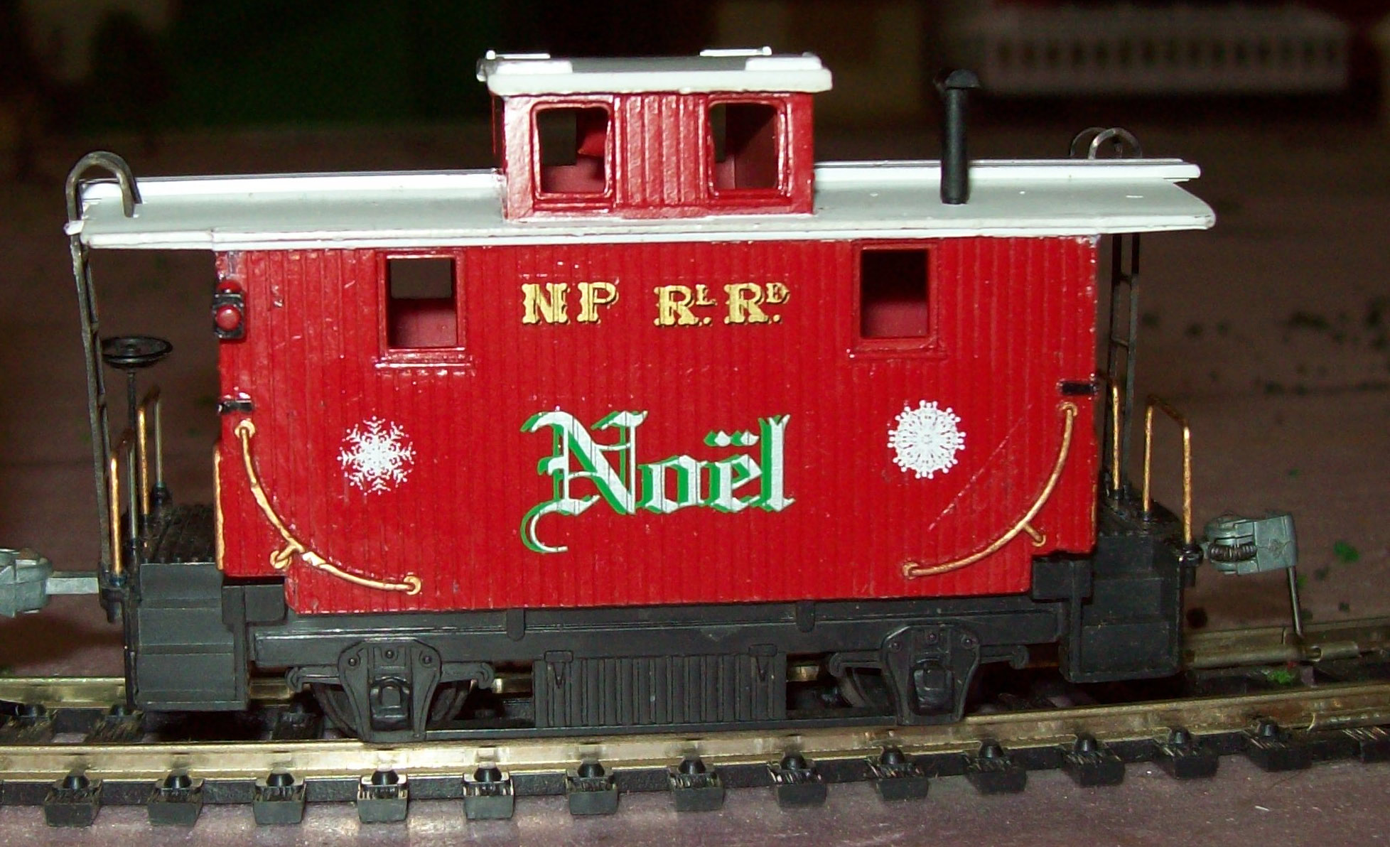

 Posted - December 22 2015 :  8:05:34 PM Link directly to this reply  Show Profile  Add oldtimer52 to Buddylist
Got the last car finished. It's a later production Manuta bobber caboose.
Hope to have a video ready in a day or two.
