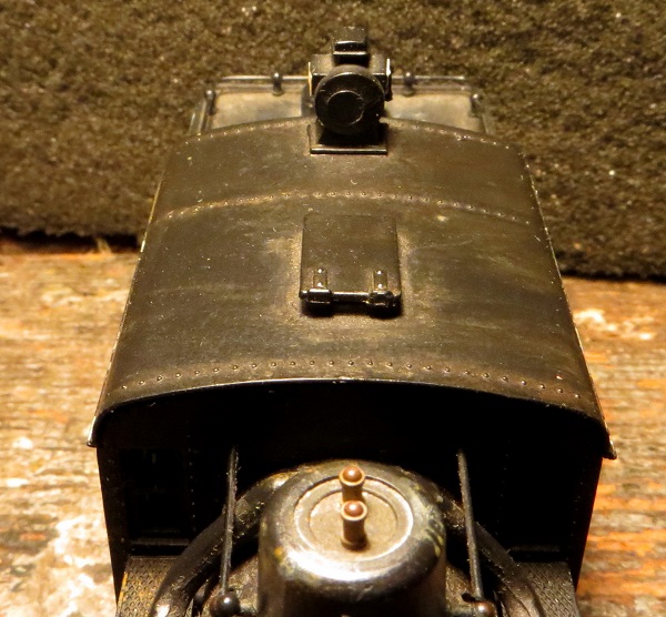

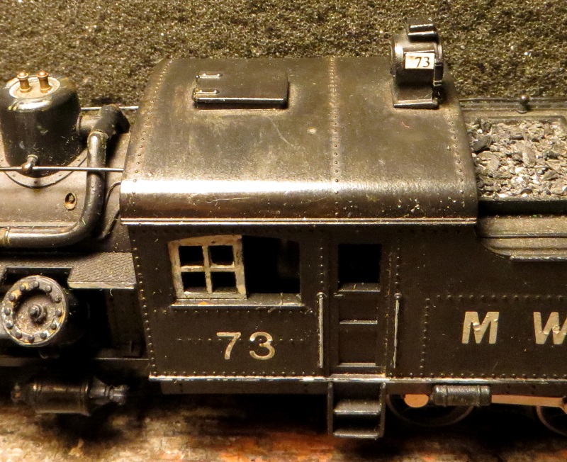

I don't have any really smart suggestions for making a roof, but here's a couple of pictures of an original roof, if that's any help:
