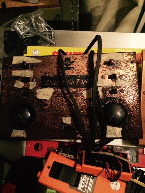

Hey, I have an old MRC power pack I got with a bunch of stuff from my grandparents and I was wondering, how do I get rust off of this thing? I need to know by Friday night or else my parents will throw this old thing out (it works good).

Old MRC packs are riveted and are very hard to take apart. It is not a good idea to do that any
way. Inspect the power cord for cracks or damage. If the power cord is bad, I suggest you trash the unit. The power cord should be replaced only by a adult with electrical skills.
If the cord is good. If the knobs pull off then remove them and try cleaning the unit with a Scotch bright pad the best you can. Tape off the switches, knob shafts, terminals, power cord, and any holes. Then with a couple of light coats, paint the unit with rustoleum paint. Be careful and try to not have any runs.
If the power cord shows any signs of cracks, then this is a unit that is dangerous to use.
Good luck, John

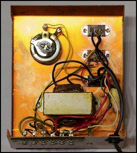

This is an old product. It most likely has a selenium rectifier in it with some old insulation products. The switches and other parts are riveted to the front case. You will not be able to dip the case to strip it. Any type of chemical may leak into the box and damage the old insulation. Old MRC packs are riveted and are very hard to take apart. It is not a good idea to do that any way. the switches and other parts are riveted to the front case.
My scotch bright/Rustoleum method is the safest way to keep this antique in operation. It will not look very good but it will not hurt you either.
This product really needs a grounded cord added to it. This should be done by a adult with the proper knowledge
I would suggest that you replace the unit and not try to save it.

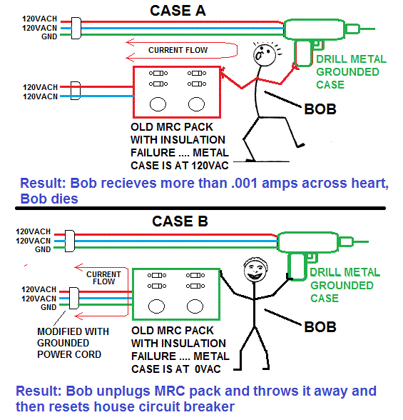

An older power packs with a metal case and a two prong cord can be a deadly device. When these were new the insulation was state of the art. Now this insulation is no longer state of the art and is 30 to 40 years old. The older insulation was fiber board that gets brittle with age, and varnish that will also break down. The vinegar is a harsh chemical that may cause these old insulators to fail, even the fumes.
The three wire AC power system was invented to help prevent deaths from this type of device, but the system only works if the metal case is grounded. New 2 wire devices are double insulated and that is to prevent human harm.
As the picture show the older MRC packs were metal and all the devices were attached to the case.
If the power cord, power switch or the transformer break down then the case may have 120VAC on it. Not a safe situation. With a 2 wire system, then you may be the source of a ground. It may not burn you, but it can sure stop your heart.
Regards, John

To that, I agree. In that case, I WOULD drill out the rivets, check the interior for any damage, ohm out the connections to make sure there are no shorts, use self-tapping screws to reassemble it, and still use it. I realize that things do improve with time, technologically, but that even old devices can still be used safely. if care is taken to check them properly. I've had more than one Tyco gold Power Pack die on me, but I can't say I've had any MRC types go bad. If you're loaded with money, go buy new. If not, take the safe road and thoroughly check out the old pack, and then you'll know for sure it's generally safe to use. They were built as a child's toy, and they built in as much safe-guards as they could back then, otherwise they wouldn't have lasted 30-40 years. My Shop repairs old Lionel power packs, drill out the rivets on the smaller ones, replace the cords and any worn parts, and reassemble them. Nothing illegal about it, and it saves a vintage power supply. While I can appreciate the sentiment of safely, I just don't believe " at all costs" is necessary in this case. I WOULD take the further step of drilling out the rivets to check the internals, but as long as they check out, use it.
