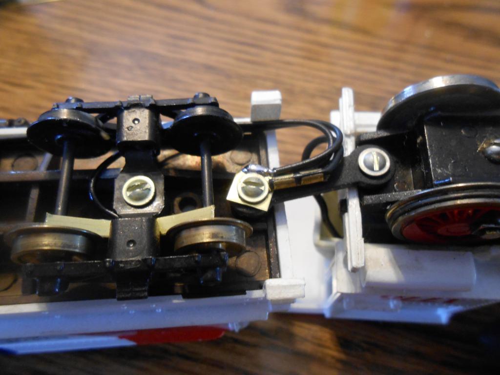

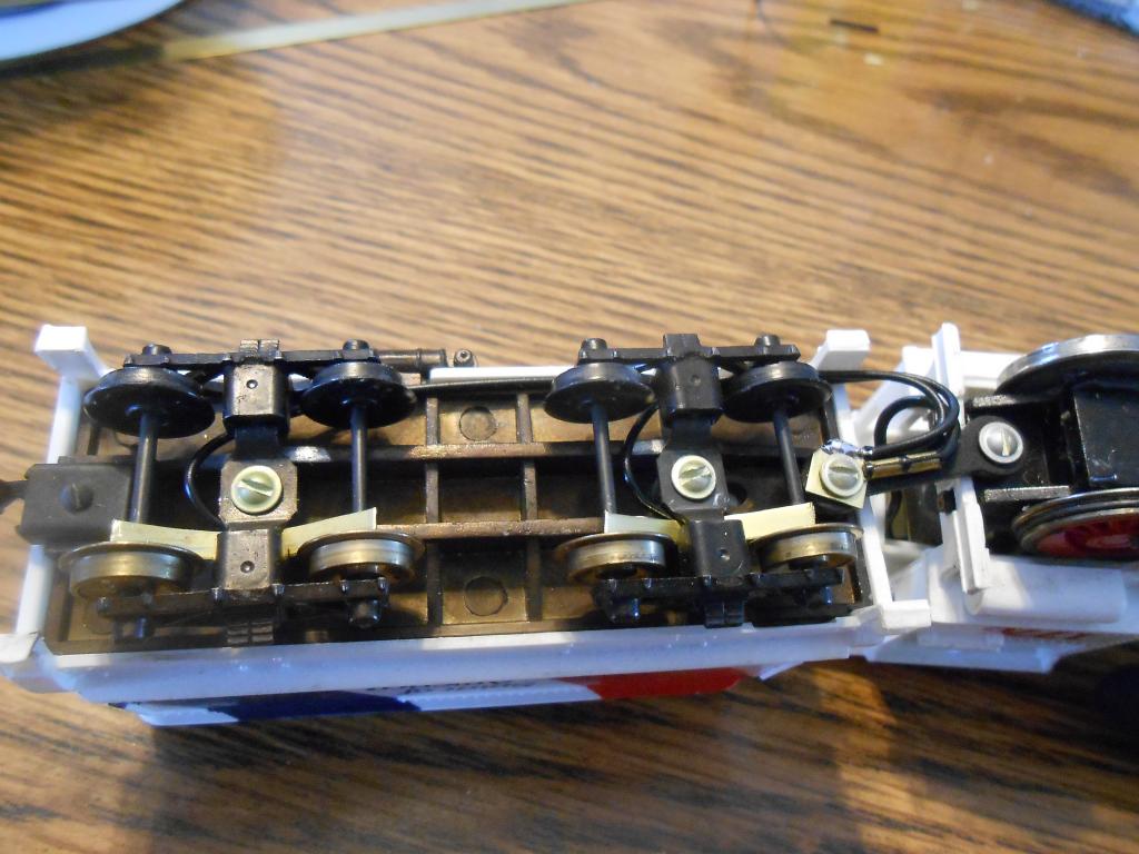

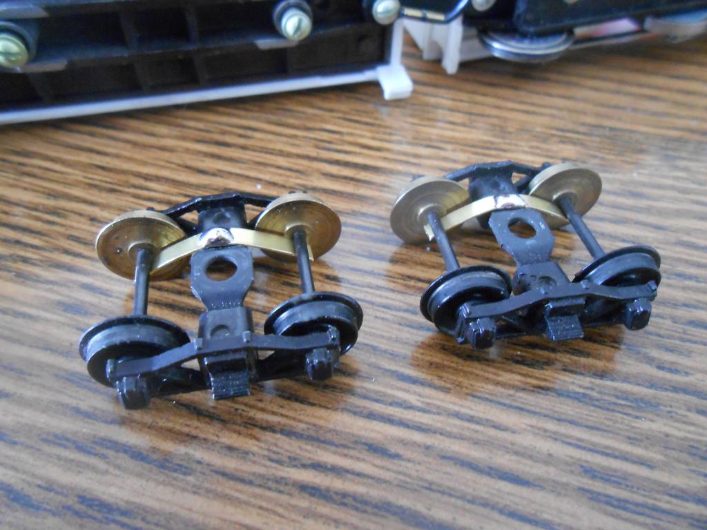

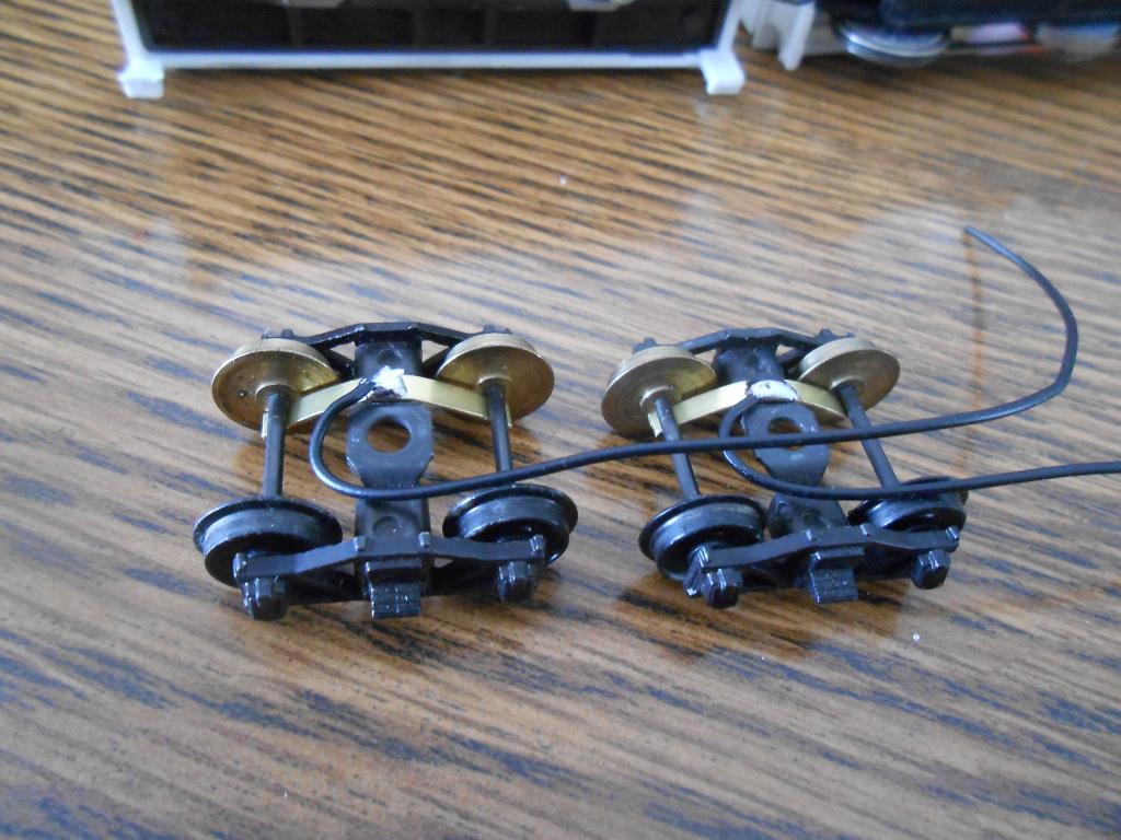

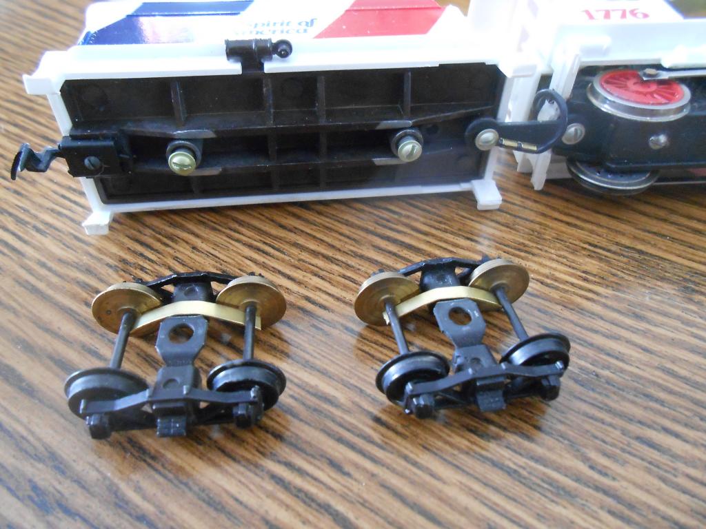

I was tired of the flickering headlight and poor performance of this engine. It's one of my favorite engines and I believe one of Tyco's most handsome. So before the snow started flying today, I went to the LHS for some brass wire. They had none so I settled on 0.016 brass flat stock and fashioned some pickups. They're resistance fit in place with 24 ga. stranded wire connected to a brass contact plate. No more flickering headlight and much better performance. I didn't realize how badly this engine was running before today. Now she can be run at a creep with five 50' passenger cars in tow.

The biggest gremlin on most model steam locomotives is the electrical resistance that occurs between and axle points and side frame journals of tender trucks. As a result this little improvement is one of the easiest ways of improving steam loco performance. The only thing that I would like to add is that Phosphor Bronze works better than brass for electrical pickup wipers.
