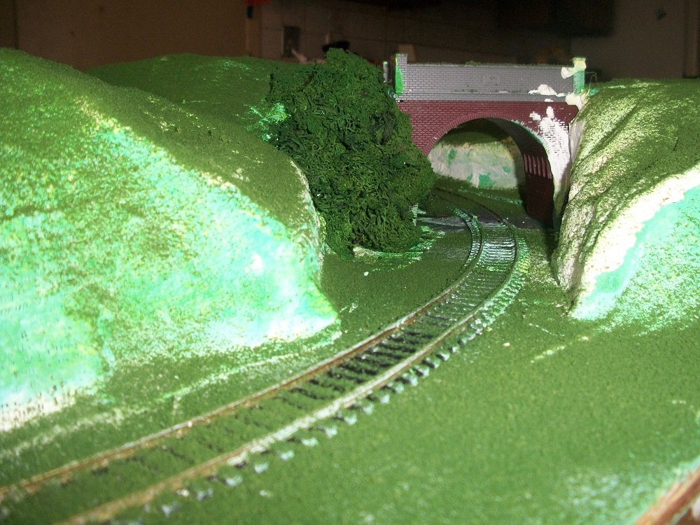

Ima throwin' down the glove here. I was able to get this much
done today. I challenge you Walt to power up some of that
slot track- I wanna see some of your automobiles.
Skimps, need to see some photos of that Down Under
track plan.
No 'scuses, no sniveling.
By the way, the mister helped a lot. Laid down a damp base, spritzled on
the snow, grass, then spritzled it with a top coat. Dried to a firm crust.
Got some patchy areas I'm going to go over with gray paint, highlight
it with a black was to look like granite- I hope...

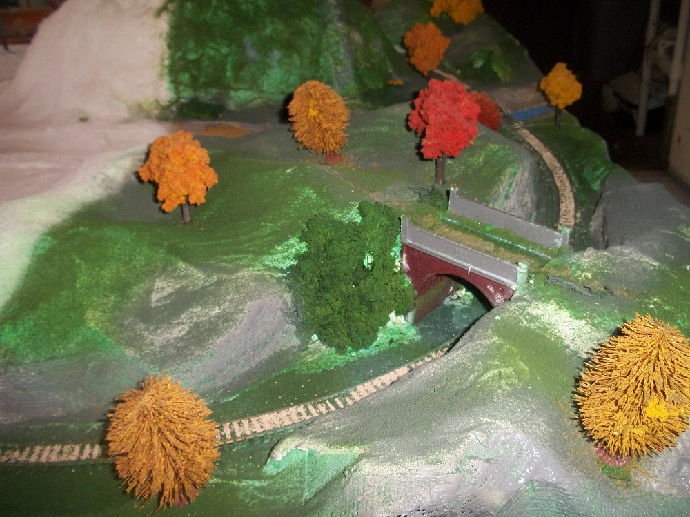

 Posted - April 08 2015 :  11:26:44 AM Link directly to this reply  Show Profile  Add Chops124 to Buddylist
Blew down some gray spray paint to hide the white patches, particularly on
the side of Sugarloaf Mountain, which helped soften it up a bit, visually.
Added fall foliage, laid out a thin thread of ballast and added mud colored
paint about edge of river bank.
Later today: water.
Tomorrow: scrape off the rails and see if anything runs, then call it a wrap.

 Posted - April 08 2015 :  12:10:05 PM Link directly to this reply  Show Profile  Add wks to Buddylist
Looks very good. Would come in handy for some photos for The TF RR News.

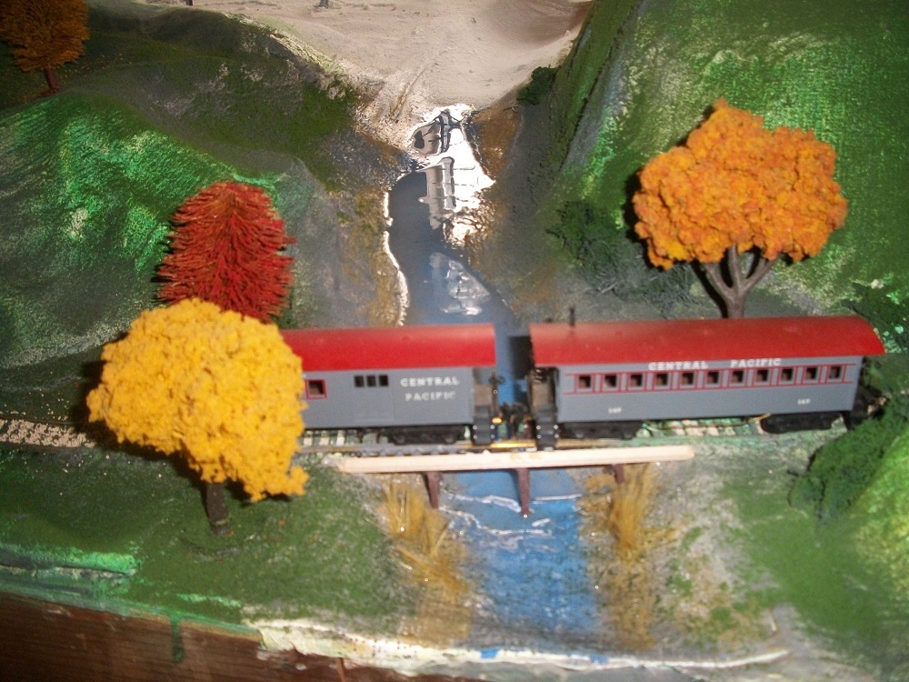

"Water, water everywhere, but not a drop to drink," (Tale
of the Ancient Mariner). After multiple layers of plaster
and paint on the stream bed, I figured it was sealed off
good. I figured wrong.
Poured out a thin layer of WS resin water and watched
as it dribbled out through a dozen micro holes. Whatta
mess. Had to scrub down the kitchen table pretty good
before wife came home.
The remainder, however, plugged the holes.
Rewatering continues. The snow and grass pretty
well tied down after having them sprayed the base,
and then over the top again until saturated.

 Posted - April 09 2015 :  5:34:59 PM Link directly to this reply  Show Profile  Add Chops124 to Buddylist
Getting there. Mt. Cheesecloth presents some issues, may need yet another
coat of grass.
 Posted - April 10 2015 :  12:17:35 AM Link directly to this reply  Show Profile  Click to see DaCheez's MSN Messenger address  Add DaCheez to Buddylist
That's looking really good Chops! The river and bridge turned out great.
In regards to "Mt. Cheesecloth needing more grass"... I remember on my first plaster layout I used some of Woodland Scenics' undercoat (basically brown/green paint that stays wet longer so you can sprinkle your grass right on top of it without needing glue). Well, I made the mistake of not shaking it well enough and a lot of it went on virtually clear leaving the grass looking very white-ish from the bare plaster beneath. The addition of more turf just gave it a weird mossy look. My method now is to absolutely cover every bit of the layout with cheap, brown and green, dollar store paint before adding turf. The paint provides the colour and the turf provides the texture.
Just my 2 cents, but in the places where the plaster is really showing through I'd just apply some green or brown acrylic paint over top of the current grass and then give it another sprinkle of turf while the paint is still wet. The end result should be good.

That water looks pretty good Jeff. And I dig your old coaches.

Eric's advice is correct. I always paint a color similar to the ground covering. It helps greatly with the final results

Believe it or not, I saturated the base with either white or green, but
and slathered most of it with plaster. Oddly enough the undercoat
faded and the cheese cloth started to re-emerge when I applied
a coat of watered down white glue to hold the grass. I am going
to have to tip the layout on its side, and re-apply yet another
layer of grass to hide my sins.

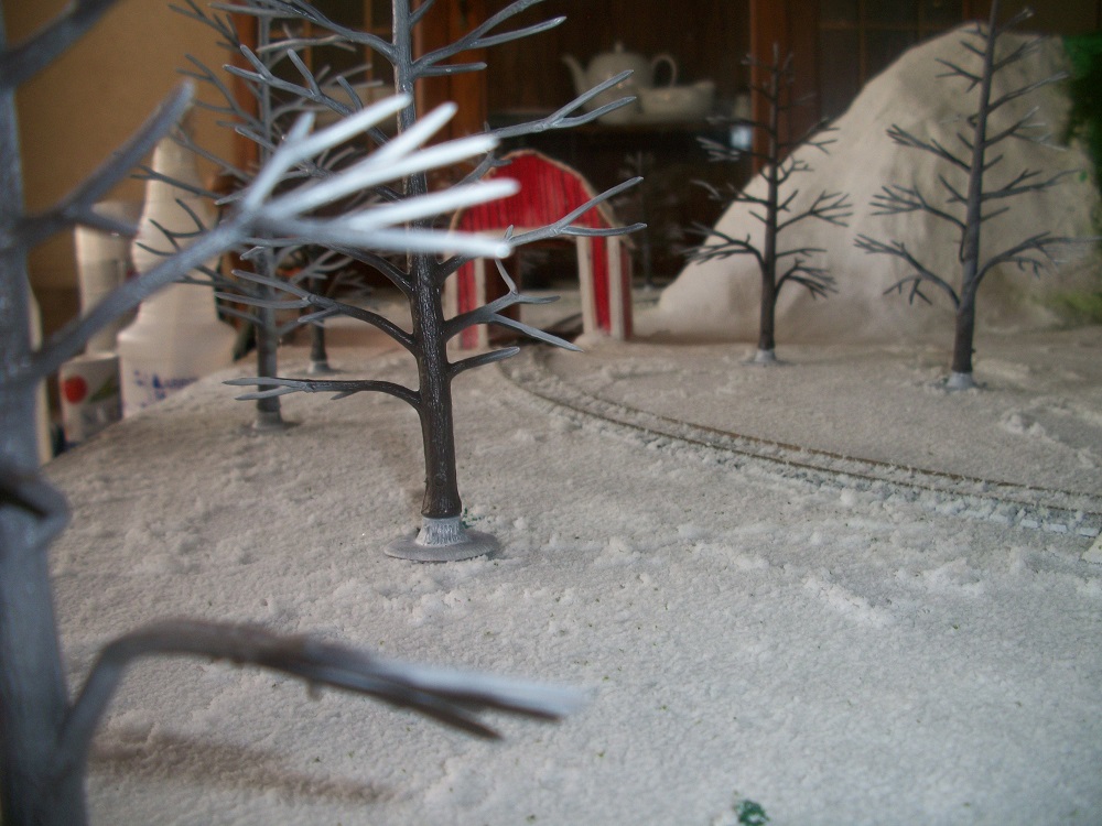

Another thing I wish'd I'd one is glue the winter tree stumps
before I laid on the snow, so they wouldn't stand out like they
do. Sigh.
