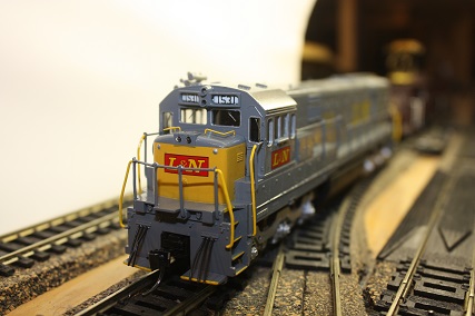

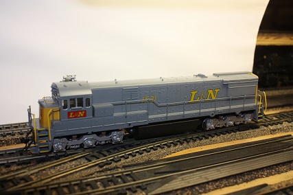

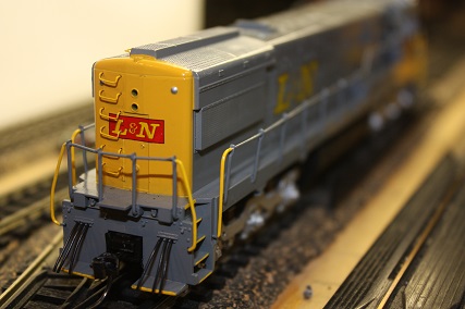

This is an older Athearn Blue-Box re-build.
Randy
 Country: USA  ~  Posts: 370  ~  Member Since: April 30 2011  ~  Last Visit: November 09 2026 Alert Moderator
 Posted - March 29 2015 :  8:54:25 PM Link directly to this reply  Show Profile  Add JNXT 7707 to Buddylist
Dang that is a beautiful job on that, Randy! Excellent job
rbturner
RBT
 Posted - March 29 2015 :  8:59:58 PM Link directly to this reply  Show Profile  Add rbturner to Buddylist
Couldn't tell from pictures what the horns should be Jerry. So I stuck on a set from a Bachmann GP-50.

That's a sweet job of superdetailing! It's detail added later, but it's so neatly done that it looks like it's all designed in from the beginning.

Looks more like an Athearn Genesis to me. Very nice.

Thanks for the kind words guys. I do use pre made grab irons now; I used to bend them all. The cheapest I have found are from Tichy. For the wipers and air hoses I use the scraps from the Miniatronics light bulbs I use. I drill the pilots and super glue in the wire scraps then trim them off even with the footboard. I take the "too short for air hoses" scraps and strip the insulation off and bend them for the wipers.
Detailing on the cheap. I have been also making my lift rings out of scrap wire strands. I need to begin making coupler lift bars too.
