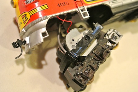

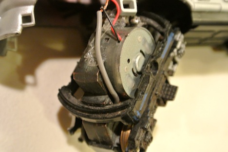

I posted pics of an f-unit that i did the cd rom motor conversion on several months back. I did have to do some trimming on the gimbal but it fit. i forget where i posted it but i will dig around or just take some fresh pics for you. so far i have had no reliability issues with mine and it is still going strong!

 Posted - March 04 2015 :  01:48:26 AM Link directly to this reply  Show Profile  Add metalsmith1 to Buddylist
Here are the pics of that F-unit
